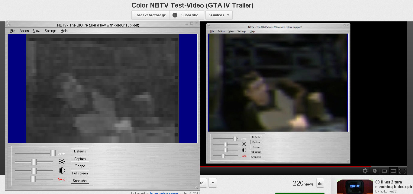

      Compressing the audio file doesn't really work for anything with high-frequency sounds like this.
      Color NBTV files are even worse. You can basically just guess what you're looking at if you compress the .wav (or .flac) file to .mp3 or .ogg or any other lossy format and then try to play it back.
      Here's a stupid little NBTV demo video I uploaded ages ago.
      http://www.youtube.com/watch?v=0Xsbvn12L8U
      If you leave the "decoder" running and set your soundcard recording to "stereomix" you can just about see the video if the youtube video plays back in 720p. The audio compression of youtube (AAC LC 152KBit for 720p) kills the color and a lot of the little bit of details NBTV has.. (see attachment)
