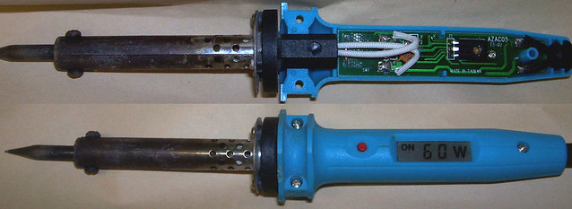

                          Re: time to ditch my $20 25w iron and get sumpin' REAL!!!
                          Originally posted by PCBONEZ
                          Didn't we just go over this 3 days ago?
                          Yes, but I didn't the right information until today.
                          And no, it's not likely 'regulated'.
                          The -adjustment- is probably just a pot where as the base station types use an actual regulator FETs or MOSFETs or something similar that would give off enough heat to melt the handle on that thing.
                          That does not mean it doesn't work well, probably works great, but it just isn't the same class of tool.
                          The information at the company's website indicates it really is temperature controlled, not just power adjustable:
                          "Temperature Setting Range 250-450ºC
                          Temperature Control System Sensor Feedback ( ON-OFF Control)"
                          I think a temperature controller could easily fit in the handle because I have a 10-60W (total power consumption) power adjustable (not temperature regulated) iron with a simple triac controller and digital display:
                          The handle seems thinner than the Goot's, and it stays cool at all power settings. The triac is a 2N6075A (600V, 4A, 10W) that's not fastened to the circuit board (barely touches the copper), so it must not dissipate much (1W max, assuming 2V drop?) The display doesn't show actual power but just selects 10/20/30/40/50/60W (readings agree closely with Kill-A-Watt).
                            That adjustable power scheme is nothing new.
                            I remember the cheap Radioshack irons that were 20 or 40 watt selectable. At 40 watts the element got full wave AC when you flipped the switch to 20 watts it just put a diode in circuit that chopped half of the AC wave off. Simple and effective that's how simple it is to change wattage.
                            To have more steps again the triac circuitry is minimal.
                            Regulating temperature is a more complex issue requiring much more circuitry and is best done with a low voltage DC PWM scheme not a triac at line voltage.
