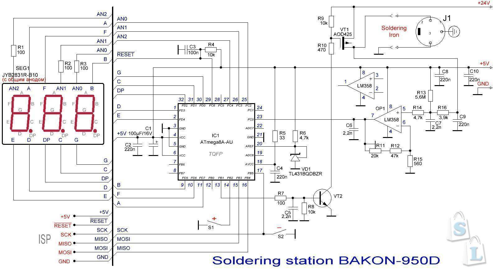

    I have a problem with the Bakon 950d soldering station. It worked for many years without a problem, now it warms up to the set temperature and displays the error S - E. I noticed that the MOSFET AOD425 reaches a very high temperature. Where could be the problem?

    Re: Bakon 950d problem
    There is some information here https://www.badcaps.net/forum/showthread.php?t=66287
    Sensor - Error
    The mosfet controls the element, so it is likely full ON and not turning off due to the sensor error.
      i tried different solder tips, still the same problem.
        The fault seems to be with the seating of the element, not the solder tip.
        Check this video https://www.youtube.com/watch?v=dvzHYdzb0XQ
