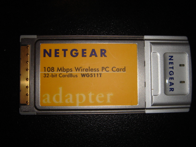

            ...I found this Netgear PCMCIA card in my drawer... It'll do the Wi-Fi job perfectly right?

              well being Netgear
              it may take a while to get the right drivers - they often change chipset and keep the same partnumber.
              but it will work.
              however, there is probably a mini-pci slot in the laptop for an internal modem/wifi
              i'd take a look and see if there is - and if the antenna cables are there.

                As for the WG511t, it is Atheros based, thus very good.

                        It works great! and the Netgear WG511T card is a great combination with it.

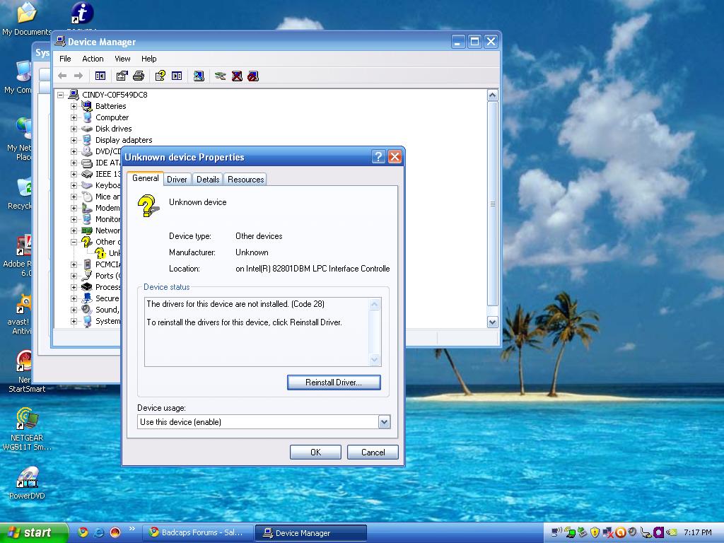

                                      I'm missing this driver for my Tecra and I'm not sure what it is exactly. Even installing the Intel chipset drivers didn't solve it.
                                      So what could this driver be?

                                        Click on the details tab, I need to see the PCI_VEN.

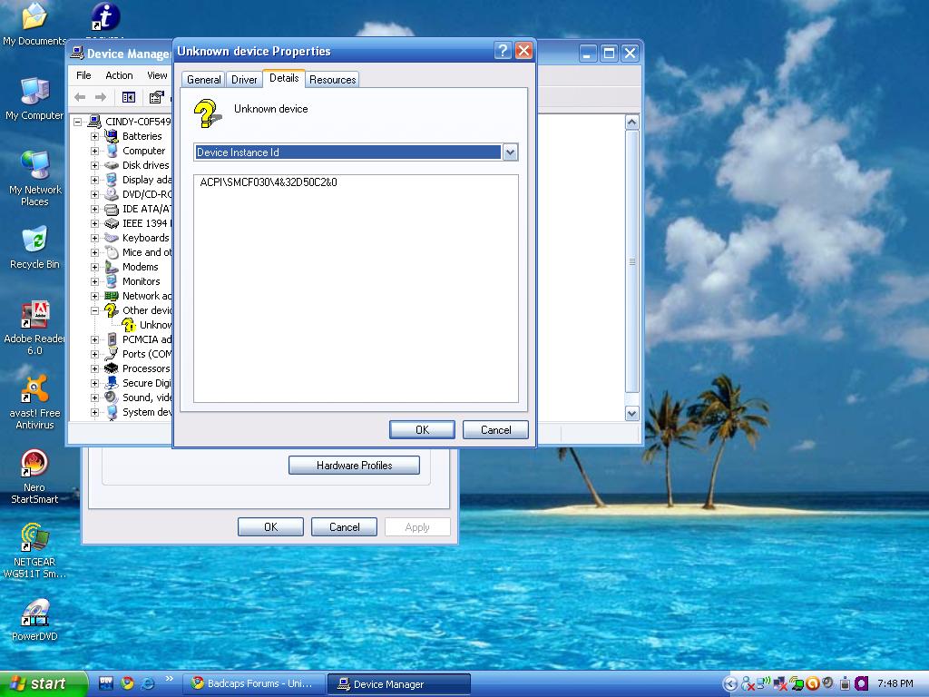

                                          Is this the extra detail you needed?
                                          It says 'ACPI' so I'm thinking it might be a power related driver?
