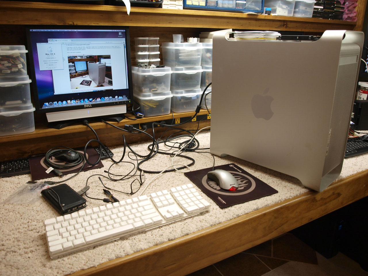

    I was given a G5 PPC dually @ 2GHz, 16gb RAM; model A1117. It had OSX Server 10.4 on it when I got it, no disks. I got it from the original owner. I wanted to remove the server OS and run 10.5.8 on it, the last version of OSX that supported the PPC platform.
    This is the tank in question:
    I pulled the HDD with OSX Server on it, leaving it intact and installed a blank HDD. After seemingly all day hunting, I found the media to install 10.4.2, which is what originally came on this... After updating it, it's now running 10.4.11....and now here's the problem....this system never came out with 10.5, so there's no OEM install media for it....but people are getting it running on these...but I haven't figured out what media they're using to do it.
    The only install media I have for 10.5.8 is what came with an iMac, "Gray label" media, it sends it into a kernel panic when attempting to boot from it (the gray label 10.4 that came with an iMac did the same thing, which is why I had to hunt down a different version of 10.4); the gray label media is intended for only specific models and won't work on all.....so the question is, which of the gazillions of OSX medias do I need to use to get this thing up to 10.5.8?

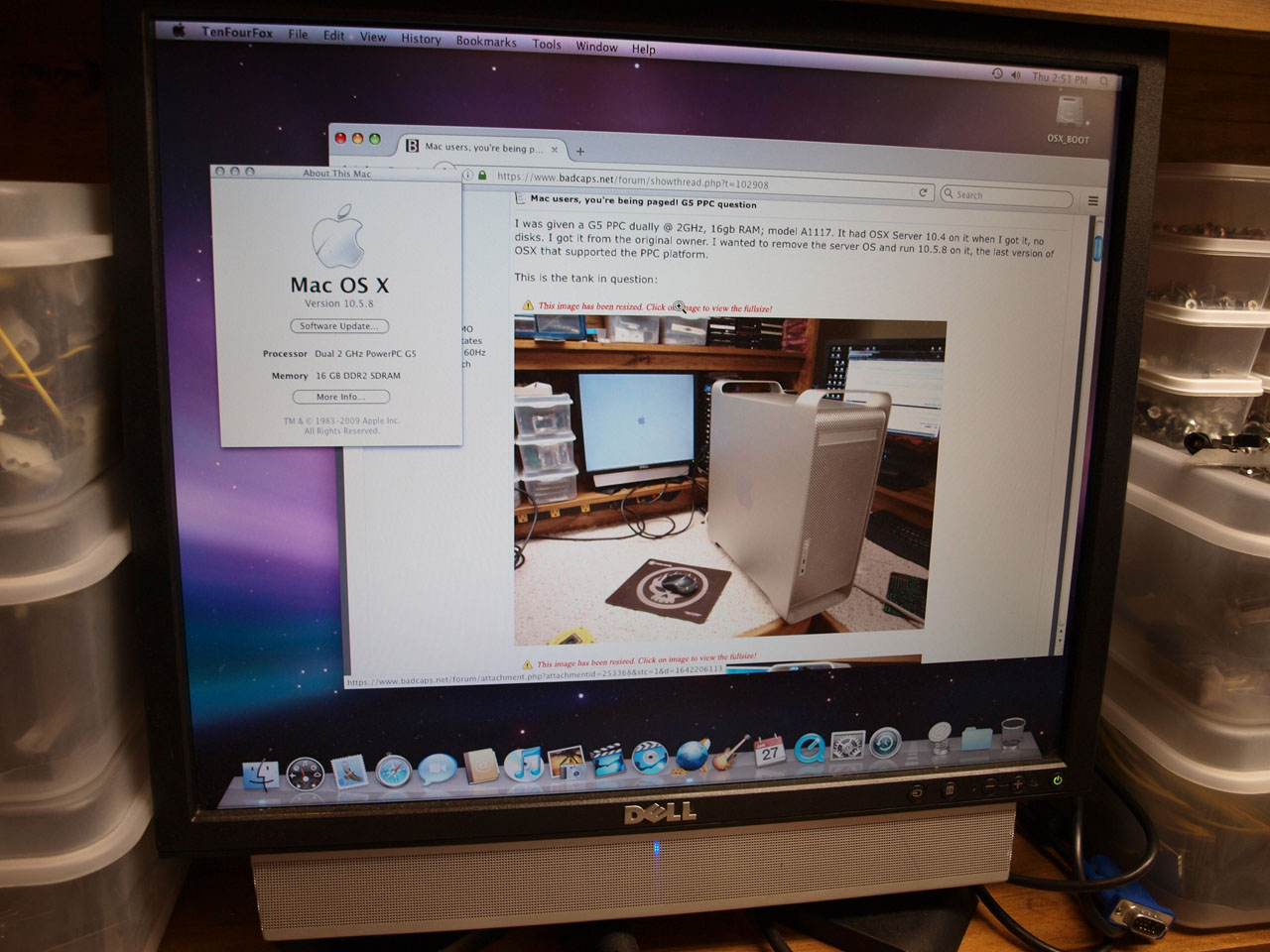

                                Piernov's disc worked. Installed fine and then used the updcombo for 10.5.8...and software update from there.

                                    All is well, this post created from it with tenfourfox v 13 SPR1
