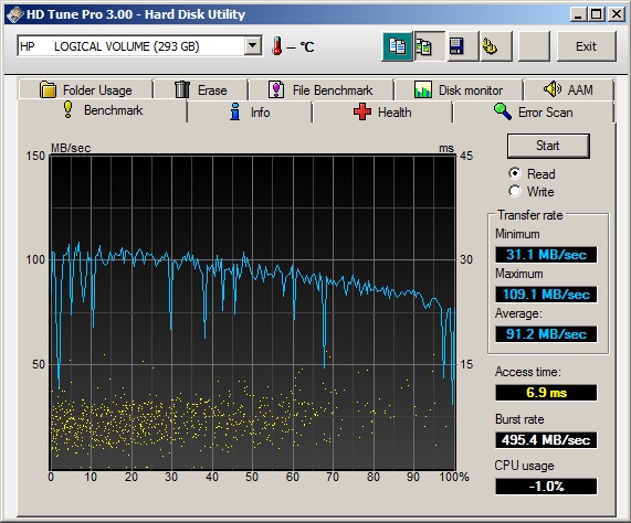

    First up, we have 3 of them in a RAID5 config, with a 256mb cache module upgrade installed:
    Fairly predictable. Nice throughput start to finish, with a little bit of rotational speed loss, and a nice burst to the controller.

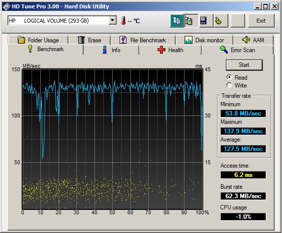

    Next, let's look at 4 of these in RAID10 with no cache upgrade:
    Interesting... Better throughput, but with no rotational loss. Access is a little better, but burst is lacking. (Keep in mind this is same server, just different drive configs)

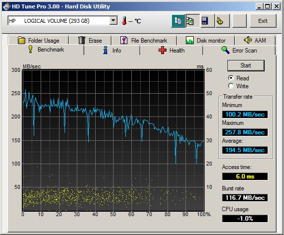

    Okay, so lets give it the beans and throw the 256mb cache in there.
    So, RAID10, 4 drives, 256mb cache installed:
    SWEET JEEBUS! Guess I just found the reason for no rotational loss in the last one... the controller wasn't keeping up with the drives, even at their slowest! So, we have incredible throughput, obvious rotational loss, but an incredible average! Burst rate is still not the same as the RAID5, which confuses me.

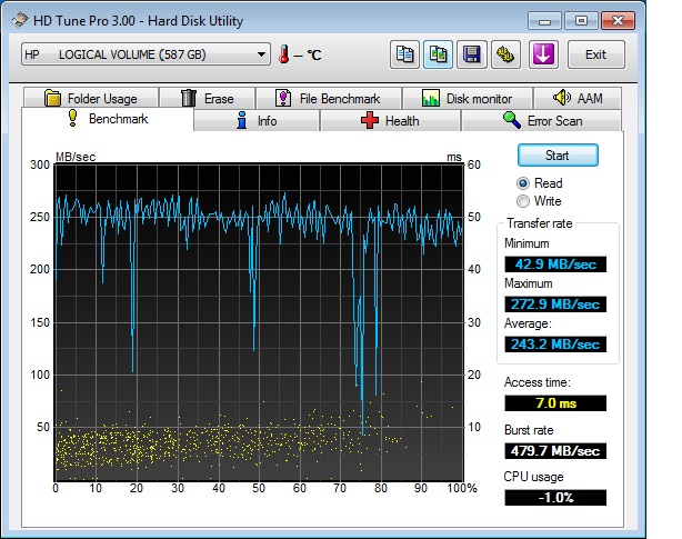

        So, I figured I'd go for broke and reconfigure it in RAID0. I also wanted to see if Windows 7 would run on these (one of the guys here is considering using one as his desktop). So, reconfigured and reinstalled.
        Started up HDTune, and my mouth was wide open when I turned around.
        I think I've hit the upper limit on the RAID controller in this server.
        We'll see when my 4 15k drives come in

          I've done a little research, and supposedly these are 6gbps drives and 6gbps controller... so, I'm not sure why it seems to be topping out at 250-270MBps

            try Linux on it, it probably has better drivers.
