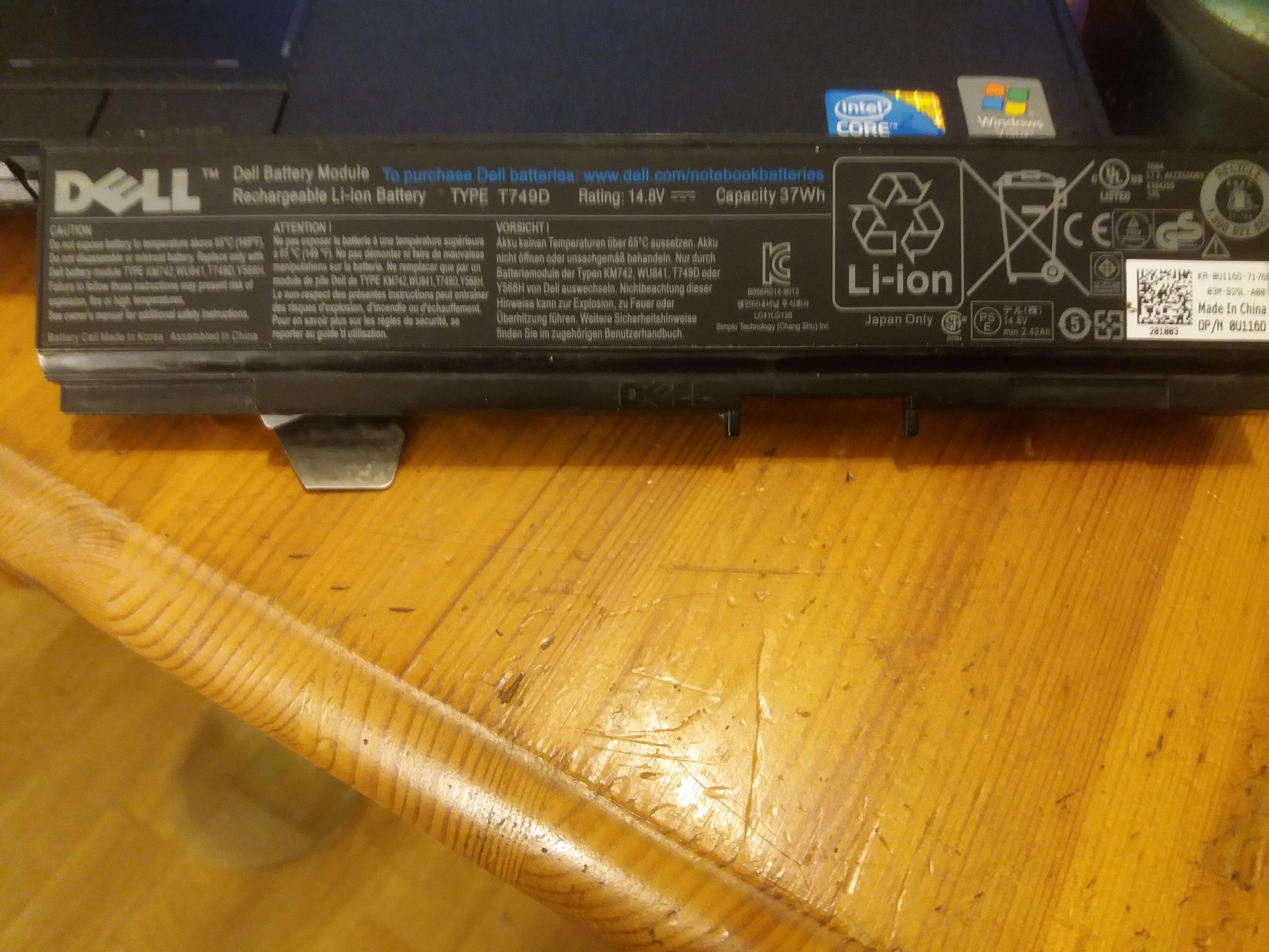

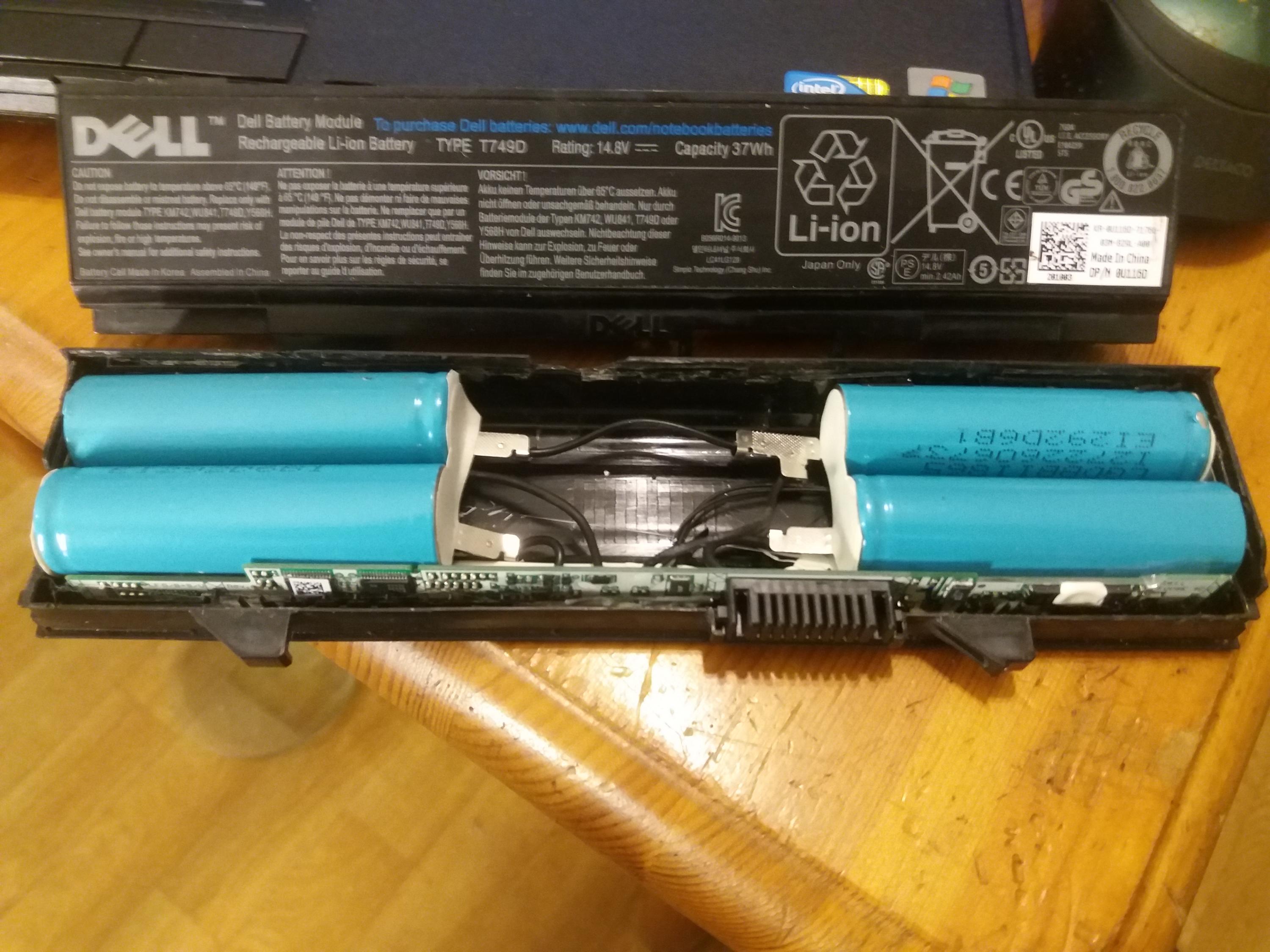

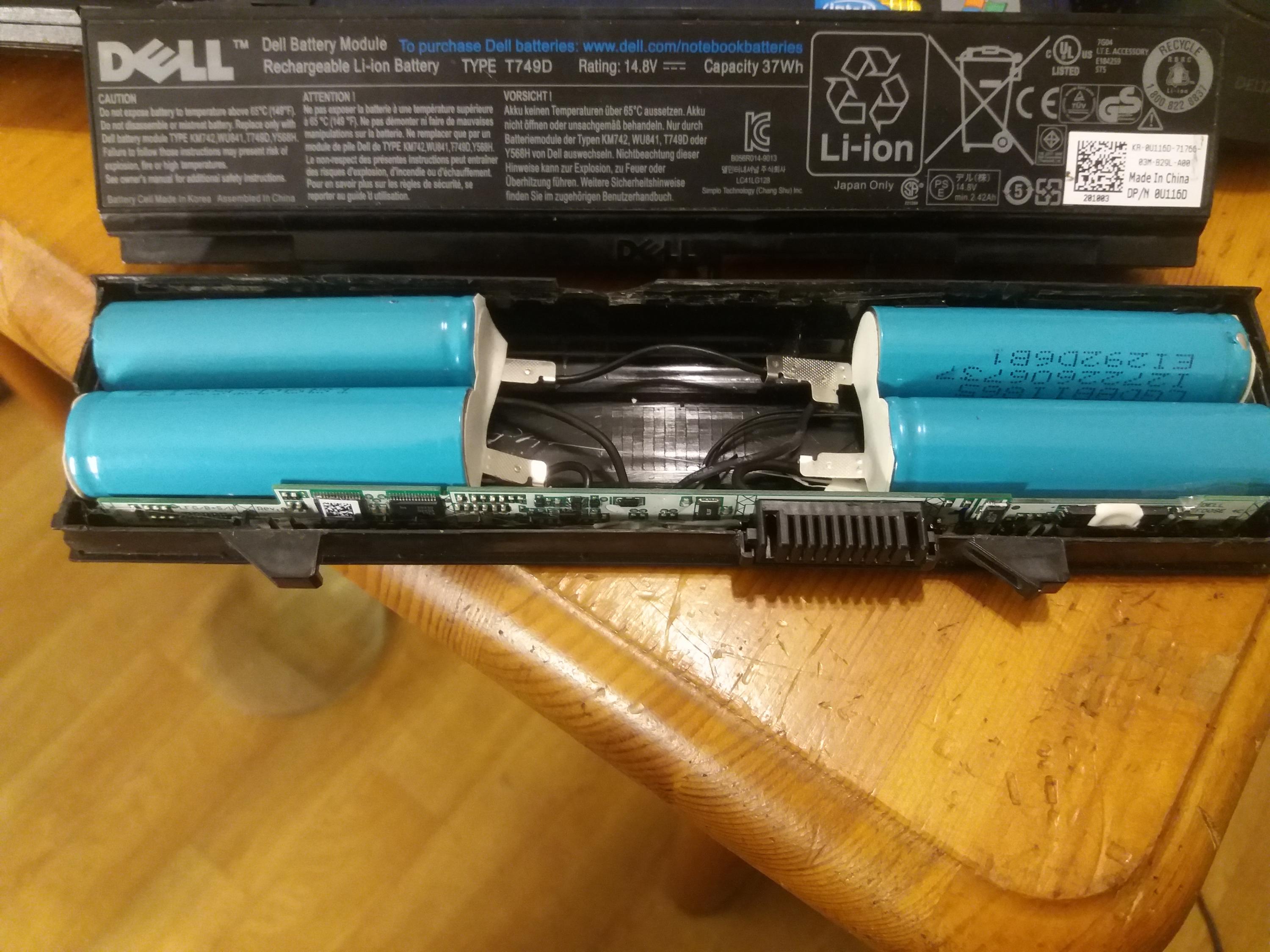

    Hi I opened the battery box for the DELL Latitude E5400 it would contain 6 cells but there were only 4 pieces I was thinking of switching to corresponding parts but I could not identify them not even in google there was some info it is of Type T749D Rating:14.8V and a Capacity 37Wh. here some pictures and hope someone can help
    they have the designation:
    LGDBB11865 in the first row
    I2722606689 in the 2 row and then
    EI292D6B in the last row.
    any help is welcome

    4 cells sounds correct for a 37Wh battery (a 6 cell battery is usually 50-60 Wh), looks like they are using the same case for the 4 and 6 cell batteries though. The cells are 18650 Li-Ion cells made by LG rated at 3.7V 2600mah:
    https://www.reddit.com/r/flashlight/..._this_battery/
    https://wp.geekfun.com/wp-content/bl...ICR18650B1.pdf
