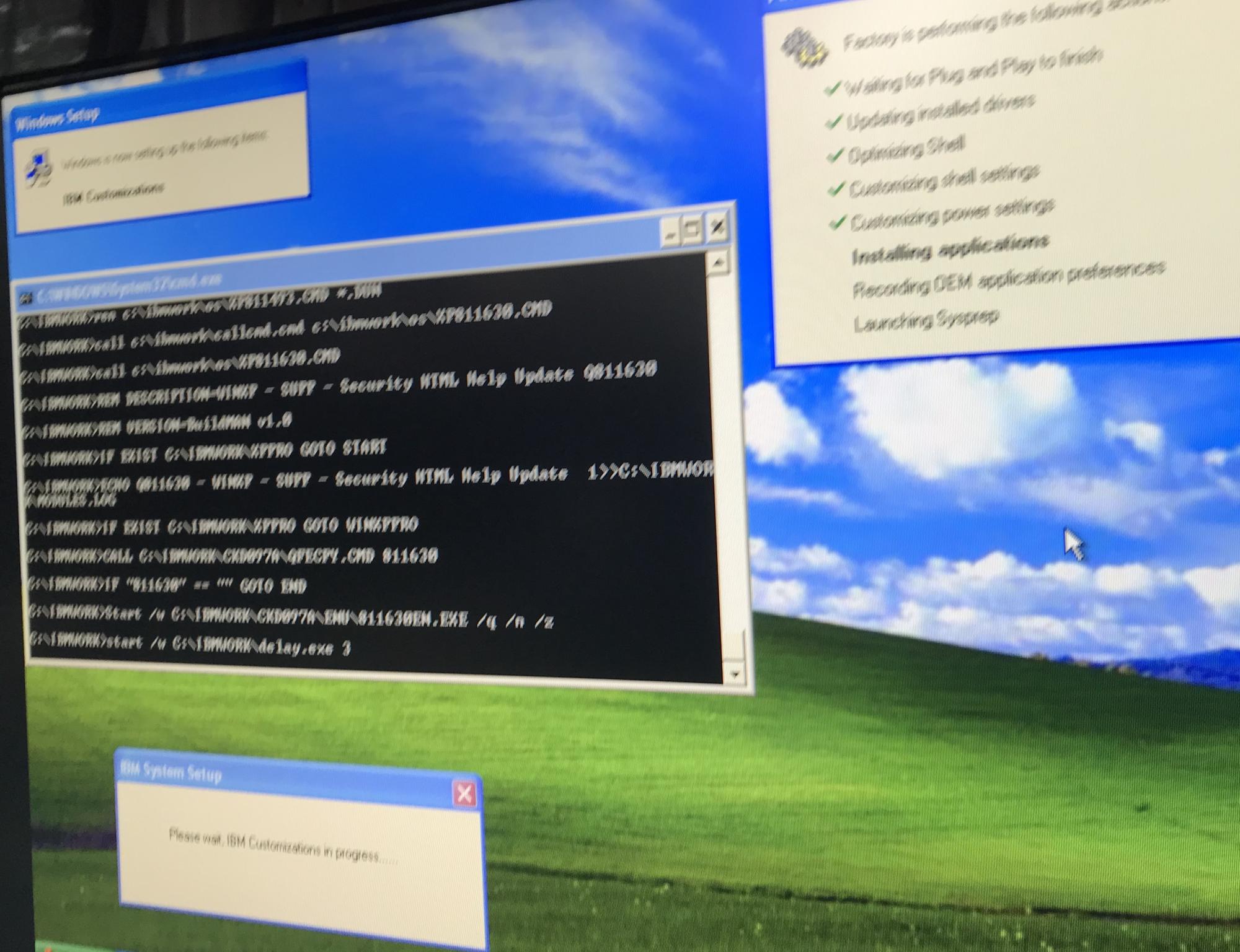

    I found a recovery disk for this computer
    The biggest problem with recovery is there are no instructions on how to do it
    I will give some details on how you do this shortly
    Unless you see this screen with all the pop up come up
    It did not not install correctly

      Here is where I got the the recovery disk from
      https://restorecd4u.com/
      Like I said earlier there are no instruction on how to use this recovery disk
      The fist thing you have to do is use the dos command to remove all partitions from the drive and once it has copy all the files then remove the recovery disk before it restarts ( there is no message to do this ) then you see it copy the files from drive D to drive C
      Then It will reboot a few time and the begin to load Windows
      If you do not see the window pop ups then it did not install correctly
      It was well worth the $18.00 that I spend on this Recovery Disk

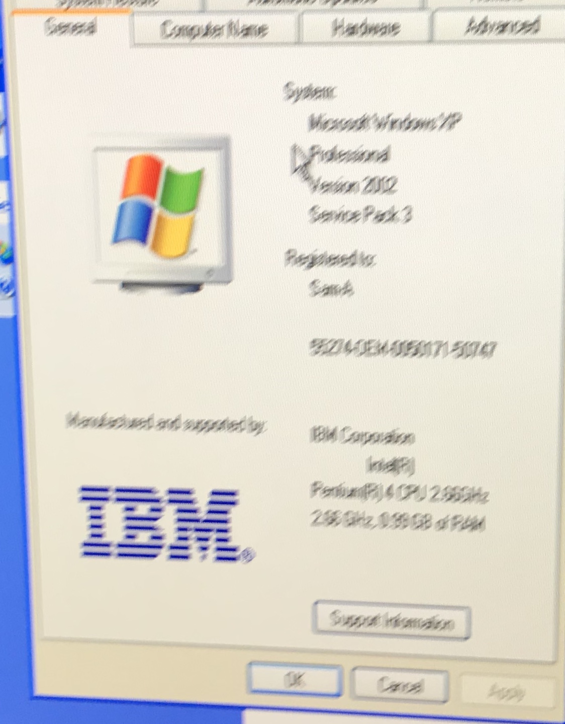

          No it is a Recovery Disk but not what I am use to
          This one work completely differently
          The problem I was having was I had used this drive before it had Windows XP Pro on it already
          You really need to format the drive but I did not want wait the 8 hour that it said it was going to take so it would not load correctly
          because it is a DOS based windows 98 format because once it loads all the files and it boot to windows it changes the fat32 files to NTSF file format
          In fact I am using this computer to reply to this post
          I have service pack 3 installed and using My Pal Moon browser which works pretty good

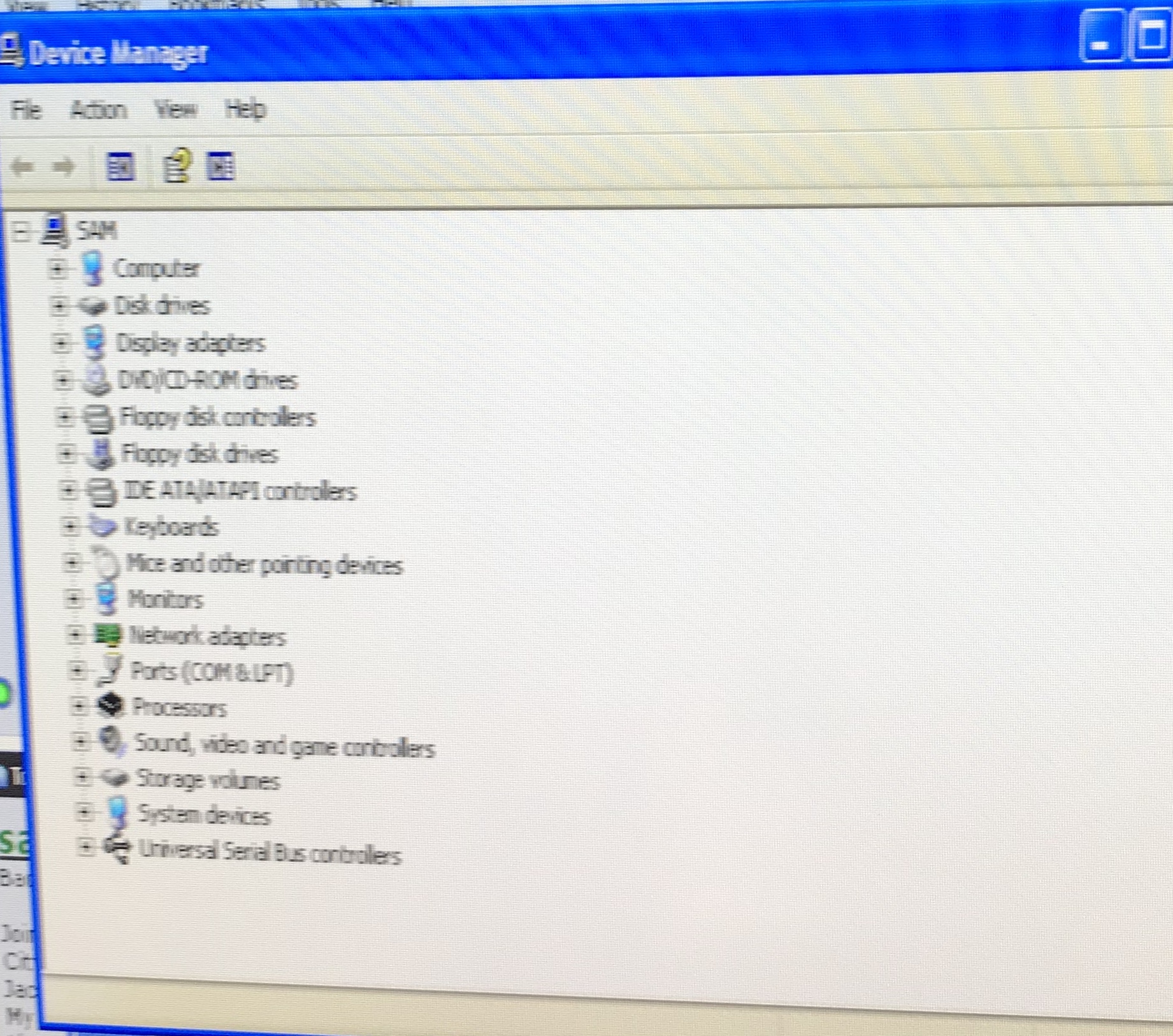

                                        • Jul 2011
                                        • 6057
                                        Re: I found a recovery disk for a IBM 8183 : A50
                                        Unable to find the system drivers for this computer system
