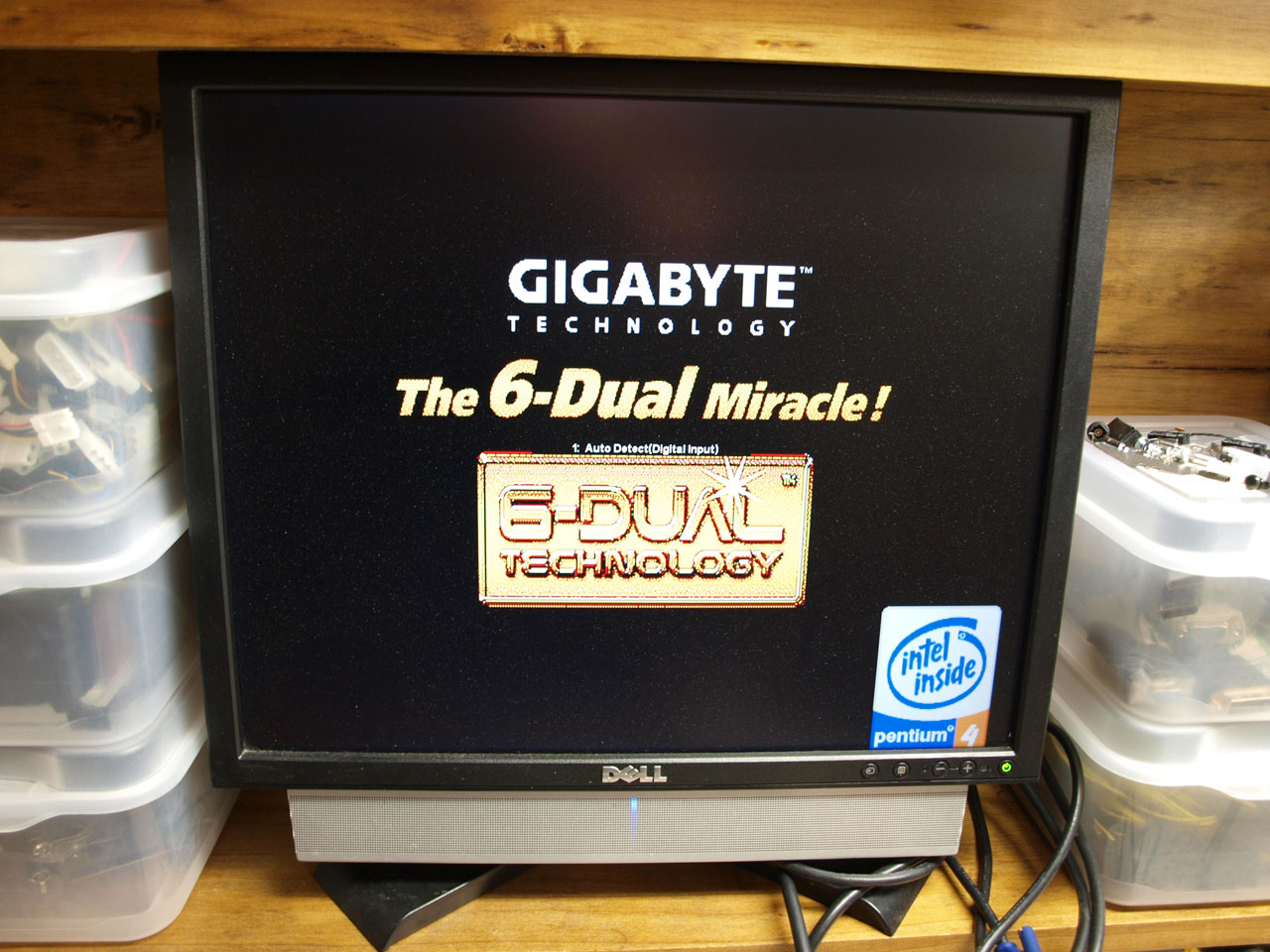

            Today's dropoff was a Gateway ESX-500X, complete with tower, monitor, KB & mouse, and the manuals.
            The GPU appears to be a LeadTek GeForce 6800 128mb. The heatsink on this thing is a solid copper monster!
            It would not POST....this is why. Piece of junk power supply someone added. The brand name on it is "COLORSIT", I've never heard of it. The original obviously went bad, hence this....
            Has an 'alienware-ish' look with the fold-up door....kind of neat actually.
            The rest of it...
            The motehrboard is bad, partially. Caps are ok. NIC doesn't work, and it's not stable for some reason. RAM and GPU have been tested in another board, they're fine. The board is an Intel OEM; 845G/GL with a P4 @ 2.66/533 in it. I'll do a freebie resto on this, I have an Intel D865GLC which works, full featured BIOS, has 2gb RAM + P4 3GHz/800 Prescott in it, and best of all it fits the IO area of this case. The IO area of this case is not removable.....and I just don't want to cut this one out..... The untrained eye would never know this isn't the original board anyway.....ohh, and it came with an upgraded Audigy sound card....

              Colorsit PSU... I remember seeing the innards of one from Shroomie.
              IIRC their OEM was supposedly "Unitek Electronic Co.", but from what the PCB looked like, I'd go towards HEC being the OEM.
              A recap and some spare parts to complete the filtering and it should be good for 250W, if the heatsinks aren't absolute garbage, I guess.

                    Super!
                    I saved one of those as well. It really is a neat-looking machine, like you said. IDK why, but I too agree that the case definitely looks "classy" with the front door closed.
                    And you got all of the original hardware and peripherals?! That's awesome!
                    Looks like top-of-the-line build too, with that 2.66 GHz P4. IIRC, that's one of the highest 533 MHz FSB CPUs this motherboard supports. Mine only came with a 2 GHz P4, but I swapped it for a 2.66 GHz from my ECS P4VXASD2+, which can also do 533 MHz FSB with Northwood cores only... but being a cheapo ECS mobo with a single-ended VRM that powers the CPU from the 5V rail, it ran miserably hot around the CPU. So giving it the 2 GHz from the Gateway seemed more appropriate, even if the difference in TDP is only 10-15 Watts.
                    Funny. Mine also came with an extra NIC inside, which suggests the original one was giving problems. However, when testing that, I found it to be OK. What I found was NOT OK were the caps around the CPU. Mine came with Nichicon HM from the defective period. None looked bad, but all were showing out-of-tolerance capacitance. Replacing those got the board stable and onboard NIC working too. I see your board has KZG caps (likely 6.3V, 3300 uF ones?) If so, I suspect they may be bad or on the way out... hence the stability issues. Or it could be some of the small caps elsewhere on the board. But of course, IDK if it's worth doing that kind of work on such old board. Perhaps in a decade from now when AGP systems get even more rare, it might be? I say, stash it somewhere for a decade... and if anything has changed, fix and sell it then... or dispose of it then. These motherboards are nothing special indeed, since they can only do 400 & 533 MHz FSB with Willamate or Northwood CPUs. But they are made by Intel and quite well-made too.

                    That's probably one of the top-10 best AGP GPUs out there, if not top 5. This one alone is at least $50 on eBay (selling prices, not bogus asking prices) - your's probably more with that cool heatsink and not some stock crap.
                    https://www.badcaps.net/forum/attach...1&d=1645491409
                    Could they make the ATX power cable any shorter on that PSU?
                    At least mine came with the original PSU - still in working condition too. It's a 200 Watt Delta, IIRC, and not a whole lot of Amps on the 12V rail (maybe 10A or so.) I caught mine just as the 5VSB "critical" cap was starting to go high ESR, but not failed yet. The 5VSB was within spec, but I imagine it wouldn't have been for long. I replaced only that cap and it's on my to-do list to recap the rest of the PSU. It's full of Ltec, though none are bad it looks like. The older Ltec seem to do better in the older Delta PSUs. The one thing that worried/worries me the most about that PSU is the 12V rail rectifier - only a 12 Amp part, IIRC. Not sure how they (Delta) are rating the 12V rail for 10 Amps with that, given the PSU is a single-transistor forward design. But hey, it took my 2.66 GHz CPU just fine. In fact, remember those old full-height HDDs I sent you last year? I formatted those on this machine, along with all of the other SCSI stuff. It's a nice solid machine overall.
                    Thus, upgrading the 12V rectifier on my PSU is another item on my to-do list for it, as I plan on restoring the whole PC too.
                    Now it makes me curious: what kind of rectifier(s) that ColorsIt PSU has on the output.
