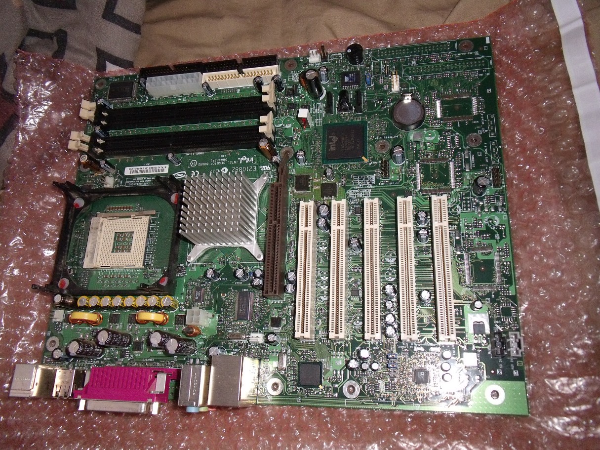

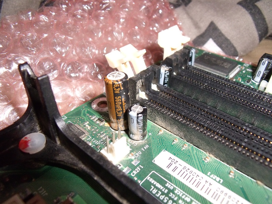

    Does anyone know whare i can find 2 of these caps the big orange one.
    Intel D865PERL Socket 478 Motherboard.

    talk to topcat you need 6.3v (or higher) 560uf caps. must be 560uf since thats the marked value. samxon will work fine or go rubycon if you want the absolute best. since you are in between memory chips, id pay more and get rubycon since it can get hot there
    ps, try to get the physical size right as well. get out a ruler/tape measure and measure in mm of both diameter and height.
    pps. any other nichicon hm/hn on there/ replace any of those as well since those were a bad model. brand on yellow caps?

      talk to topcat if you are in the usa/canada. you need 6.3v (or higher) 560uf caps. must be 560uf since thats the marked value.
      if not, get samxons from big pope or go to digikey for panasonics (pannys). the board will love you for it
      pps. make sure the the caps are low esr or ultra low esr
      ppps. any other nichicon hm/hn on there/ replace any of those as well since those were a bad model. brand on yellow caps?

                                  You can buy compatible replacements from here, ebay, or at Mouser.com
                                  The caps with the "X" vent and black sleeves/gold stripes are probably Nichicon HN. If you buy caps from here, make sure to mention that to Topcat so he can give you compatible low-esr caps. Or if you buy from ebay, look for Rubycon MCZ or Nichicon HZ as those should be compatible as well. Otherwise you can buy the same Nichicon HN caps from Mouser - and don't worry, it's unlikely that they will fail. Reason why is because Nichicon HN and HM had problems with caps made before 2005, but are okay since then. I doubt Mouser will sell you old caps.
                                  Also, check the brand/model of other caps with "X" vents and black sleeves/gray stripes near the PCI slots. If they are Nichicon HM, they might need replacing too (just look for a 4 digit date code on them where the first 2 numbers represent the year - if it's 04 or less, they can be bad). Anything under 470uF, however, doesn't need to be replaced unless the motherboard's problems still persist.
                                      Fujitsu polymers
                                      Good brand
                                      to the left of them is another nichicon, as well as those UCC's look like KZE's from what I could see, those may be from the defective series, maybe not.

                                        I think only KZG (and possibly KZJ) had heat-related problems. KZE uses different electrolyte and their ESR isn't as low as KZG and KZJ.
                                        On Phaihn's board, the KZG caps seem to be on the high-side of VRM so they probably aren't as stressed as the Fujitsu caps on the low-side of VRM.
