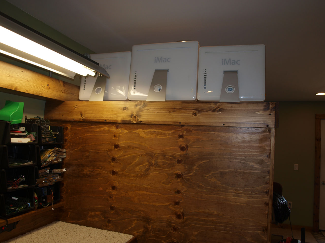

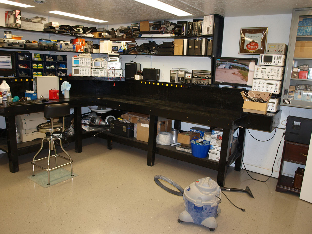

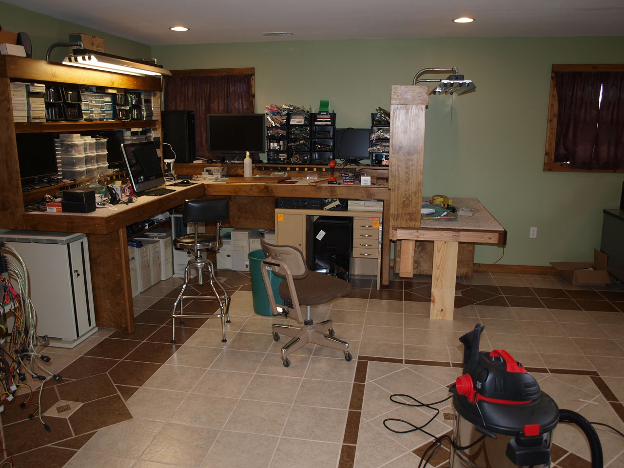

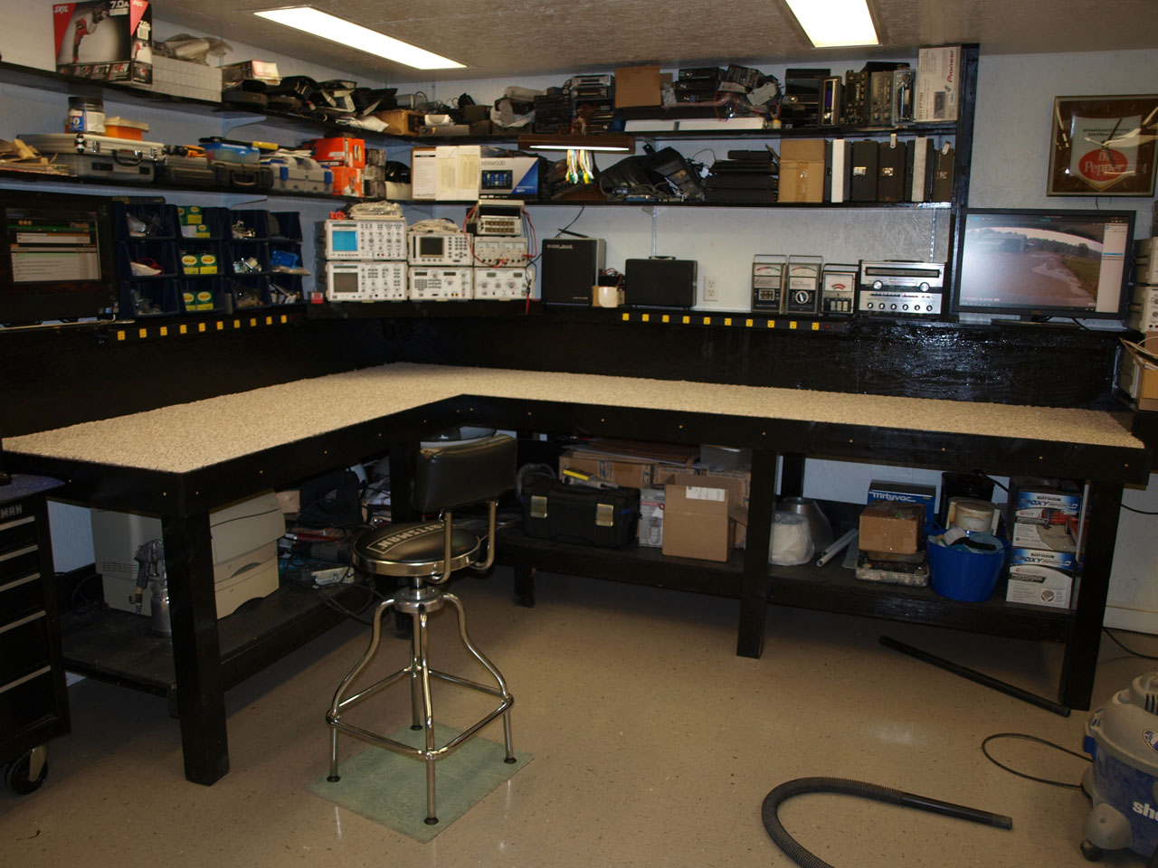

              As I started to lay out a design in my brain of this 'new bench', it dawned on me that I already had one.
              This bench was originally built for automotive type work before I built the room around it...
              This pic is circa 2010, right as I started the remodel. The room literally was built around the bench. It had to be moved out of the way several times....needing the efforts of 3 mules and a crane it seemed... I built the bench when I bought the property in 2005.
              Once the remodel was done, I built a bnech system out in the big garage portion of the building, and this bench pretty much got used for a catch-all....and it dawned on me....what better could one want! It's located deep in the bowels of the building, few have seen. It's heated & cooled. Awesome lighting.....WTF, so yea, I cleaned all the junk off and the backboard shelf.
              Once that was done, I made a corner piece for an equipment rack. No matter which side of the "L" I'm working on, leads & probes can reach.
              I still have a ways to go....but yea... It's amazing how sometimes we forget what we have.
              More as this develops.

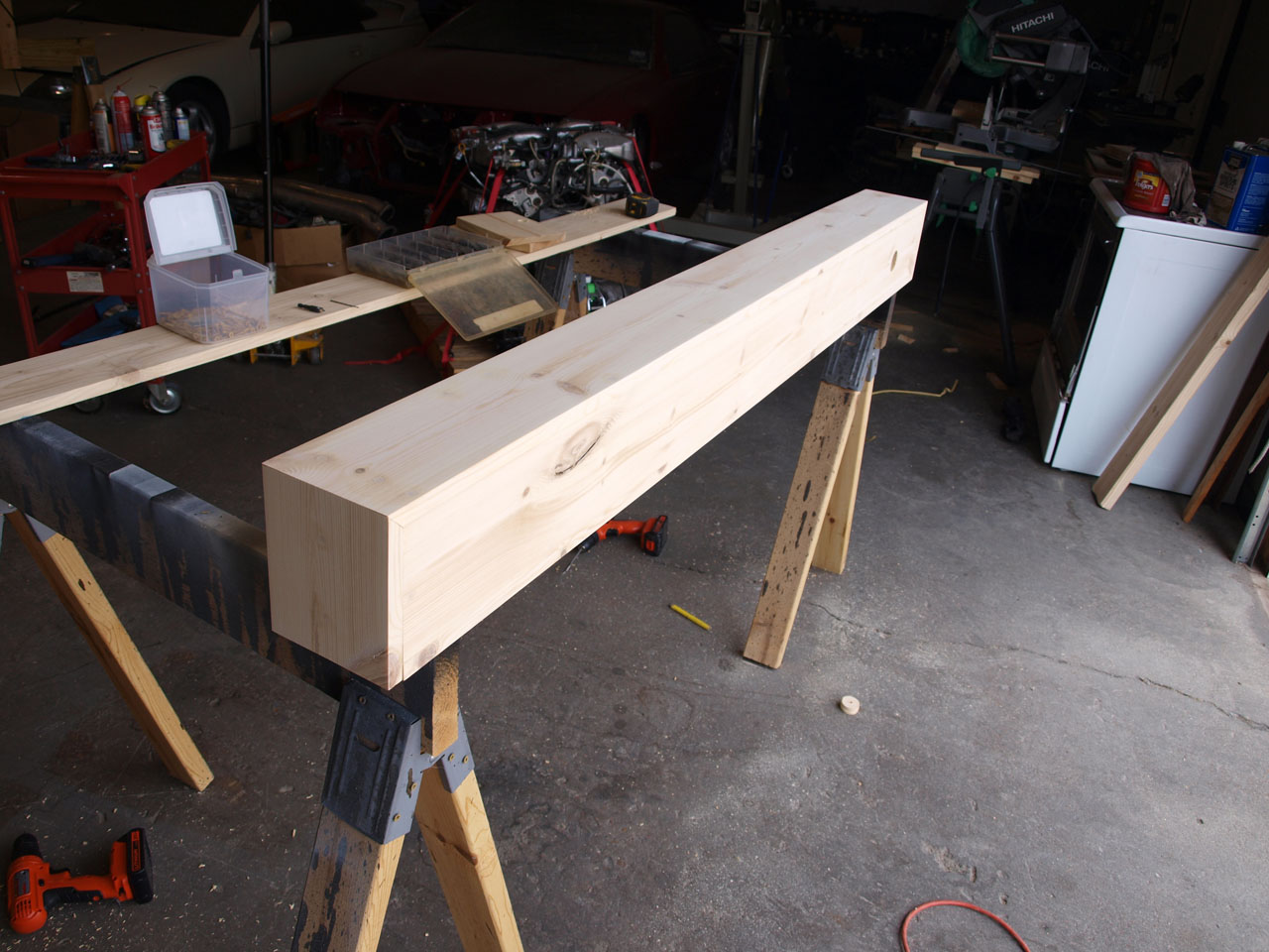

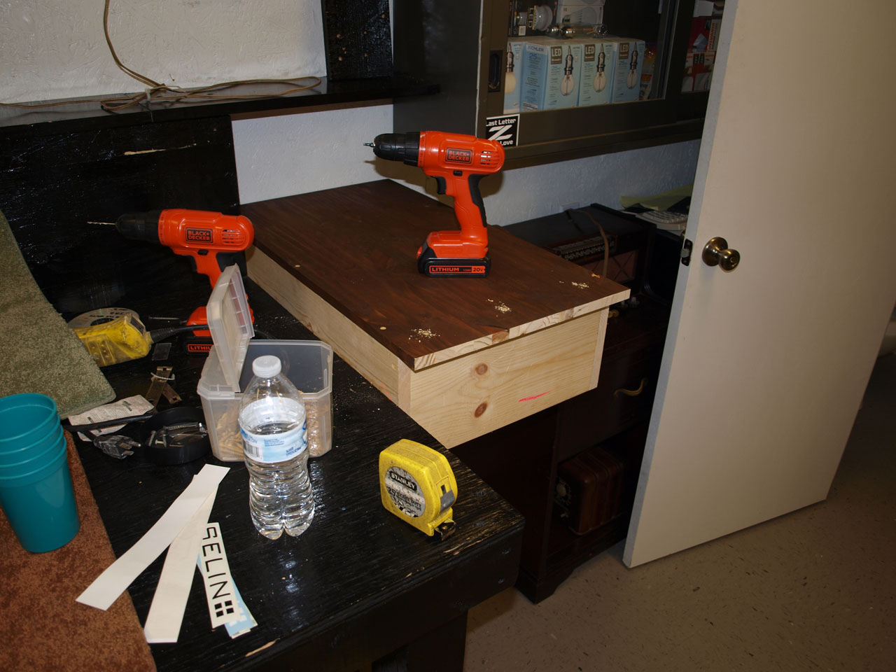

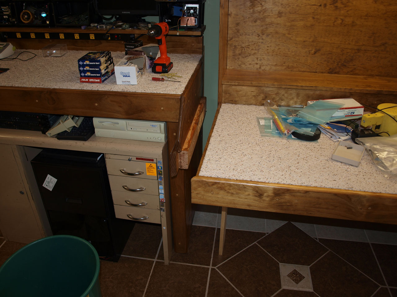

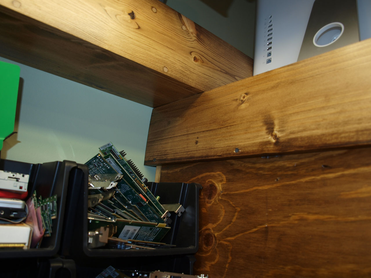

                Ok, made some headway this weekend....starting with extending a stack rack on the right side of the bench, for more equipment or whatever....its raised about 4" above the bench work surface.
                The old plastic storage drawers removed, as well as the backboard end cap.
                After 15 years, I finally repaired the light in this clock. Every single lighting component was bad.....bulb, ballast, and starter. I also added a pull chain switch so the light doesn't have to be on all the time...
                Ok, back on track....stacked a few things in the center corner shelf....to get it out of the way for now.
                Now test fitting the shelf surface. This stained board was something my wife was using for crafts that she mis-measured and was too narrow for her project....... We don't waste around this place!!
                Test fitting the frame.
                The top cut down to size.
                Bottom bracket added.
                Painted.
                Installed. Yea, I know it looks a little out of place, but there's more to come that will be under and to the right of it (under the glass door cabinet). This just had to be done to complete the workbench itself
                Now for the front & side edge rails that will create a track 1/4" deep on the bench surface....for carpet to sit in and not move around. I use a commercial anti-static berber carpet. I haven't zapped one yet.
                Test fitting. These are 1x6's, so obviously they'll have to be run through the table saw....
                Installed.
                ...and here we are as of last night. I have done a little more rearranging & relocating....but nothing that needed pics taken...
                More to come.

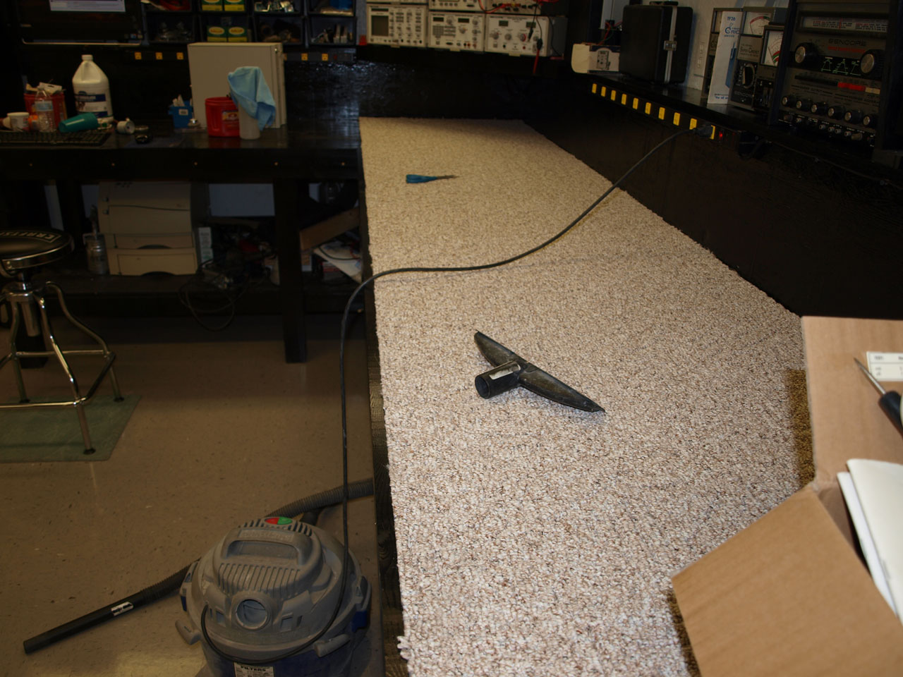

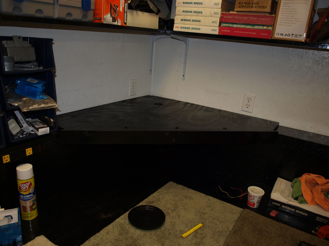

                            Today wrapped up the modification to this bench with a trip to the local carpet store to see what they had.....nice remnant roll of commercial anti-static berber carpeting!!
                            getting the long side cleaned off:
                            Cut & fitted. I only had to do minor trimming after cutting for a nice snug fit.
                            ...and now for the smaller section....this piece didn't even need any trimming. I cut it and it laid in there perfectly!!
                            The seam, with no carpet tape under it, it fit that nicely!!
                            Done!
                            That concludes this part of this project....but fear not, there's a little more to come.

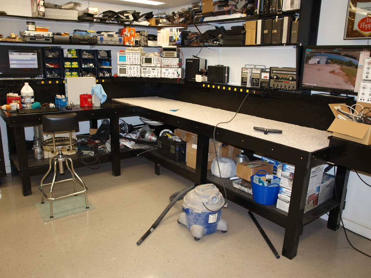

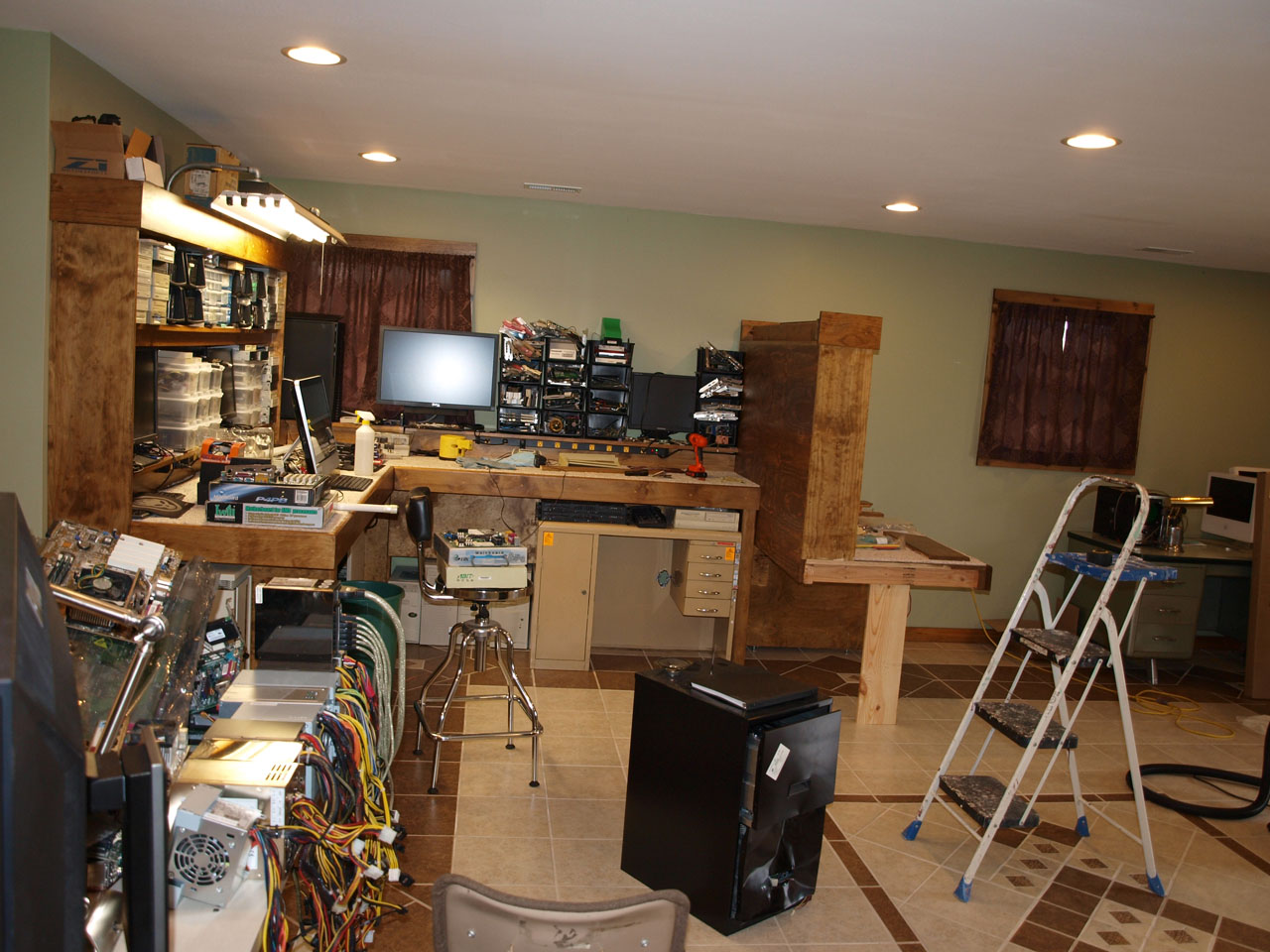

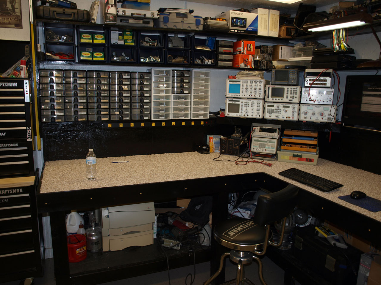

                                    Today's task was moving all the component-level equipment from the front office to the back workroom. I have some other ideas for that smaller section of this bench....but for now it's empty..... I also have some other ideas and uses in mind for the front office...it will never stop being my office & PC benches...but in time I'll expand a few things.
                                    Things are starting to take shape.
                                    All those damn capacitor bins moved....and of course adjusted to fit the way they needed to.
                                    The other end....
                                    I only connected the essentials....the two vectorscopes (left column, bottom device and middle column, top device) are just decorations....I don't really see them ever being used again. All the rest is up & running.
                                    I pulled a lot of junk from the upper shelves. There was a plastic case (visible in the upper left corner) with a brand new Dremel 4200 kit. I don't even know where it came from....
                                    More later.

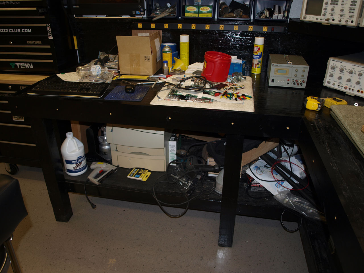

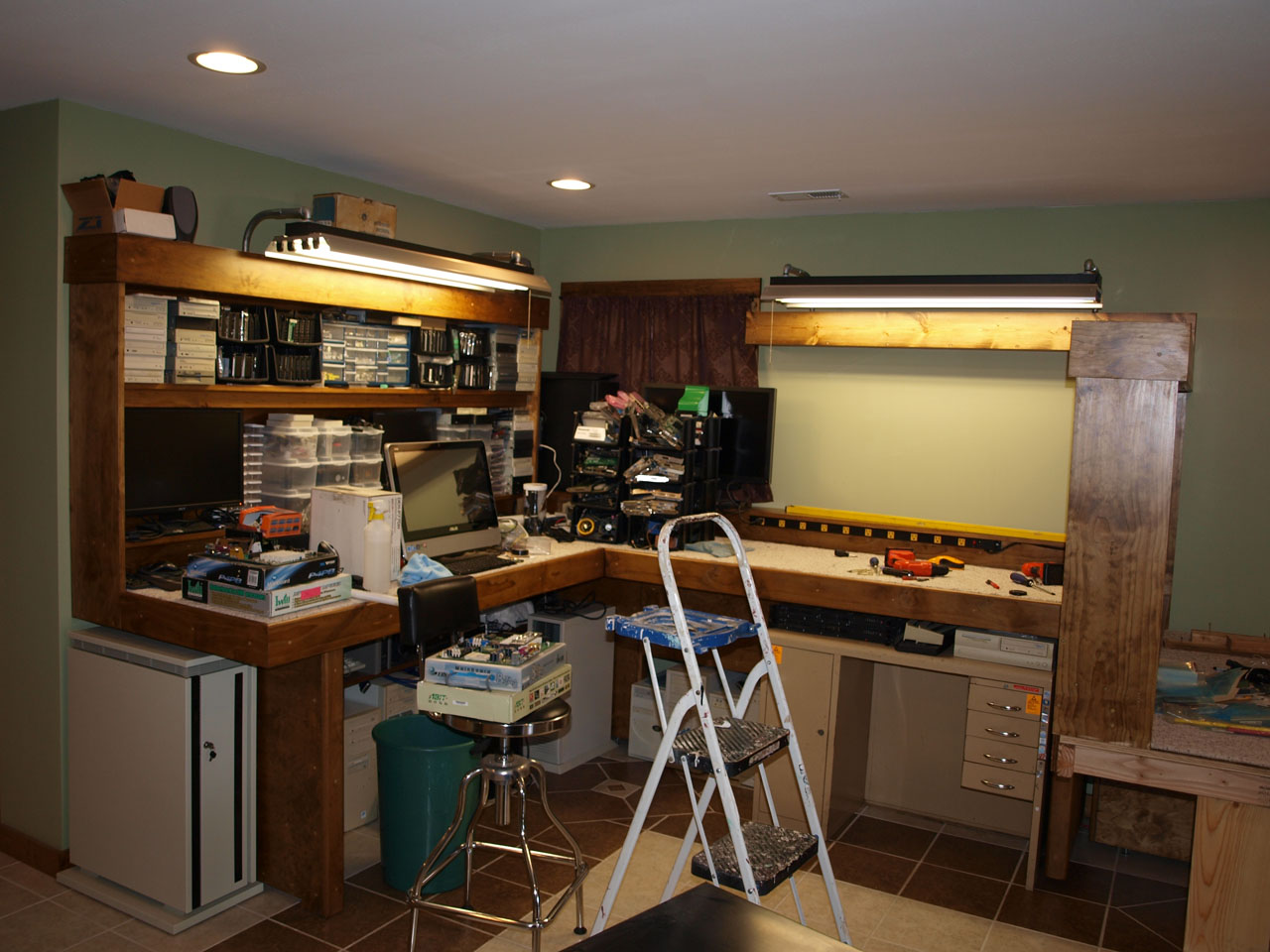

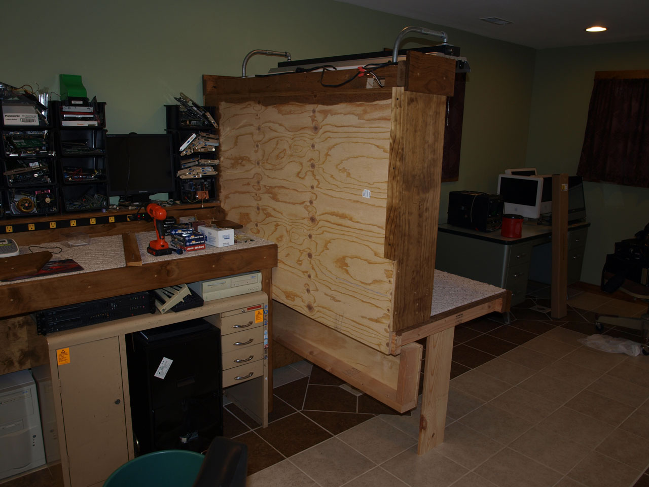

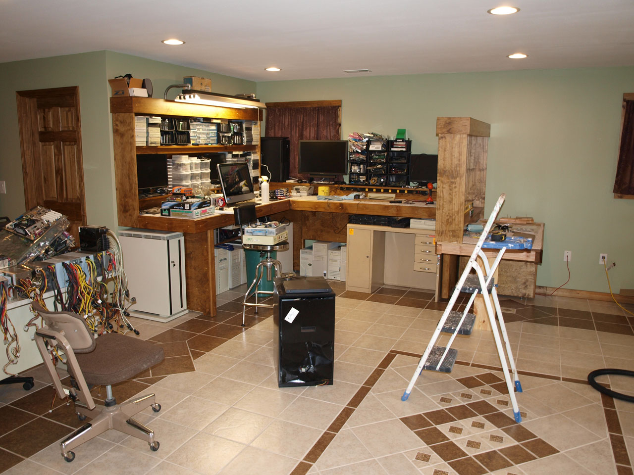

                                      More fun continued.... The service bench in my office now needed a little reconfiguring.....since no more component level stuff (messy stuff) will be done in here....this bench is strictly for clean stuff.
                                      The lower table height portion of the bench separated.
                                      Back unfinished....didn't think I'd ever had a need for it to be finished.....times change. Standing on a temporary leg on one side.
                                      The old mounts & trim.
                                      All that stuff removed.
                                      Mockup of the plan.....
                                      Boy what the hell did I get myself into!!

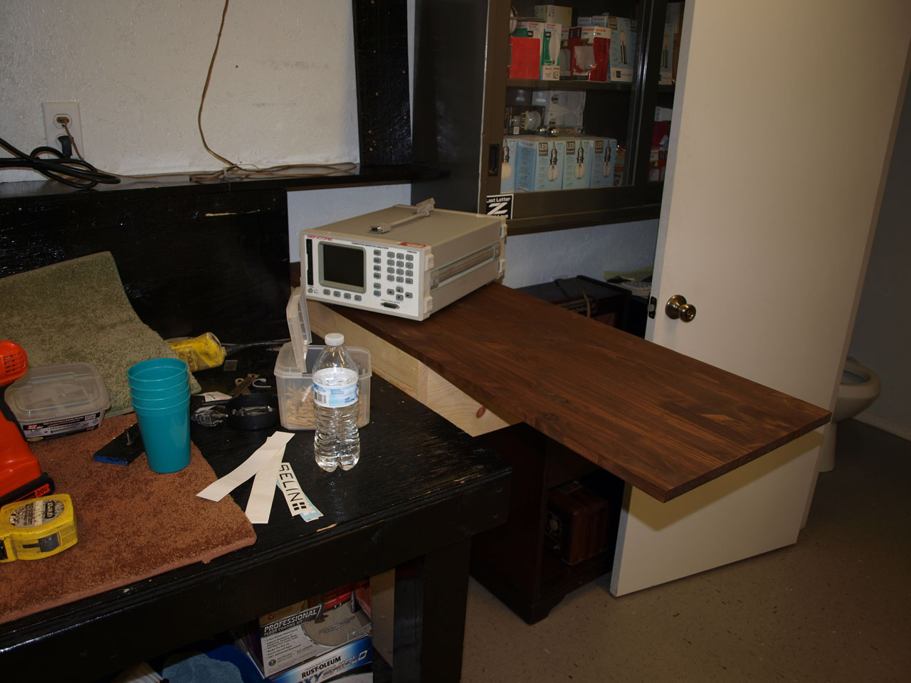

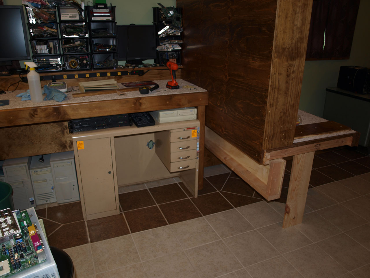

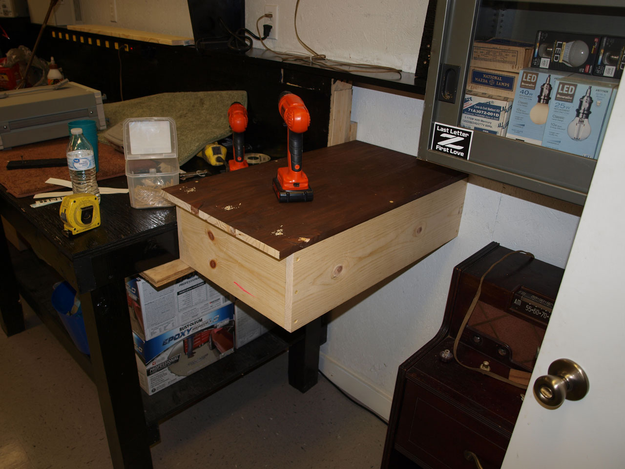

                                        • Oct 2003
                                        • 16958
                                        #59
                                        Re: Topcat's Dream Service Bench Reborn!
                                        Now we get down to the nitty gritty!! Tarp laid out since I'm not about to pack this heavy bastard out to the garage to do the finish work on it.
                                        Here comes the stain...
                                        Stained.

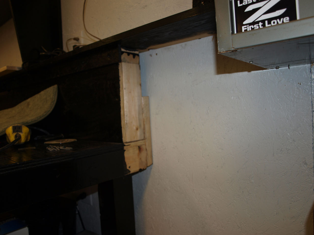

                                        Top coat applied and mountings drilled. This is being held in place by 3x 3/8" carriage bolts....
                                        That part done.
                                        Making final leveling adjustments, and tightened the nuts down. It's solid enough I could remove the temporary leg and it would stand solid.....but I didn't want to stress anything....so it'll stay a bit longer.
                                        Light removed.
                                        Back kick board removed, as for the new layout it won't be needed anymore.
                                        The brace on the right side was attached from inside the leg....I wasn't about to take the leg apart, that would have been a huge headache....so a wonderbar & hammer, I pulled it loose leaving a few screws sticking out... I used a dremel with a cutoff wheel and zipped them off then an awl to punch them down inside the leg for eternity.
                                        Sanded & stained to match. I'm not too worried about the match, when this is all done it'll never really be seen.
                                        ...and that stage done...

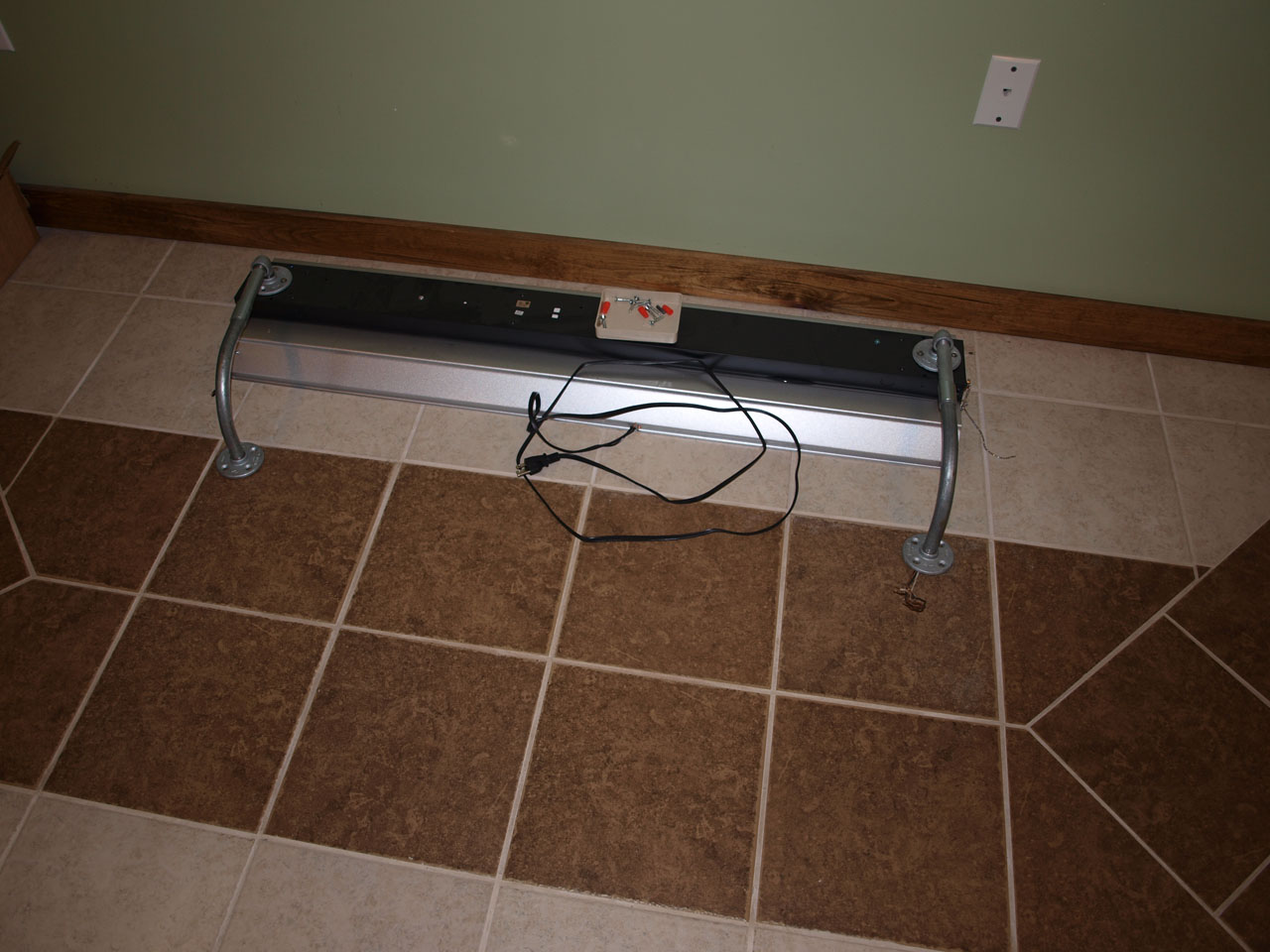

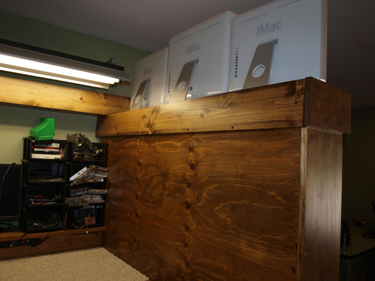

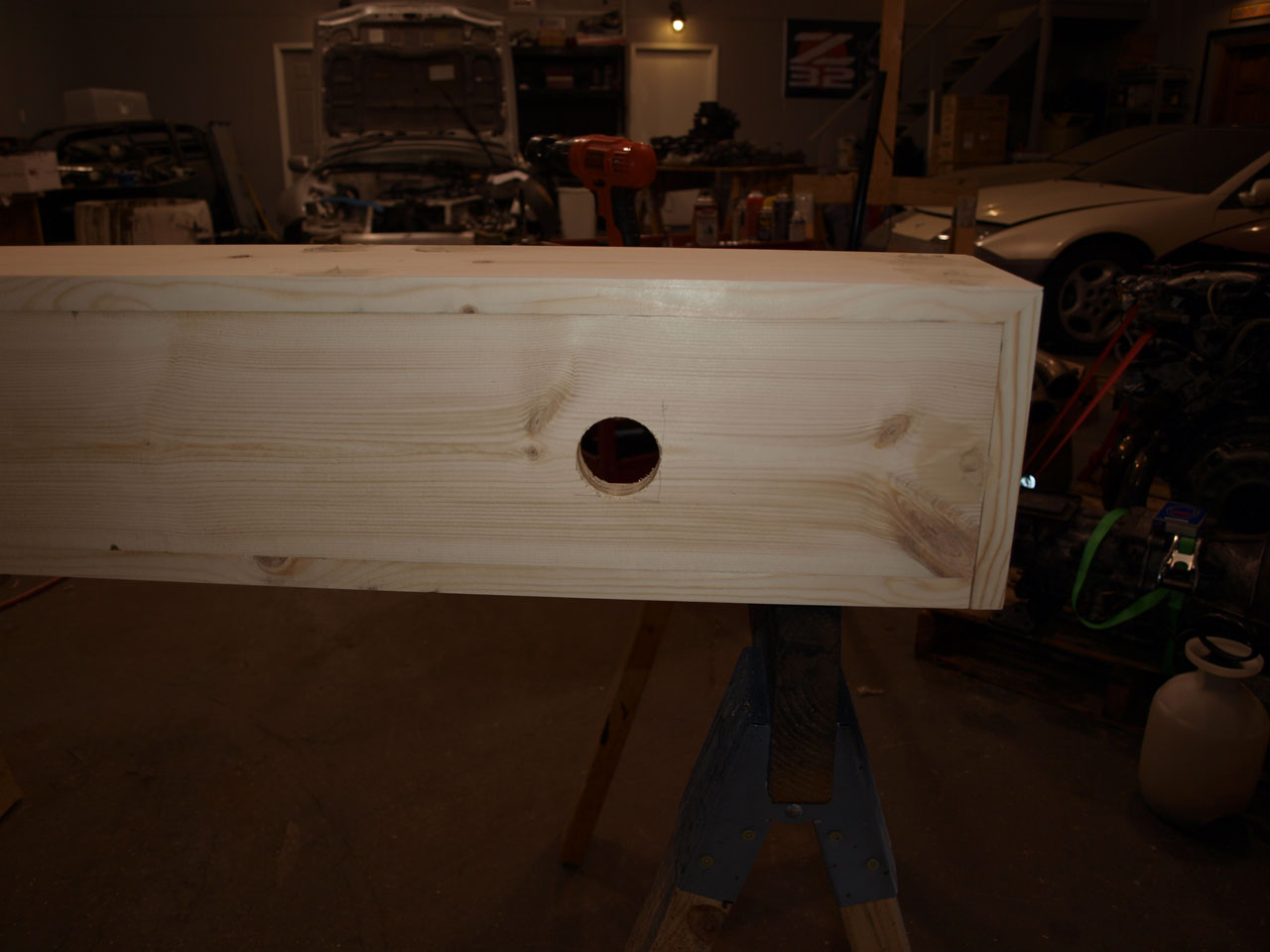

                                          The next step in this bench's reconfiguration....relocation of the light.
                                          Had to carve a channel for the light cord to run through. Nothing annoys me more than wires showing when they shouldn't be.
                                          Carved the other side flush as well....I'll come back to this later.
                                          New head piece made...where ohh where is this going to mount....
                                          Mounts for light.
                                          Sanded.
                                          Stained.
                                          Topcoated.
                                          ...and here's where it's going to mount...
                                          3x 5" 3/16 lag bolts into the studs later, adjusted, and level!
                                          Light installed.
                                          Not bad!
                                          Now back to this unsightly mess.....
                                          Nothing a piece of scrap board wouldn't cure!! I didn't bother to make that outside corner perfect (didn't 45* it).....it really won't be seen by anyone but me. Making it perfect would have meant removing the entire head piece from the bench.....wasn't worth the effort.
                                          It still looks damn skippy good!!
                                          Not bad!! ...and to be continued!
