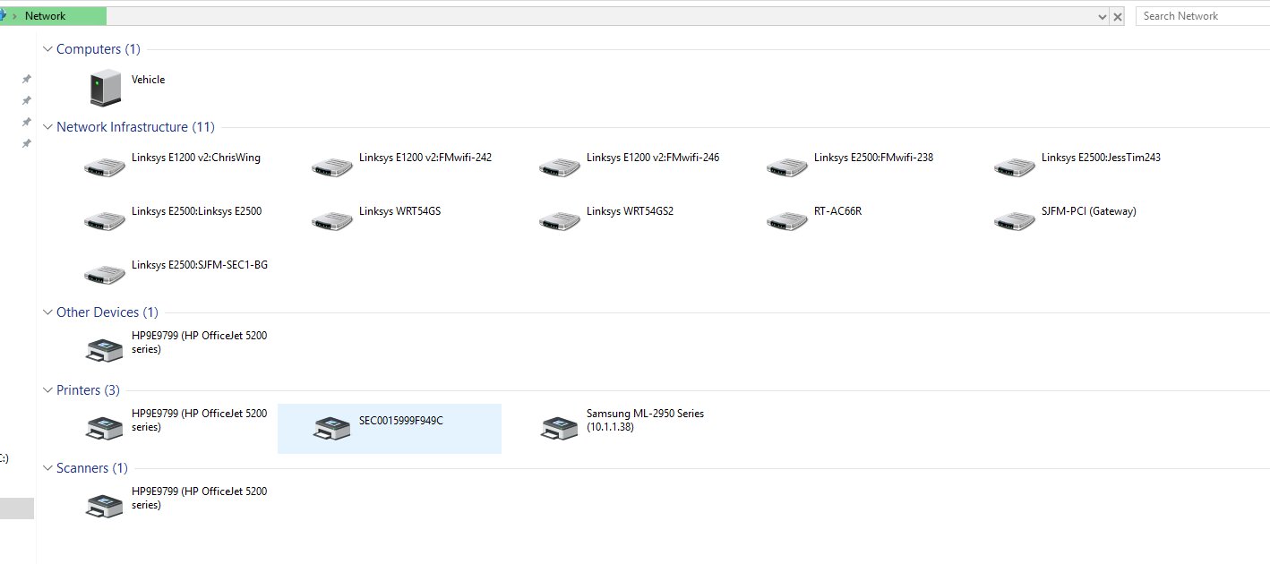

    I run a fairly sophisticated (if I do say so myself.. And I do! ) computer network at my work...
    My main workstation has 3 Ethernet ports and allows me to access main workstations on all 3 networks I created..
    I did a re-install of my main workstation and now I cannot see any of the other network workstations..
    NETWORK DISCOVERY is turned on, PRIVATE NETWORK firewall is turned off and all workstations have the same WORKGROUP..
    What setting am I missing??

                    Nope... It's a closed system..
                    The problem is, before I could just open up FILE MANAGER, click on NETWORK and all the computers I have on my network would be available.. I then click on the computer, right click on the HD and SHARE it..
                    Now, none of the computers are showing up.. See Attached..
                    Funny thing is, I can ping the workstations from my main workstation.. The workstations show up on a LAN SCAN.. And, as you see from the pic, a printer from one of the workstations shows up in FILE MANAGER..
                    But the computers themselves are not showing up at all..
                    Thanx for the reply.. Much appreciated
                    • brethin
                      • Dec 2008
                      • 1907
                      Re: Computer Network Question
                      If you want to access the other sysytems with file manager you need to turn SMBv1 back on. Microsoft turned it off in one of the patches. Function Discovery Resource Publication needs to be set to automatic start in all the services of all the machines.
                            That did it!!!
                            Awesome..
                            Thanx... And thanx to all the replied... Much appreciated..
