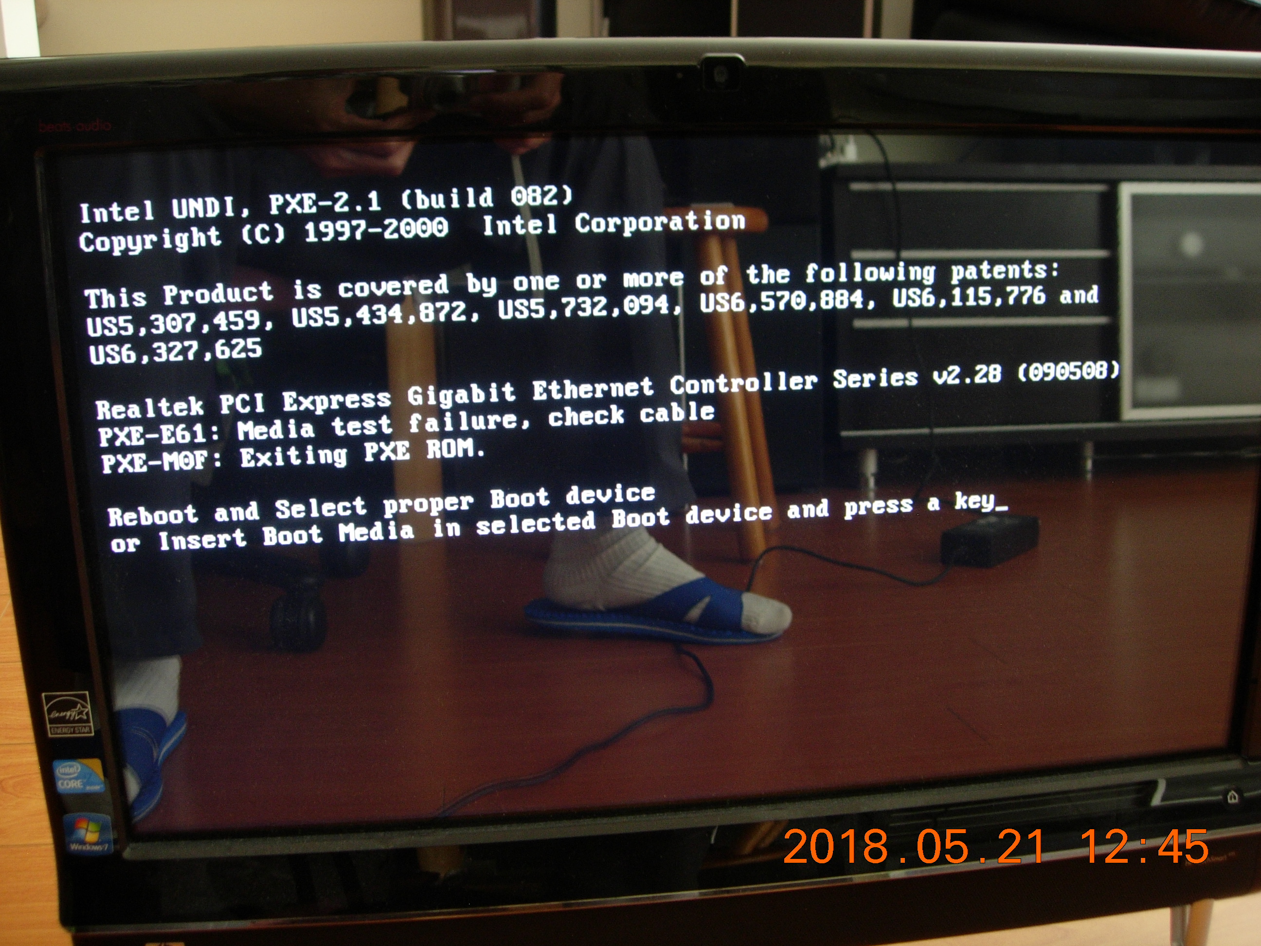

    I have an Hp 600-1390. Recently, it won't boot suddenly.
    I have tried to press the F11 key when starting up hoping that I can do the System Recovery. But the computer does not response to the F11 key.

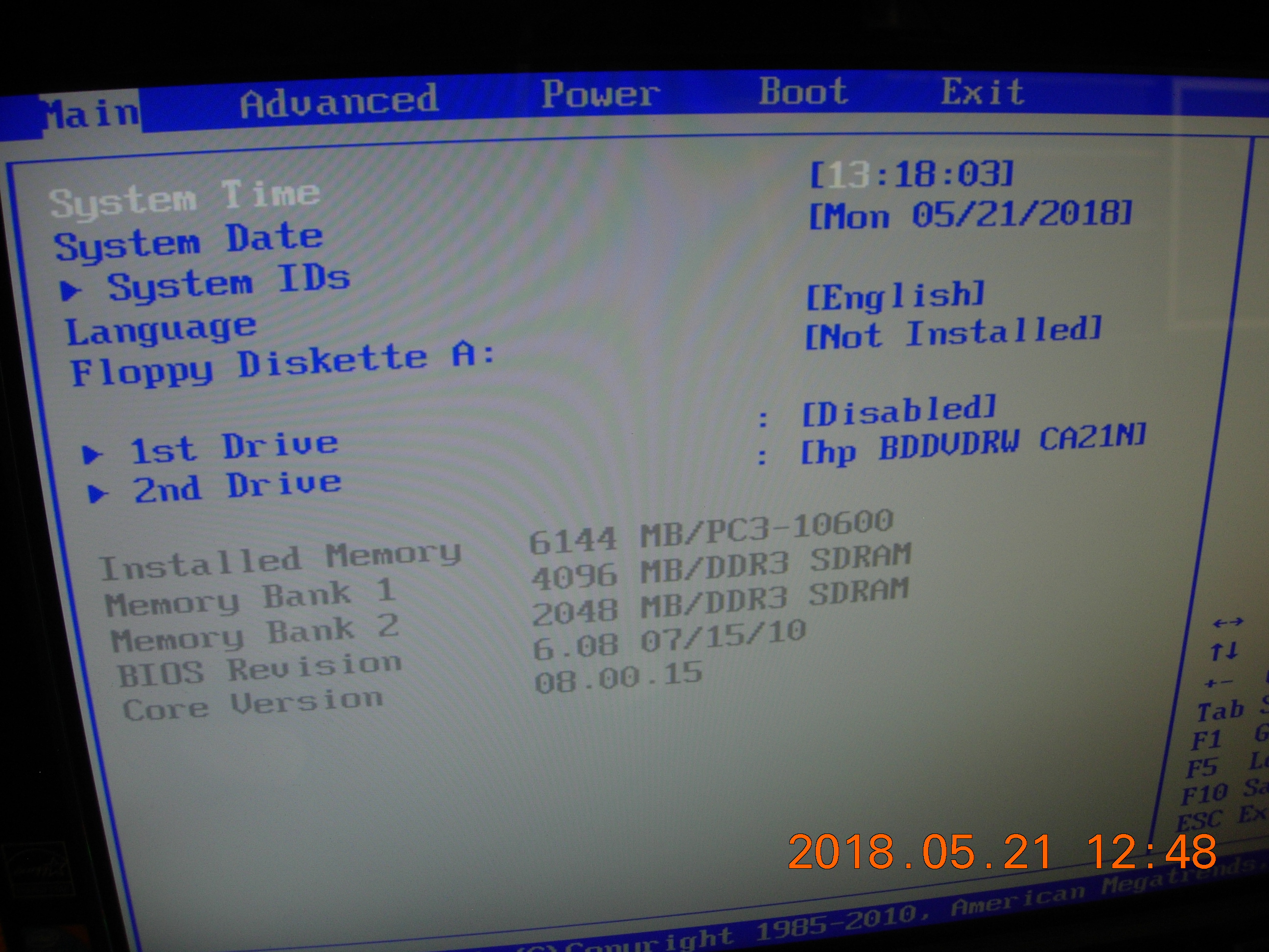

    I can go to the BIOS set by pressing the F10 key. The BIOS shows that the hard drive is disabled. I have tried to enable the hard drive, but finally the hard drive is still showing "DISABLED".

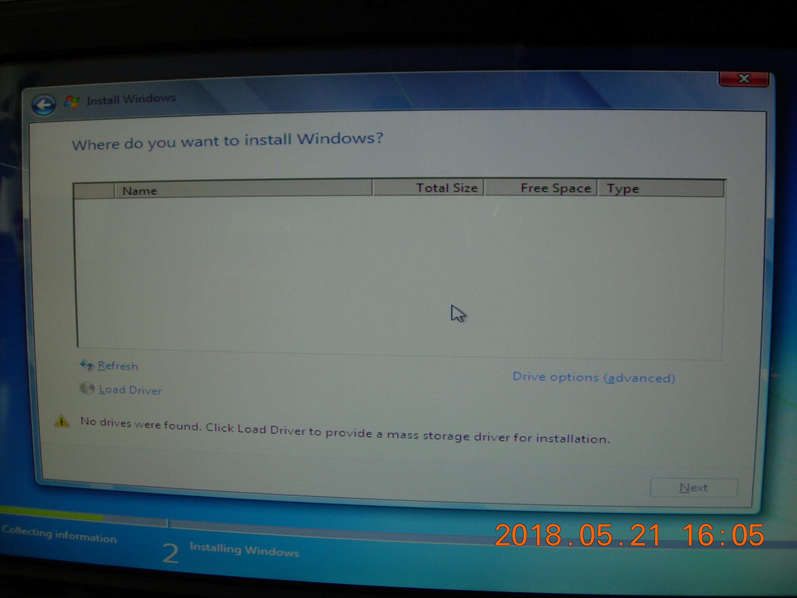

    I have also tried booting with a Windows 7 hoping to reinstall Windows 7 to it. But it also could not find the hard drive to install the new Windows 7.

    After starting, it stops here.
    The BIOS shows the hard drive is Disabled
    When trying to reinstall the Windows 7, it could not find the hard drive to do so.

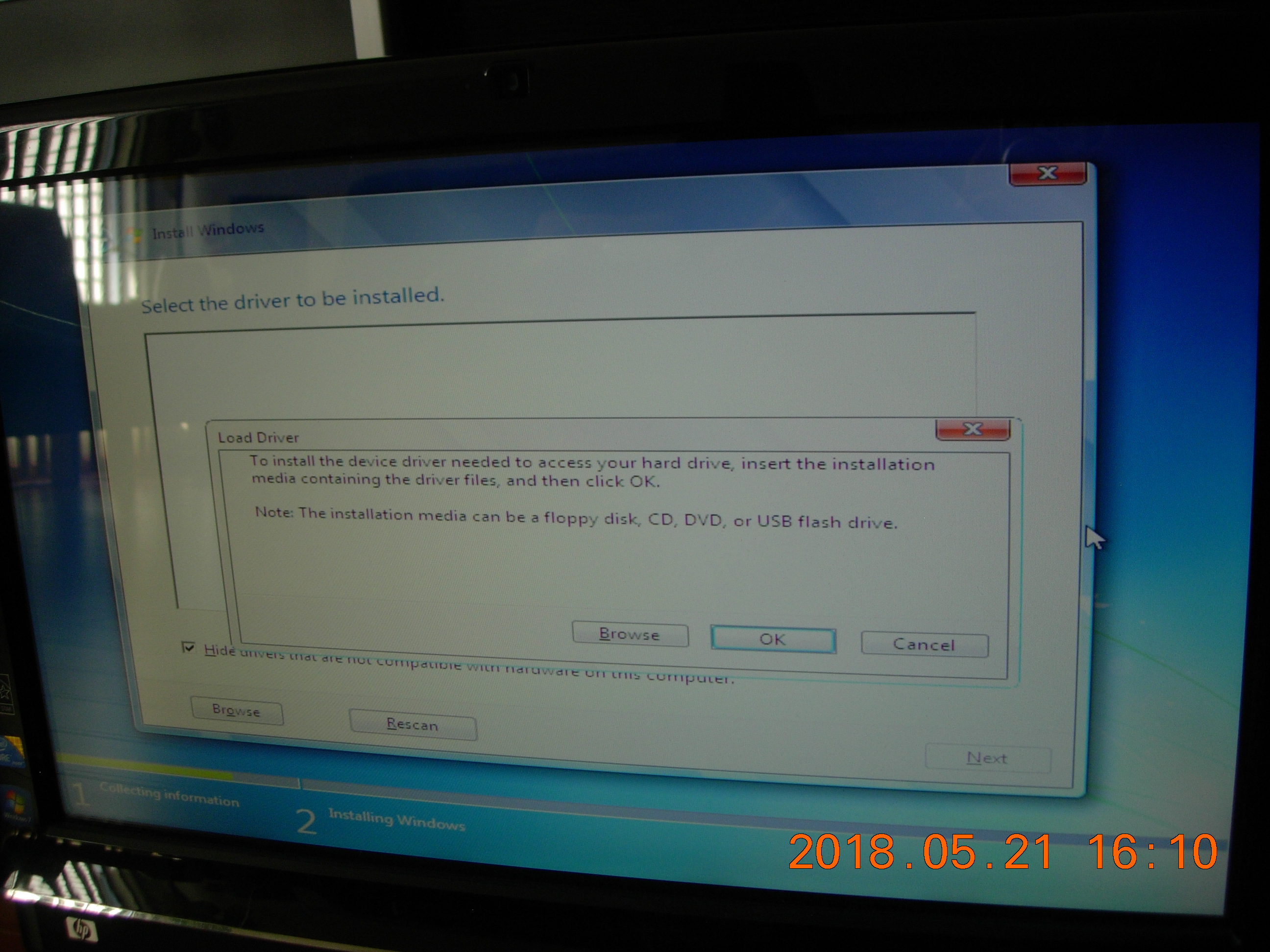

    Where can I find the driver files that it asks for when reinstalling Windows 7?
