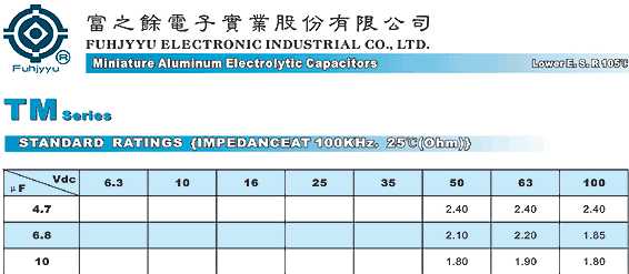

                      I'm just trying to 'learn ya' so you can figure this stuff out on your own.
                      [And so don't have to ask. And so you can help others.]
                      This is the part to burn into your brain.
                      Higher number for Ripple is better.
                      Lower number for ESR is better.
                      Filter caps are used to pass/short ripple voltages to ground.
                      Higher Ripple rating means it can pass more ripple without over heating.
                      - Similar to a max current or a watts rating.
                      Lower ESR means it's easier for ripple to go through the cap.
                      - Similar to a resistance value.
                      Once you got that down the only thing to know is how to find and read data sheets.
                      Finding can be impossible or crazy with some crap brand originals but most of the time it's at least do-able.
                      If not then go by what's typical in the application which can be asked or learned by experience.
                      One thing to watch in reading tables is that they use standard values.
                      Ripple should be: mA at 100kHz and at max rated temp. [Usually 105°C or 85°C]
                      - Some brands cheat and use 120kHz. [And some list both which is handy.]
                      ESR [a.k.a. Impedance in some tables] should be either
                      - mΩ at 100kHz and 20°C -or- Ω at 100kHz and 20°C
                      Some brands use a non-standard temp or frequency or both.
                      For instance:
                      Our buddy Fuhjyyu takes ESR at 25°C.
                      Elite takes Ripple at 120kHz.
                      Using those conditions inflates the numbers and makes the ratings 'look' better.
                      In a way that works out good because if you match their inflated bogus number in a chart for replacements that uses the correct standard conditions it's actually an upgrade.
                      I uploaded MBZ table to show how standard looks for comparison.
