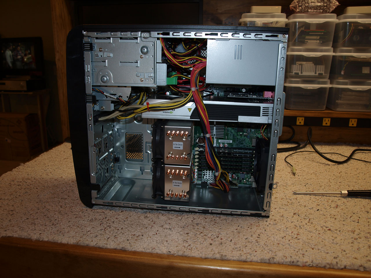

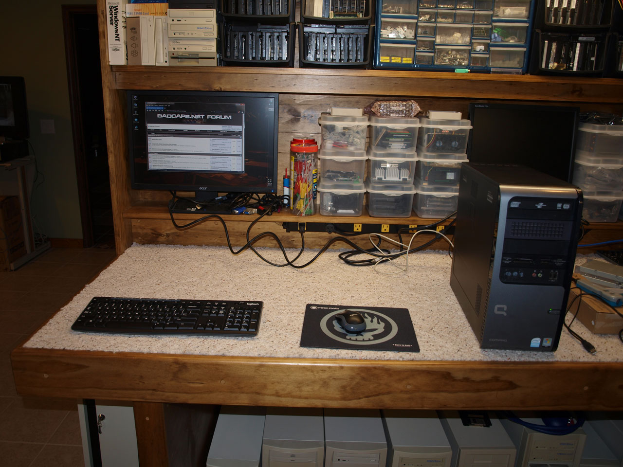

      Just a postscript to this thread with what became of the extra board.....

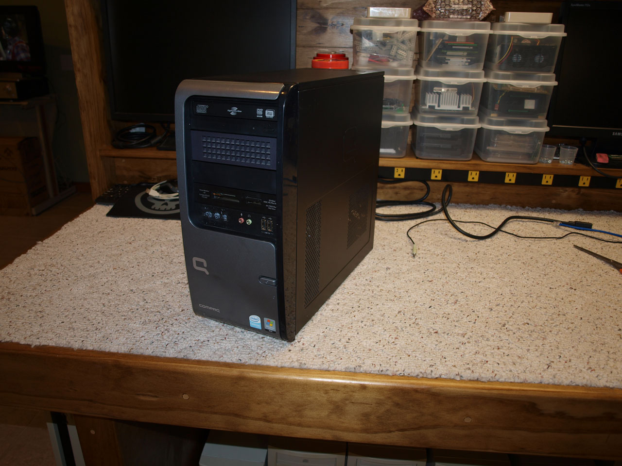

      Celeron Compaq? Couldn't be....
      Don't worry, it's not!
      Now how cool was all that!! This case came from the house of heavy smokers....it was nasty & skuzzy, so it had to be hotwashed twice to get the sludge & stench off it. It also needed a moderate amount of modifying for fitment....but what the hell... Some day when I'm dead and gone, this bizarre computer collection will be worth millions!

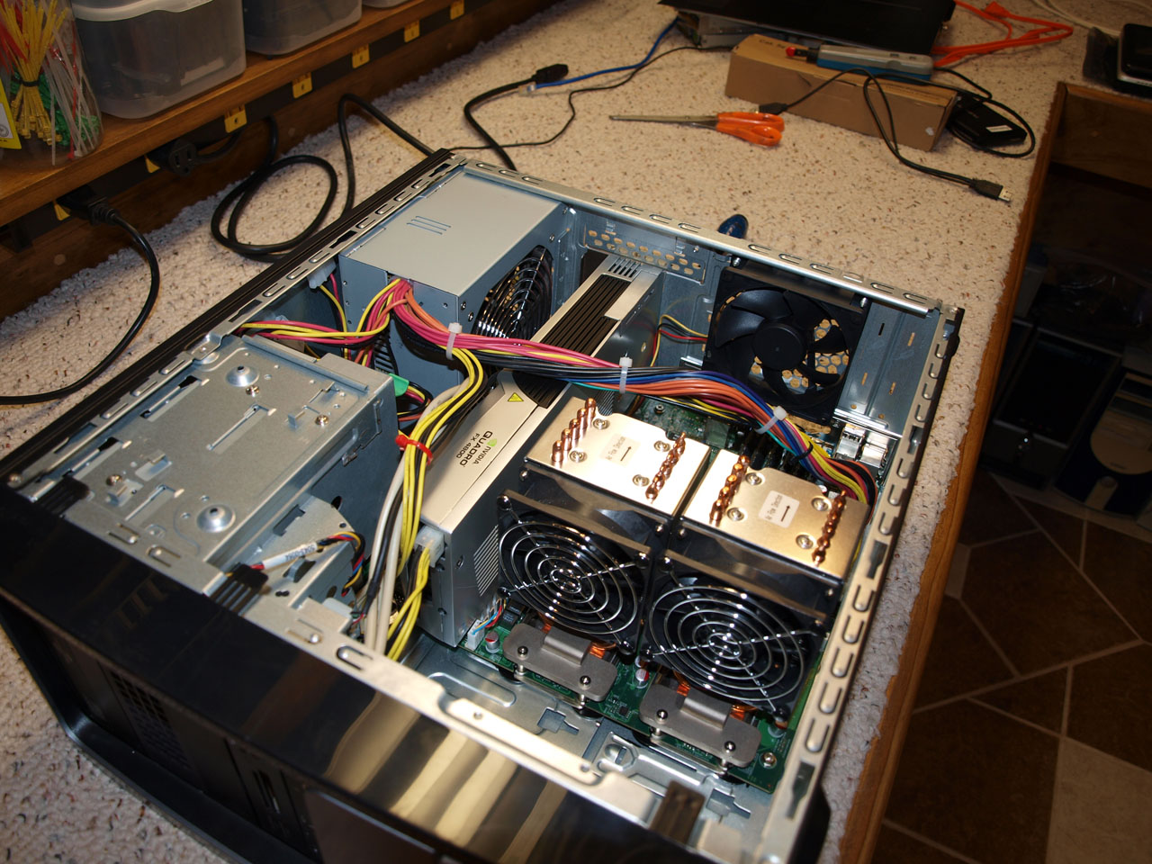

      I built this one with what I had on hand. Its a dual quad-core Xeon E5410 @ 2.33/1333 8gb RAM and a quadro FX4800 GPU.

        Man, that looks hella-neat!
        And the whole system cooling looks like it will all work together very well, with the CPU fans drawing air through the bottom half of the case, and the GPU + PSU from the top half. I bet it runs cool!
        ... well, maybe save for that FX4800 perhaps.
        But seriously, top-notch system!

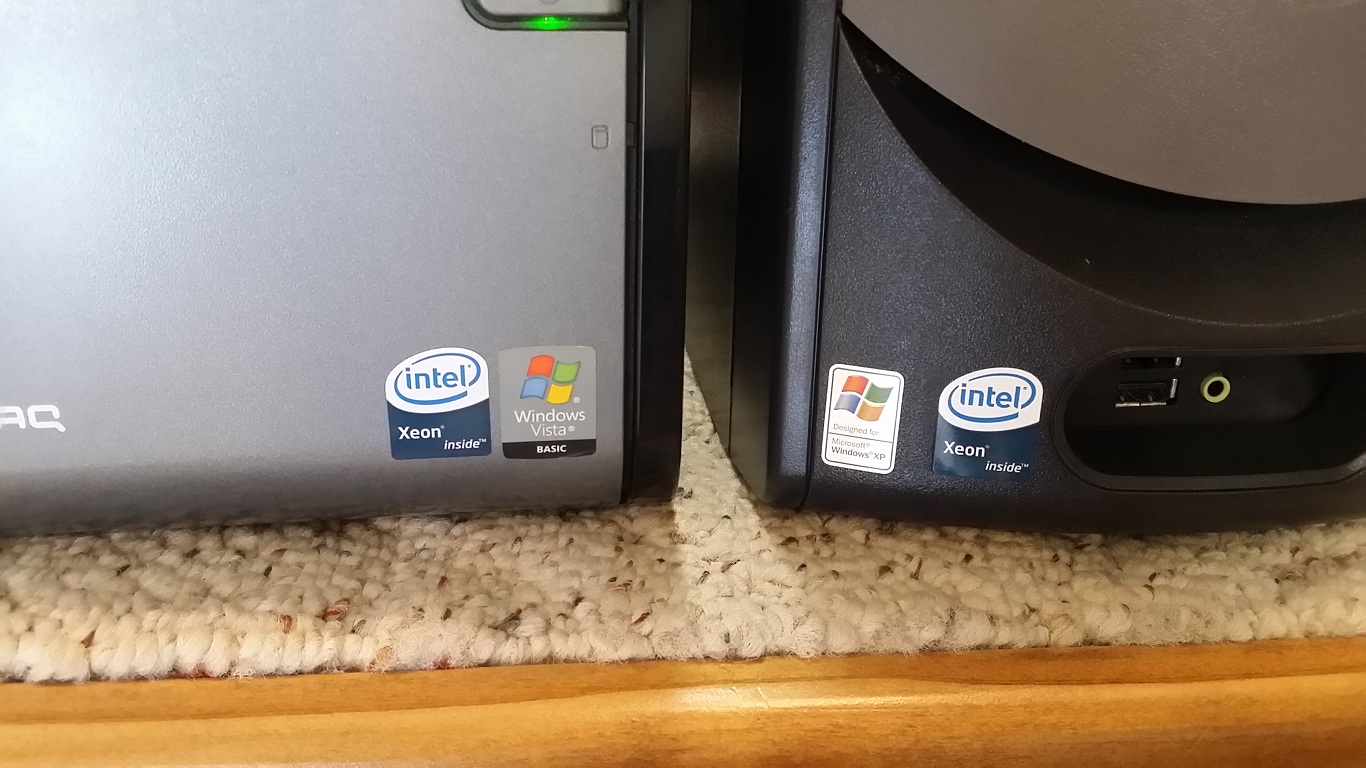

              Re: Dell Dimension 1100? ...or is it? The Ultimate Sleeper System

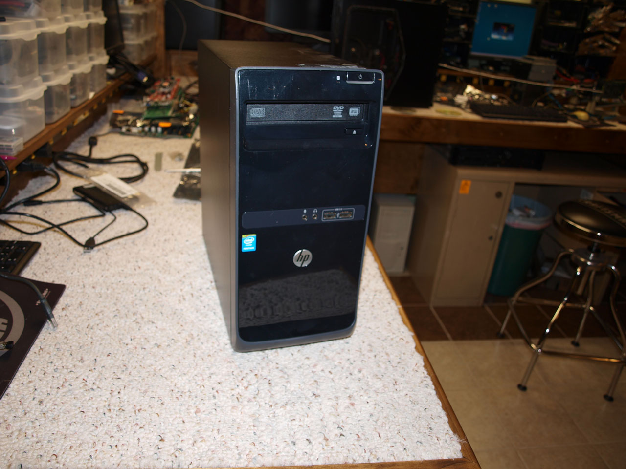

              The only external hint that things may not be as they appear to be...

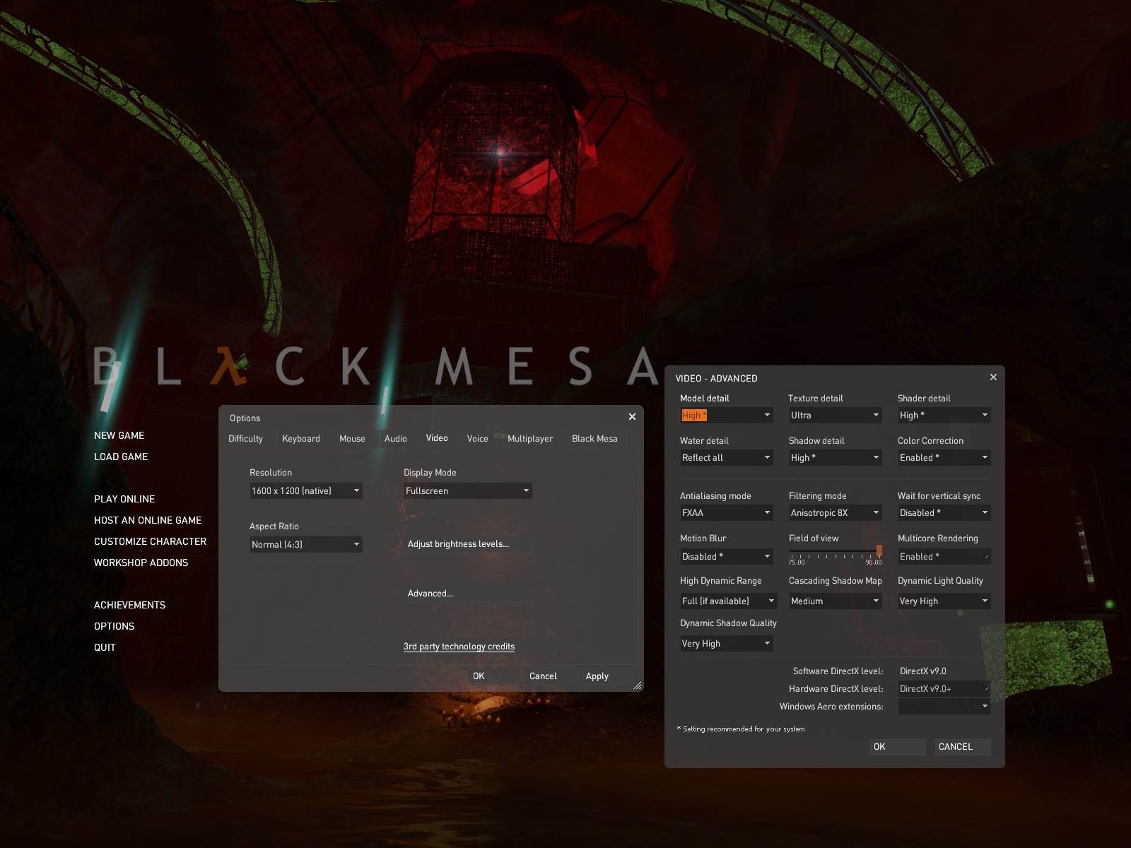

                    With that GTX480, it should even still be able to handle modern games too - at least Fortnite for sure (well, that's not really modern now anymore, or so the "cool" kids say these days.) But Apex Legends will probably run OK too.

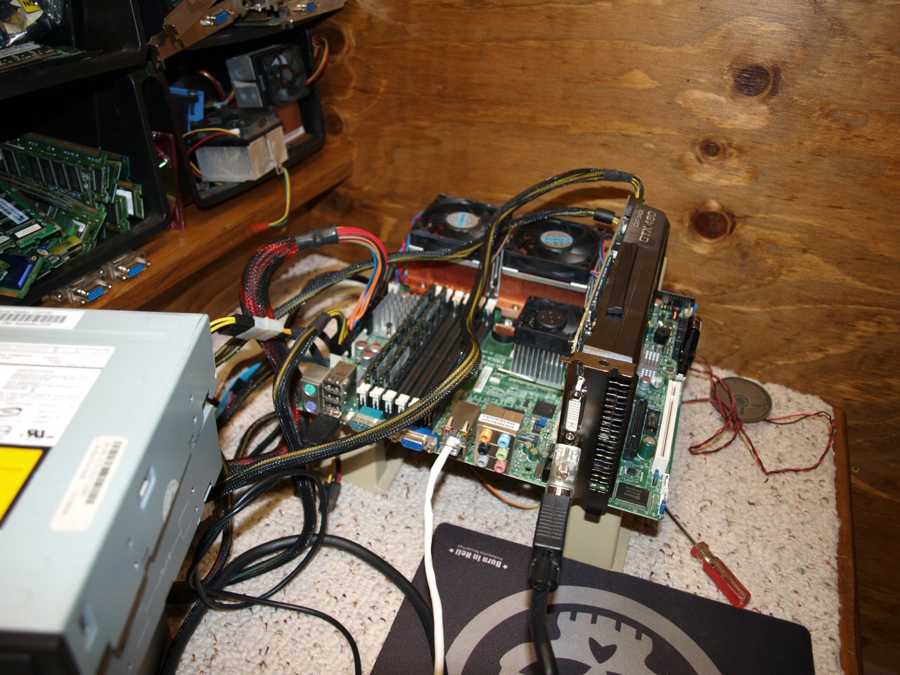

                        Yea, another one....the board was a SM tree freebie..... I picked up 2x 3GHz 1333FSB CPU's for 22 shipped. The big fat solid copper heatsinks were leftover from some old socket 604 system (sinks are the same for lga771)....I actually have 4 of them, I have 2 remaining now. I had 8gb ECC RAM in the bin...but I'll grab more....its cheap, and the board supports 48gb. I did find a case that this will fit.... Goin for the trifecta!! One Dell, one Compaq, and one soon to be HP case....

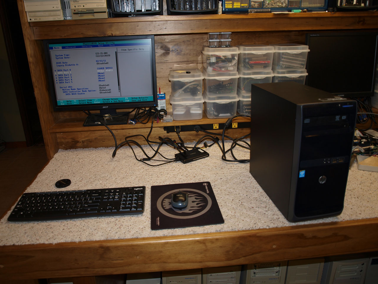

                                    Just for those that think I forgot about # 3.....
                                    The case got modded...
                                    More later.

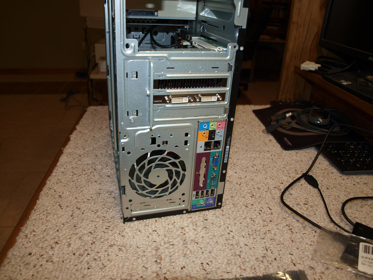

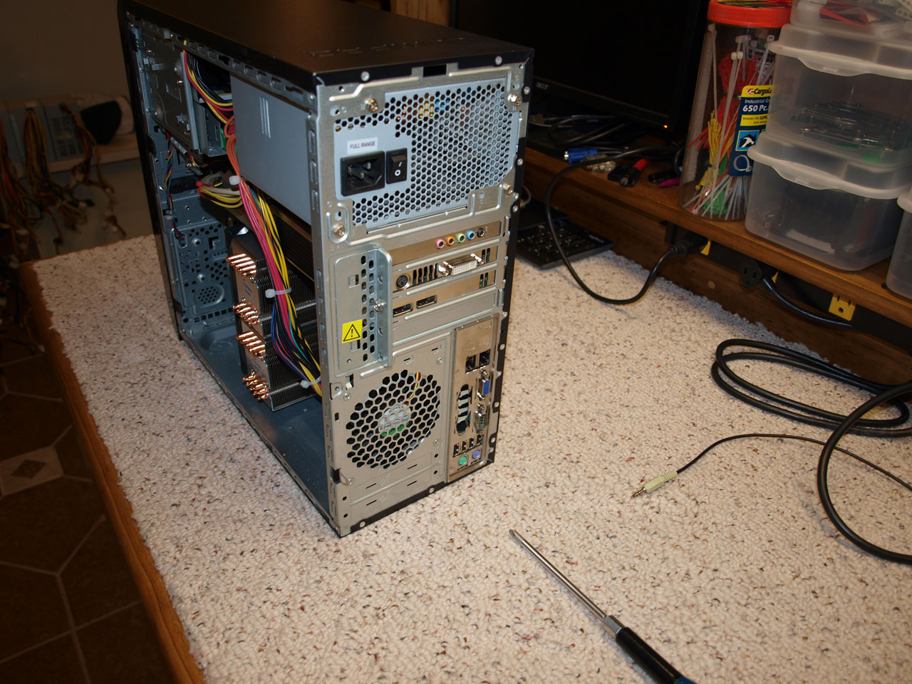

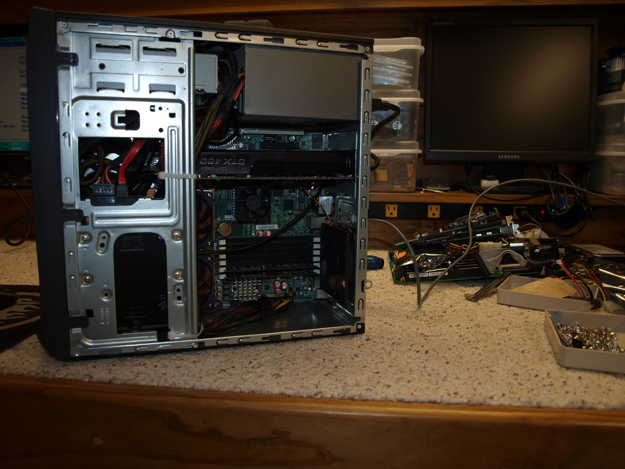

                                      All done.....I just used what was on-hand as far as memory & GPU. It's kind of funny, a GTX460 can be had all day long for ~$20 these days... I had 8gb of pc2-5300P RAM in the bin and I just ran with that....if there comes a time it needs more or I rehome this thing, I can always add more, it's cheap too....but for now its done.
                                      All assembled....
                                      Butt shot...
                                      YAY, it works....
                                      OS install.....
                                      ...and all finished, of course this post created from it...

                                        ^ AWESOME! ^
                                        Looks so modest on the outside, yet a mini powerhouse on the inside. I love it!
                                        A PSU with a 120 mm fan might have worked better, though, as right now the airflow across those wires looks a bit tight... though I'm sure is more than fine.

                                        At the very least, you should be able to run this on it in full details:

                                          Don't get your hopes too high, I have a 780 Ti and a 5820k Haswell CPU but the game is quite slow at times with the settings in attached screenshot:
