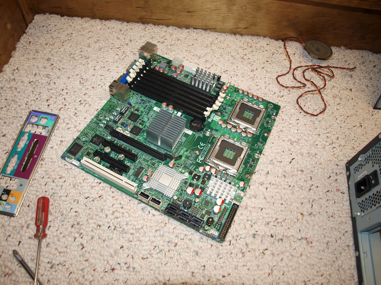

          Just a couple pics.... The controller came today....the GPU's should be here Monday.
          The replacement board:
          The previous board which was thought to be bad.......but isn't. I'll store it for a build later on. These are quite unusual boards, mATX with dual CPU sockets....I've never seen this on any other board.

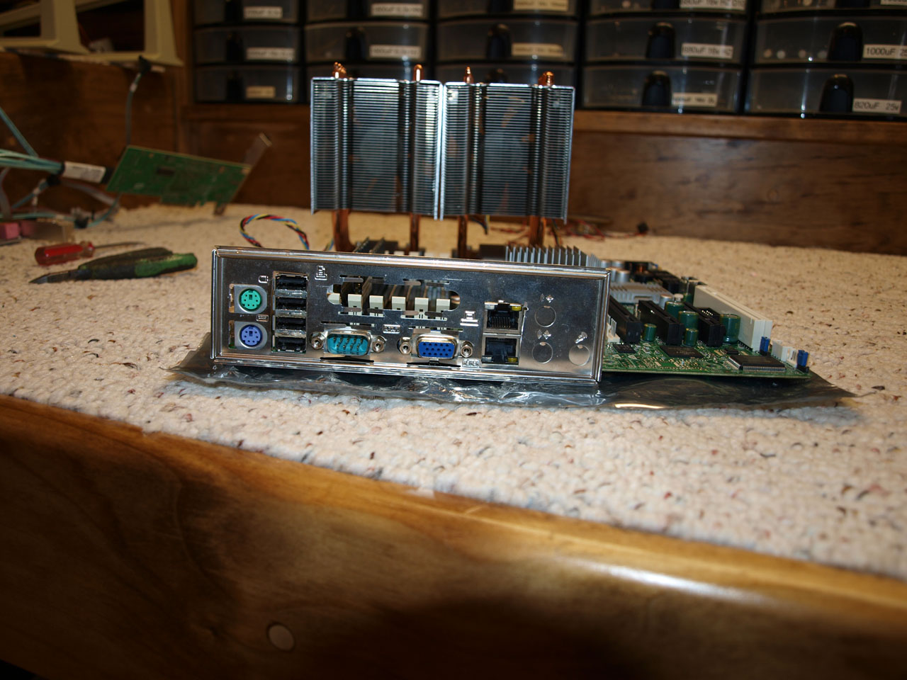

            Just a little note for the original board (now the spare)....I was rummaging through IO shields looking for one for something else, and came across one that will fit this board, which did not come with one.
            I'll have to do a little Ratduding with a dremel around the USB block next to the KB/mouse ports to expand it for 4 ports versus 2....and the NIC ports to be able to use the second one.... Thats easy peasy.
            I'll have to keep my eyes peeled for another mATX case with the floor clearance for one of these kooky little boards.

              ....and a perfectly ratduded IO shield!!

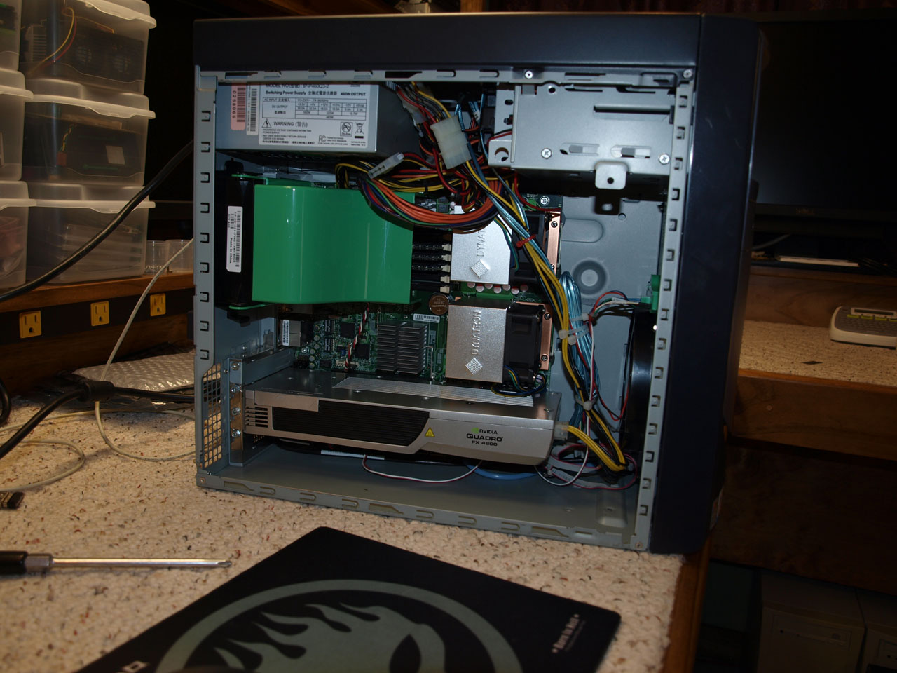

                      This one is finally done and problem-free. GPU added and LSI RAID controller. It runs surpringly cool for as cramped as the case is....but it breathes well.

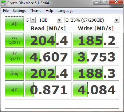

                      Some benchmarks:
                      The disk benchmark is 2x 160gb velociraptors in a raid0 on a LSI 9650 w/bbu & batt, write caching enabled.
                      Overall, its a good sleeper that was fun to build.... It gave my troubleshooting abilities a workout.....but got 'er done!! I'll have anotehr one of these some day when I find another mATX case that can hold this weird mTAX board....its certainly no fun putting one in a full ATX, anyone can do that. Gotta swim against the stream!!

                        A couple config changes that yielded some performance gains. I removed the LSI 9650 and replaced it with a LSI SAS3081E-R, which is a very basic SAS RAID controller, these can be had all day long for about 10 bucks shipped from ebay. I swapped out the drives with a pair of 2.5" 15k RPM SAS HDD's in a raid0, the results were pretty good.....a writeup is coming soon....but here's the comparison results:
