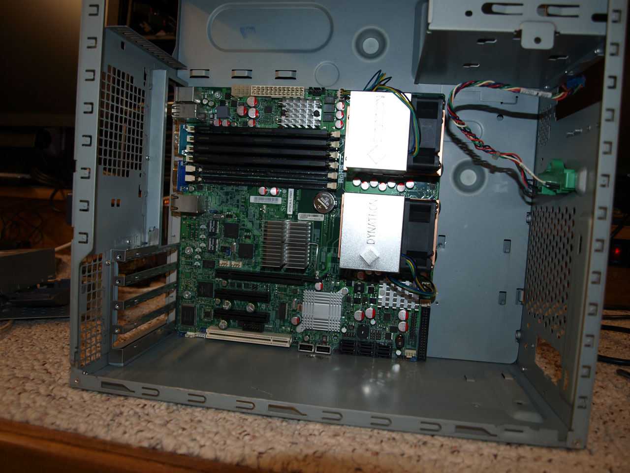

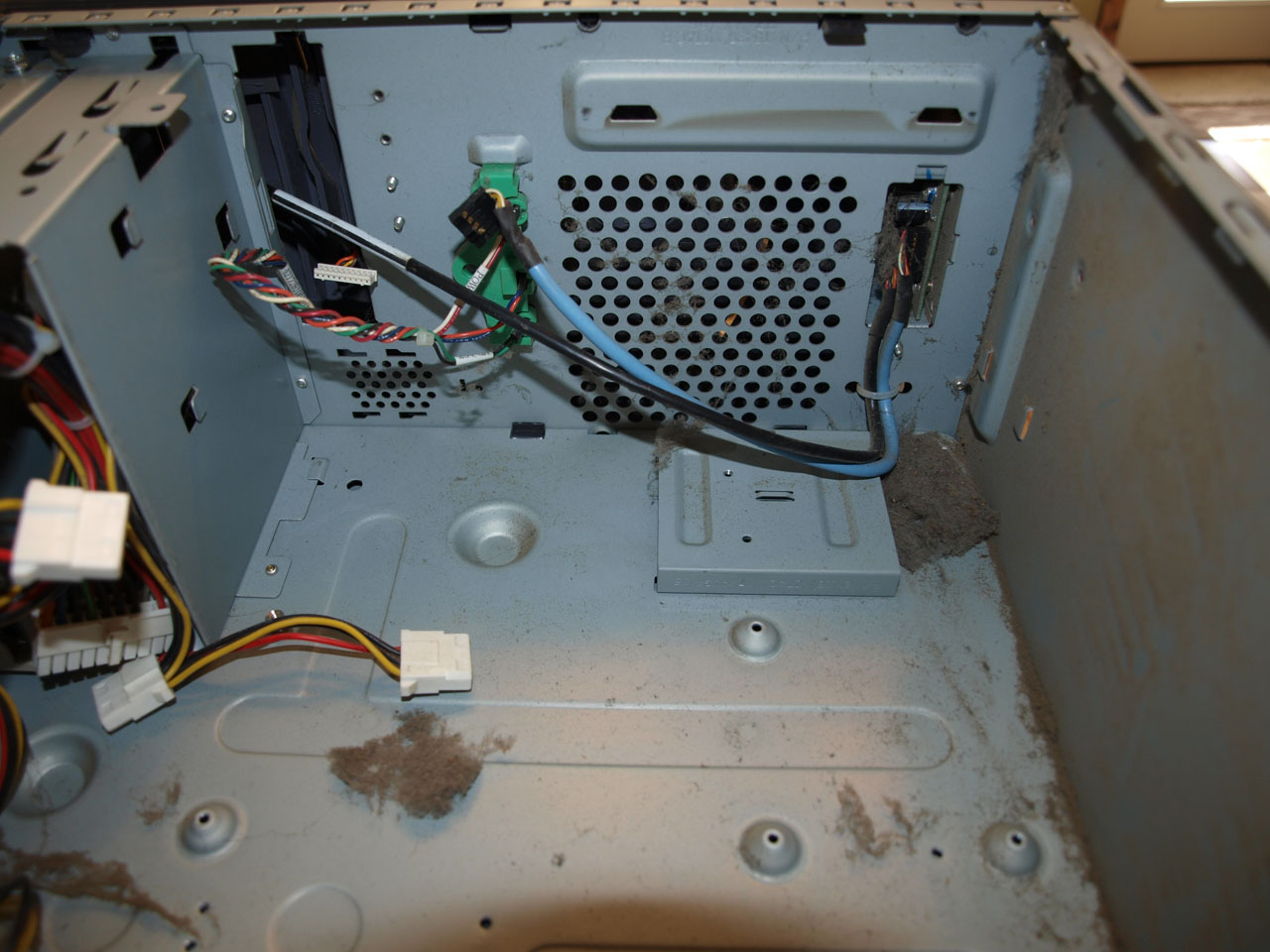

I picked up a Supermicro X7DCA motherboard on ebay for cheap sometime back, which SM claims to be a mATX form-factor....well, its rather in violation of the mATX form-factor, as its about 1/4" taller than a standard mATX board, which eliminates it fitting in probaly 98% of mATX cases out there.... This extra height eliminates modding the case, as the bottom edge of the board conflicts with the floor of the case, so short of cutting out the bottom of the case, it just isn't going to work.....
I've kept a constant vigil of all the mATX cases I encountered, hoping I'd run into one that has just a little extra room between the bottom edge of the board and the floor of the case.... I finally got one earlier this week when one of the local shops gave me a pickup load of junk.... It was a Dimension 1100 with a 2.53GHz Celeron in it. The motherboard was bad, the PSU needs recapped, and by modern standards, this thing was truly scrap iron!

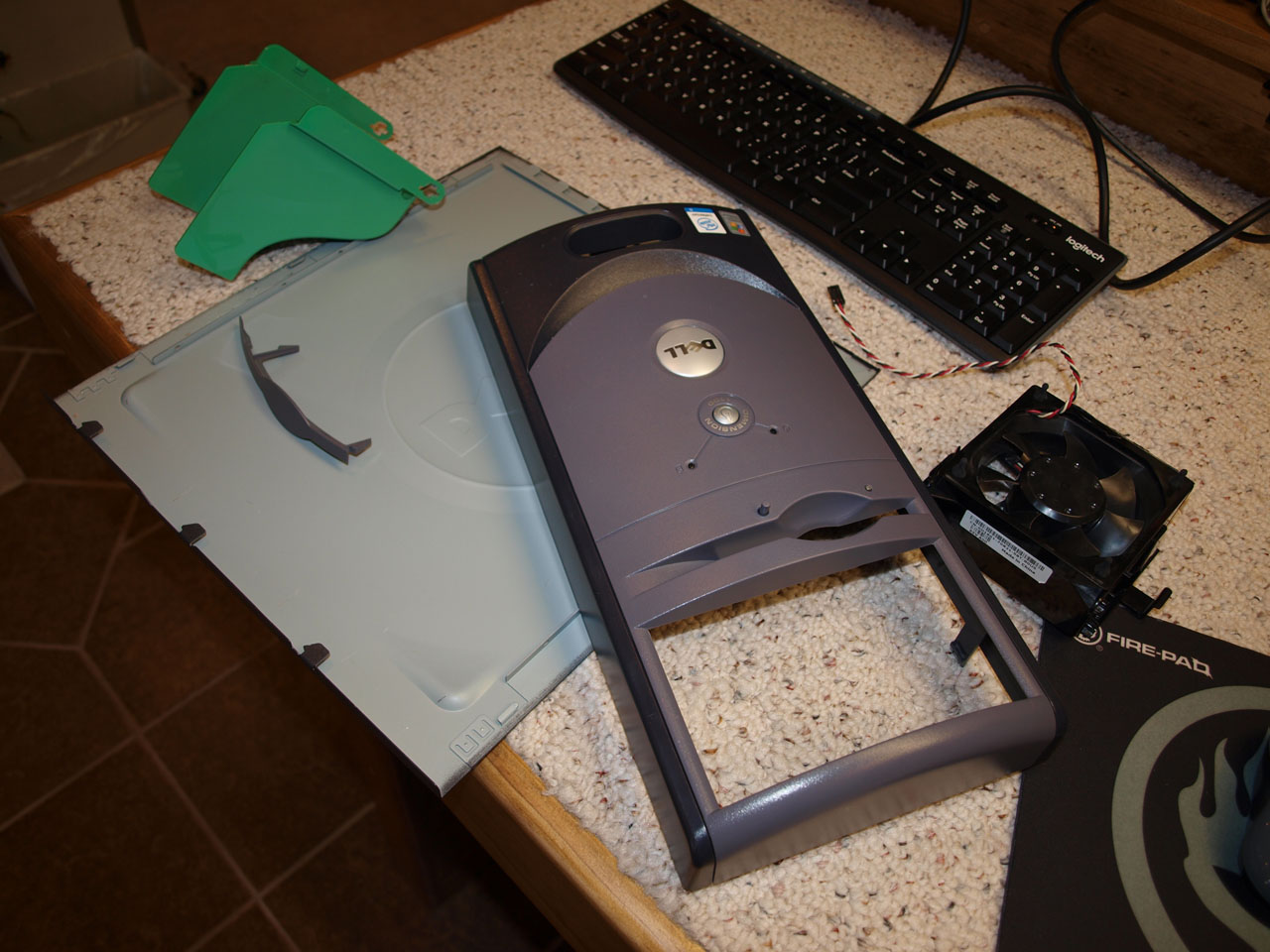

Anyway....the junk in question:
Junk internals removed....

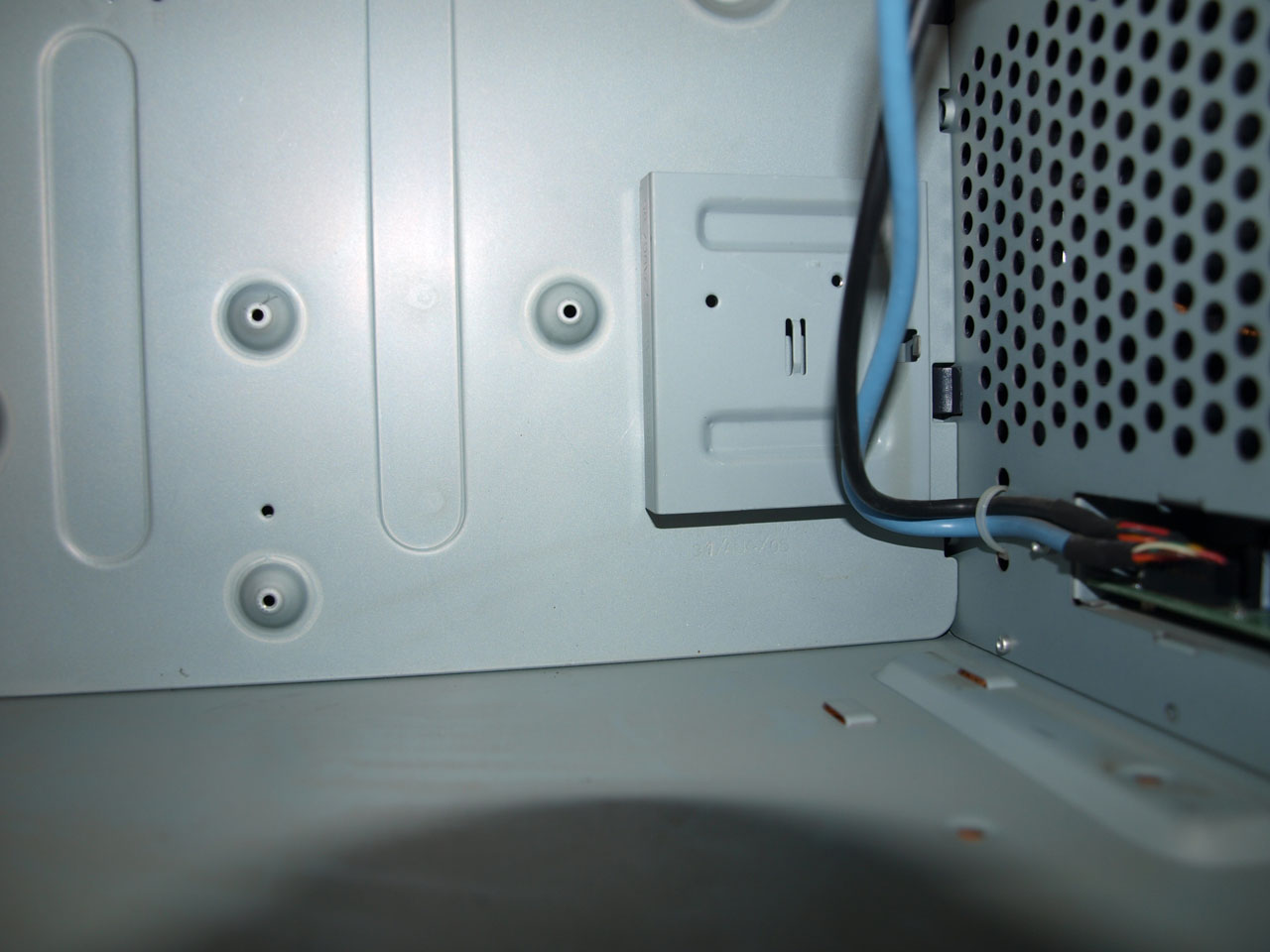

Yes, that's a dime stuck to the bottom of the case...

I took the case outside and blasted it with the air hose to get all the bunnies out of it, and then came the art of making the square peg go into the round hole...

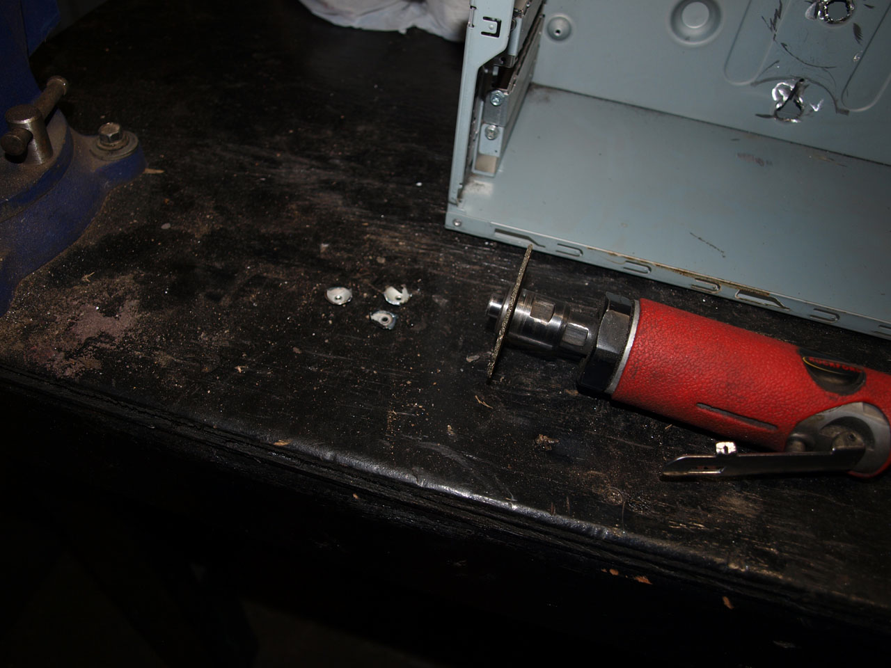

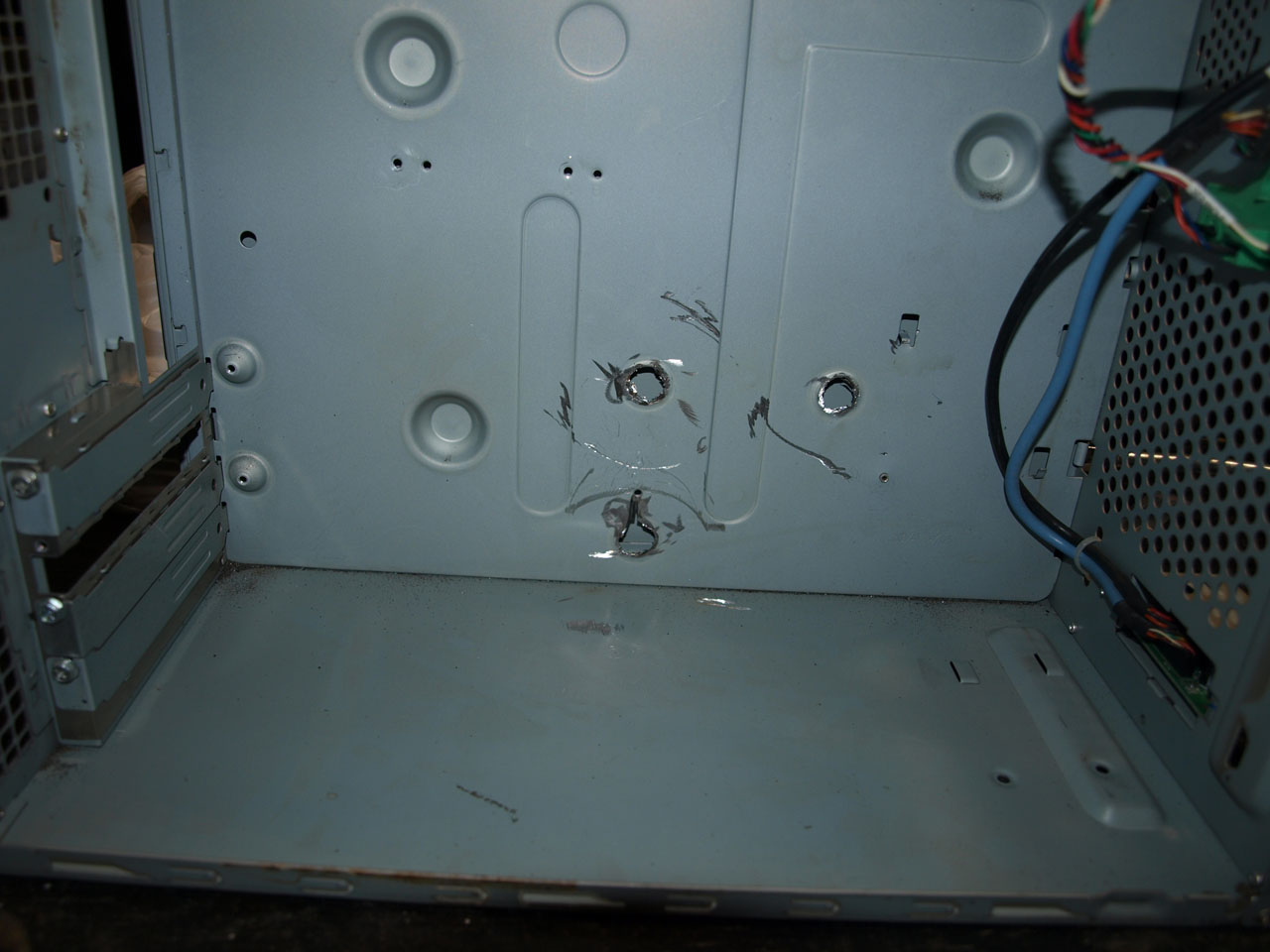

First off that little platform the HDD bracket/cage mounts to has to go, the back of the board hits it. I'll be mounting the HDD elsewhere anyway, so no loss in losing the original HDD mount point. The large perforated front plate of the case is also a great spot to fit a 120mm fan...I'll come back to that later
Those 3 standoffs to the left of it don't line up with the mount points on the board....so they need to go as well.

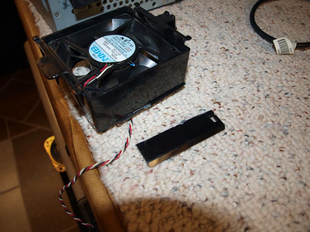

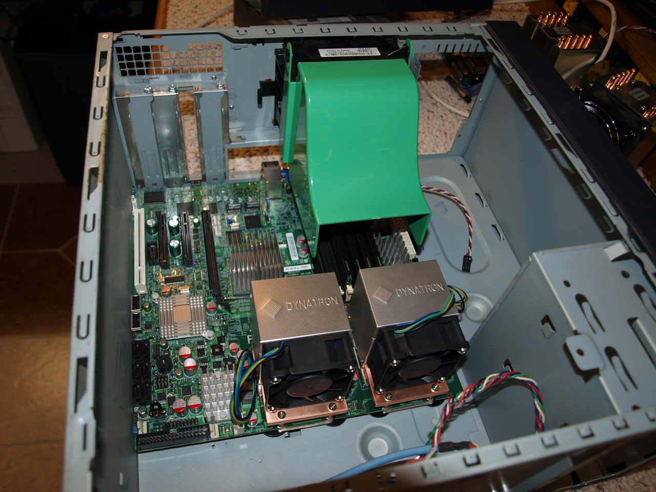

Now to test fit the motherboard with the OEM air guide....this couldn't have fit more perfect!! Its right over the memory, creating a nice windtunnel to keep that quite hot ECC nice & cool....it's not as bad as fully buffered, but registered/ECC still gets very toasty. I had to trim one small tab off the bottom edge of the plastic tunnel housing, as it was hitting the DIMM modules.
Trimmed.
Zipped the standoffs out with an angle grinder....that was kind of tricky in that small space....but I got it...

Board attached to mounts. There's MAYBE .25mm between the floor of the case and the bottom edge of the board, its VERY close! No, I do not have an IO shield for this board, I will find one though, Supermicro is good about not having a gazillion IO shields, and uses maybe half a dozen different styles....and this one is pretty standard. Finding one won't be a problem.

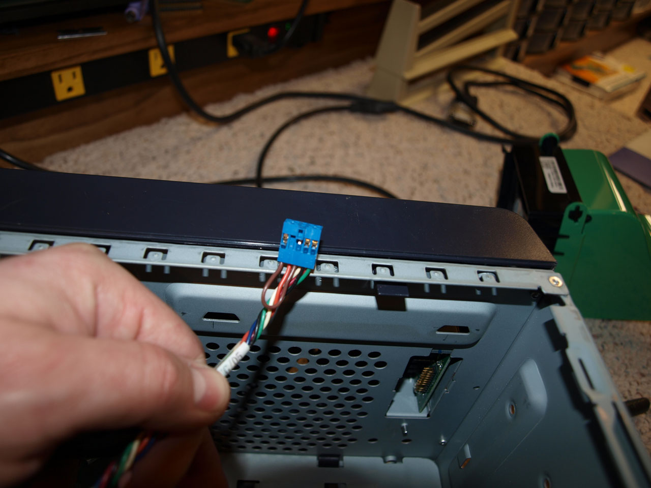

Now for that goofy single-end front panel connector....
Cured.
