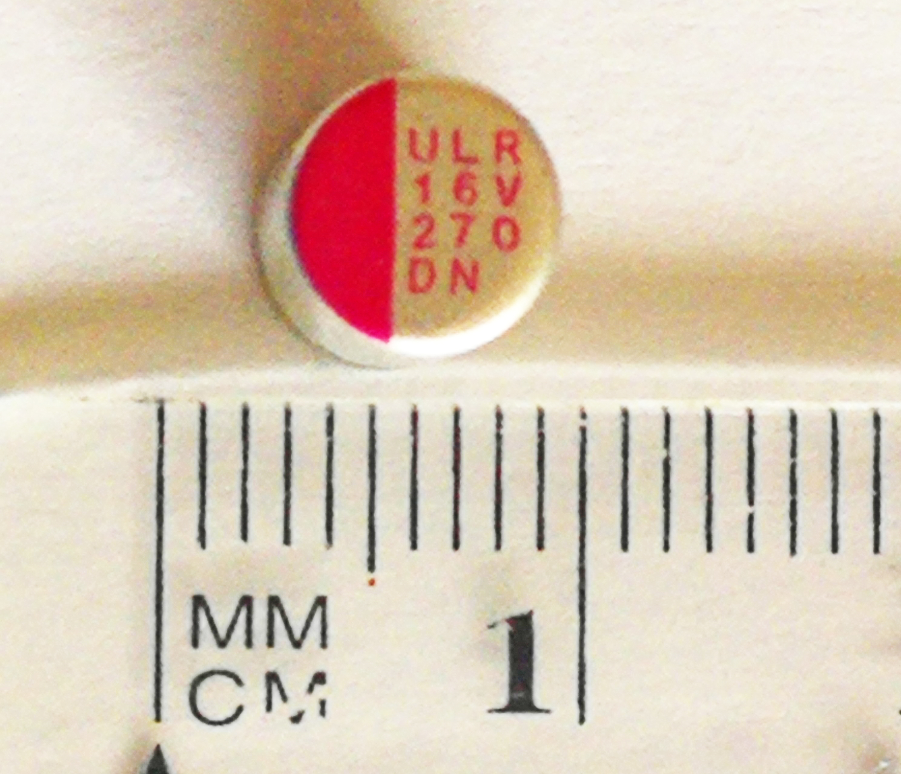

    URL 16V 270 DN Replacement
    I accidentally pulled out a cap on my R7 250 Power Color video card. The wires are on the board and the cap is detached. The cap has URL 16V 270 DN on it. I am hoping I can replace it but don't know how to find the correct replacement. Can someone advise? I have added a picture of the top of the cap. The length of the cap is 11mm.
    Thanks in advance for any help on this.
    Re: URL 16V 270 DN Replacement
    270uF 16V
    X-CON: ULR series capacitor
    LTEC ULR series:
    https://cdn.badcaps-static.com/pdfs/...a76a95785d.pdf
      Much appreciate the quick response. Do you know what the DN characters stand for? Is that manufacture date code?
      • Behemot
        • 4845
        • CZ
        X-CON ULR for sure, and the DN is indeed date code. Is it SMD, or THT? Anyway, the card will most likely work fine even without it if you have good enough PSU, it filters +12V input. And there are (usually) more of them too.
        On the other hand manufacturers sometimes save on them and leave blank spots so I fill all of them with some caps from other dead components (boards, graphics cards), it won't harm anything to add some morefiltering and bulk capacitance.
