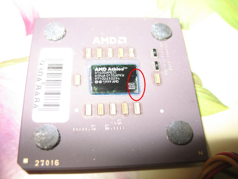

              The processor on the left photo is an Athlon "T-Bird".
              I used to have a 1.3 Ghz 100 Mhz FSB version and it gotten damaged, because I wasn't careful enough when reclipping the heatsink after moving it to another motherboard.
              If you get no screen and no sounds, it's probably because the chip gotten damaged.

                @ RJARRRPCGP: if I will found a suitable MOBO I will test this CPU.
                The Biostar where it is mounted has several BAD caps and a burnt sign on one memory socket so I don't want to spend money and time on it.

                    that thunderbird might work
                    http://www.cpu-world.com/CPUs/K7/AMD...1400AMS3C.html
                    i had a XP-M 2500+ with chipped corner on the core - worked fine still....
                    the M versions are better as the multiplier is unlocked also

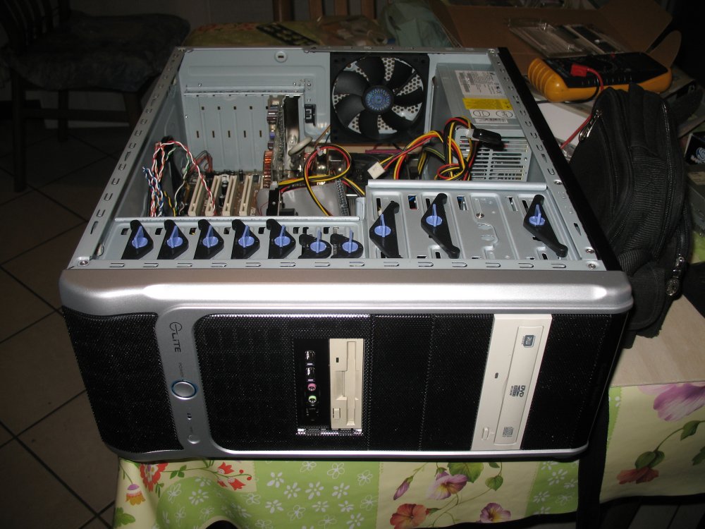

                      At the end my brother bought a Cooler Master Elite 330 Black for 38€ and 2 GB Ram A-Data for 54€.
                      For the PSU I gave him my spare Newton Power... probably better than Antec 380.

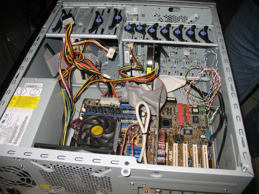

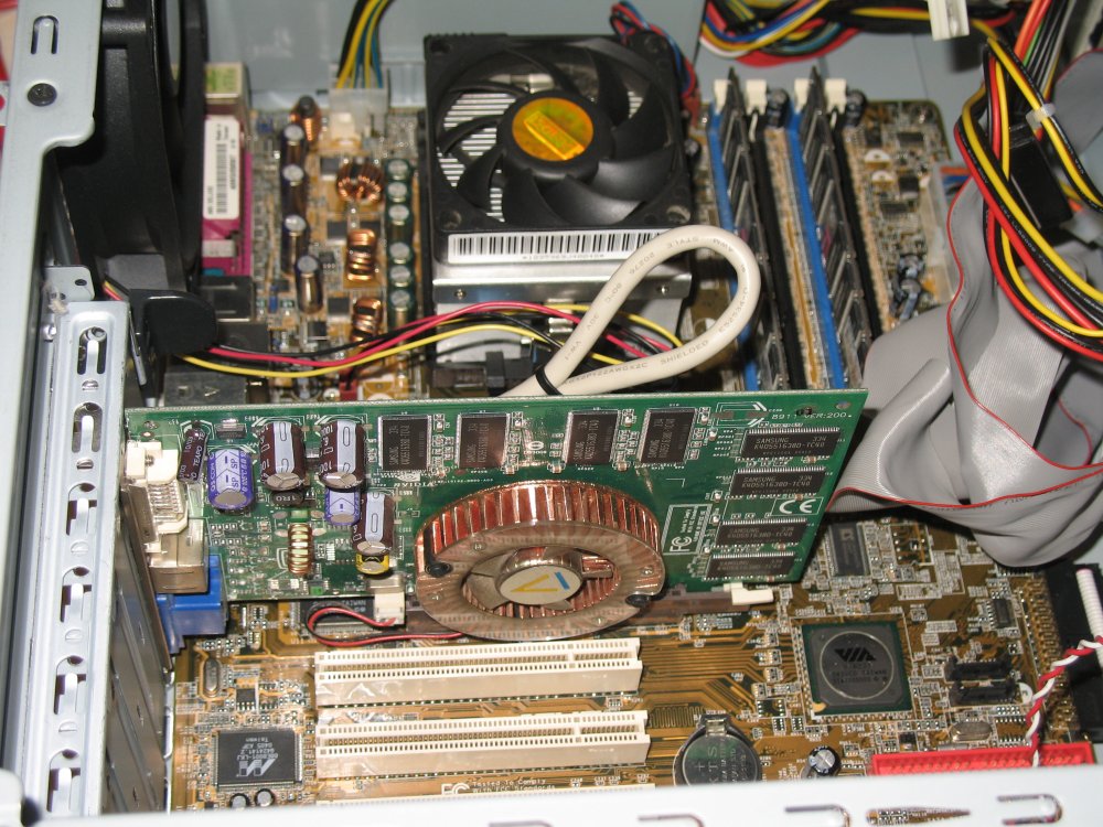

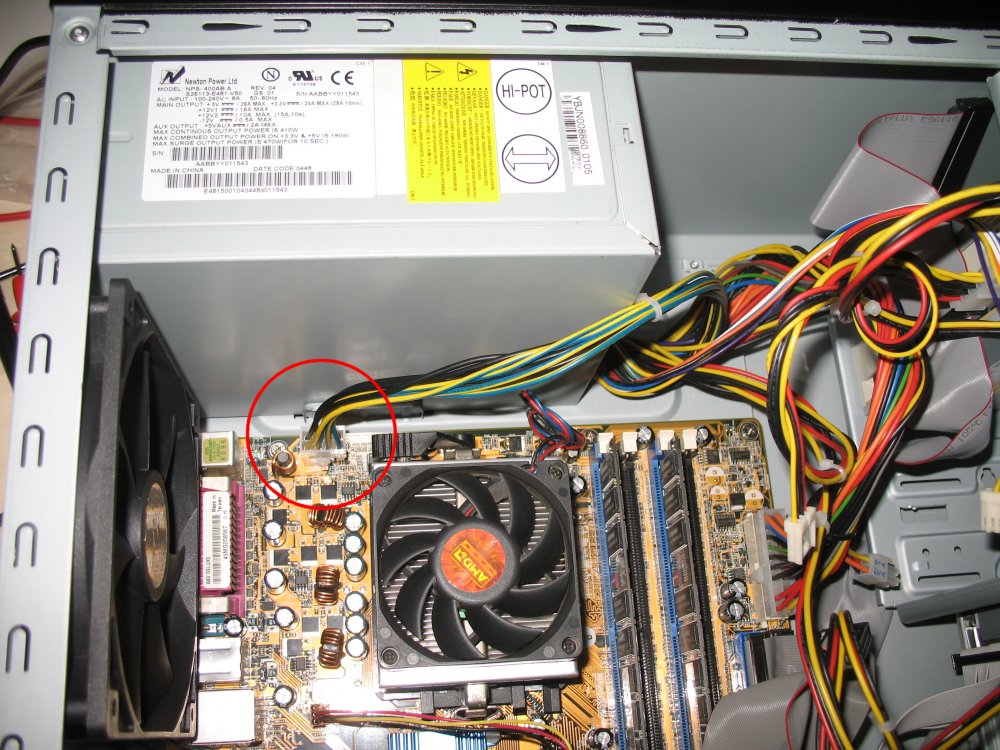

                      Last night we build the PC and we had some little problems:
                      1) the PSU is different from mine, he has not the 4 PIN connector CPU... but there was an 8 PIN connector. After testing the voltage we saw it was 12V so we used them. It is circled in a picture.
                      2) Was not possible to insert the 24 PIN power connector because very close there is the IDE connector. I cut the connector and I rescued the 4 pin connector from a dead unit, I extracted the cable and replaced the cut connector which had the semi-naked contact after I cut it.
                      3) After installing the OS we discovered that the PC was unable to restart using the restart button from Win and the reset button on cabinet. using one of them simply made the screen black and the PC running without any activity. After looking BIOS setting we decided to reset CMOS and the problem disappeared.
                      Well it seems good but only using it we can see if this MOBO is good.
