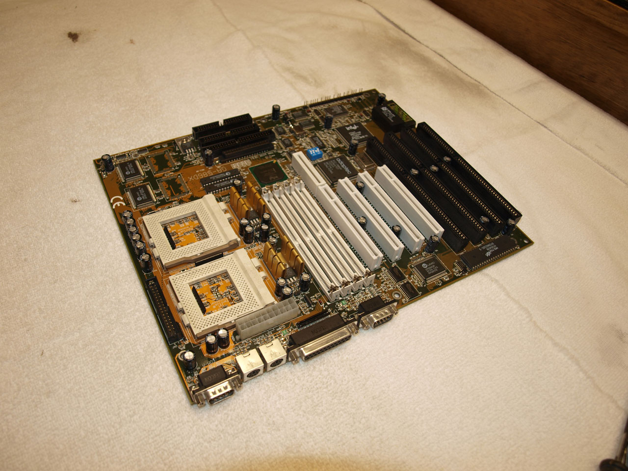

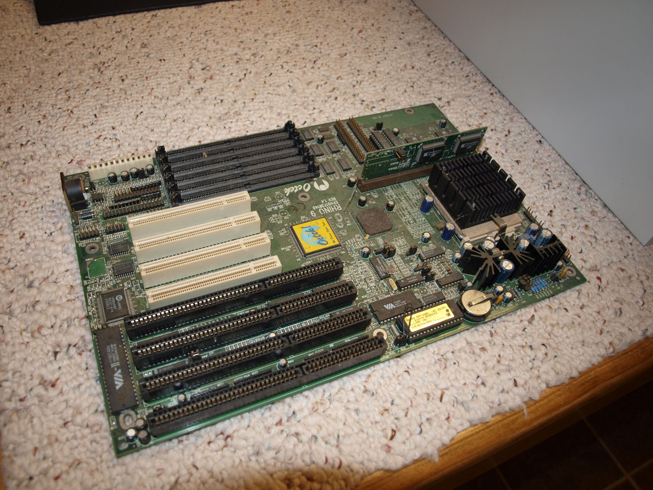

    What's so special about this one? hmmm...
    Closer look:

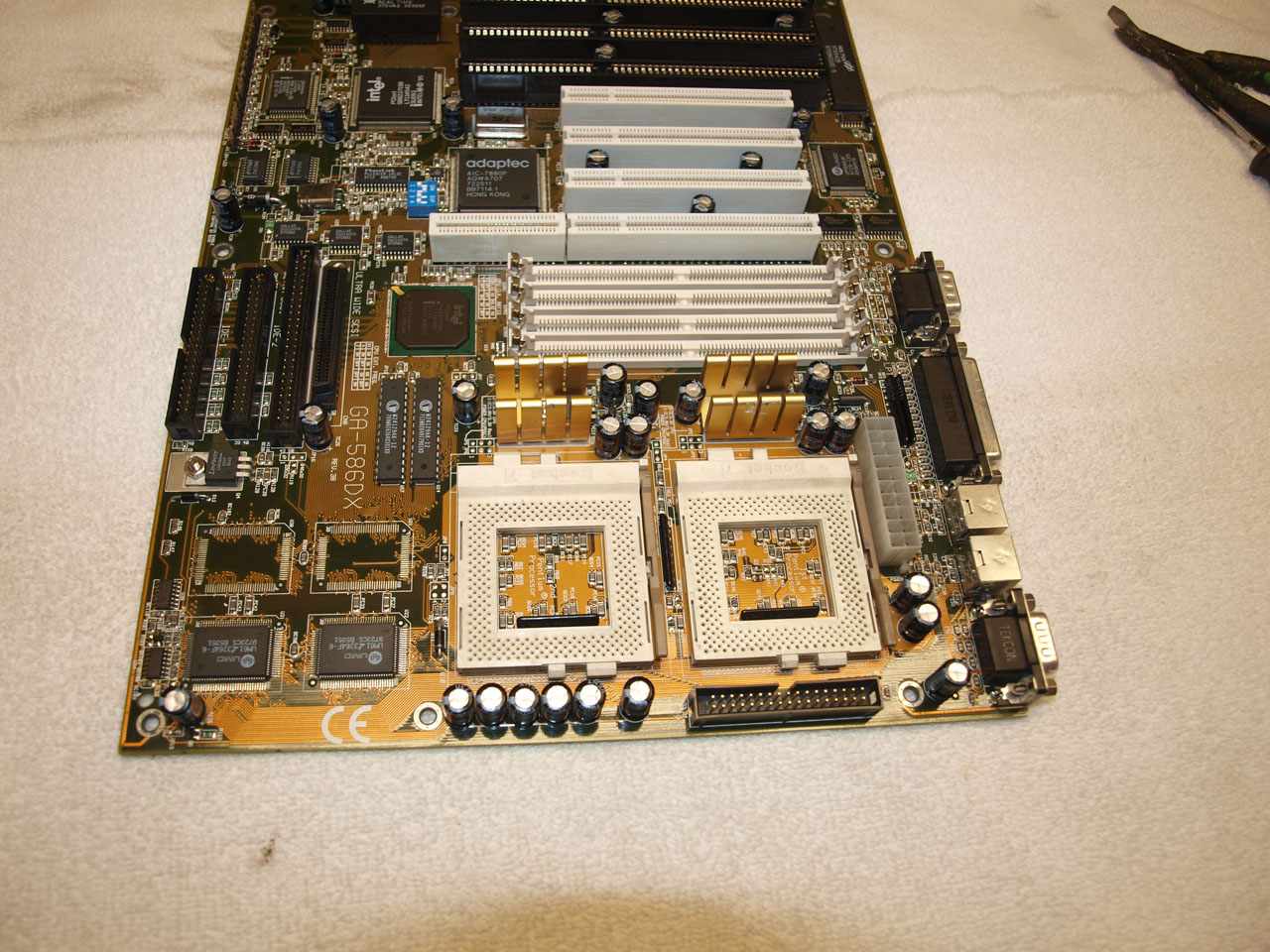

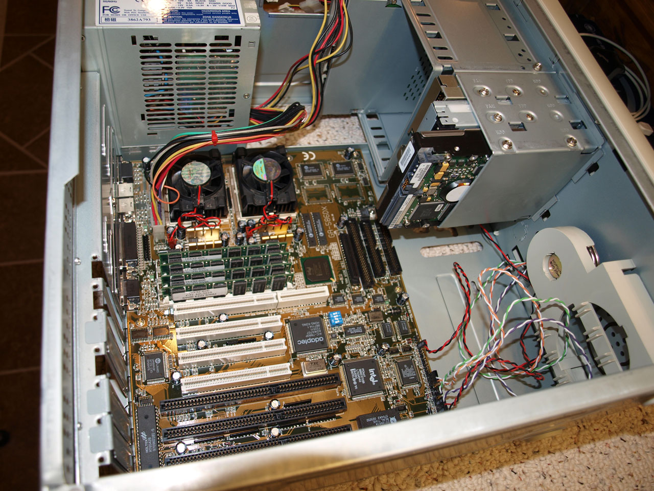

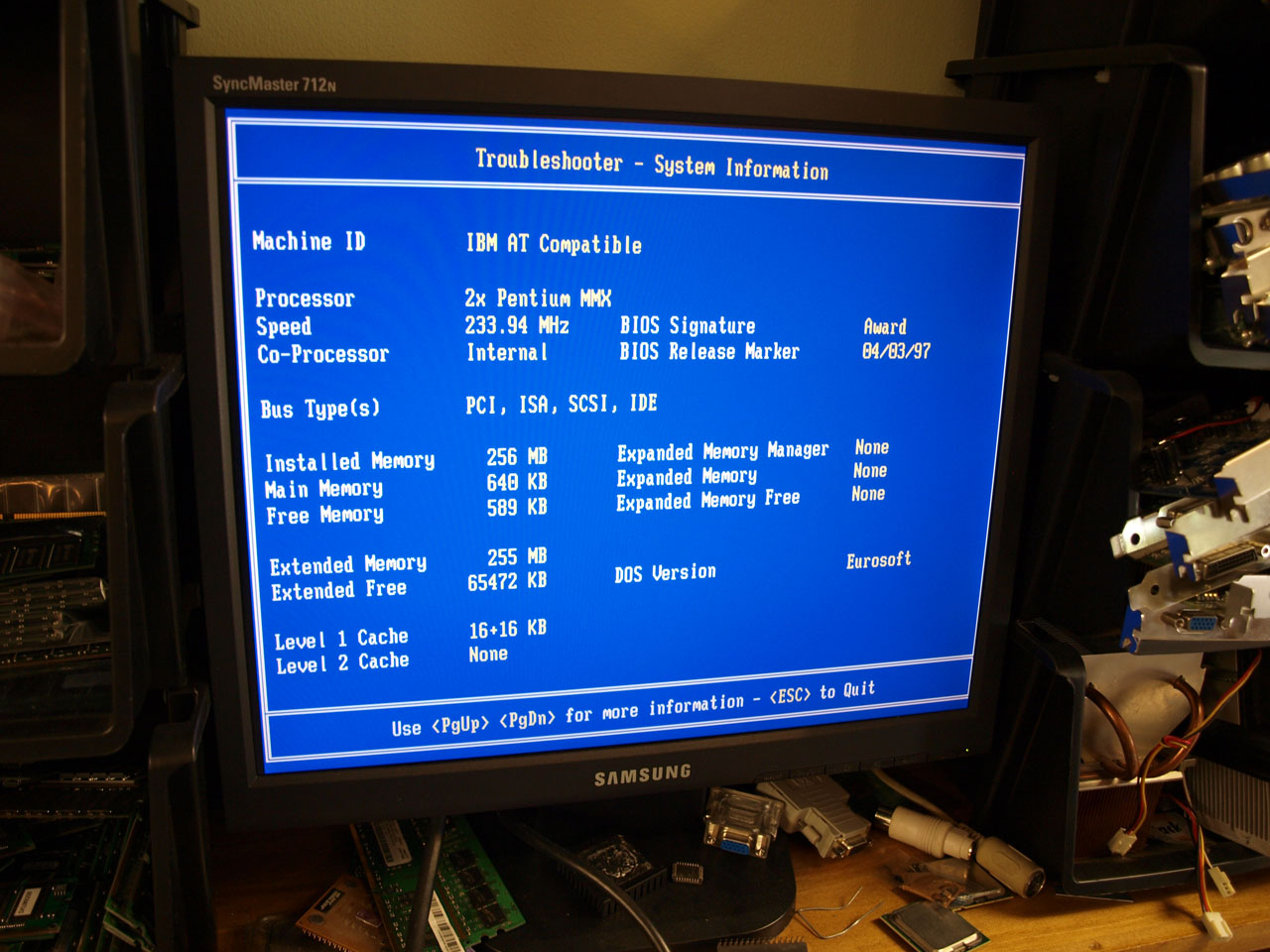

    Yes, that's a dual socket 7 board....the only one ever made in standard ATX form-factor. Every other dual socket 7 board was either AT or proprietary.
    Mated up with a pair of Pentium Classic 233MMX CPU's, and 256mb RAM.
    Recapped of course.

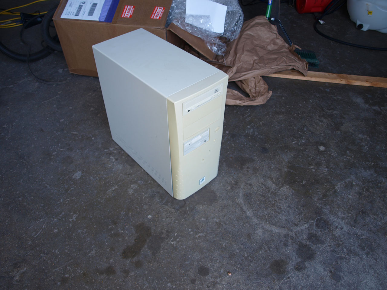

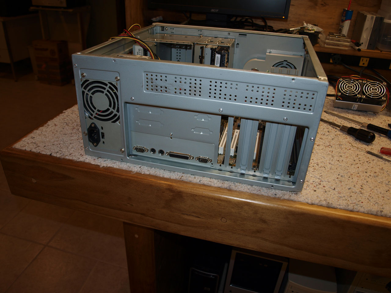

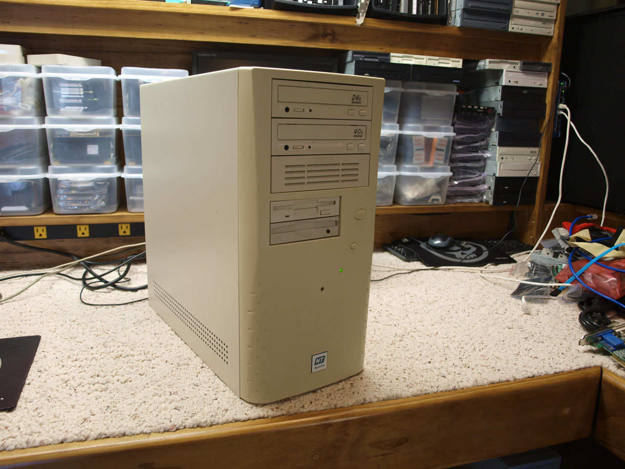

    Attic find.....yellowing ATX case. Looks like I'll have to mix a batch of my yellow removing serum.
    I should have played the lottery!! Of all the f*cking odds!! This case had the correct IO shield for this motherboard....I'm usually never this lucky!
    Not sure exactly what path this one will take....it was a bit of an unplanned/impromptu build.....

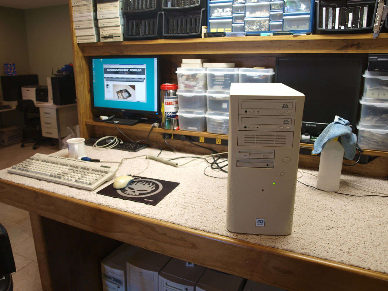

          Re: Gigabyte GA-586DX Retro Goodness

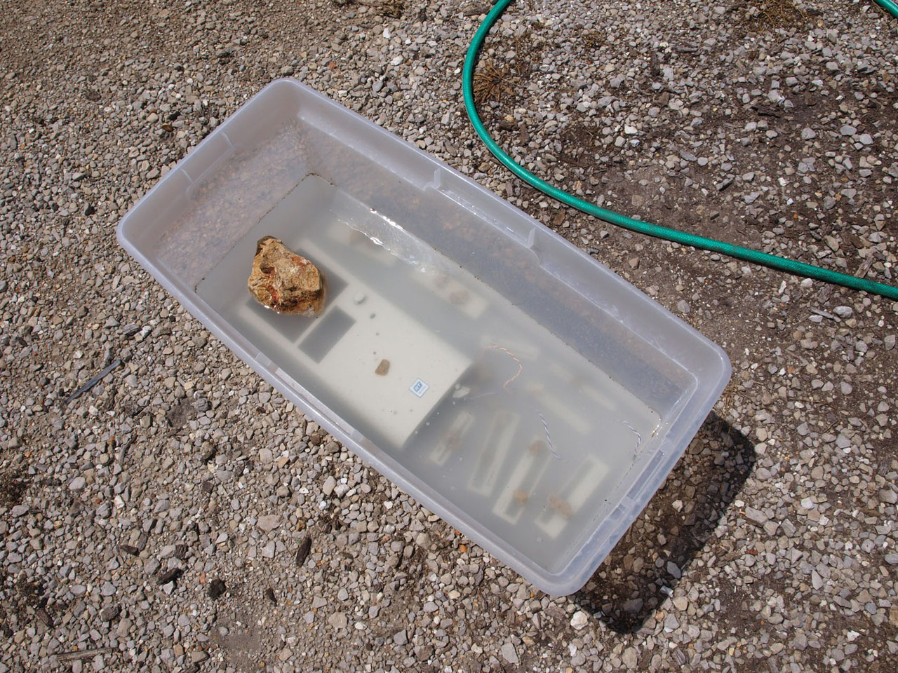

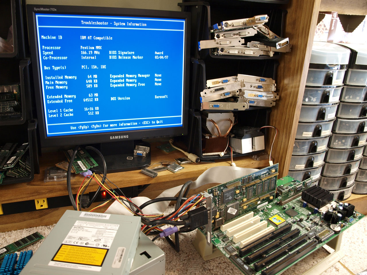

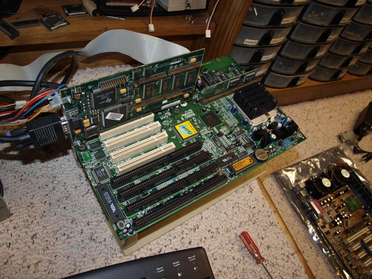

          Kind of taking some direction with this build, but pondering it a little while I get the 'usual stuff' done.
          Metal parts of the case washed & dried.
          Plastics bathing in the yellowing removal soup:
          Starting to reassemble.
          Much better!!
          hardware-wise, a few interesting things have turned up in the parts boxes...such as an 8mb Matrox Millennium PCI GPU (2mb base with the 6mb expansion module). I bought this new way back when..... I also uncovered an AWE64 ISA sound card. I think there's a voodoo1 around here somewhere too. I have a voodoo2, but that's a couple years newer than this system's era.

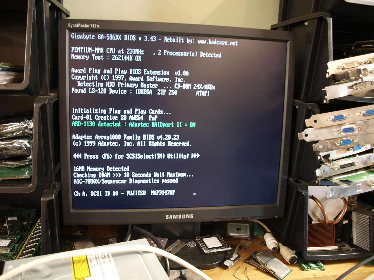

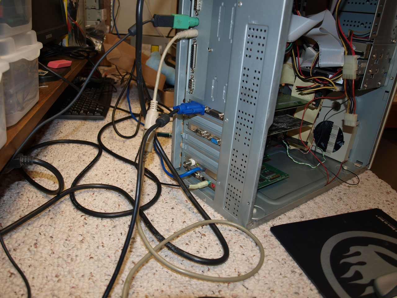

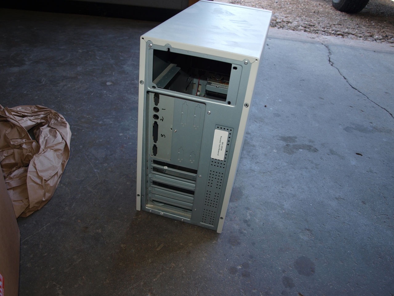

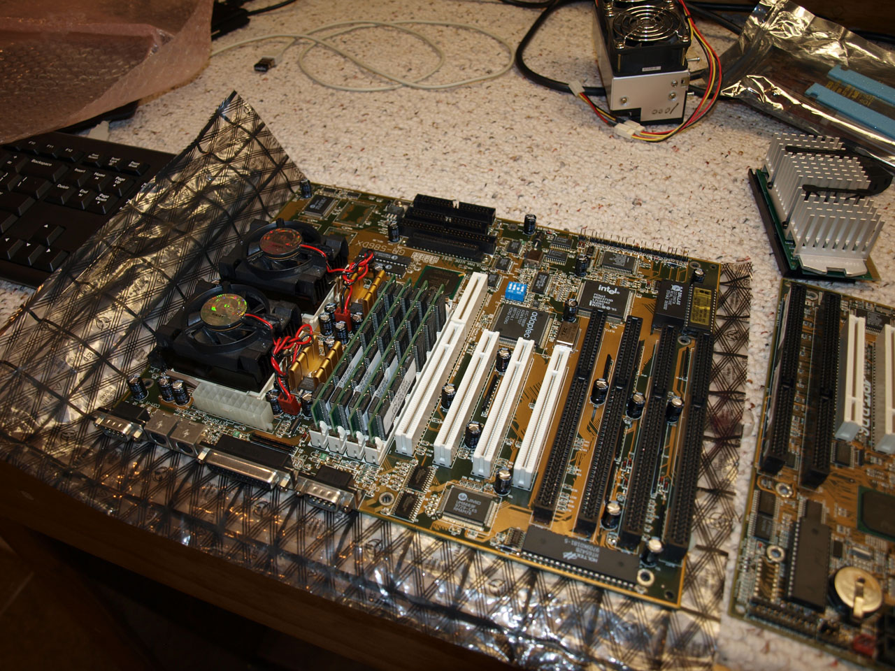

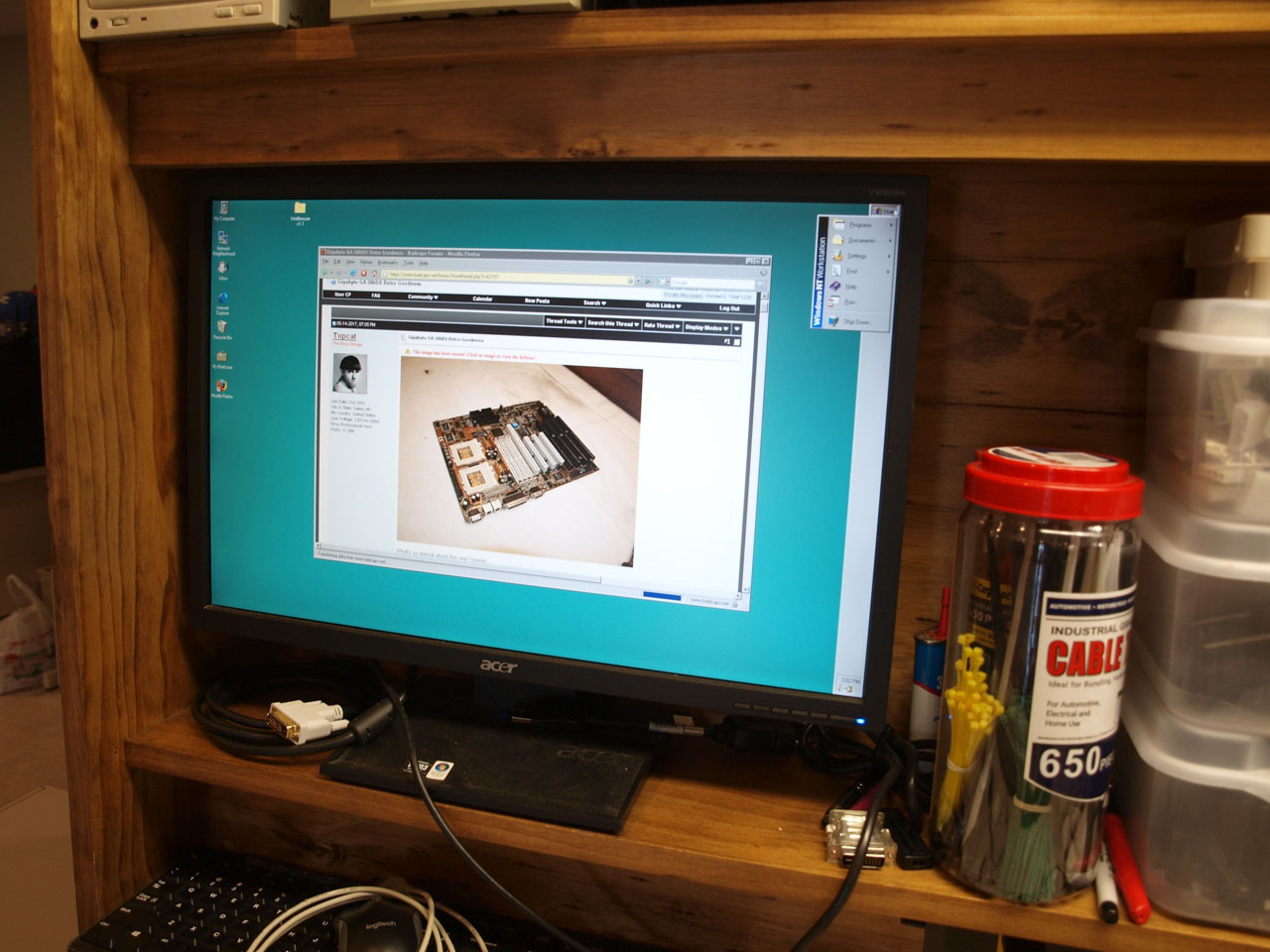

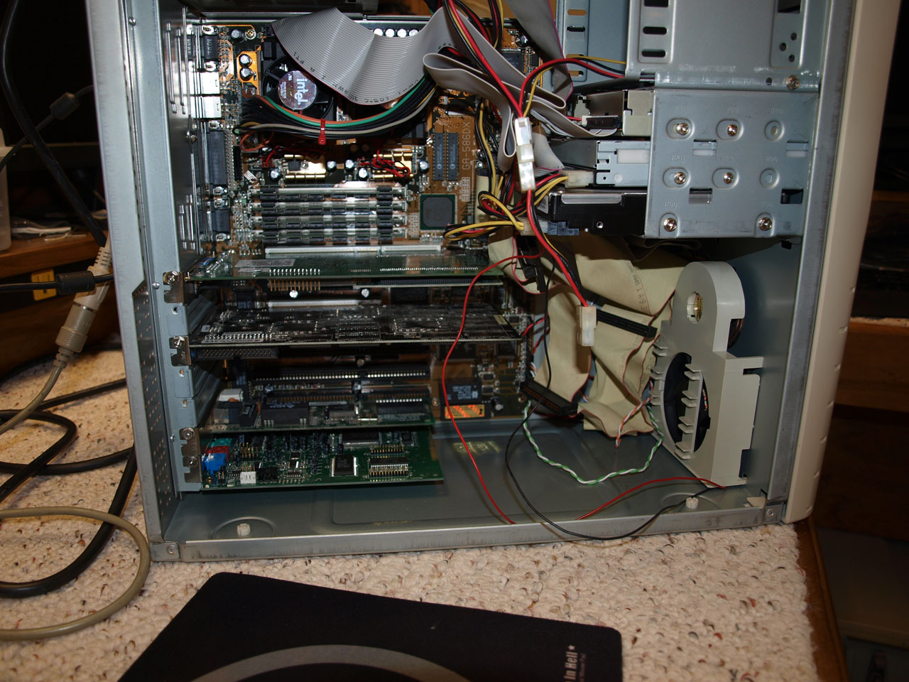

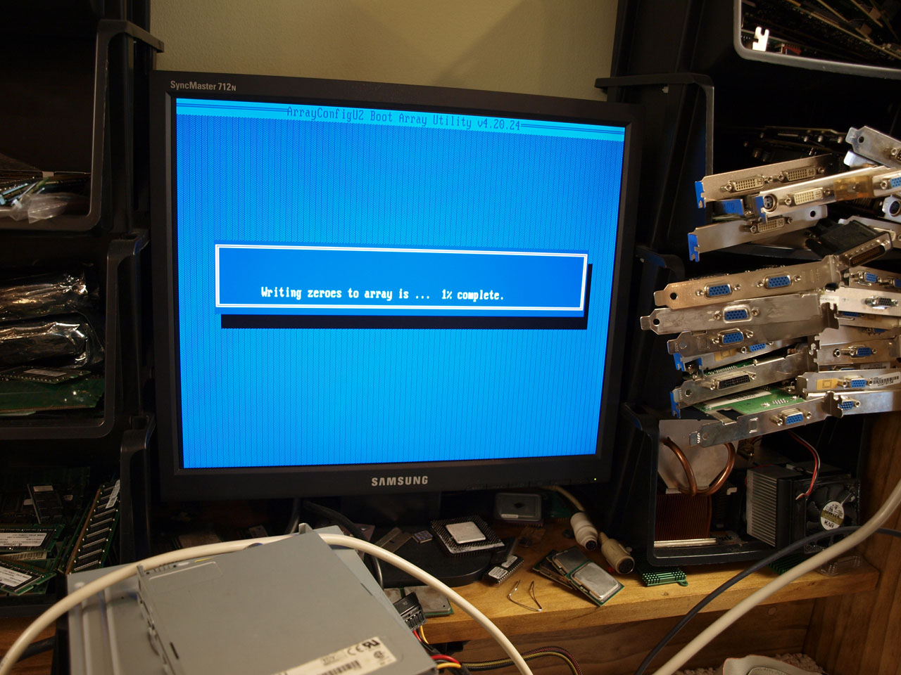

                This one is about done....except the voodoo2 VGA passthrough cable seems to have sprouted legs....but I did find a pair of AWE64's, so I have another one for another project.
                ...and up & running...

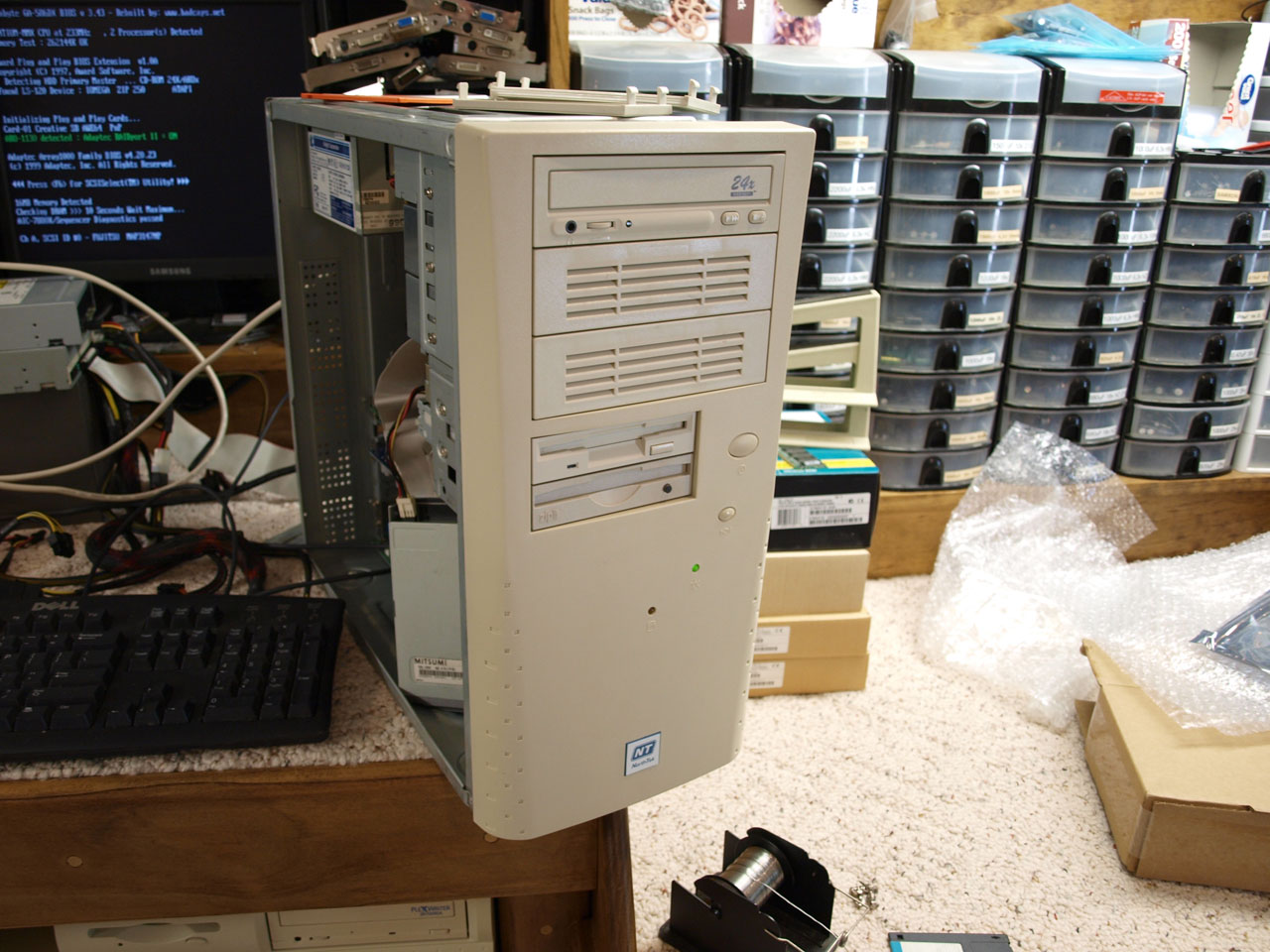

                ...but look what I found when in the attic looking for something else:
                After a hotwash:
                Another build to come in due time.

                  Dug up a lot of bones with this little chunk of old PC witchcraft!!
                  After about an hour of digging through the dustballs of adaptec firmware archives....more later.

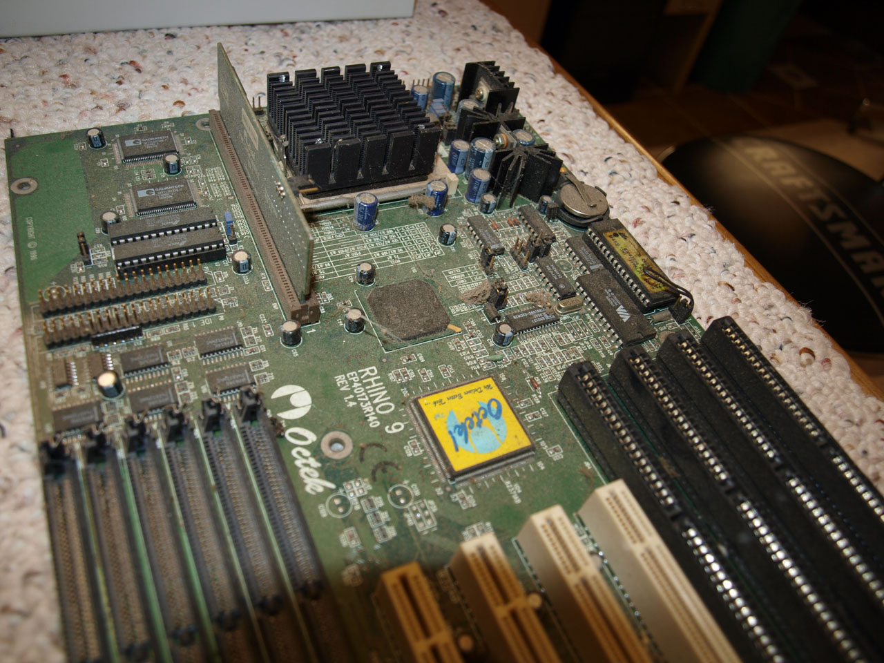

                    Gotta keep it short for now, but those Octeks are neat. Bet it POSTed like it was just turned off yesterday. Don't forget to DeOx (or equivalent) the cache module's contacts if ya haven't already.
                    The late AT era, where chipsets became much more integrated over a short time, evolving from many individual parts with 74xx tying things together, to highly integrated subsections- DMA/RTC, CPU/RAM, IO bus(ses)/FSB, with a sprinkling for "glue logic."
                    A little BIOS modding I see on the GigaByte? Enjoy your AWE(some)64.

                                That Ocktek board looks very familiar,. Looks like one I think I sent you in a big box off goodies.

                                  It might be....it's been here a long time.

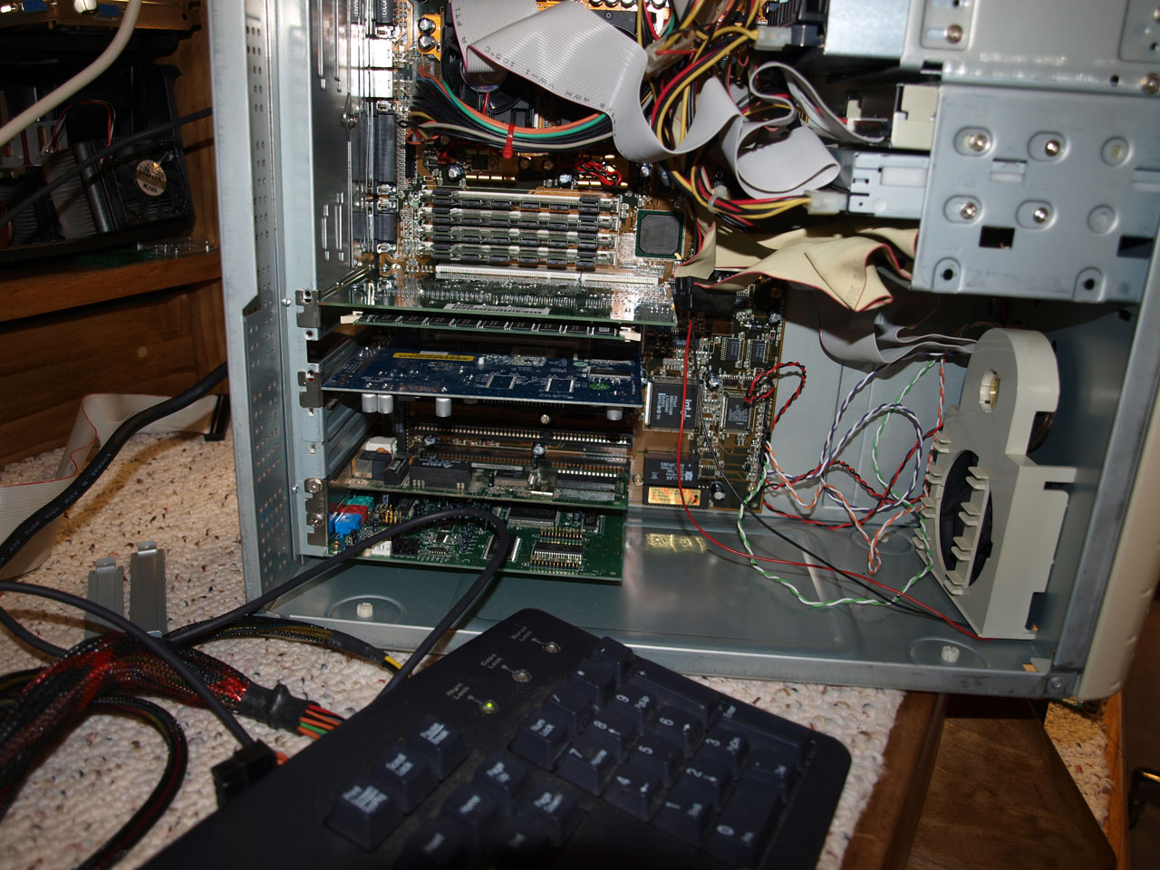

                                  I tossed 4x 128mb SIMM's in it, RAM is now maxed @ 512mb. The scsi raid setup isn't playing nice, and performs awful.....but I have some more ideas!!

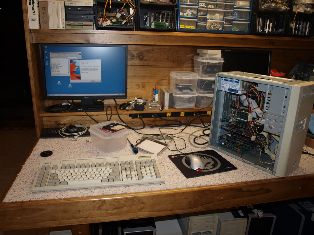

                                        Just a little update on this system.....I was bored this morning and felt like tinkering with something....and dragged this useless but fun system out.... Win2k didn't perform that great on this, and since there's no USB, its a great NT4 candidate.... All the hardware has NT4 support, and I actually had all the drivers in my archive....so what the hell!!
                                        Firefox 2.0.0.20 is the last version of Firefox supported by NT....and functions good (compared to FF3.8 & FF12 on Win2k). Age of Empires also functions nicely....funny thing is, it performs no better on modern hardware than this system!!
