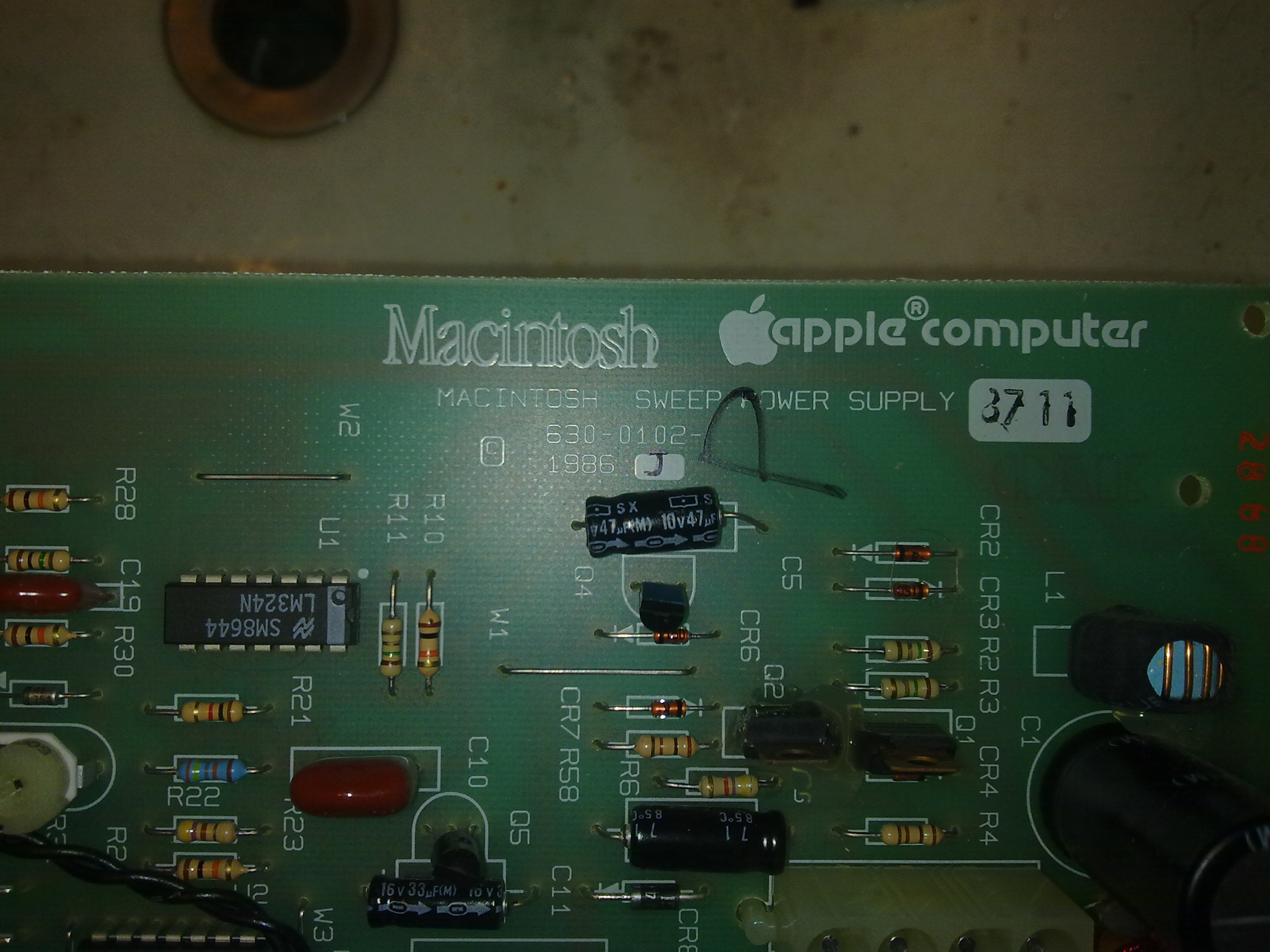

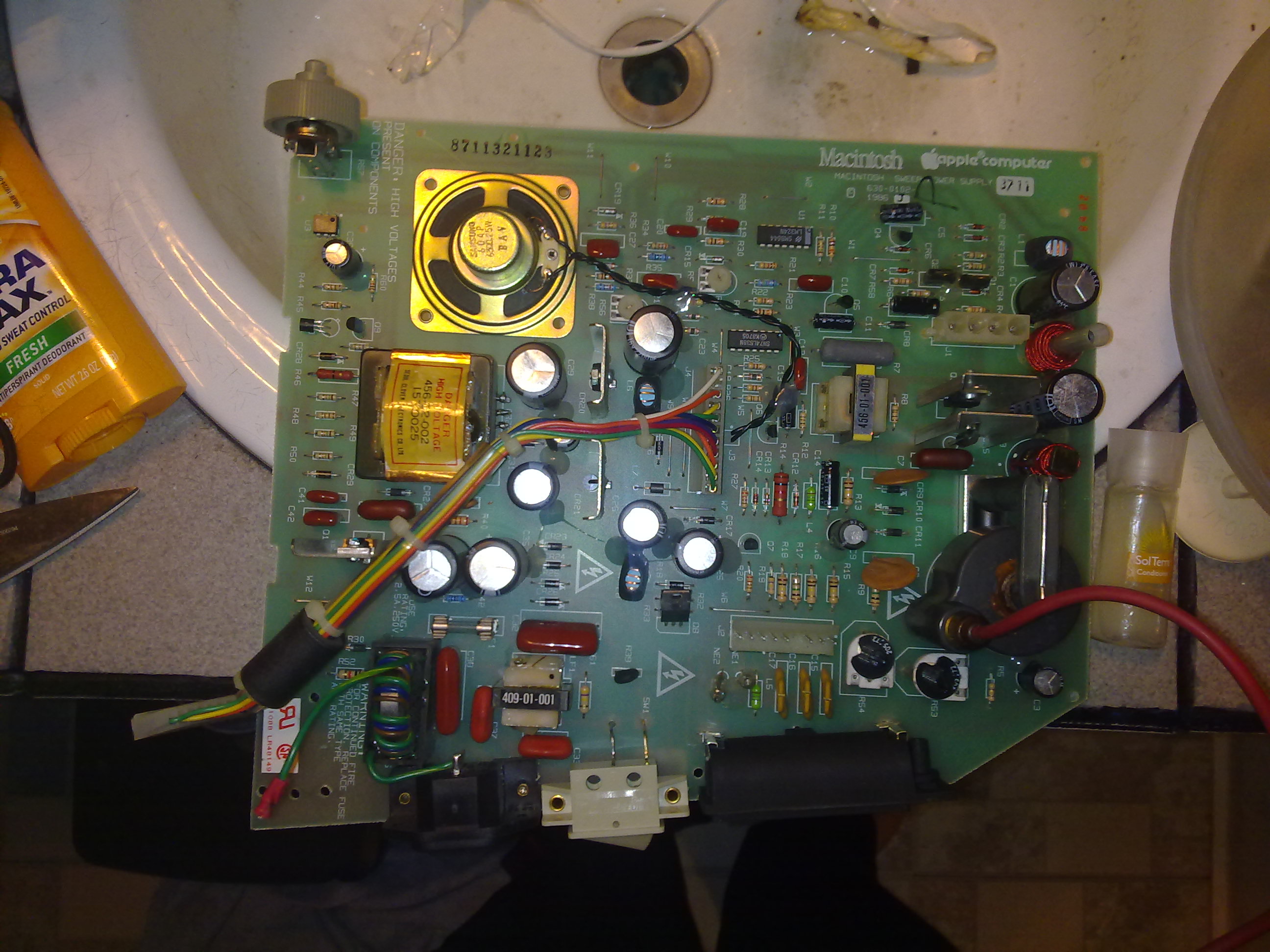

    I have a Macintosh Plus 1Mb with CPU/Memory problems not caused by the PSU. Does anyone know how i can run this thing as a display only? Like for a raspberry Pi?

    Re: Modding a Mac Plus 1Mb
    post a foto of the boards
    i think those use 24KHz refresh - so not a very usefull monitor!

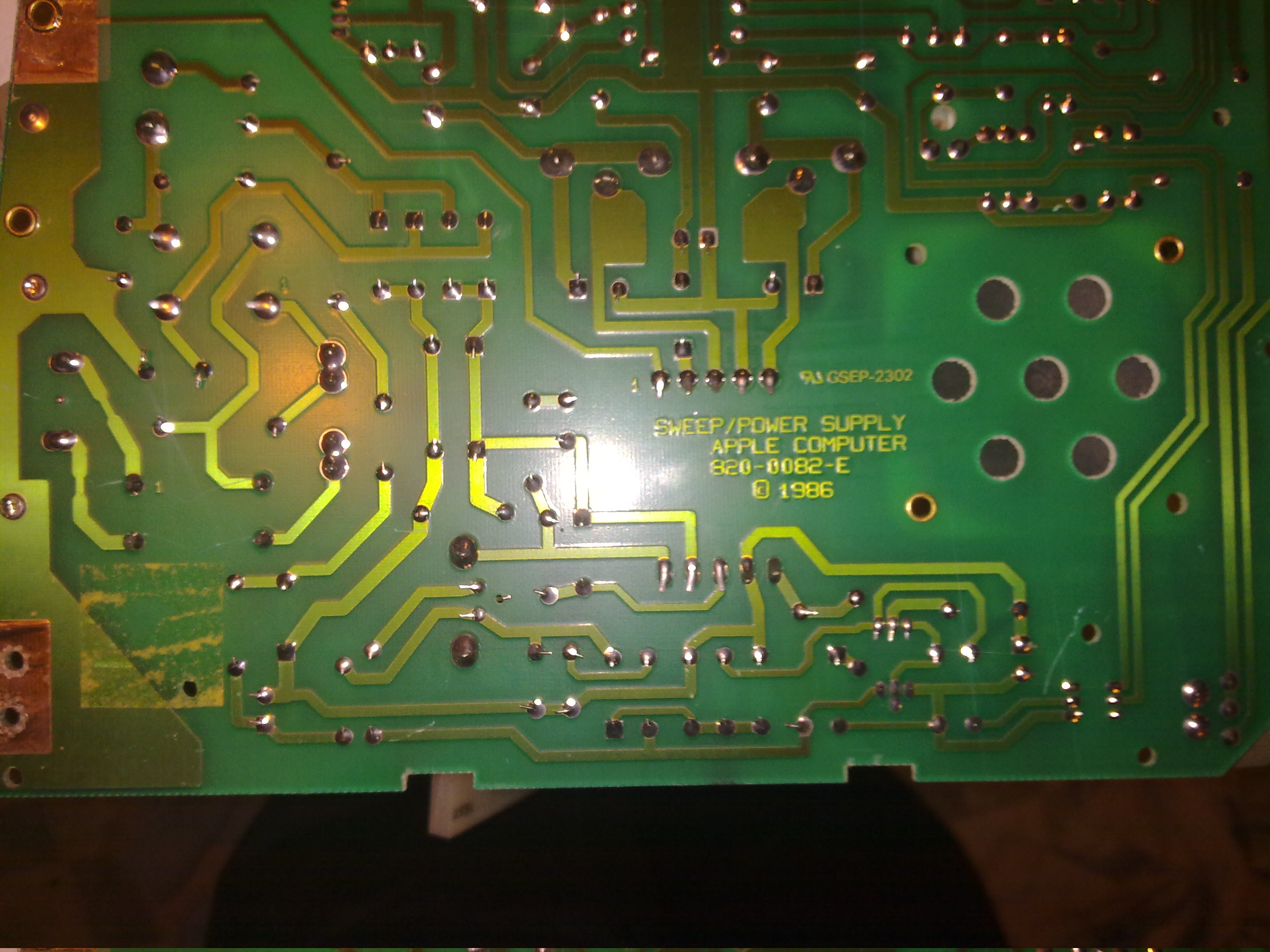

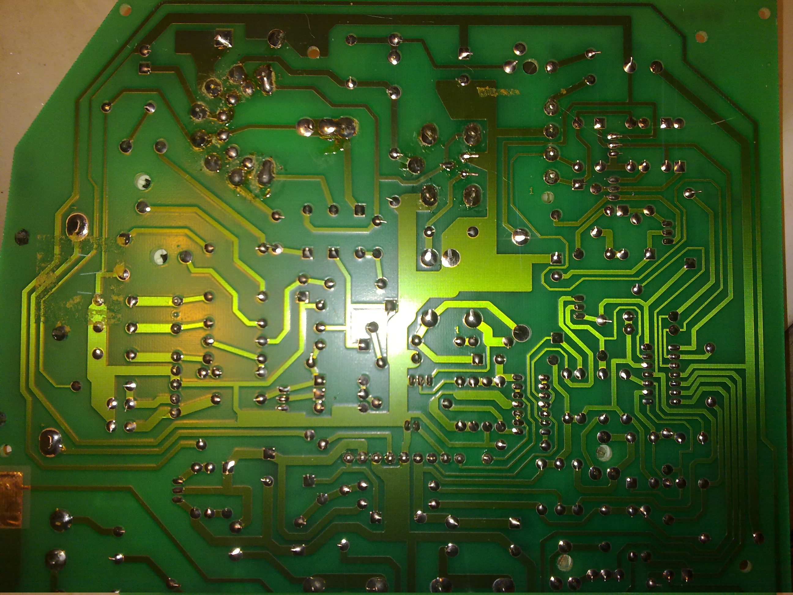

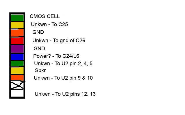

      Here are pictures. The hippy cable is what runs between the logic board and sweep board.
      The pins most obvious are the purple one and bottom orange as ground, and top yellow is speaker drive.
        Blue is 5v. It ties to the CMOS/PRAM battery post through a diode.

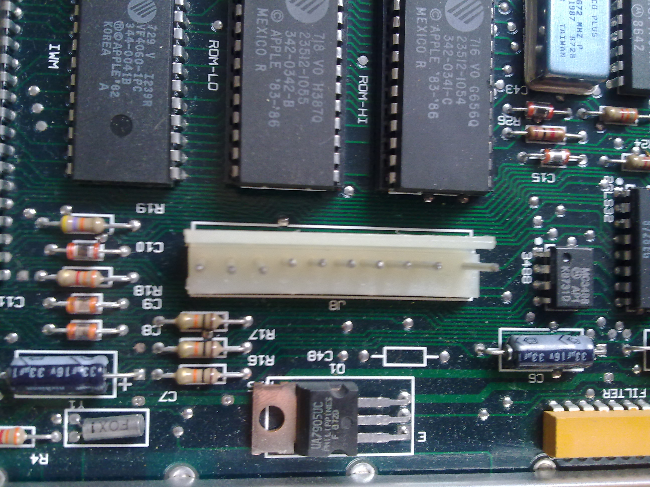

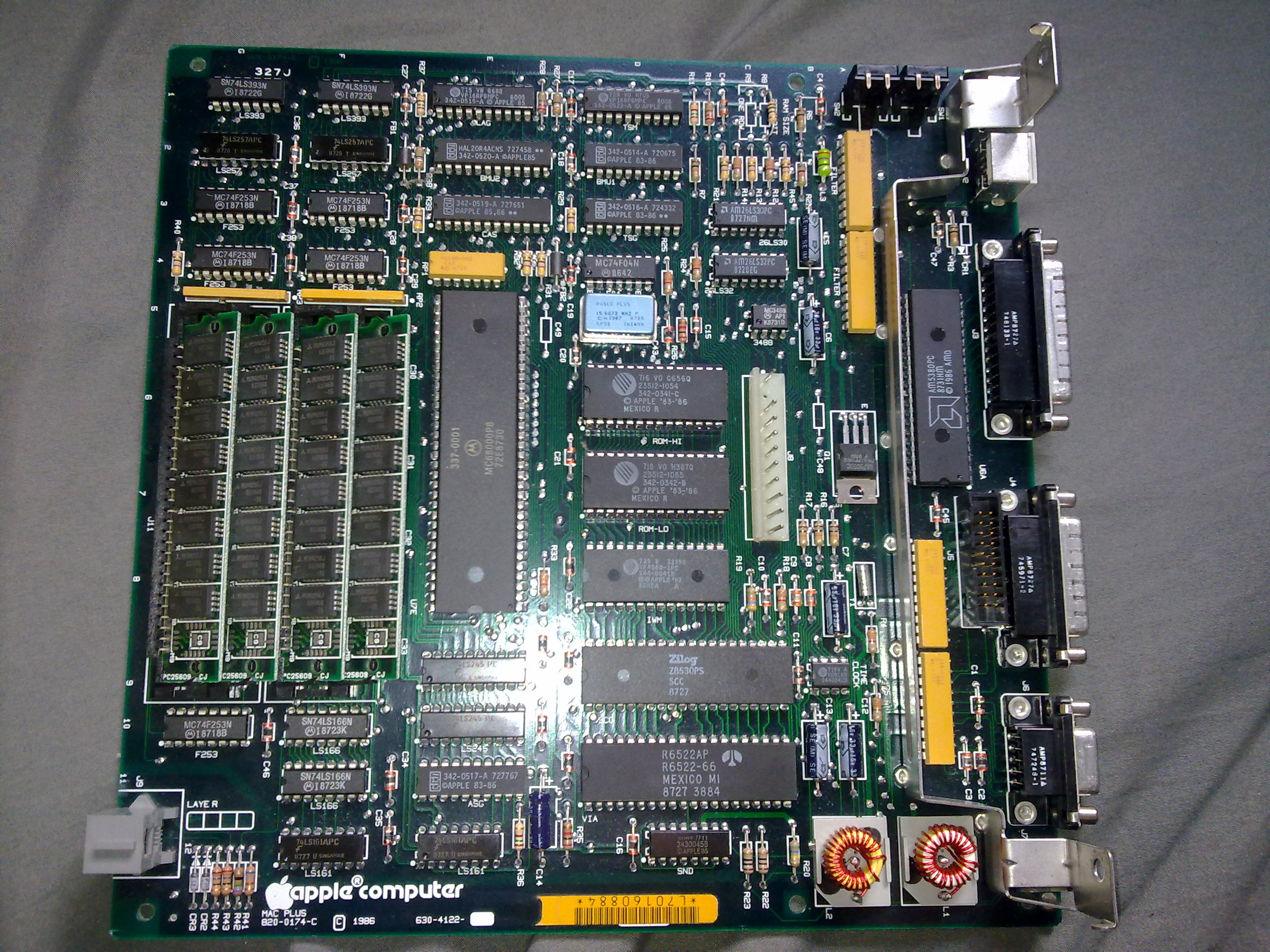

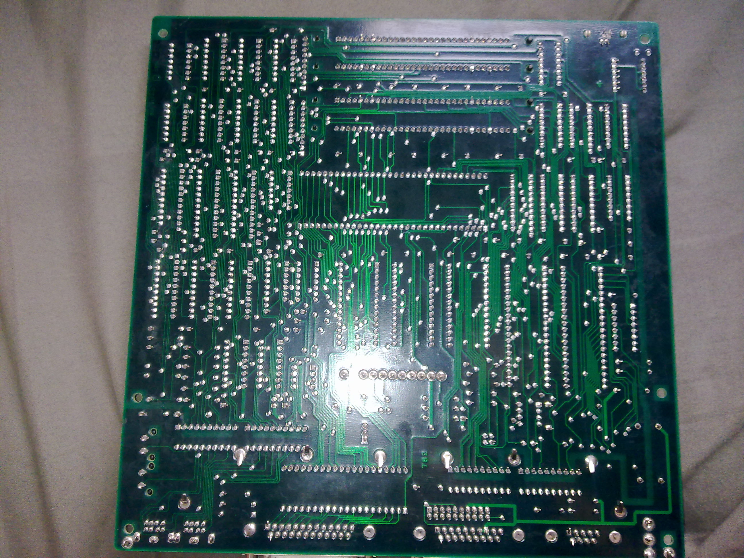

          foto's of the logic board?
          • goontron
            5000!
            • Dec 2011
            • 4108
            • US
            Here we go.
            Follow the white rabbit.
              • 31283
              try replacing the ram.
              or giving it a damned good clean.
              also, replace the electrolytics - they appear to be the only smoothing on the thing!!
                Well, i cleaned it, and tested the caps. No dice. Just going to send it to scrap.
