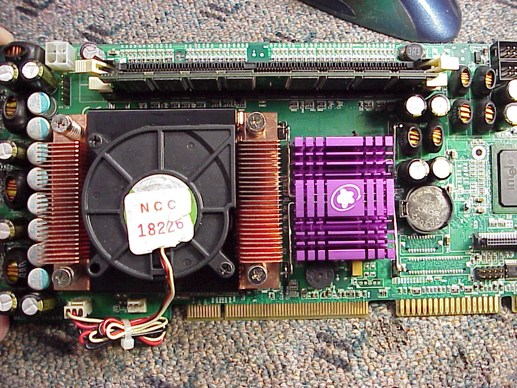

                              like this screamer?
                              sounds like a dental drill!
