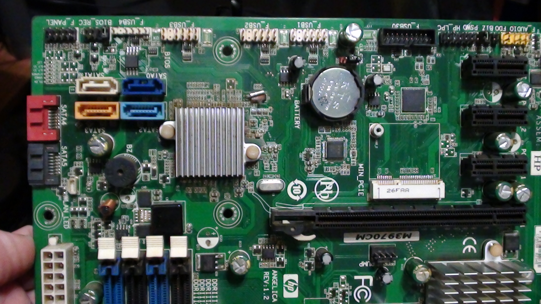

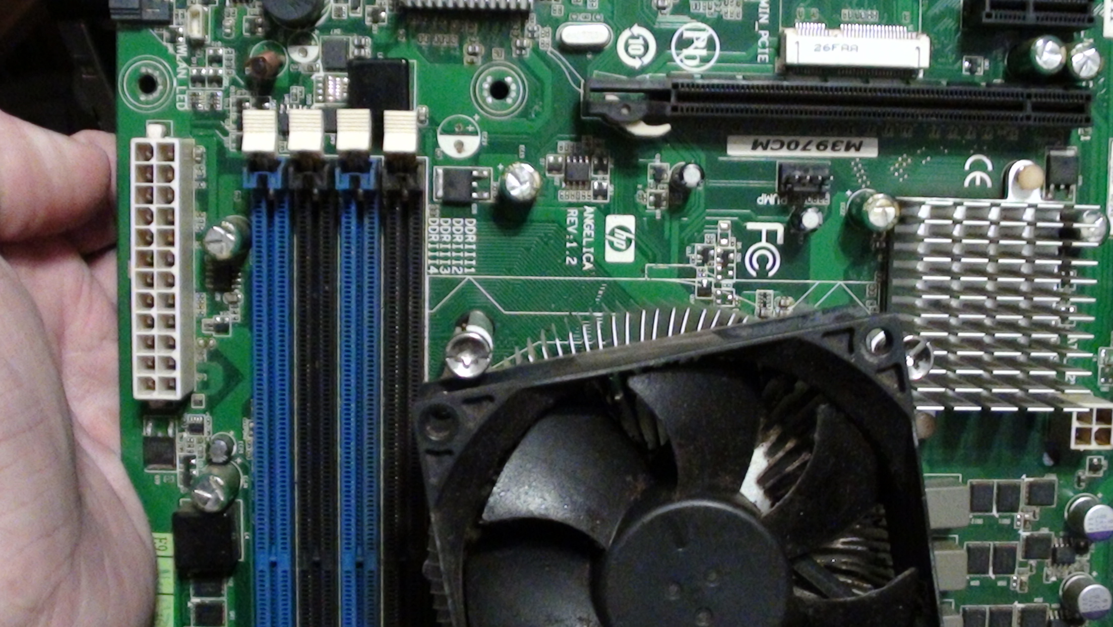

    I have an HP M3970CM motherboard here. There's a four pin header that says PUMP. The customer moved the motherboard to a new case. The power supply has a two pin header. For some reason, he thought the two pin header plugged into the four pin header. It killed the motherboard. When I manually try jump starting it (shorting the pins on the panel header), the fan will almost start. It'll jump a little. He fried something out on the motherboard and I was hoping someone might want to give some suggestions as to what he might have fried.
    I was thinking he might have actually fried the CPU. I've checked the various fuses. There's three caps near the 4-pin header. I pulled them, they're good. It's a socket AM3r2 and I don't have a CPU I can try in there. Any suggestions? I'm thinking of just telling him he needs a new board, but the ones I've found are a bit pricey.
    Thanks!

    have you got a picture of it ?

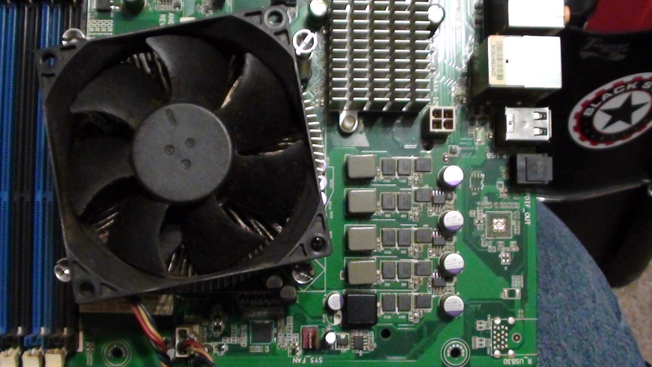

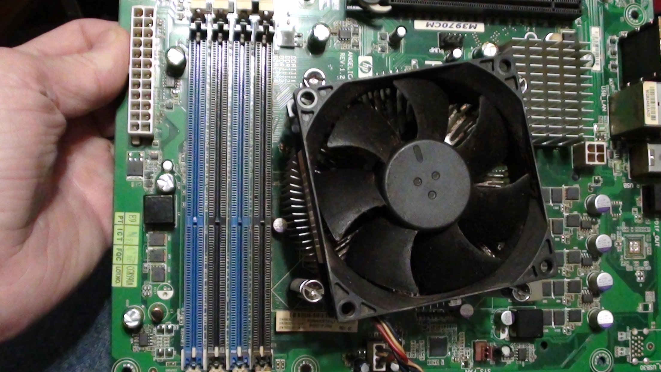

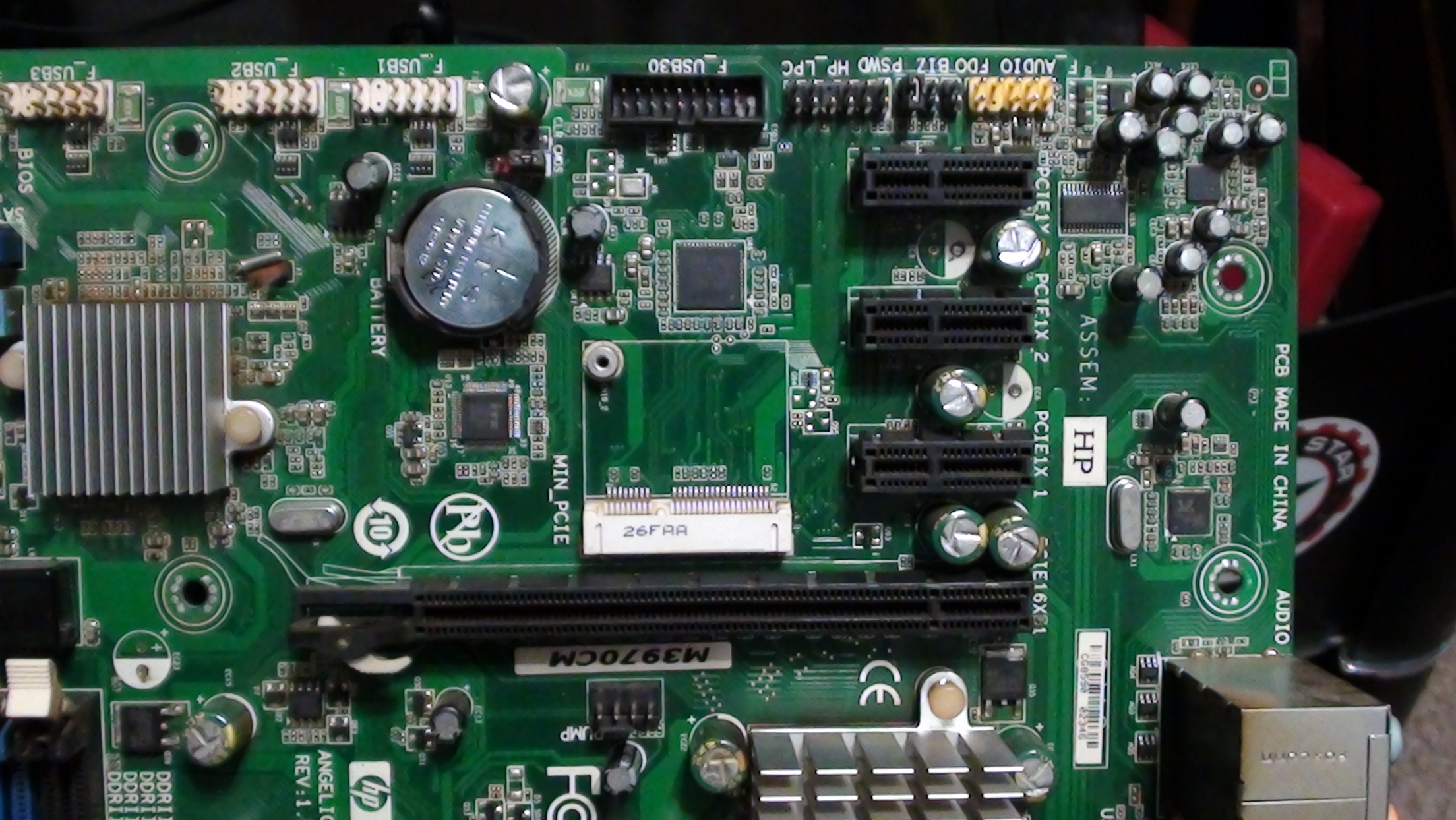

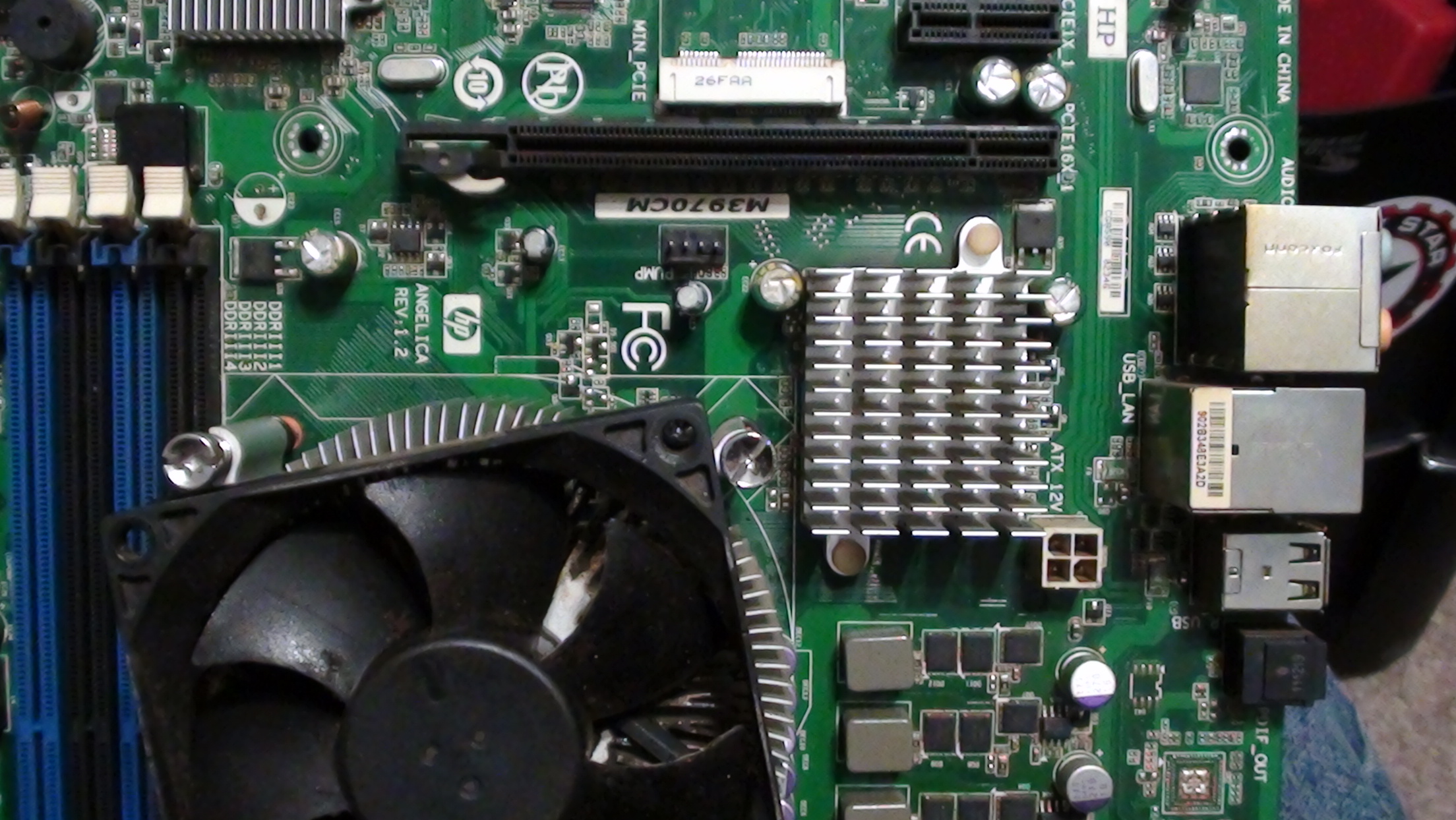

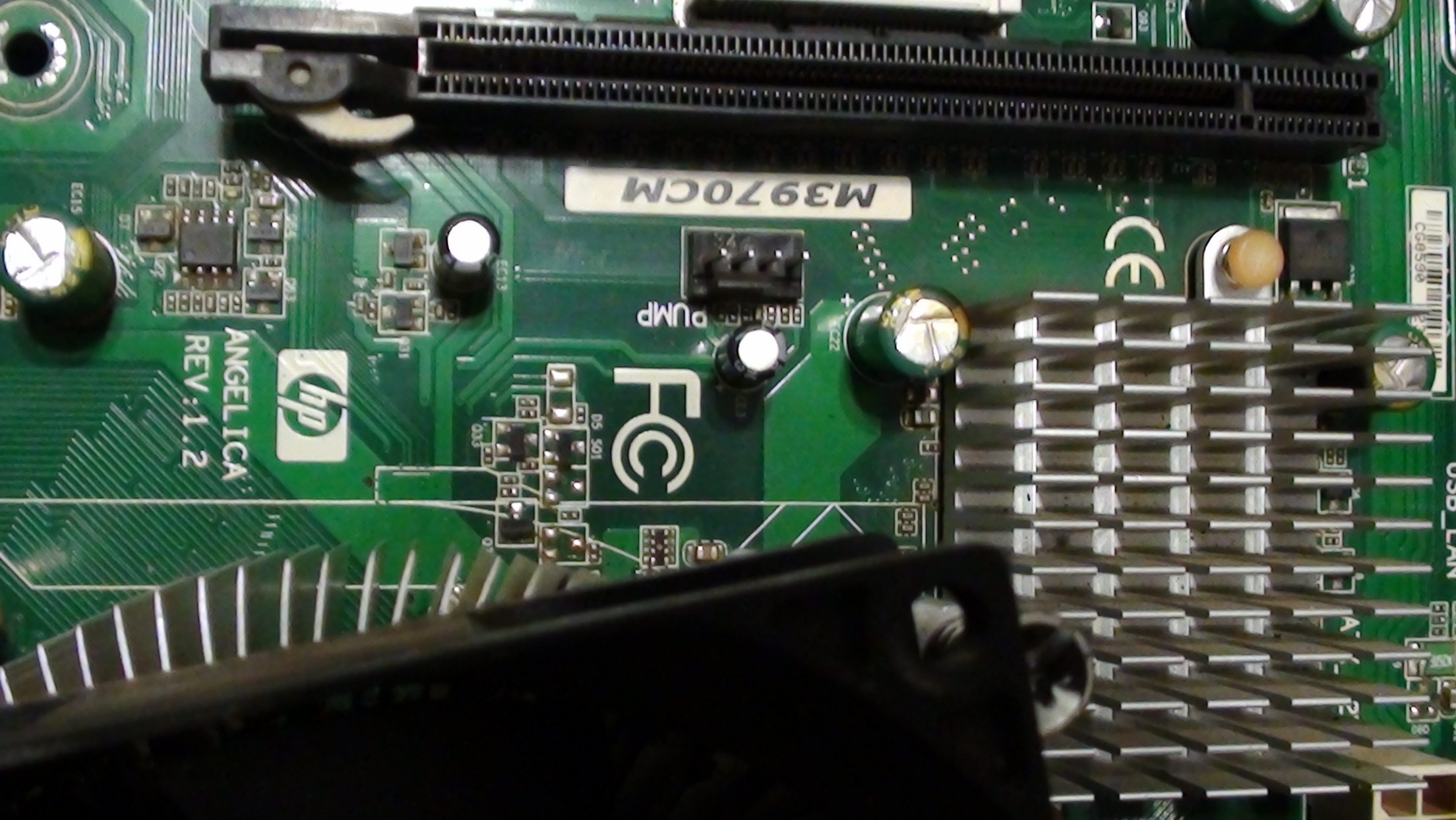

      I'll upload them now, but I don't know if they'll do any good. The one that shows the header with the word PUMP is where he plugged the power into it. I'm thinking it might very well be the CPU that's dead. I can't really think what component(s) would fail that would make the board act this way (minus the fuses that I've already checked). The CPU fan just jerks for a second when I try turning it on, the power supply doesn't turn on at all. If I only plug 20 of the power supply pins into the motherboard, we get a little action, but when I plug in those extra 4 pins, nothing.
      Hopefully someone with a little more knowledge will be able to give me some test points on the board or something to check for various voltages or something.

        be good to at least know which pins were shorted or what sort of power was put into the board in the wrong place and access to a schematic / service manual .
        knowing what pump does would be a starting point .. i looked for a manual but found nothing .

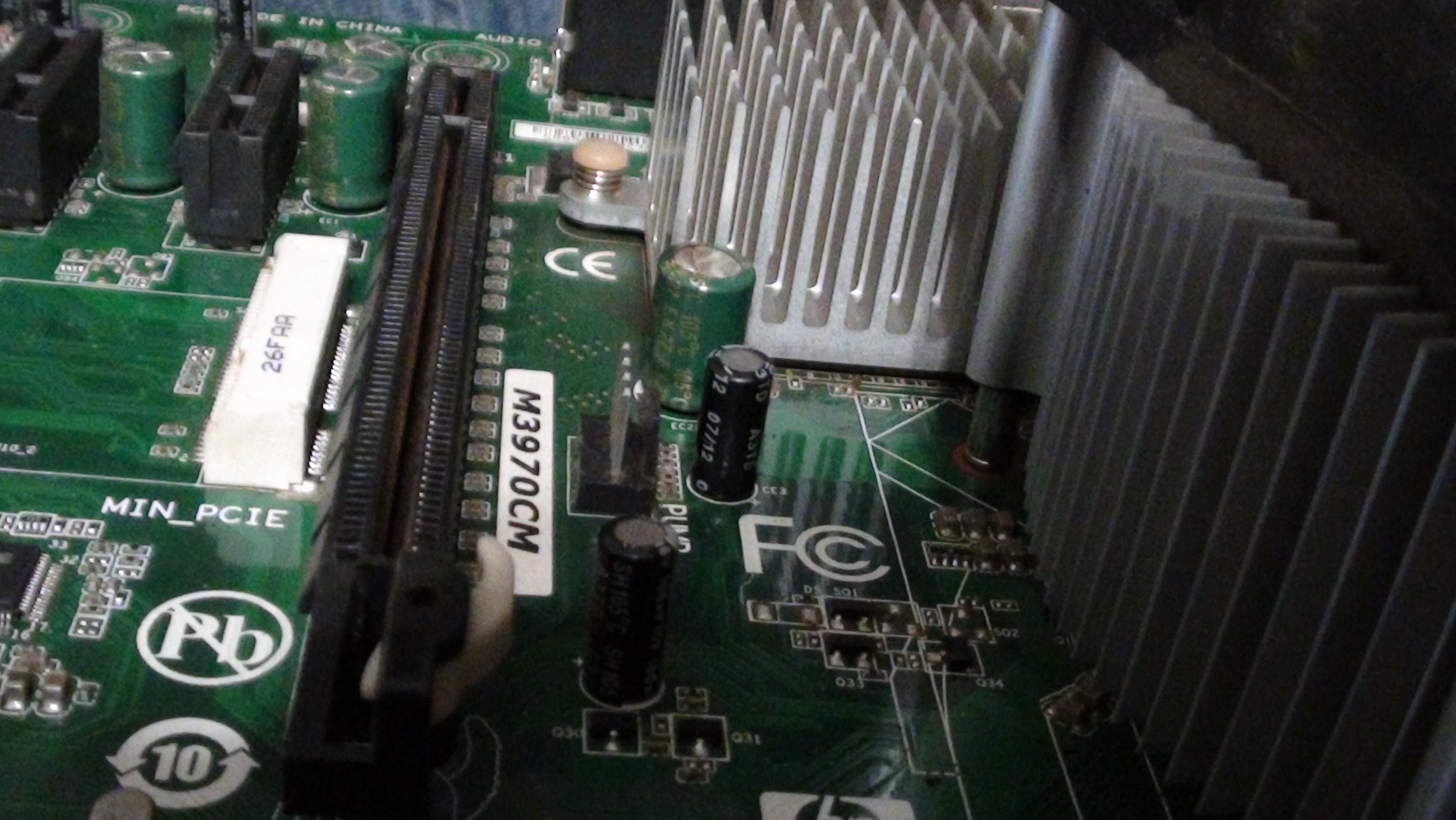

          The pump header is to power a pump for liquid cooling. This person didn't use a liquid cooling setup. I can put a DMM to the power supply plug he had plugged in there, but I'm guessing it was 12VDC. Notice the cap next to that one heatsink. It's discoloured, but tests fine. There's a few components that are discoloured around that silver heatsink. Is that the AMD 970 chipset under there? I see the AMD 970 chipset uses a SB950/SB920 southbridge. Is that built into the AMD 970 or something? I couldn't find a replacement AMD 970 or maybe I'd attempt to replace the one under the heatsink (if that's what's under there).
          Here's a link to the manufacturer's website for this PC:
          http://support.hp.com/us-en/product/.../model/5296860
          It lists the board as an Angelica2 M3970AM, however, the sticker on the board says M3970CM. From what I can tell, the 2nd to last letter is maybe just a revision. There's an AM, BM, CM (maybe more?).

                If that PUMP header is supposed to supply power it will probably have a MOSFET or regulator or something which is supposed to control it.
                When he applied power to it instead, probably that part has blown from the reverse voltage and gone shorted. That will be why the board doesn't start up - the PSU or the board sees the short and shuts down again straight away to stop things catching fire.
                Unless the CPU supplies power to the PUMP connector, I doubt it has been damaged.
                Without a schematic it will be hard to figure anything out though. You could check the assorted SOT-23 devices nearby to the connector and maybe the 8-Pin chip at the end of the PCI-E slot for shorts. It's possible they are responsible for the PUMP control, since they are nearby - although it's not guaranteed.
                Do you have a pinout for the PUMP connector and do you know what he plugged in where?
                If you are really unlucky he may have sent 12v into a 3v or 5v logic input (for reading pump RPM or temperature or something) and blew the SIO chip or such.

                      There's 7 little SMD components right behind that 4-pin header. They might be hard to see in the picture. They're extremely hard and I'm certain some of them are dead. It might be impossible for me to replace those. I could remove them, but I might not ever get them back on, because of how small they are.
                      For those SOT-23's, are you talking just about the ones around that 8-pin chip or are you talking about all the SOT-23's that are anywhere near the 4-pin header? I have a device that will allow me to check those SOT-23's, but I have to remove them. Is there a way to test them for a short while they're in-circuit still or do they have to come off? For the 8-pin, just take a DMM and check the continuity between all the various pins? Thanks!

                            You can test all the SOT-23 components near the header without removing them, just check there are no shorts between the pins. You might get lucky.
                            If you can find which rail the short is on (check all the rails resistance to ground from that 4-pin connector on the main ATX, since it acts differently, the problem circuit may be powered from that connector) you might be able to apply power externally and find out which part heats up.
                            Use current limiting so it heats rather than smokes (and you can still read the label). There's the trick of putting alcohol on the board and seeing where it evaporates first. That will show you what is getting hot.

                              I took the DMM and set it to continuity. I checked the resistance between all the SOT-23 pins, there was always continuity, but nothing that says anything like 0 ohm. I had a couple that showed something like 14Kohm or so. I could check again if you think that isn't right.
                              I took the DMM and did the same with that 8-pin IC and I want to say there was just two pins that showed 0 ohm. I'll try finding a datasheet for it, but I'm thinking those two pins might be GND. If it sounds like the CPU is good, that's kind of good news. It makes buying a new motherboard for him not so nerve racking. I always hate saying okay, you need <blah> and when <blah> comes, it doesn't fix the problem. Most of the time, there's a way to check <blah> to see if it's bad or not. Sometimes, it's just a educated guessing game. It's most likely it's just the board and not the CPU. Thanks!!!!

                                  I've seen ICs, like dual 555-timers, that have essentially two ICs built into one chip. I was thinking it could be something like that.
                                  Code:
                                  AS358M
                                  G1 (maybe?)
                                  217JJ3
                                  It does not have two GNDs. I'll double check the continuity and make sure I'm remembering it correctly.
                                  Each pin of that 4-pin pump header has an SMD component. I'm wondering what would happen if those SMD components would have shorted out. I'm thinking of just removing them. The 4-pin PUMP header wouldn't work, but if they're faulty (and I'm assuming at least one is), maybe they're preventing the PC from starting and removing them will allow it to start up. It's very hard to check the continuity of them and read any markings, if there are any markings, because of how small they are.

                                    Here's the continuity of the components next to the header. I'll write what I think they are and then the continuity I measured:
                                    Code:
                                    black SMD resistor: 8.17 Kohm
                                    black SMD resistor: 100 ohm
                                    black SMD resistor: 3.91 Kohm (but started at 3.67 Kohm and counted up until it stopped at around 3.91 Kohm)
                                    SMD capacitor: 3.50 Kohm (just counts up and up and up)
                                    black SMD resistor: 0.0000 ohm (could this be causing the issues?)
                                    black SMD resistor: starts at 5 Kohm and counts up to around 6.40 Kohm
                                    SMD capacitor: starts at 9 Kohm and counts down!!!
                                    I guess I'm going to remove those SMD components, if I can. What can it hurt at this point? One of them doesn't look like it's in good shape at all (the SMD capacitor looking one). It appears to be crumbling.
                                    I went back to the 8-pin IC and double checked. I must have been remembering it wrong. There are no two pins that show 0.0000 Ohm resistance, but there's one that shows 0L (Overload, infinite resistance), that's what I must have been remembering.

                                      Removing them didn't make a difference. I think we're just going to call this board bad and try to find a replacement. Without a schematic, it's more or less a guessing game.
