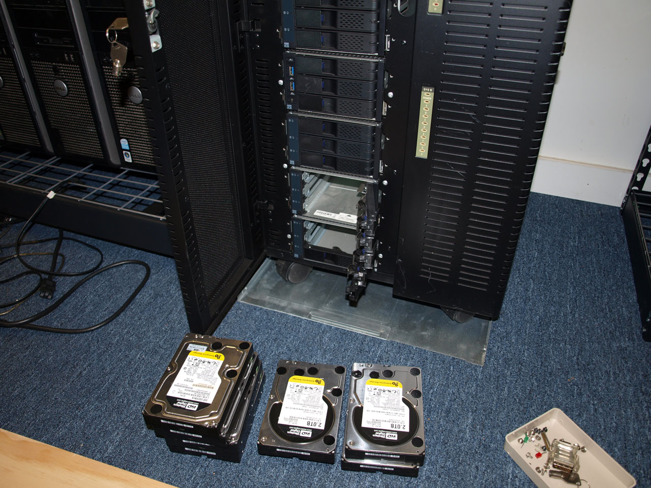

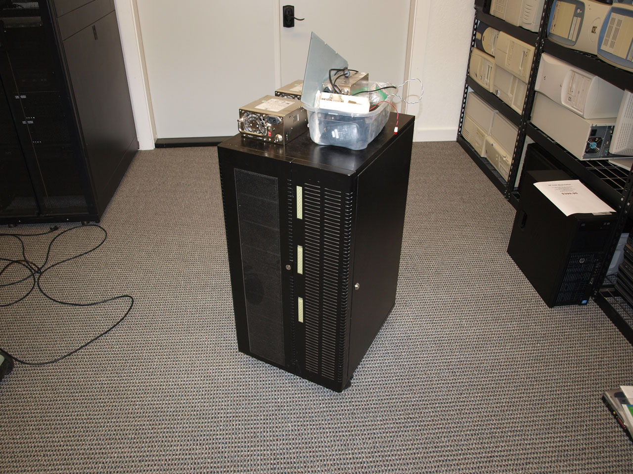

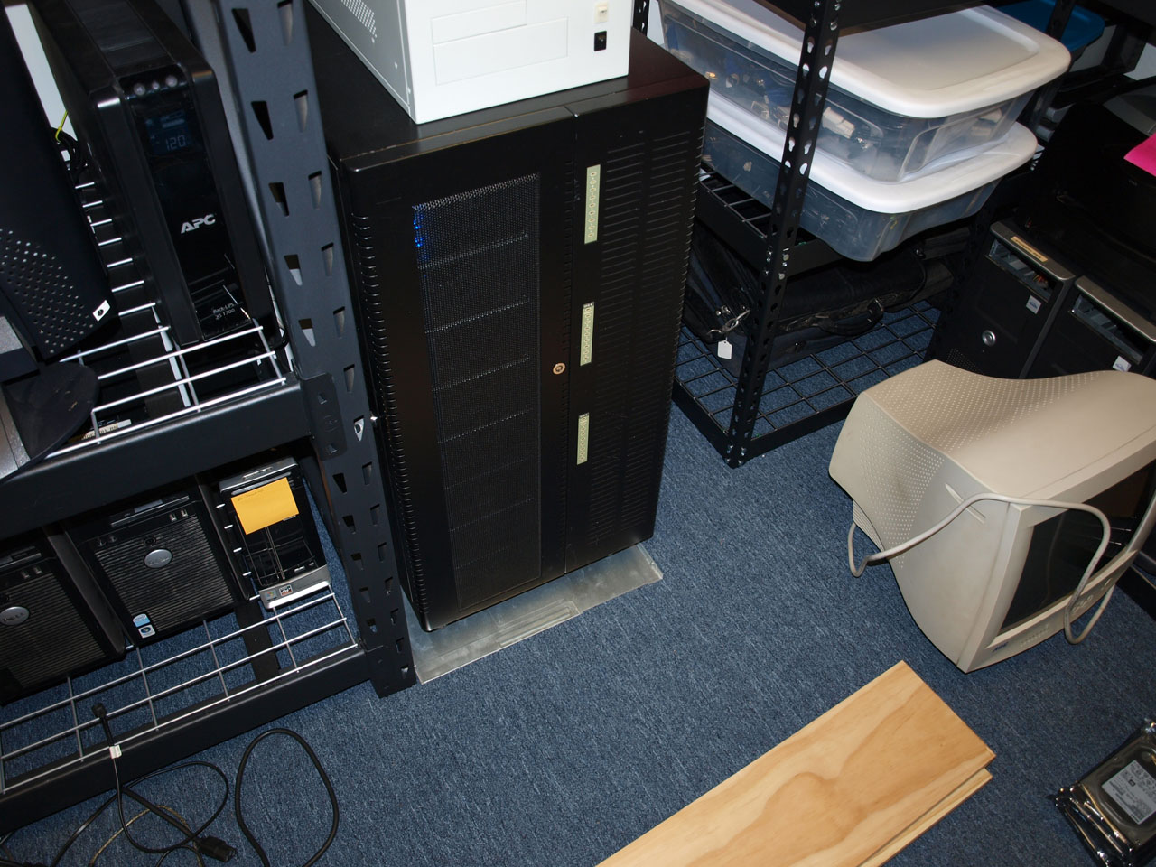

                So this thing is back in the news....this time it's cycling out HDD's that are 10+ years old.

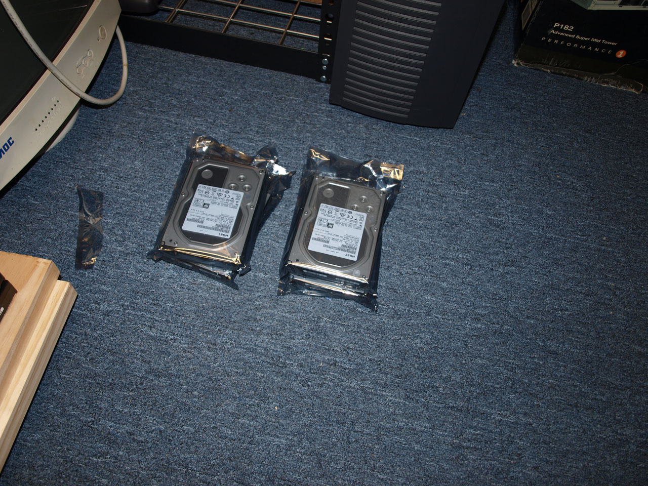

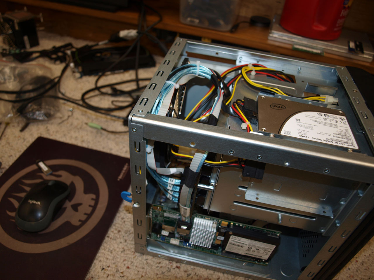

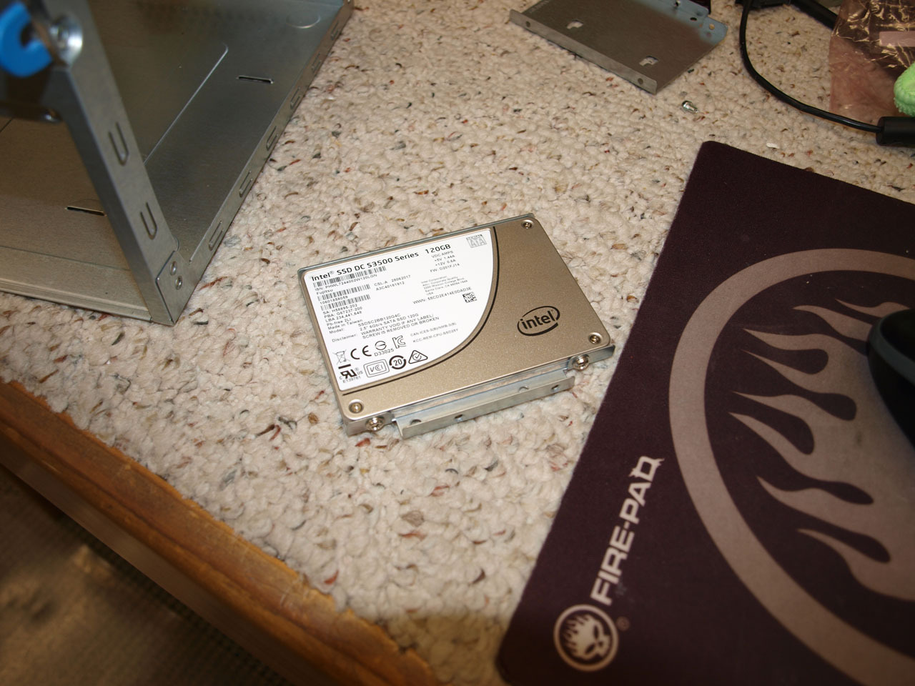

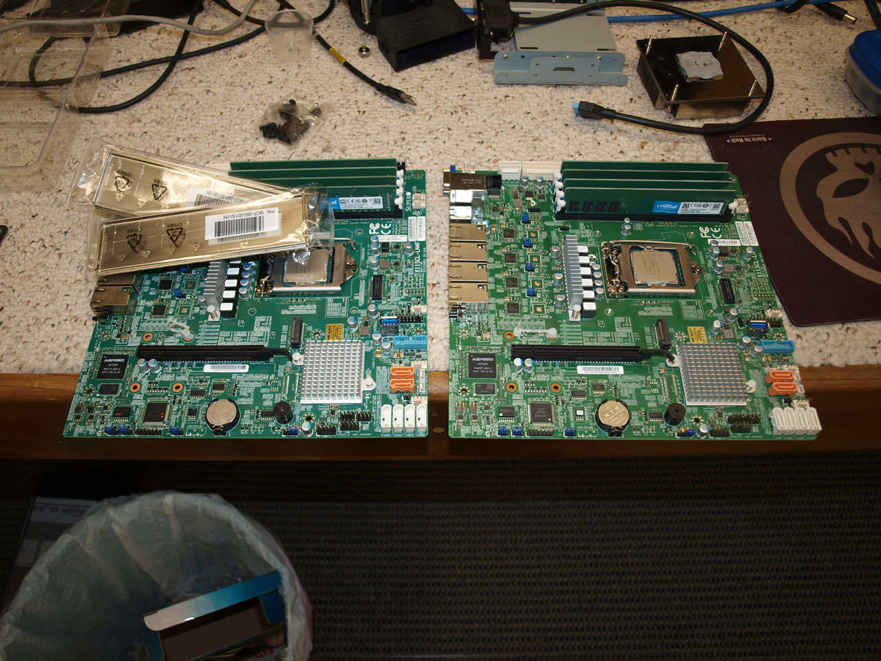

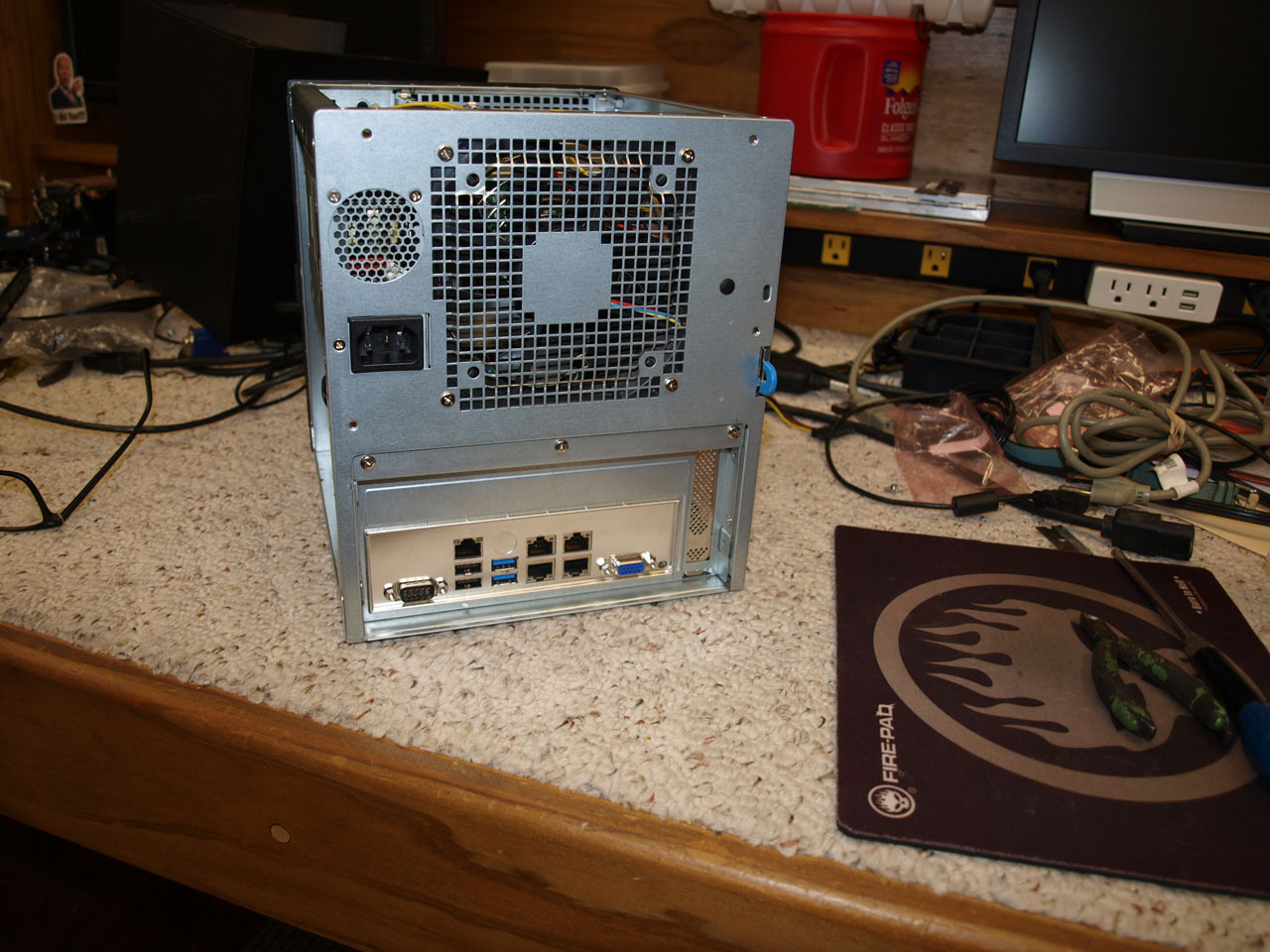

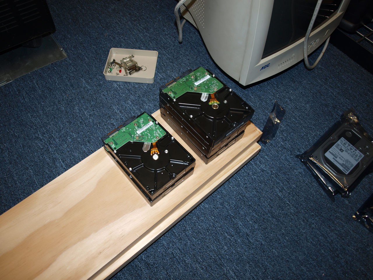

                I normally don't run them past 5, but time got away from me and there were no bells & whistles from the RAID controller... Whoever says WD Greens are junk can go eat some crow. 11yrs of flawless service, as well as some WD RE3's. I had a bunch of 1tb & 2TB's in RAID10's. I simplified a little this go-round with some 4TB's in simple mirrors. This go-round I tried some 4TB HGST 'Coolspin' 5300RPM drives, I got a stellar deal on 8 of them; which is half what I had in the system before. I've had very good luck with HGST drives. Speed is not crucial on this system, it's nothing more than a file server & local stream server. This cut the drive quantity in half; phasing out many 7200rpm RE3's. In the end, fewer drives = less power and twice the capacity.
                The new drives!

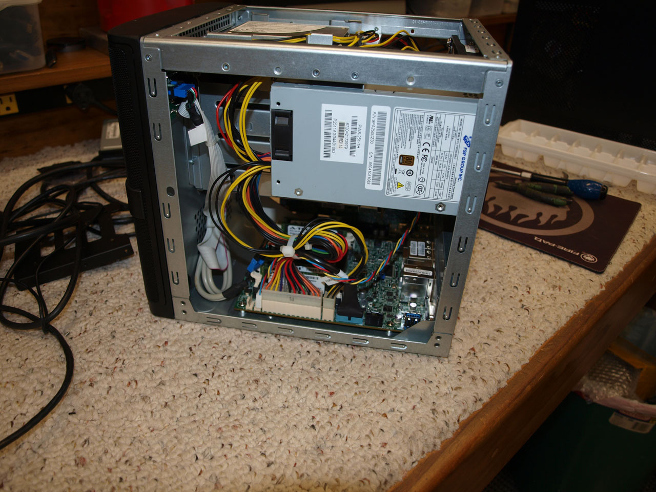

                NAS 2 (the backup server) got it first. This way I can dump NAS1 to this one and I know everything is current.
                Removed.
                New ones installed and now there's plenty of empty bays!

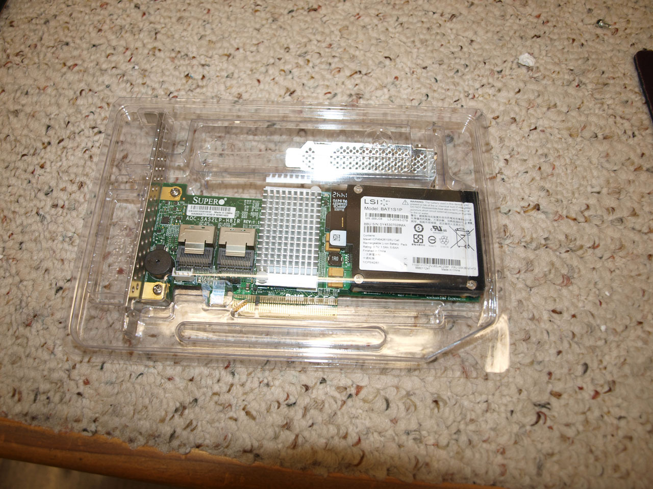

                ...and done!!

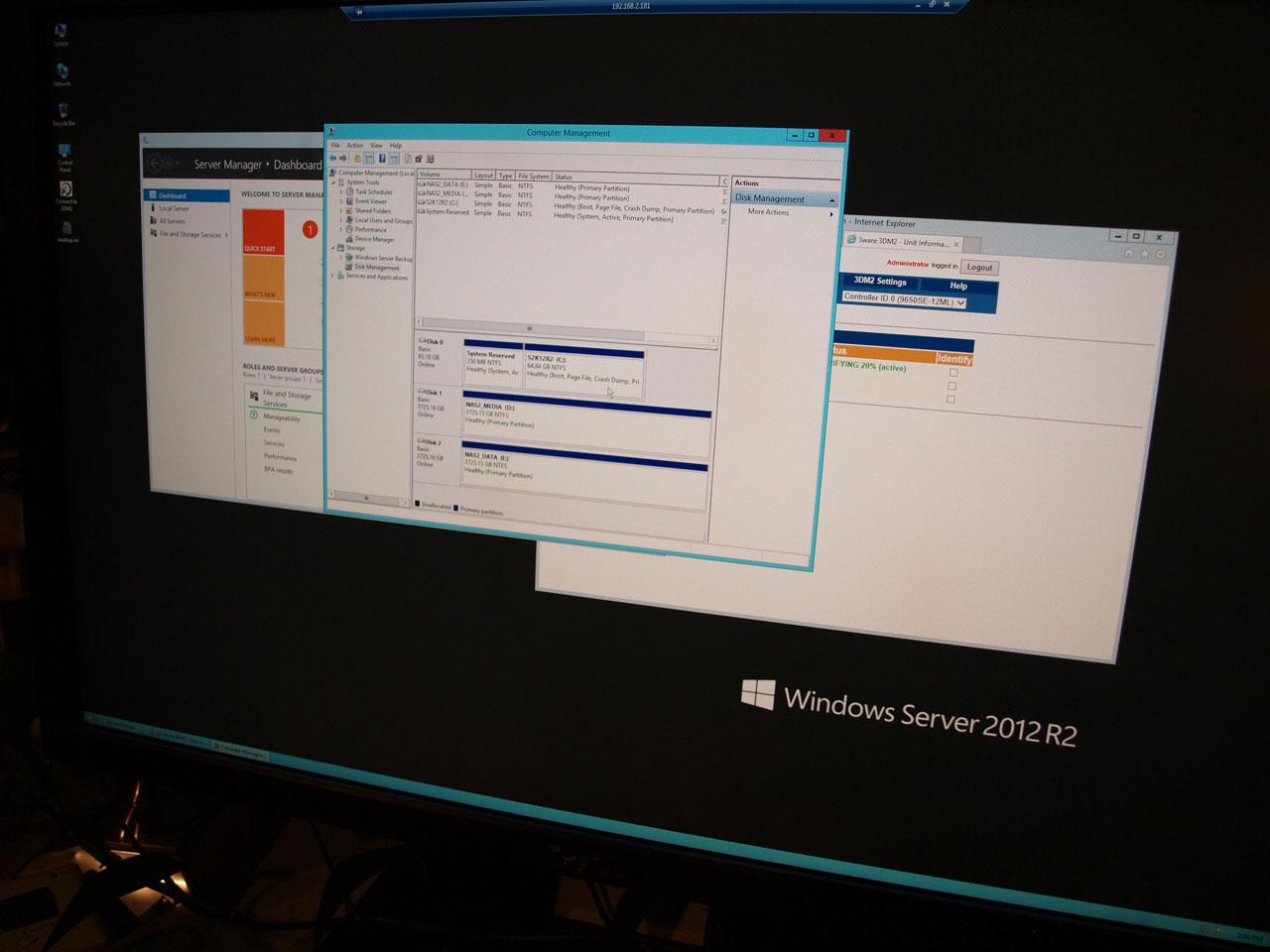

                The rest I can do from my office. The controller said HI!
                Arrays built, partitioned, and formatted.
                Most the night last night was spent transferring data over.....and now fast forward to this morning....

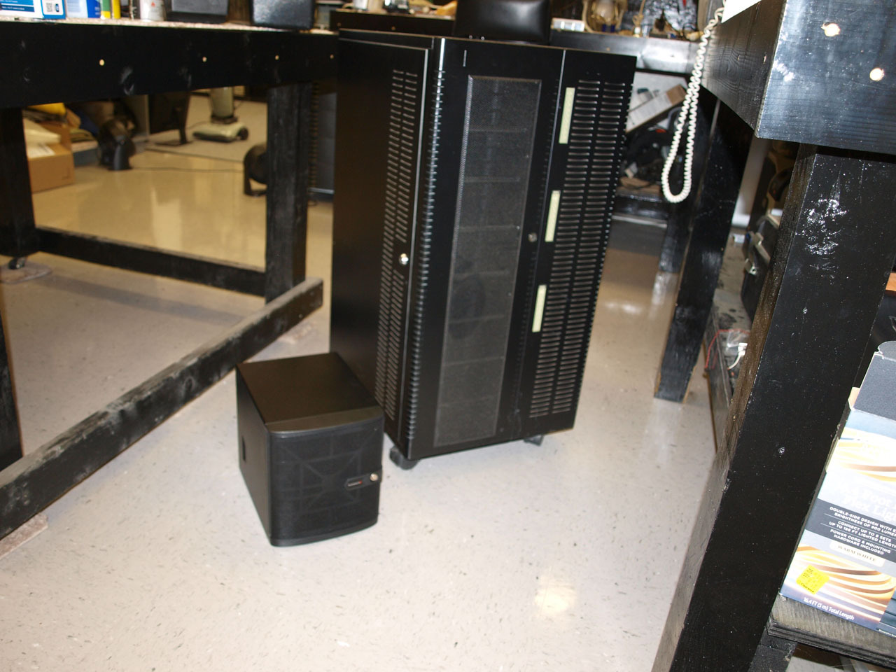

                NAS1's turn!
                Last 4 new drives.
                The pile!! I did reuse 2 of the 2tb Greens in a RAID1 for dedicated DVR drives....before it was all shared.
                Cleaned the filters while I had the doors open...
                ...and done! These all need to be wiped and the rehomed....
                ...and all finished... The transfer & resetting all the shares went smoother than usual for as many as there were.....Until next time with this jewel!!
