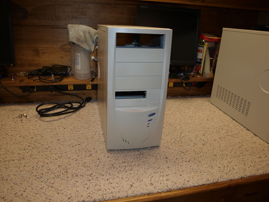

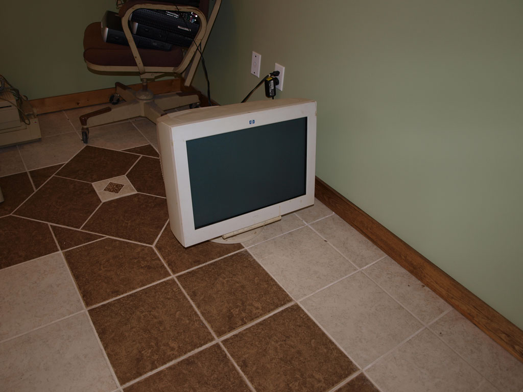

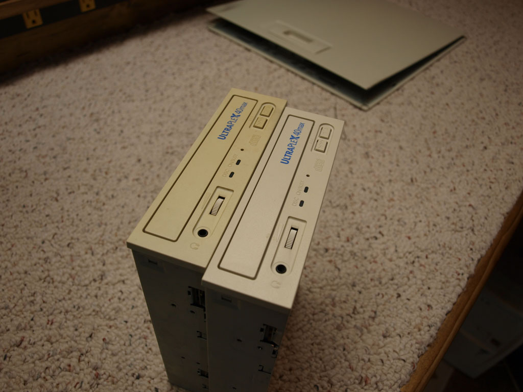

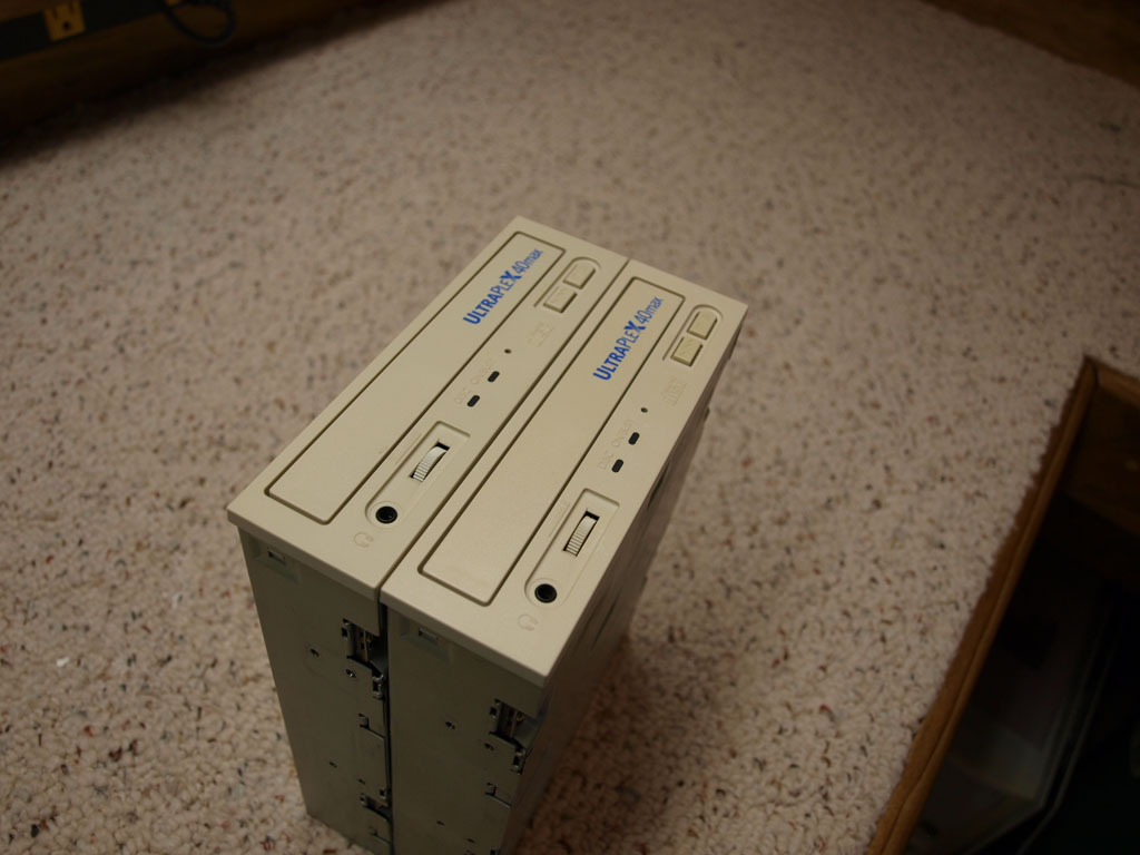

    I've been trying experiments with some 'household remedy' chemical yellowing removal, and after a few tries, I found a winner!!
    Before:
    After:
    More to come as I refine this process.

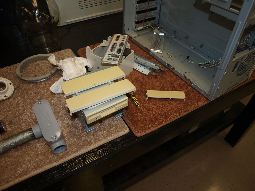

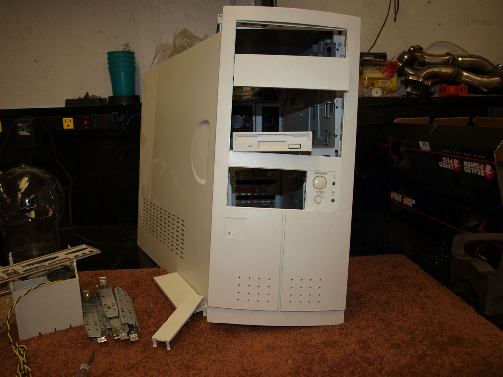

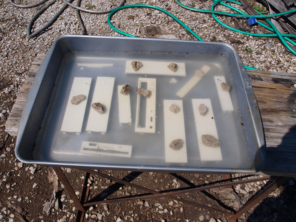

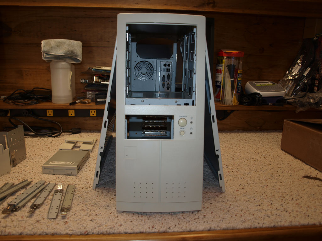

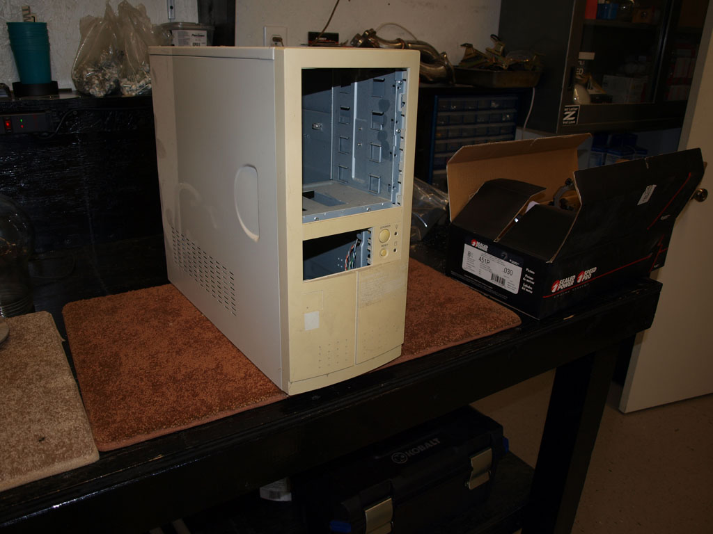

                  I think I've found my happy place!! I tested it on the worst case I had, came out looking new!!
                  Before:
                  In progress, in my super duper bromine yellowing reversing soup...
                  some other whatnots added with this batch.
                  After:
                  I'll post up the ingredients soon. I don't have proportion measurements yet, as its still kind of experimental....but I have the ingredients narrowed down after a few weeks of experimenting...

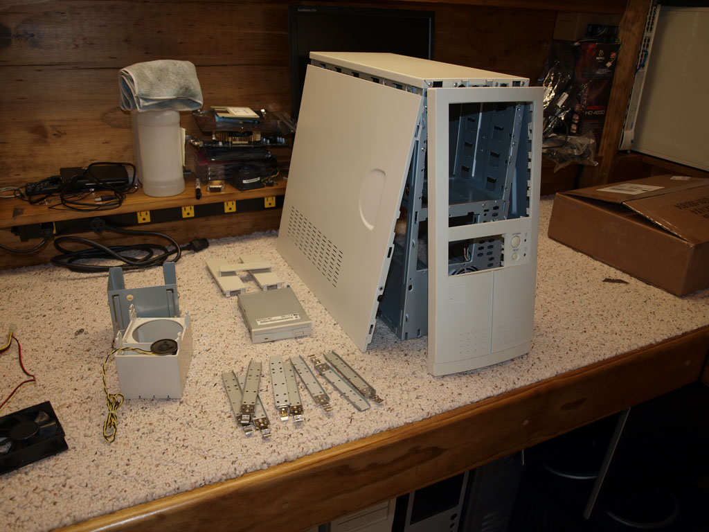

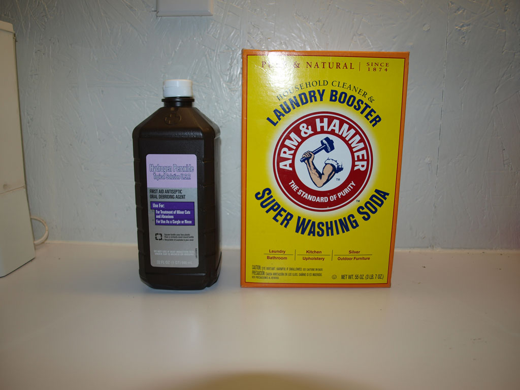

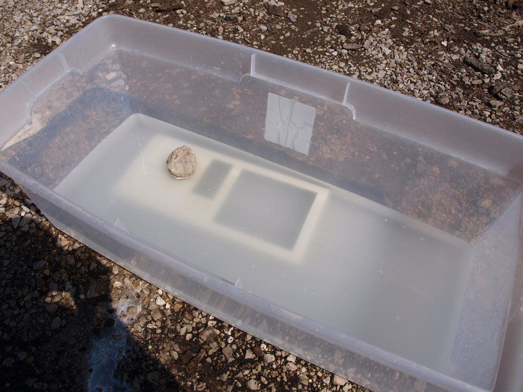

                          Ok, time to let the cat out of the bag. Here's the key ingredients:
                          1) Oxy-based detergent
                          2) Hydrogen Peroxide
                          3) Water
                          4) Intense UV source (sunlight can't be beat)
                          I've tried quite a few oxy-based cleaners, this was the best one. This one (unlike most) doesn't foam up. If there's a layer of foam floating on the surface, it blocks the sunlight. Strong UV is the catalyst that makes the whole process work. The hydrogen peroxide is introduced to speed up the process. The process works without the peroxide, but it takes a long time and will require a few treatments if its really yellowed. The 'soup' loses its potency after about 5~6 hours, and 6 hours in direct sunlight with this combination will do the trick. This nasty yellow enlight case was restored after just one 6hr treatment. Other similar yellowed items took 3 to 4 treatments without the peroxide, so its definitely a key ingredient.
                          Unlike 'retr0brite', which is more of a paste, and has to be reapplied when it runs off or dries out in the sun, the 'soup' works far better....and costs almost nothing. You just have to keep things submerged, which is why the rocks are there. You just have to shift them around periodically so to not get shadowing. Around 5~6 hours, you will notice its not bubbling/fizzing anymore, that's when you know the magic is all gone, and its time to remove & rinse off.
                          Ok, so the process is pretty simple. Mix the detergent with warm water in a pan and then add the peroxide, then place your items in the mixture yellowed side up. Then place it in direct sunlight for 6 hours. You may need to place heavy objects on the items to keep them submerged. If you do, be sure to rotate the heavy objects every so often so to not get shadows. That's basically all.
                          I am still working on proportions, I don't have measurements per gallon of water ratios yet....its like my spaghetti sauce, I add until it 'feels right'...but use generous portions of the detergent & peroxide.

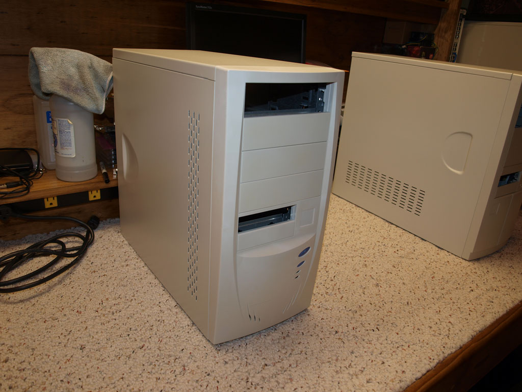

                          The final pics of the yucky enlight case after I cleaned up the rest of it:
                          Nice home for a VP6
                          Where did this come from?
                          That's all for now...

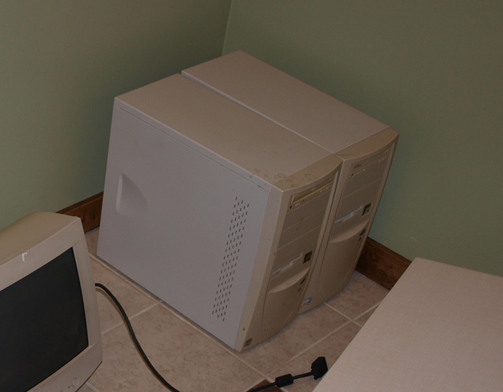

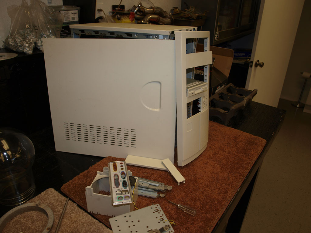

                            Re: Removing "Yellowing" From Beige Case Plastics

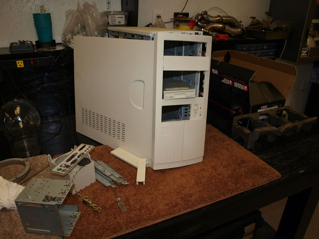

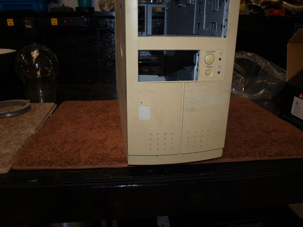

                            The case of the left....
                            Before:
                            After:
                            I love it when a plan comes together!
