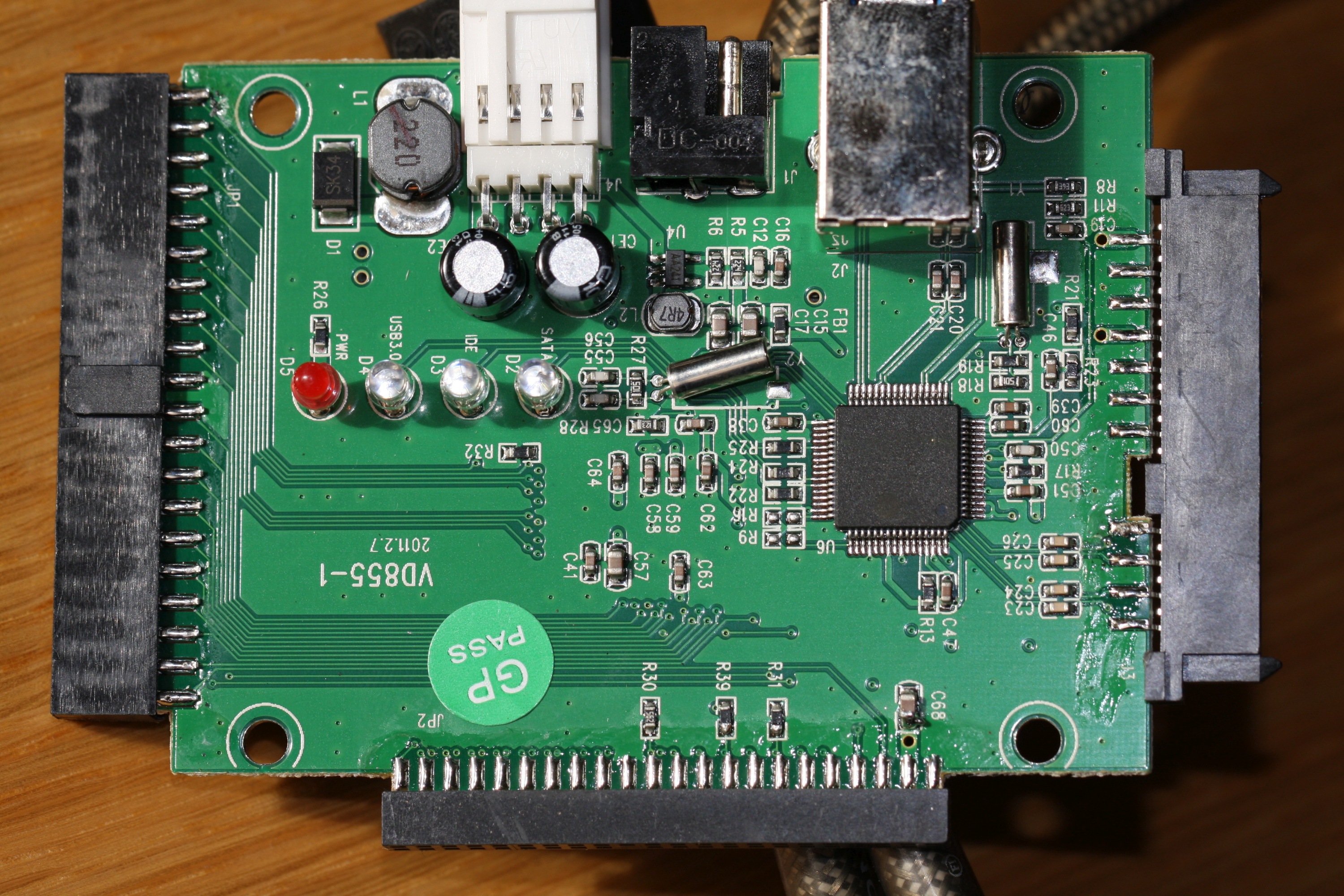

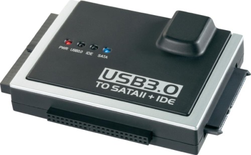

    So I have this Conrad branded IDE & SATA to USB 3.0 converter. Conrad artno: 976534.
    It's quite nice with external PSU and everything, however it has some issues.
    When I connect the USB cable to the PC there can sometimes be a spark, and pop in the speakers.
    So I started using it with the laptop only on battery power.
    I mainly use it to make Ghost copies of drives for customers, and for troubleshooting.
    But as I sometimes work on older systems I may need to limit the size of the drive so it can work with the host systems BIOS.
    This requires direct SMART access so that for example HDAT2 can access the drive in DOS.
    But this drive does not seem to offer it.

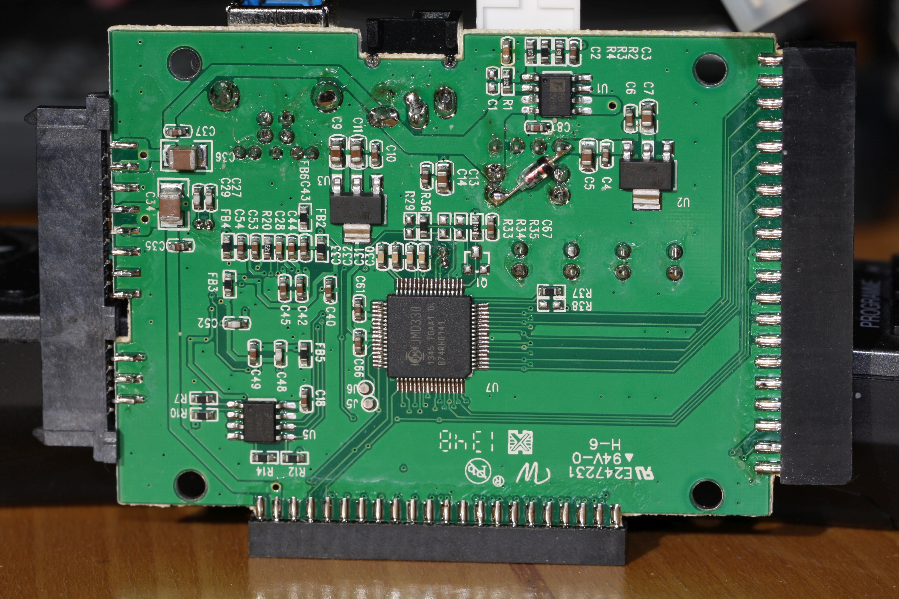

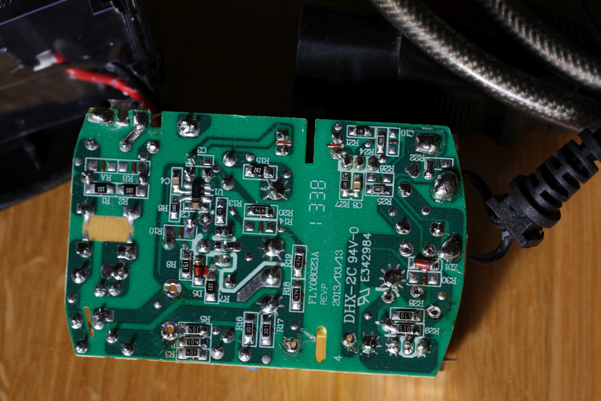

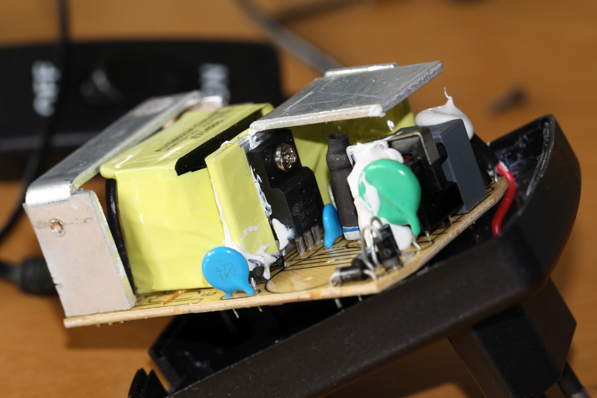

    I was also shocked by how shitty some of the soldering is when I opened it up.

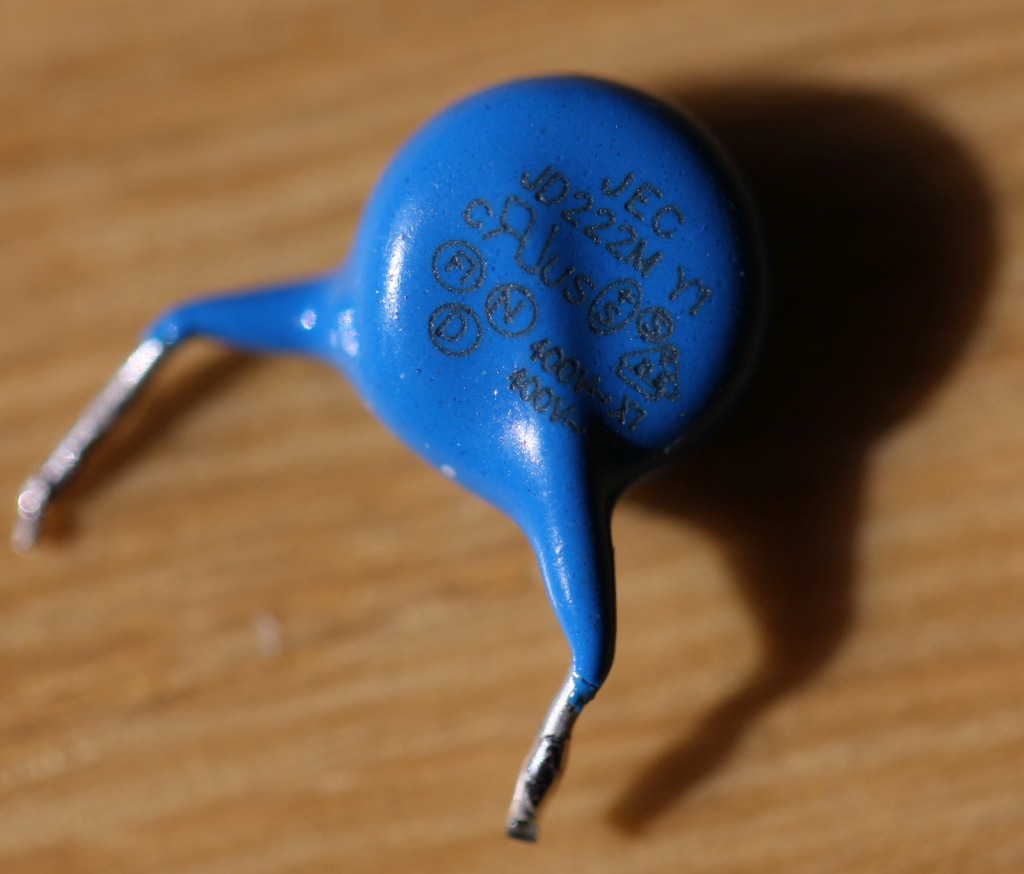

    Can't say I understand why the power adapter manages to cause that pop in the speakers either.
    The primary and secondary on the PSU are only connected by the transformer and an Y cap, which seems to have the proper safety ratings.
    The power adapter is a Flypower Model PS30IBCAK2000E claiming to provide 2Ah 12v

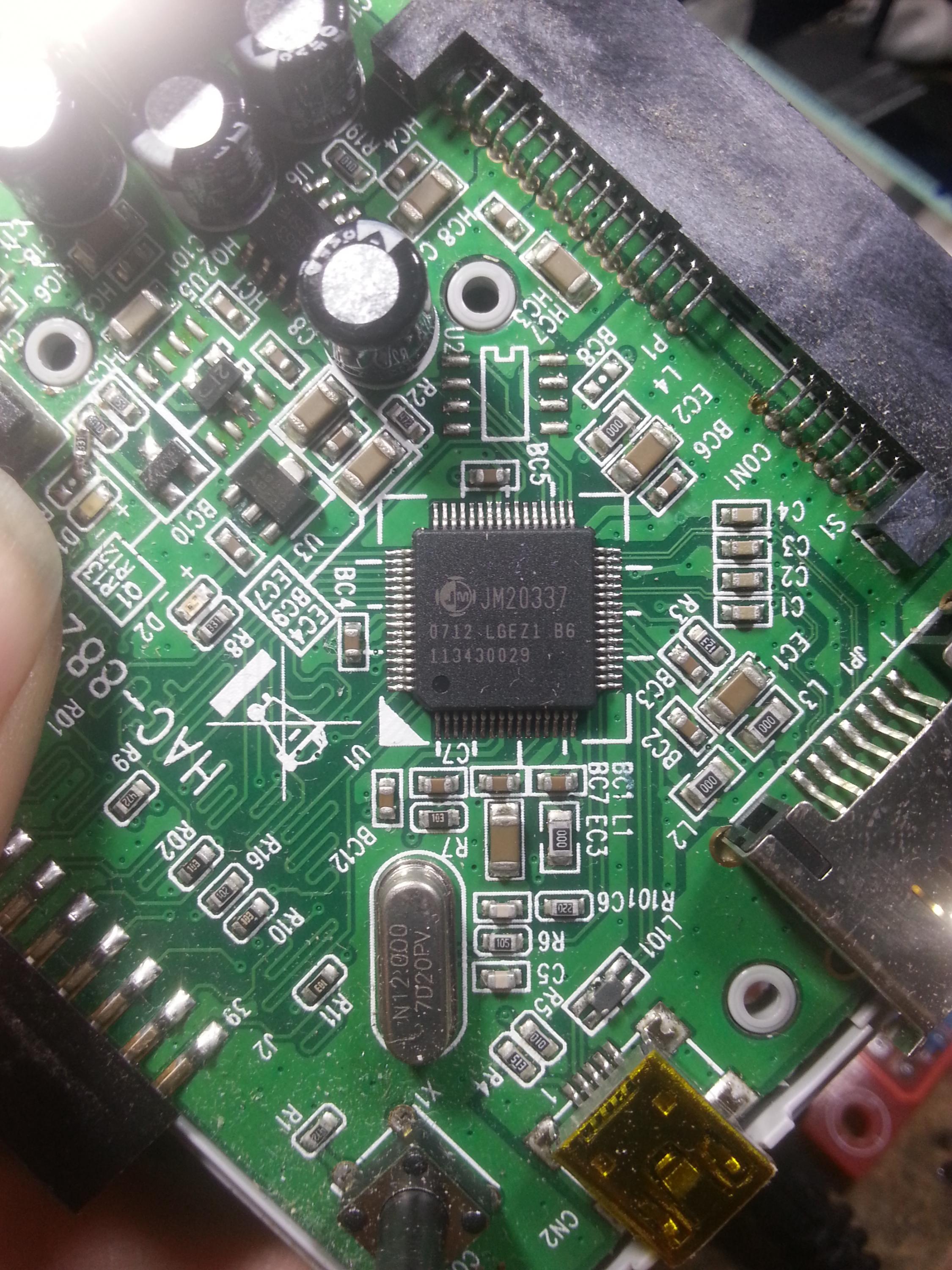

    It uses a Prolific PL2773 SATAII > USB3 controller.
    And a Jmicron JMD330 IDE > SATAI controller.
    Any recommendations for an adapter offering the same functionality but also supporting S.M.A.R.T access for DOS so HDAT2 can be used would be very nice!
    Do note that my original adapter is only branded Conrad, it has been discontinued and now they are selling this one with the "Renkforce" branding on the cover.
    Not sure if it's exactly the same thing inside or not.

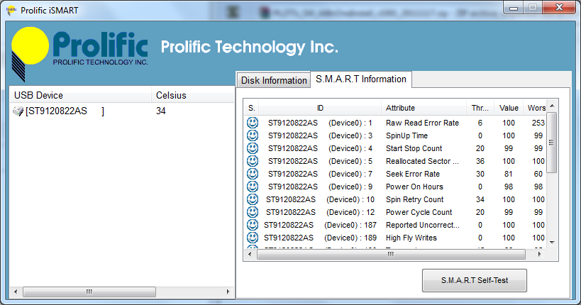

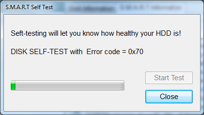

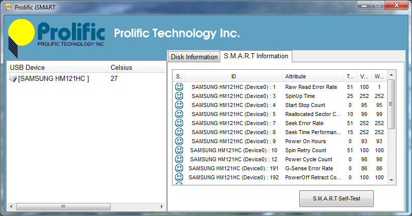

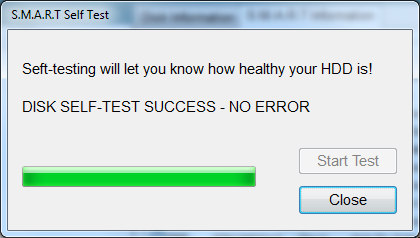

              I just installed it: iSMART and it did read some SMART data from both a IDE & SATA HDD, of course it's Windows only, a tool like Crystaldiskinfo can't access it at all for example.
              But now in my search I found the following ticket where support was added for the PL2773 bridge chip to smartmontools by reverse-engineering Prolific's iSMART tool.
              My CentOS7 system came with smartmontools v6.2 which was too old so I compiled the latest version and then it's actually able to read SMART status.
              Of course that does not help me to set the HPA area using HDAT2 since that is a DOS program but it's a step on the way.

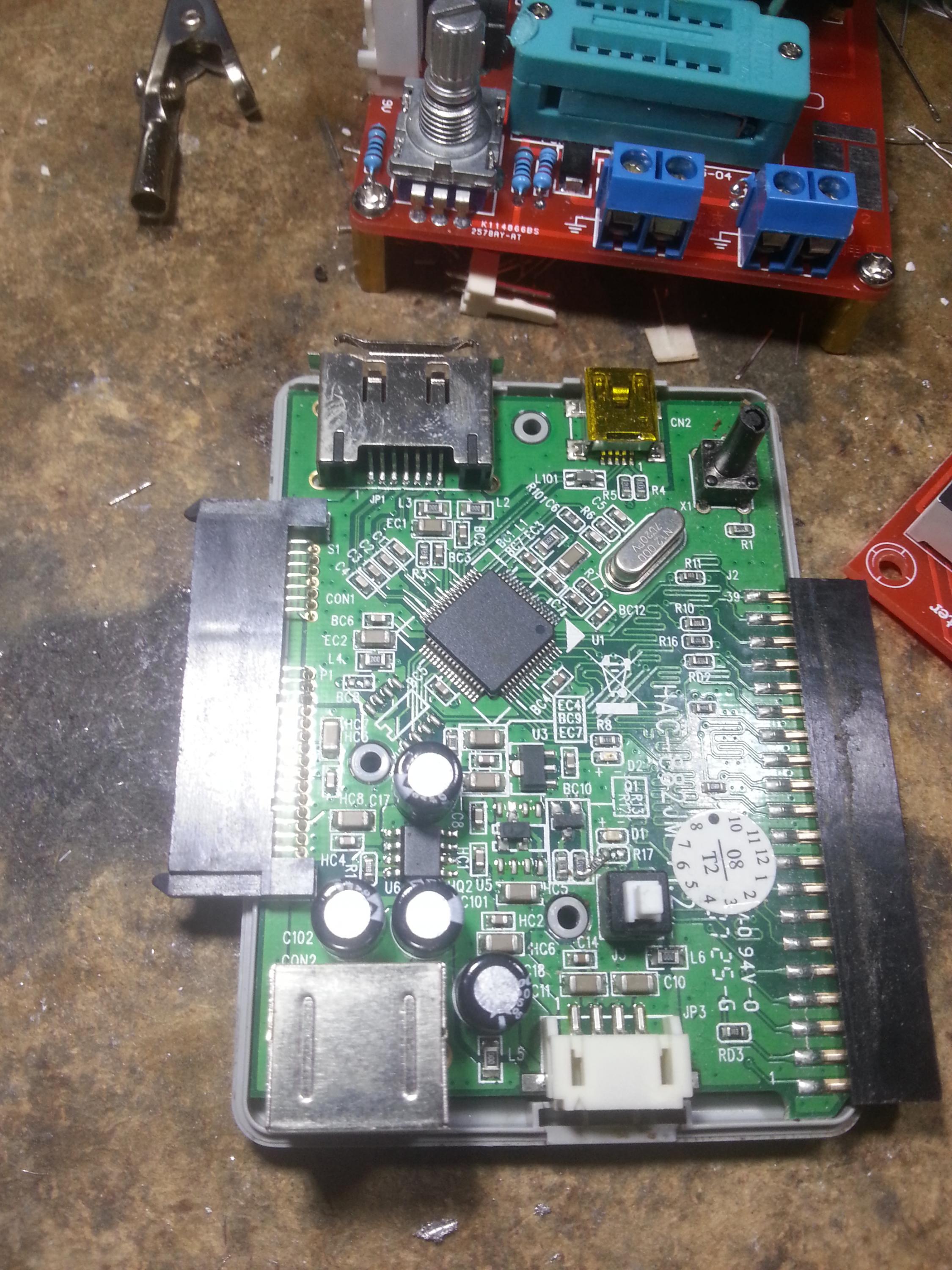

                  I looked through my parts bin now and found three different IDE/SATA > USB adapters.
                  But none of them worked in DOS though for direct SMART access
                  And one had bad caps and let out over 14v on the 12v, good thing I used a broken HDD for testing LOL!
                  I gave it some old replacement caps and then the 12v was stable, and 5v too which was low before.
                  Still didn't work in DOS though

                    The smartctl patches allude to official documentation from Prolific in respect of the "Prolific ATA pass through" command (0xD8).
                    Code:
                    cdb[ 0] = 0xD8;     // Operation Code (D8 = Prolific ATA pass through)
                    cdb[ 1] = cmd_rw|0x5;  // Read(0x10)/Write(0x0) | NORMAL(0x5)/PREFIX(0x0)(?)
                    cdb[ 2] = 0x0;     // Reserved
                    cdb[ 3] = in.in_regs.features;    // Feature register (SMART command)
                    cdb[ 4] = 0x06;     // Check Word (VendorID magic, Prolific: 0x067B)
                    cdb[ 5] = 0x7B;     // Check Word (VendorID magic, Prolific: 0x067B)
                    cdb[ 6] = (unsigned char)(io_hdr.dxfer_len >> 24); // Length MSB
                    cdb[ 7] = (unsigned char)(io_hdr.dxfer_len >> 16); // Length ...
                    cdb[ 8] = (unsigned char)(io_hdr.dxfer_len >> 8); // Length ...
                    cdb[ 9] = (unsigned char)(io_hdr.dxfer_len   ); // Length LSB
                    cdb[10] = in.in_regs.sector_count;  // Sector Count
                    cdb[11] = in.in_regs.lba_low;     // LBA Low (7:0)
                    cdb[12] = in.in_regs.lba_mid;     // LBA Mid (15:8)
                    cdb[13] = in.in_regs.lba_high;    // LBA High (23:16)
                    cdb[14] = in.in_regs.device | 0xA0;  // Device/Head
                    cdb[15] = in.in_regs.command;     // ATA Command Register (only PIO supported)
                    AFAICT, one can send any ATA command, including vendor specific ones, to the HDD using this method. The "in_regs" bytes are the ATA taskfile registers corresponding to the specific ATA command.
                    In the past I asked the author of HDAT2 if he would add support for a particular ATA feature (error recovery control, ERC) and he graciously provided same. Perhaps you could ask him to add Prolific support.

                            • diif
                              • Feb 2014
                              • 6978
                              • England
                              Re: Recommend good external IDE & SATA to USB3 converter? (To replace Conrad 976534)
                              I've just opened up my Magic Gate 2, it is however USB2 not USB3.

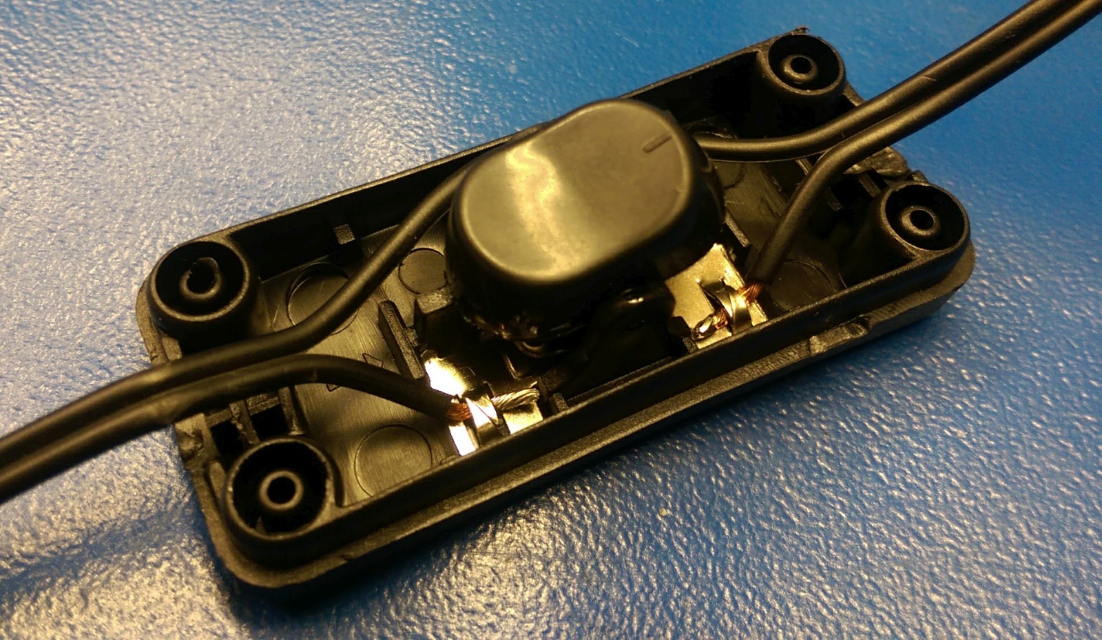

                                Had some problems with intermittent connection and opened the switch up for the power adapter.
                                Found the wires just tipped with some solder on their ends.
                                And pushed in under some crimp connections not even firmly on the wires so they can move around freely.
                                Fantastic QC
