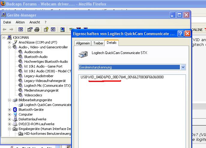

    I have a cisco VT webcam sitting here on my desk. It was working correctly under Vista because I had drivers for it in which i lost now. I reinstalled XP looking for the drivers and there aren't any to go with it. I need some help in finding the driver. I really need this to work otherwise I need to buy a new webcam. The model on the webcam is V-UJ16.

        Re: Webcam driver....
        can you read out the device IDs? (VID and PID)
        does windows let you install the logitech drivers?
            Originally posted by stevo1210
            How do I find the device IDs?
            they're listed in the device manager in the 'details' tab of the device.
            If you google these IDs (as "PID_xxxx" and "VID_xxxx") you are likely to get more results.
              How about this driver?
              http://members.driverguide.com/drive...riverid=764941
              Another way is to boot from a Linux live CD, and run the command lsusb. This will give you the USB ID number. You can then look to see if it is in this list here:
              http://mxhaard.free.fr/spca5xx.html
              There are lots of other Linux web cam drivers.
