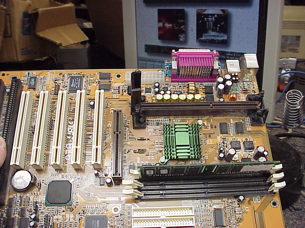

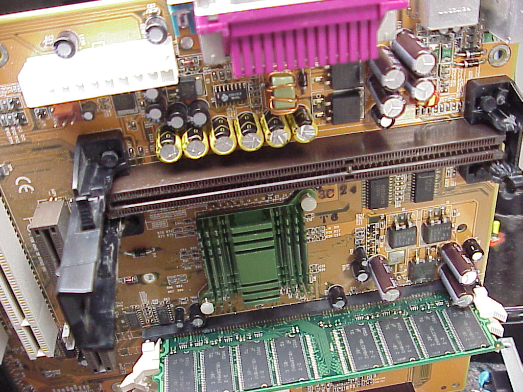

    abit be6 poly mod
    this one is from a homebrew arcade game.
    none of the original caps were bulging but the tayeh vrm output caps read 1.8 ohms esr in circut.
    most were 6 or more each out.
    vcore caps are now polys.
    no more reboot when doom is started!
