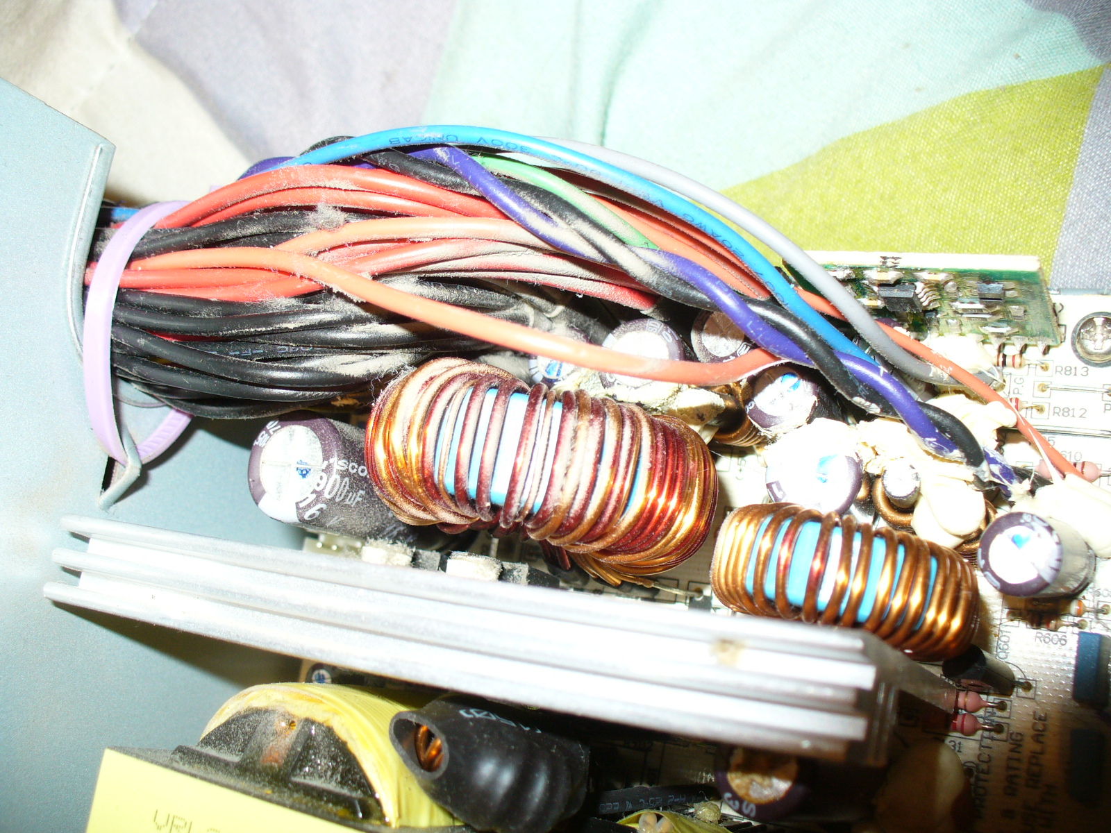

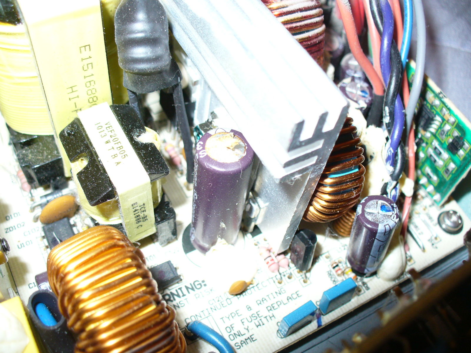

              Ding ding ding... The 5VSB is hosed. Pics coming... given that such a HW RAID card with BBU would probably load down the 5VSB a bit, no wonder it took a shit.
              I was going to recap it when I bought it... and never got around to it. Now it's kicking my ass. I don't care how pretty their ladies are, screw you SuScon!

                  This one at least. I and somebody else on the forum bought one of these new for $40 on ebay. After "re-configuring" the SATA strands a bit and tying up the Molex/berg strands, it was the perfect layout for the system, so it will get recapped. My system uses about 550W of power (between the twin Geforce GTS 250's, twin Opteron X2's, and other trimmings), so 600W is as low as I dare go. It put out a decent amount of heat, but not enough to scream "overloaded" so the 600W rating is probably accurate.
                  IIRC he recapped his already. I even had a list together... and I probably posted it in the V3.0 thread.
                  The only other "cheap out" I found was they omitted the mains in plug to the main PCB; they instead soldered the wires straight into the footprint. Oddly, the EMI board was hand soldered to the AC plug and I/O switch directly after they were installed in the case. Kinda soldered in crooked a bit, lots of flux and junk not fully washed off. Not exactly junk, but this was a tad entry level (although it does have the twin rails promised AFAIK and the build quality is otherwise fine).
                  Anyway, time for pictures:
                  5VSB:
                  The rest of the secondary looks to be OK but will get recapped anyway:
                  Bigtroll will probably be sad to see the suscons go... but this trash needs to GO!
