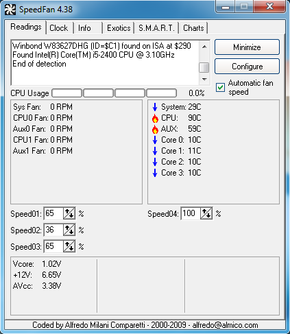

        was looking at this and it says all the fans are running at 0% but the fans are running, why is this ?

              • 30965
              Re: CPU running overly hot.
              your fans are 0% because you dont have any with a tacho.
              is your radiator getting hot?
              can you feel the pump running?
                    did you connect the fan to the socket on the cpu-plate? and the plate to the cpu-fan connector on the motherboard?
                    from what i see in the manual, the mobo should detect the fan speed.
                    and you MUST disable automatic fan speed settings in the bios and run the fan 100% because the cooler has it's own controller.
                    your screenshot looks like you didnt.

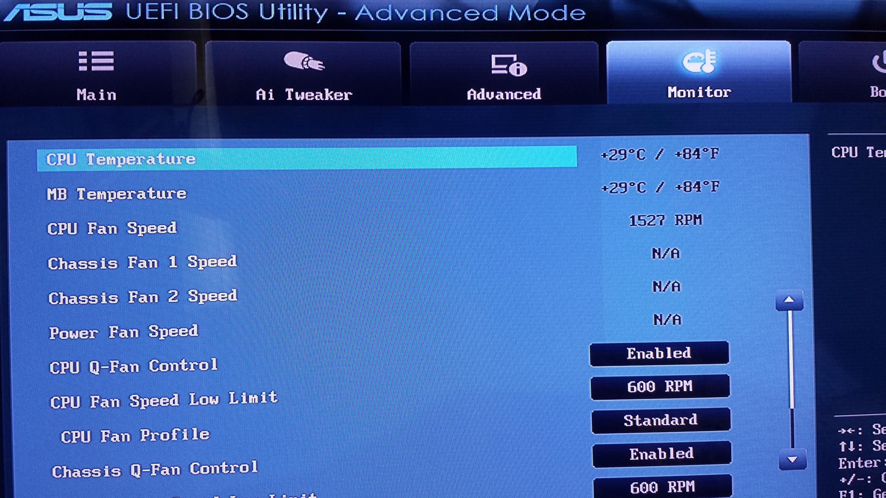

                                ok now im realy confused, went into advanced settings in bios and it says the mobo and cpu are running at 29oC and 84oF
                                  You are running speedfan 4.38 (6 years old). Speedfan is up to 4.51 now. I suggest you upgrade and see what the new version reports as the old one could have a bug in it?

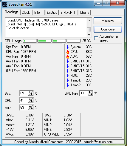

                                    updated, still pretty high.
                                      According to that your 12 volt line is sitting at 6 volts. How new is the power supply?
                                        its been used for around 6 months, its a Corsair GS600
