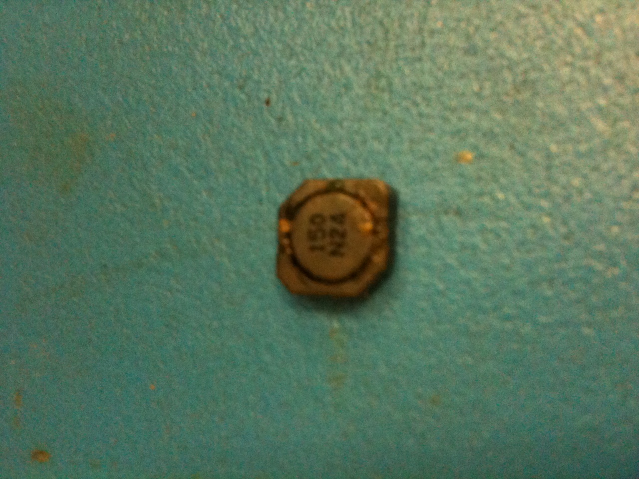

Identifying smd part
11-06-2014, 05:44 AM
Anyone can help find this part

Do you mean what is it or where can you buy one.
It is a 15uf inductor/coil - does that say N24 or N2A - a picture of where it fits
and a note of the physical size might help.

Thanks for your help, can you help understand the meaning of the mark 150 N24 and where can buy this, i have try ebay

Sorry that should have read 15uh - So used to typing uf which is a capacitor
See here for explanation of "150"
http://how-to.wikia.com/wiki/How_to_...uctor_markings
I dont know what the N24 means - maybe just a manufacturer code/part number
If you type in 15 uh smd inductor on ebay you should get some hits?
What is it off ?
You will need to measure it to get the physical size
