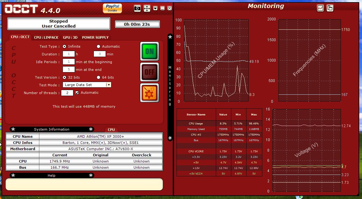

    I'm here at my parent's house ... I wanted to do something nice for my father who uses this computer just to buy stamps and coins and watch youtube clips of the bands he liked when he was younger.
    The old system has a Sempron 1500+ and 1 GB of memory... I upgraded it to a barton 3000+ (2.2ghz) and 1.5 Gb of memory.
    Now I'm looking at the voltages and I see the 12v sitting at 12.6v on idle and going up to 13v when cpu usage is at 100%
    I'm starting occt to make sure the board is stable (asus a7v600-x, had to update bios to recognize the cpu properly) and I see the 12v going from 12.6 to 12.8-12.9v.
    Placed the probes of a cheap multimeter on the hard drive molex input and I see 13.02v

        The 12v is still around 12.8-13v when cpu is loaded.. it's high but can't do much about it from here. I only visit my parents' place 3-4 times a year so i don't have anything besides screwdrivers and a multimeter here.

                I had to make do with what I had here at my parents' place so I simply went out to a car parts store and bought a 12v 21w lightbulb. No electronics stores around and a light bulb is cheap (about 50 cents).
                Now the computer has a light inside it and the voltage stays around 12.5-12.65v on idle. When abusing it with occt, it rarely crosses over 13v.
                One more thing I noticed is that even with the latest bios, on this motherboard asus a7v600-x the barton i has is not recognized properly. It's supposed to be 2200 Mhz (166 Mhz x some multiplier) but by default it sets it at 1050 mhz.
                If I manually set it to proper multiplier, after a restart it defaults to 10.5x multiplier or 1750 Mhz.
                I had to set it to 200 Mhz x 10.5 to get 2100 Mhz out of this cpu.
