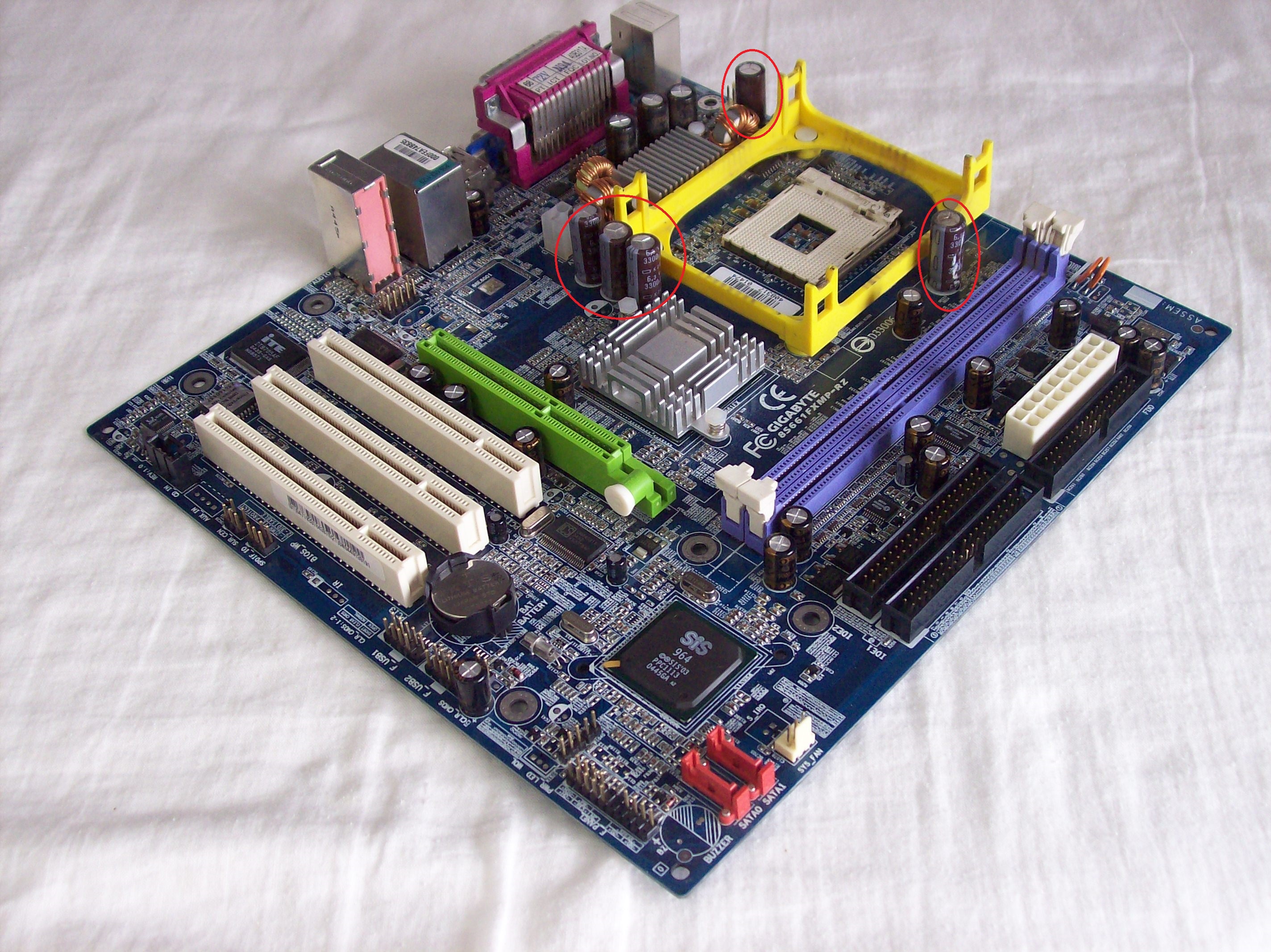

    hi guys, was wondering if anyone can get me the Schematics for a gigabyte 8S661FXMP-RZ motherboard. cant seem to find anything. took a couple of caps of and have misplaced them so unsure of what to put on the board, thanks

    Here's a few large size pictures of the board, maybe you can spot the capacitance and voltage rating
    http://fuynfactory.is-a-geek.com/wik...isometrico.JPG
    http://fuynfactory.is-a-geek.com/wik...omponentes.JPG
    http://www.nix.ru/include/view-photo...47779&pid=2254

      had a look at them, the 5 i have selected are the ones i removed, by the pictures it looks like all are 6.3v 3300uf can someone verify this ?

        Yes, that is correct.
