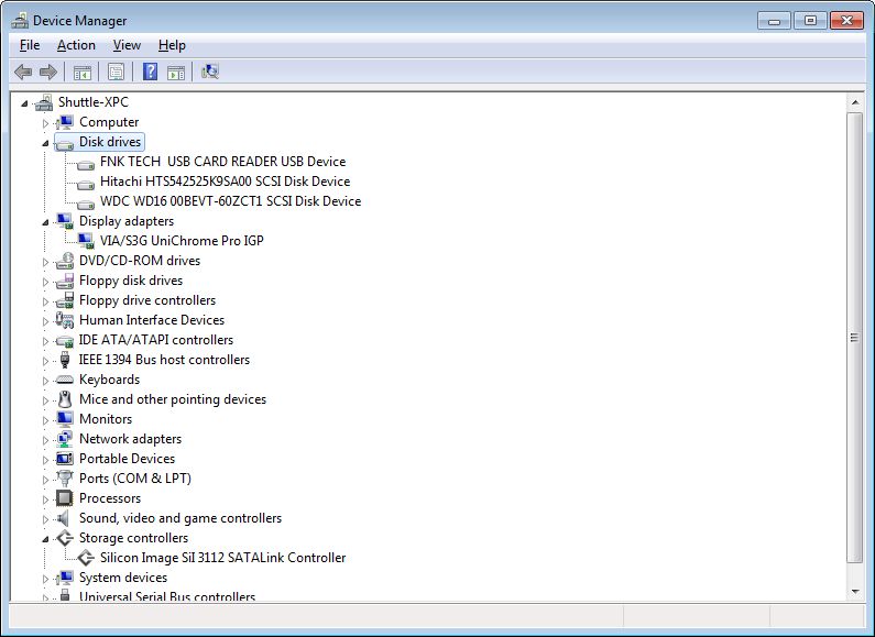

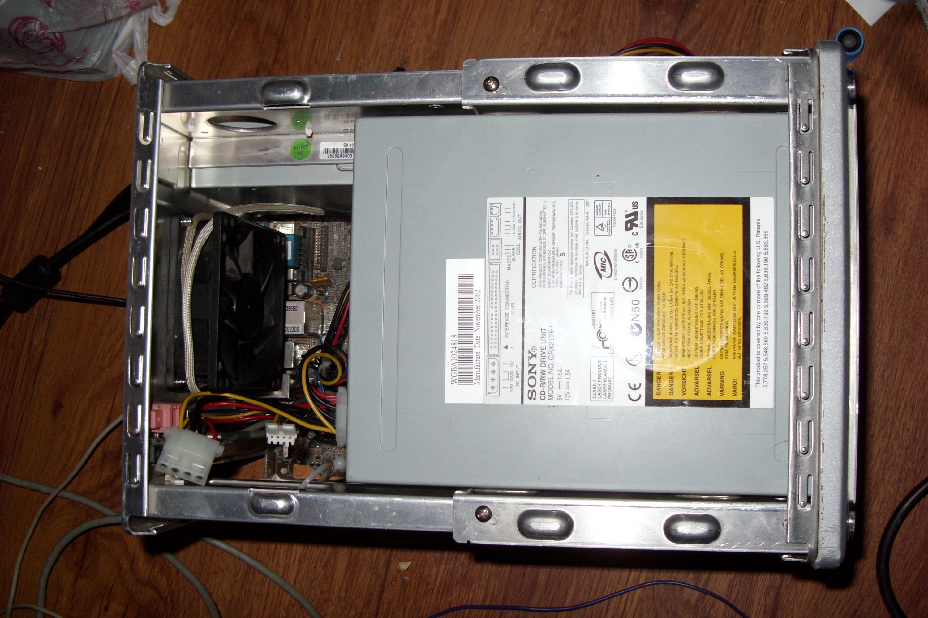

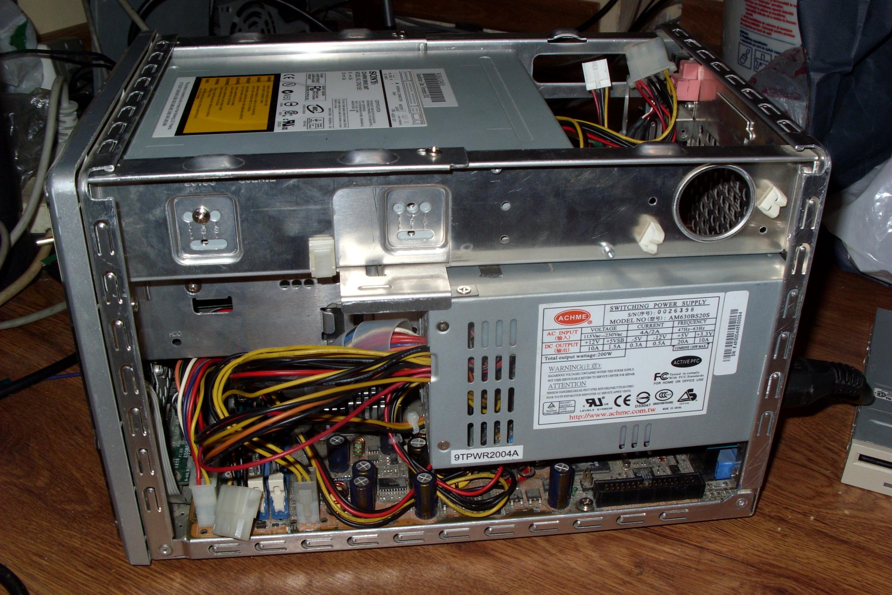

    I've been given this Shuttle X a few months back. Before i even got to take a look at it, i ended up borrowing it to someone who didn't use it at all, finally got it back a couple days ago. It didn't work. Turns out the Clear CMOS jumper was missing - this machine doesn't even spin the CPU fan if that's missing, very interesting.

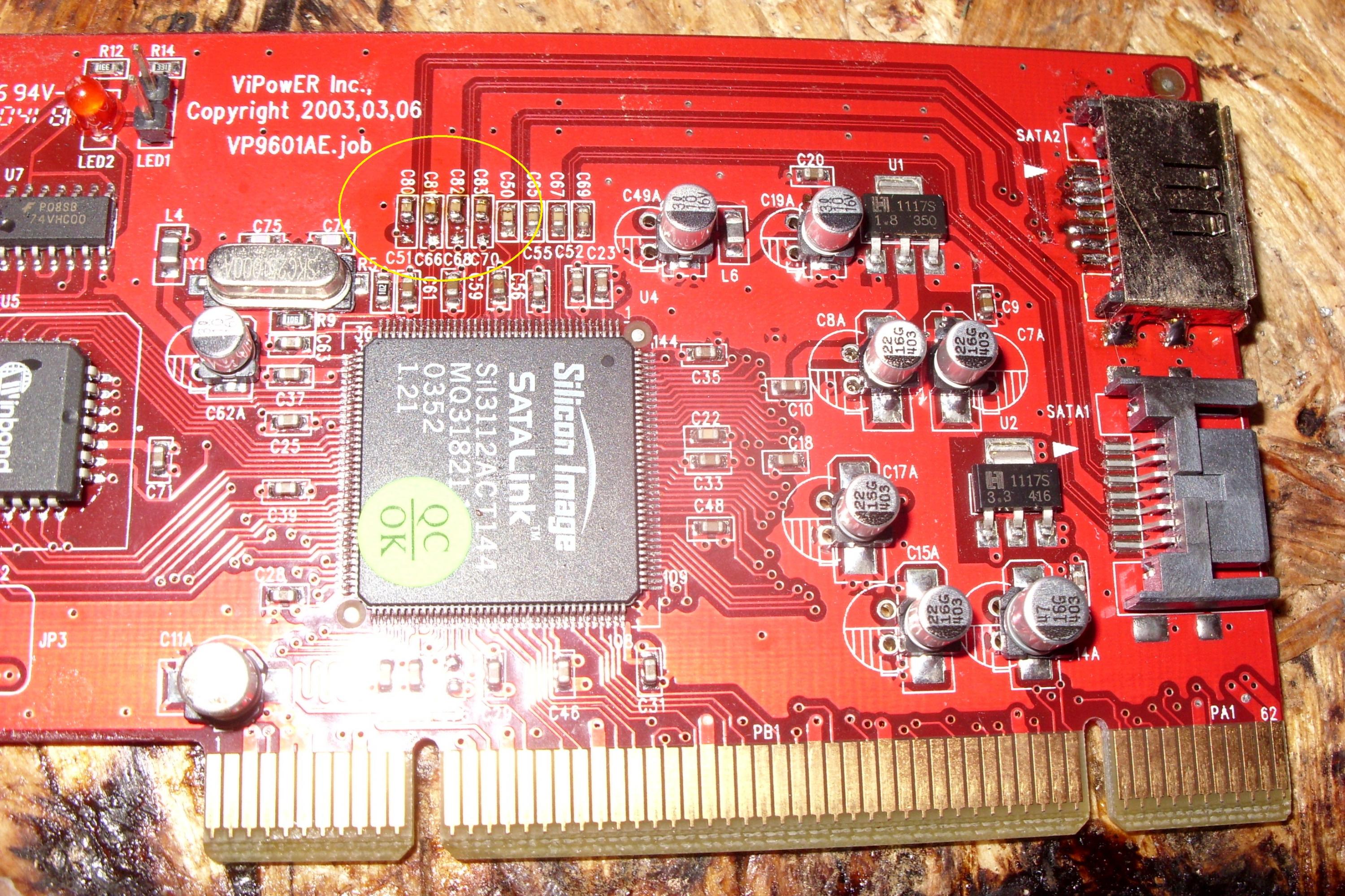

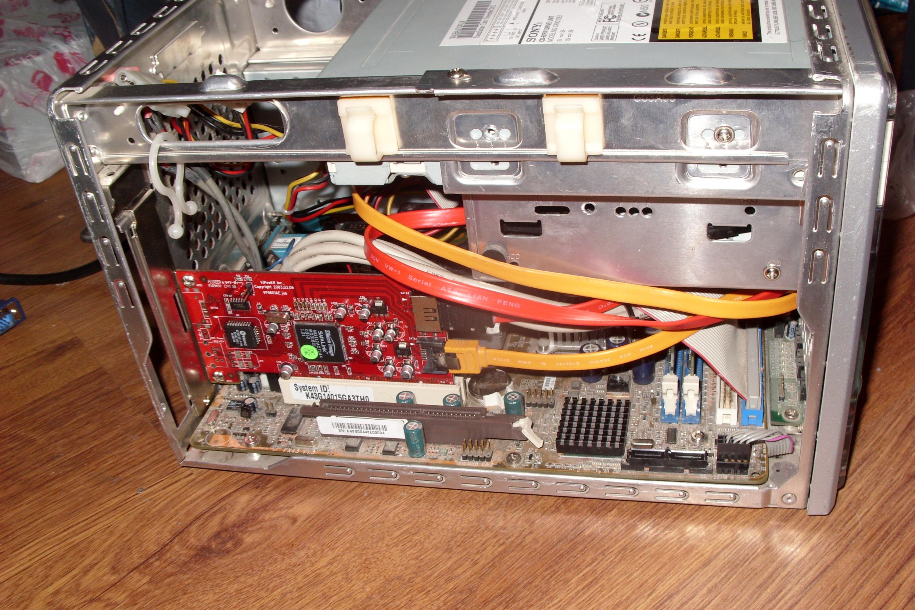

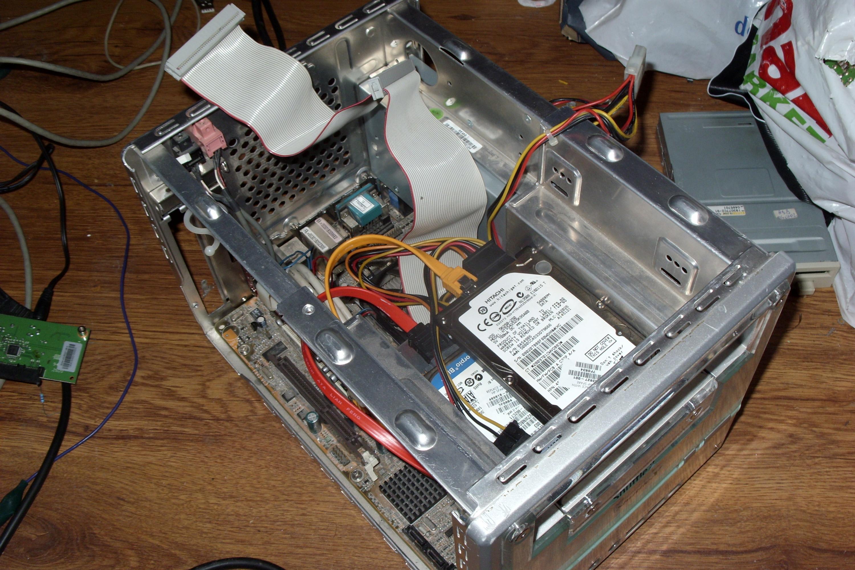

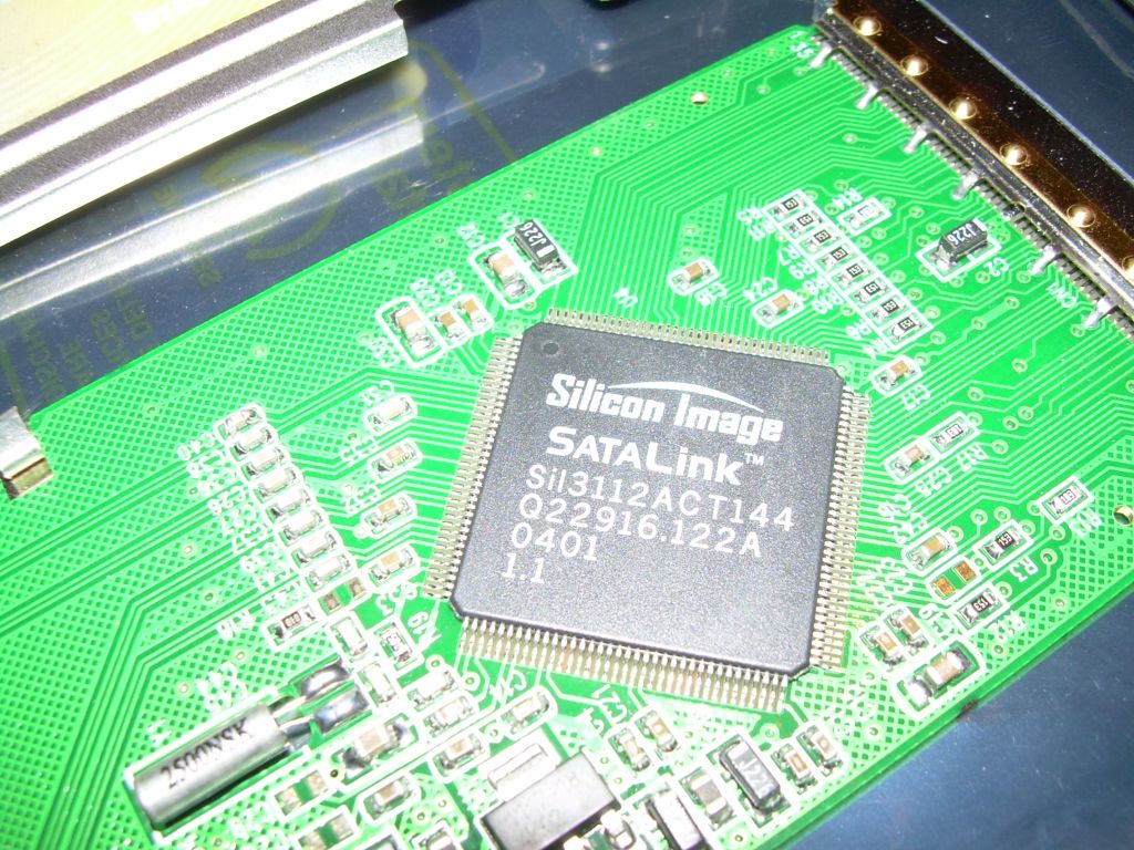

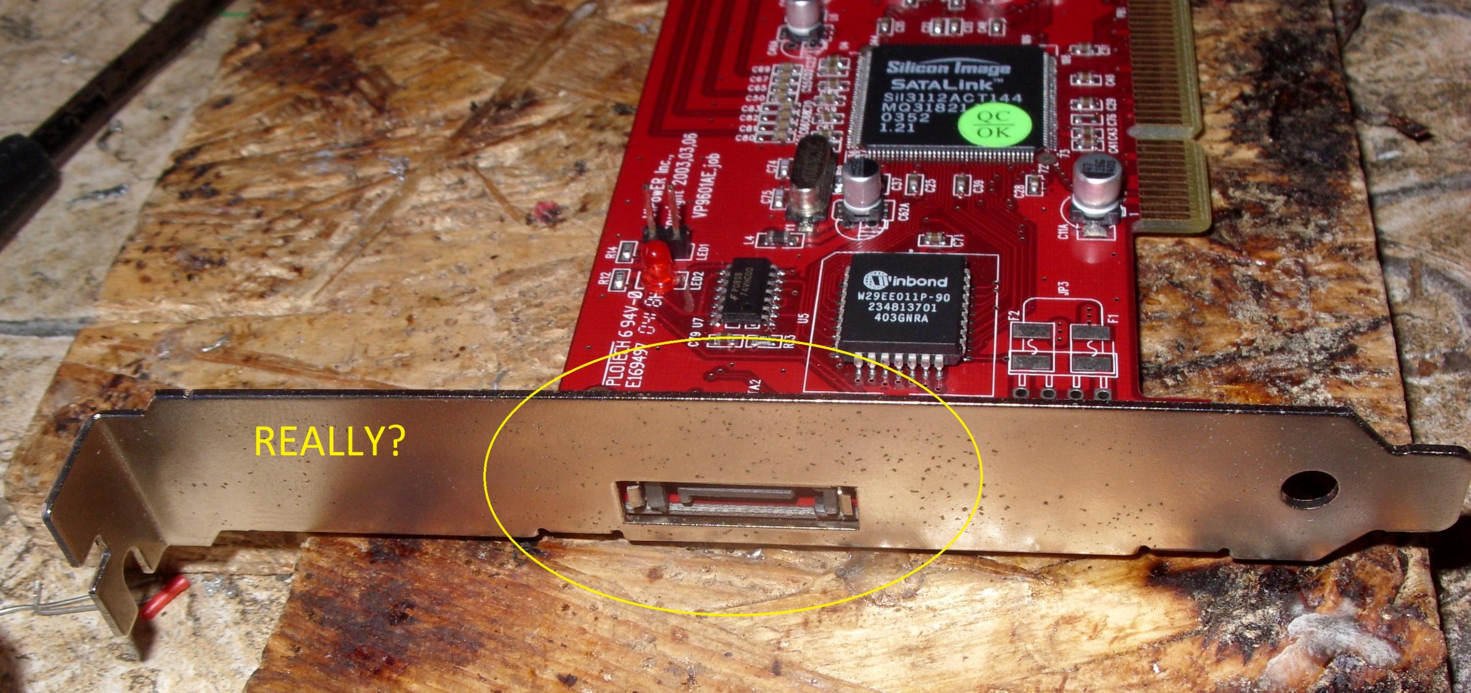

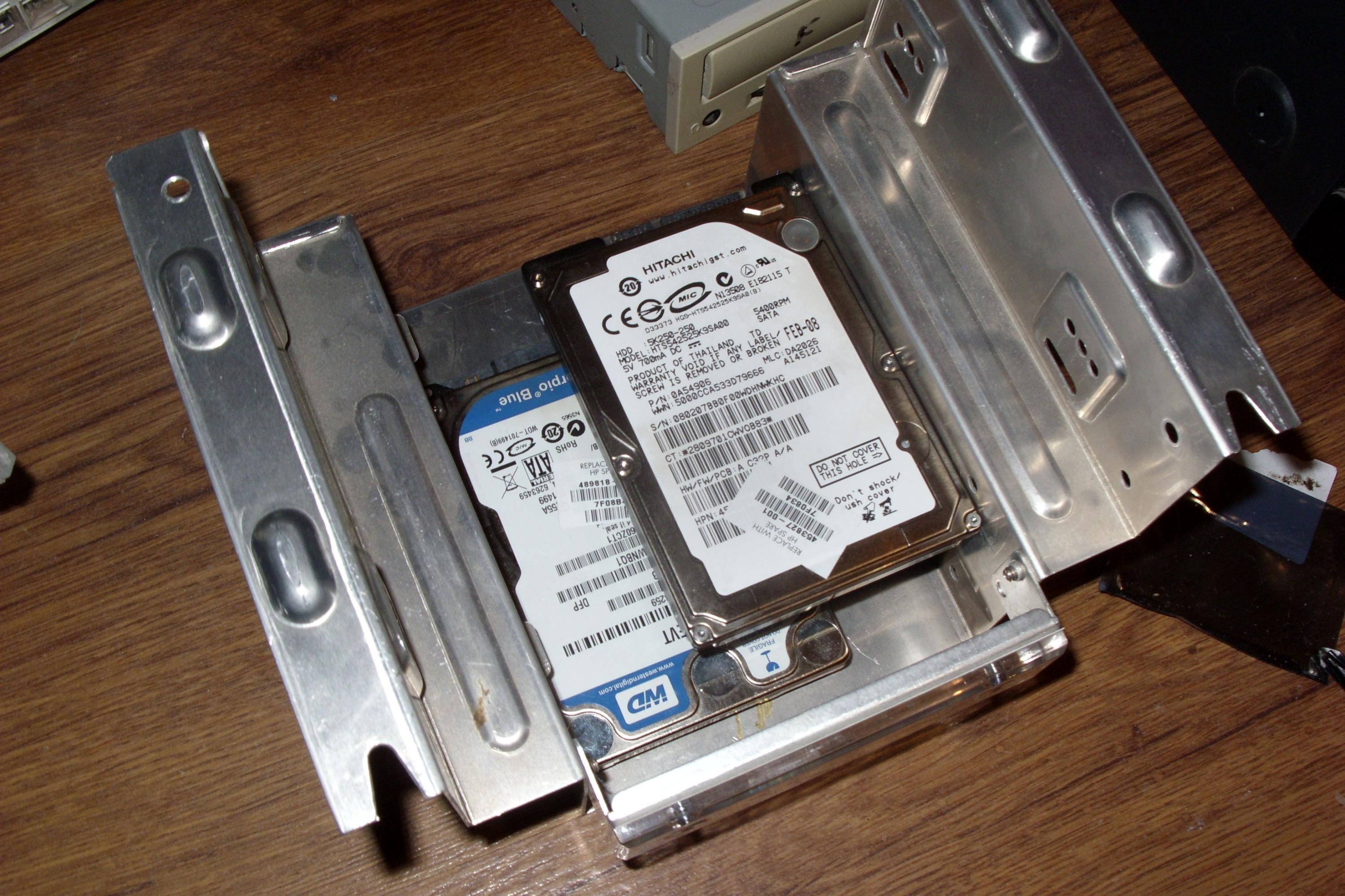

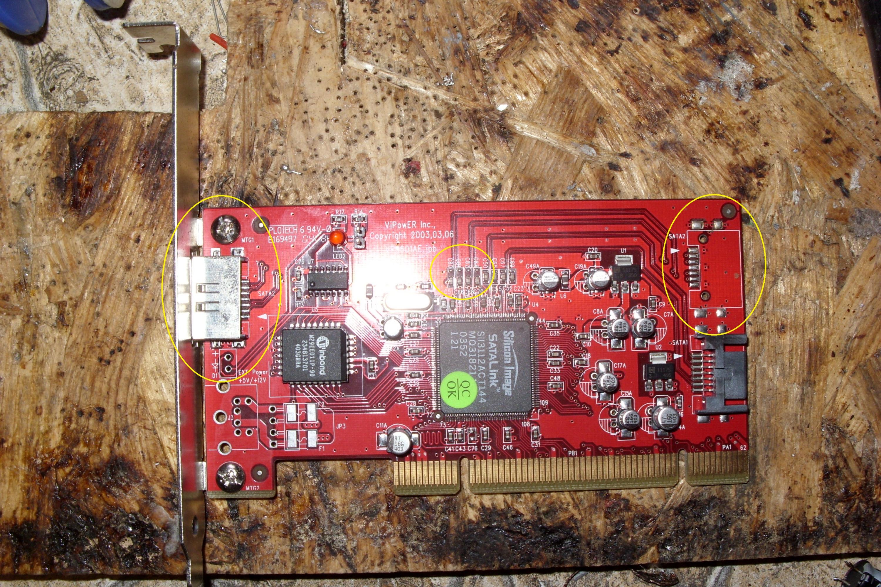

    Tried to put my laptop HDDs in, turns out i was SOL with the onboard VIA SATA controller, unless my HDDs have jumpers for SATA 1 mode, which they don't. I had this Silicon Image card lying around, but i had a problem with it. For some reason i cannot comprehend, one of the SATA ports was on the back of the card, on the PCI bracket, instead of inside the computer. Nothing my soldering iron, braid and flux couldn't fix.
    Btw, the notation on the PCB is reversed. The hacked port, labeled SATA 2, is actually SATA port 0, and is where the boot HDD (the 160GB WD) is connected.
    Then, of course, more trouble. I needed to flash a "base" (non-RAID) BIOS on the Sil3112A before Win7 would let me install - it would deny me installation because "your computer may not be able to boot from this drive". Really? Fortunately, flashing a non-RAID BIOS on the card allowed me to proceed.

    Unfortunately i don't have the funky CPU heatsink w/heatpipes the Shuttle came stock with, if anyone has one lying around, maybe we can make a deal. The SATA power connectors are another hack as it didn't have those, but i didn't post pics of that as there's nothing particularly interesting about soldering some wires to a PSU PCB.

        Re: Silicon Image 3112A SATALink port hack

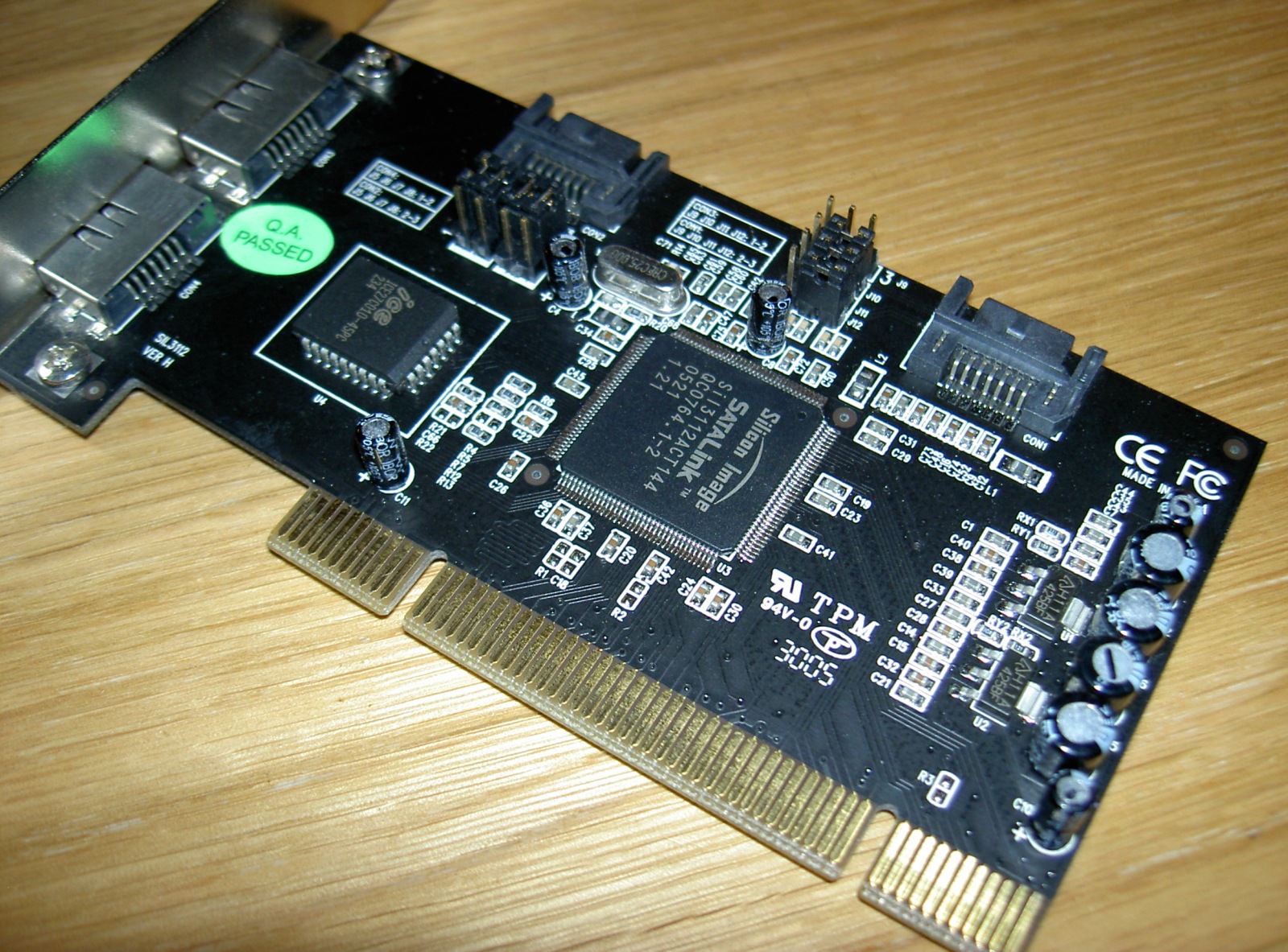

        You should have bought the super duper high end version with jumper switches for selecting eSATA or SATA mode
        On mine they recouped the losses in the jumper switches by using a ROM instead of a EEPROM so the BIOS can't be upgraded, fantastic!
            They put the RAID BIOS on it when it only has one internal SATA port, and the external port is a standard SATA port instead of eSATA?
              lti: Haha, yea, it did not even occur to me until you said it now, Amazing!

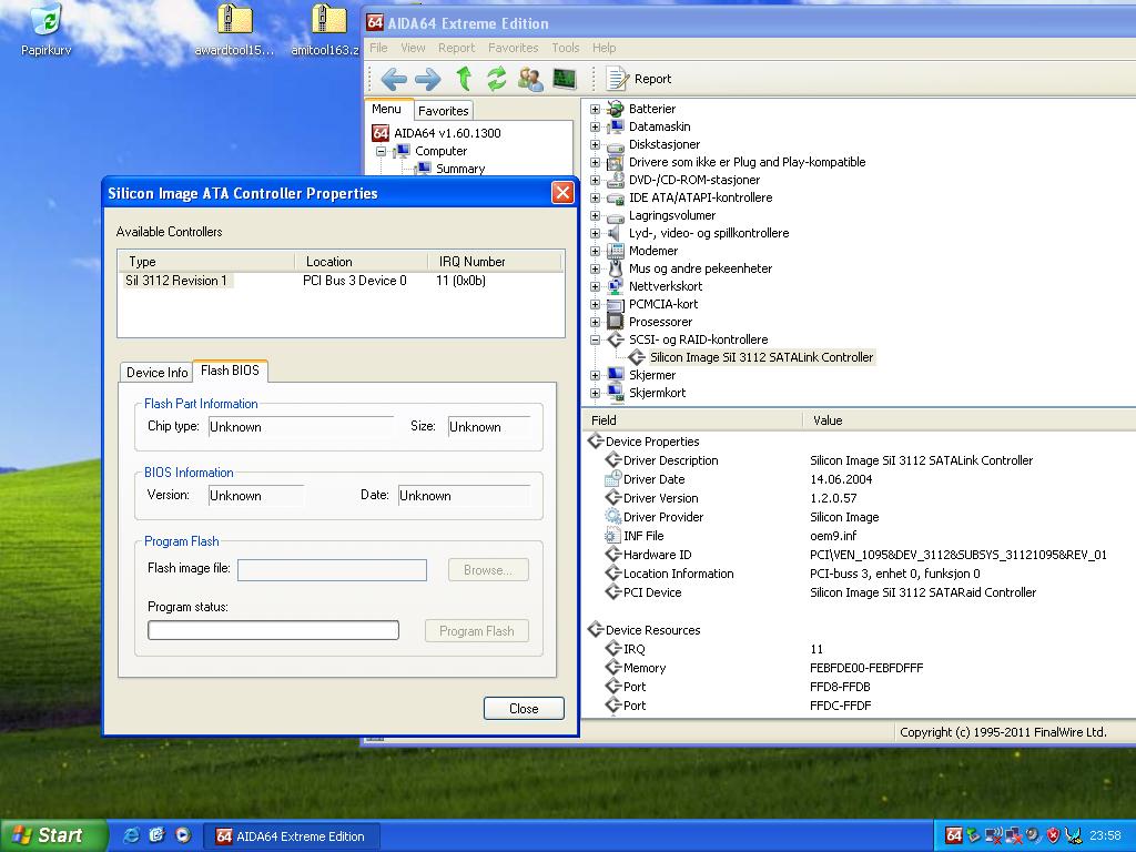

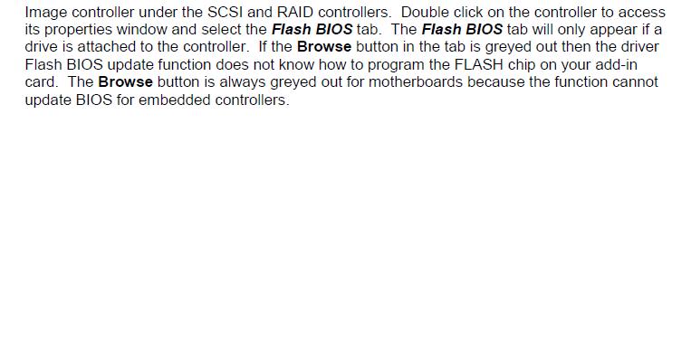

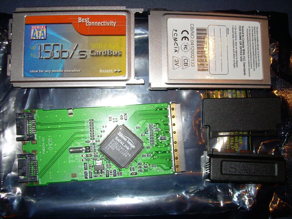

                I have a cardbus Sil3112 in my drawer, had to see if I was able to flash the card. Tried every driver on Silicon Image homepage but the browse and program flash was greyd out.
                Also tried the windows flash tool, could not get it to work.
                Got courious, maybe I will open the pcmcia card and see what chip it has and do a manually flash.
                  I've never been able to get the Windows flasher for Silicon Image to work, but the DOS flasher always worked for me (had to boot to DOS). There's also a utility that supports those cards plus several others, at http://www.FlashROM.org.
                    Opened the pcmcia card, sadly no separate eprom on this board so no chance of updating the firmware.
