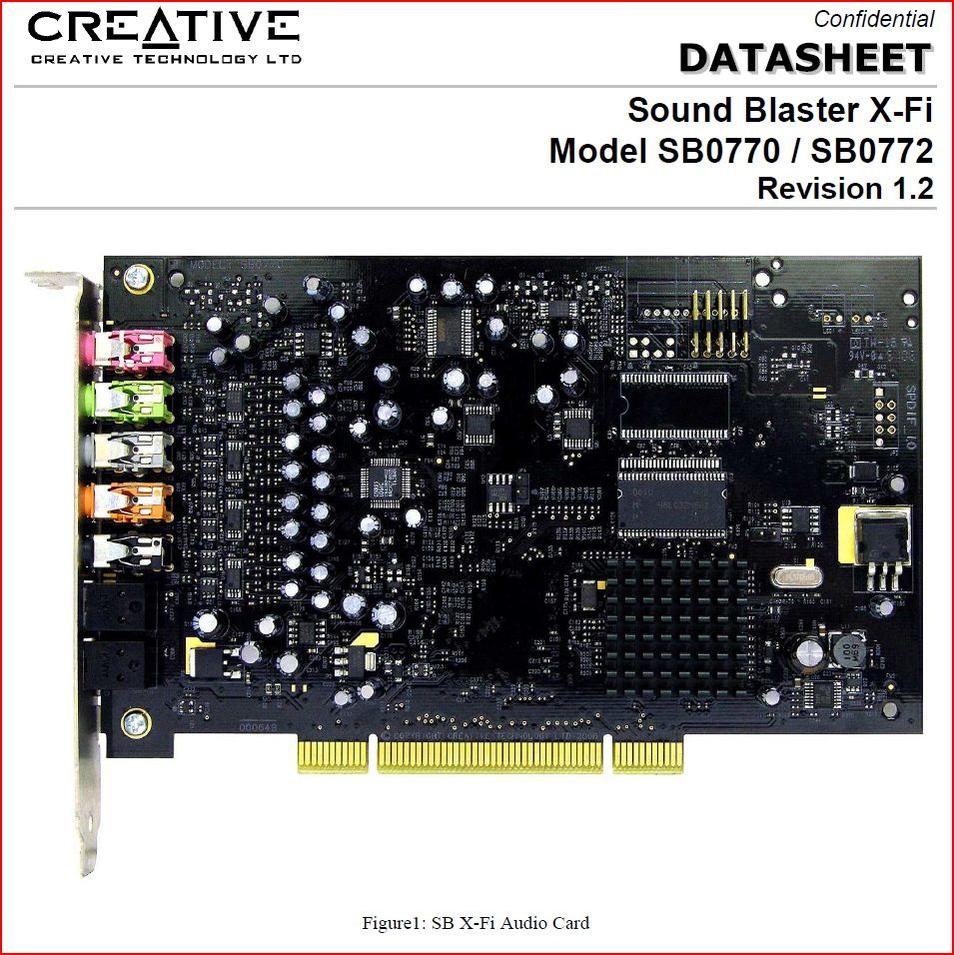

                          FYI:
                          I need a sound card because the Supermicro X5DAL-TG2 has no onboard sound.
                          Here's my slot layout:
                          1: No connector (Bottom of CPU #2 socket)
                          2: AGP Pro 8X
                          3: PCI 33MHz
                          4: PCI 33MHz
                          5: PCI-X 100MHz
                          6: PCI-X 66MHz
                          7: No connector (Fake raid chips and SATA connectors)
                          My GPU will take up Slots 2 and 3. Slot 4 is a 1394 card; its' also a spacer (so the two other large cards don't block the GPU fan intake). Slots 5 and 6 are the ones I'm having to pick from; both cards are quite large.

                            Dump the 1394 card, think really hard how often do you really use that nowadays.
                            Move the sound card in the second PCI slot.
                            Problem solved.

                                  Quite often, Actually. Mainly for my DV camera.
                                  Also, my sound card is quite massive and I thought it might interfere with my GPU's fan intake:
                                  However, it might clear.
                                  If it clears, I could send the the 1394 card to the bottom, the RAID above it, and the Sound at the top of the 3.
                                  I won't know until the GPU comes in.

                                      right now I'm on 10/100... the gigabit is onboard (intel copper controller).
                                      I ended up putting the sound card to the bottom since the cards did indeed block the fan intake. I fixed the LED header by bending the pins slightly so the header connects at an angle, thus allowing plenty of clearance.
