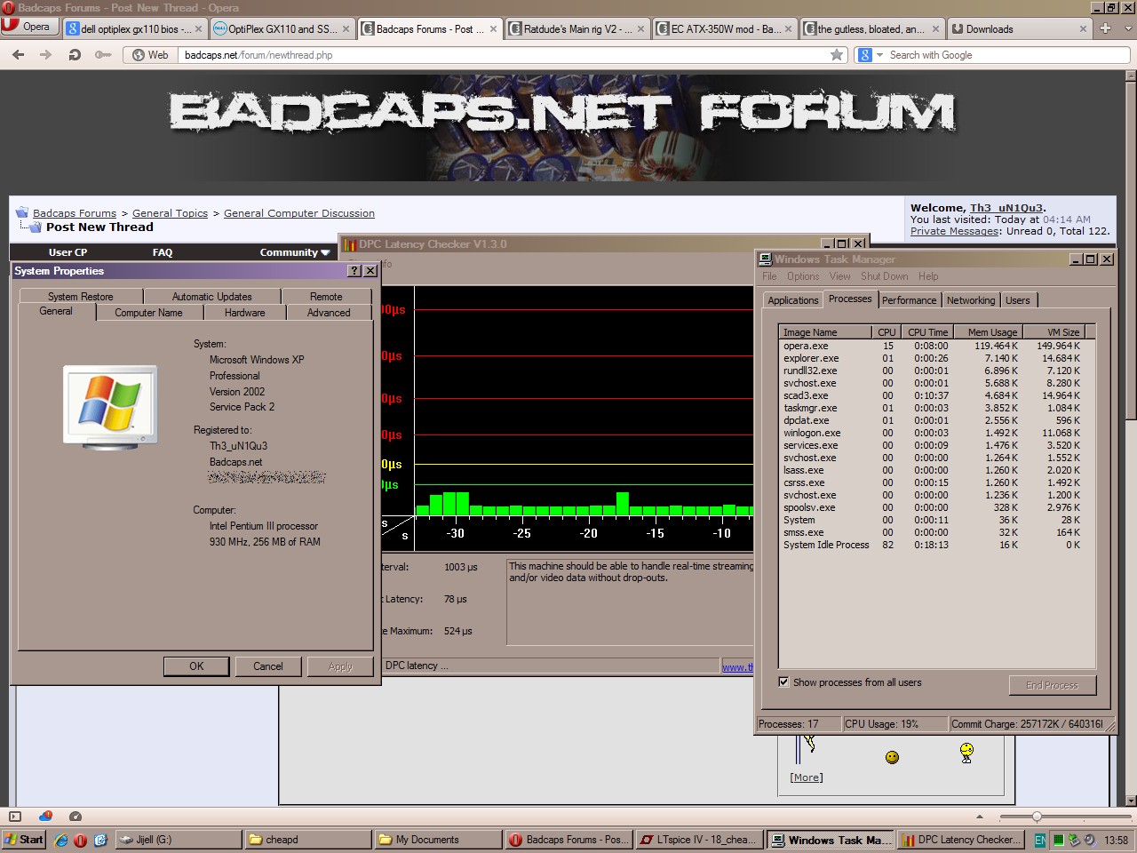

    Since my dv9000 failed i've been short of PC hardware. Mom uses the DV5 all the time (and constantly bugs me that her games hang, so the DV5 is on its way out as well), and i don't want to remember right now what's up with my main rig... It is, it works, it's just not here.
    I got myself a little iBook G4, and that does okay, but there are a few things that it won't run, most notably PCB design and circuit simulation software. And i really really really need that.
    I had this Dell Optiplex GX110 sitting in my closet for a while now. I intended it to be the next router/server box, plan was to put two GB Ethernet cards in it, a wifi, and a big hard drive via SATA -> IDE adapter. I put a P3-933 in it.
    Well, i never got the cards so it's been sitting ever since. So last night i decided to piece it together and make a working computer. I put 2x 128MB PC133 sticks in it (i gave away all my 256MB ones... the two i still have, it doesn't like), a 20GB Seagate HDD that a friend left here for free, and stole the CD-ROM from the (current) server box. And i used to have dozens of opticals lying around... None still working. Oh, and i had to fix the cable on this keyboard as well. I extended it with one that came from a mouse, so now i have a keyboard with a green PS/2 connector.
    Installed XP SP2 as that's what surfaced first from my stack of CDs, tweaked to absolute bare bones, and we're up and running. I also connected the 250GB Hitachi HDD that used to be in my dv9000 via this here USB to SATA adapter. I'm going to get a IDE/SATA, but this'll do for now. Display device is the good ole Dell P1110.
    Unfortunately the onboard Intel graphics can only do 1280x1024 at 24 bits, next resolution up is 1600x1200 at 8 bits, nothing in between. So i'm stuck at 1280x960 (for proper aspect ratio). Ahh well. I can see it from further away. There is no AGP slot on this box if that's what you were asking.
    Now to describe the machine... Yes, pics soon to follow.
    • First of all, the HDD bay was missing. No problem with that - the 20GB Seagate sits nicely on bubble wrap and foam - double insulated. This is a typically quiet drive anyway, so there were no noise issues to speak of, and now there's no vibration either.
    • The power button is missing from the front panel, i have to press it with a screwdriver. The reset button doesn't press where it should so that doesn't work either - but i hope i'll never need it.
    • The power connector for the floppy drive has been ripped off the PSU - wonder who had a need for it. I have plenty tho, and i'll only need the floppy to update the BIOS anyway.
    Other than that, the machine is very solid. Both PSU and CPU fans are thermally controlled, and it's really quiet. That's good since both are 60mm - if those were blasting at full speed it would have been quite a noisemaker. It's only got two 'lytics on the whole mobo, and those are UCC KY (IIRC), they serve as output coupling capacitors for the onboard audio. Everything else is SMD tantalums and OSCONs. Like a boss.
    I had some initial DPC latency issues due to the Microsoft driver for the onboard 3Com ethernet card. I've sourced the Dell/3Com driver and it's fine now. DipTrace runs, LTSpice runs (fairly slow to simulate, but it works), so i'm back in business. The only thing i still need to do is to install the networked printer, i'll be doing that right now.

      I'm pretty sure i can mod this thing to accept a Tualatin as well... But i'm out of Tualies anyway. Oh btw... printer working fine.
      While i was looking for a floppy disk to update the BIOS, i found my stash of good opticals, pulled out a DVD burner and a CD-RW. I decided for the CD-RW as i recall that particular burner being very slow (worn laser). It's not like i'll be using it anyway.
      Same friend which gave me the 20GB Seagate will drop by tomorrow with two sticks of 256MB PC133, a 32MB PCI video card and a IDE->SATA adapter he has lying around. Looks like i'll be maxing out this thing pretty much.
              Sounds typical. The onboard Intel i810 video in my HP is limited to exactly the same resolutions as your Dell. I still primarily use 1024x768 @ 85 Hz on the majority of my computers, so that's not a problem for me. I wonder if PowerStrip will solve your problems, though. I've used it only on one computer to force my HP A4032A 17" CRT monitor to refresh at higher than 60 Hz (Windows didn't allow me to do that no matter what because it detected the monitor as generic plug&play).
                Nope... PowerStrip won't support custom resolutions on intel graphics of that era, it says so in the FAQ as well. And don't tell me you're still using a 17" CRT. It's hard for me to work in less than 1440x900 (wide) or 1400x1050 (4:3).
