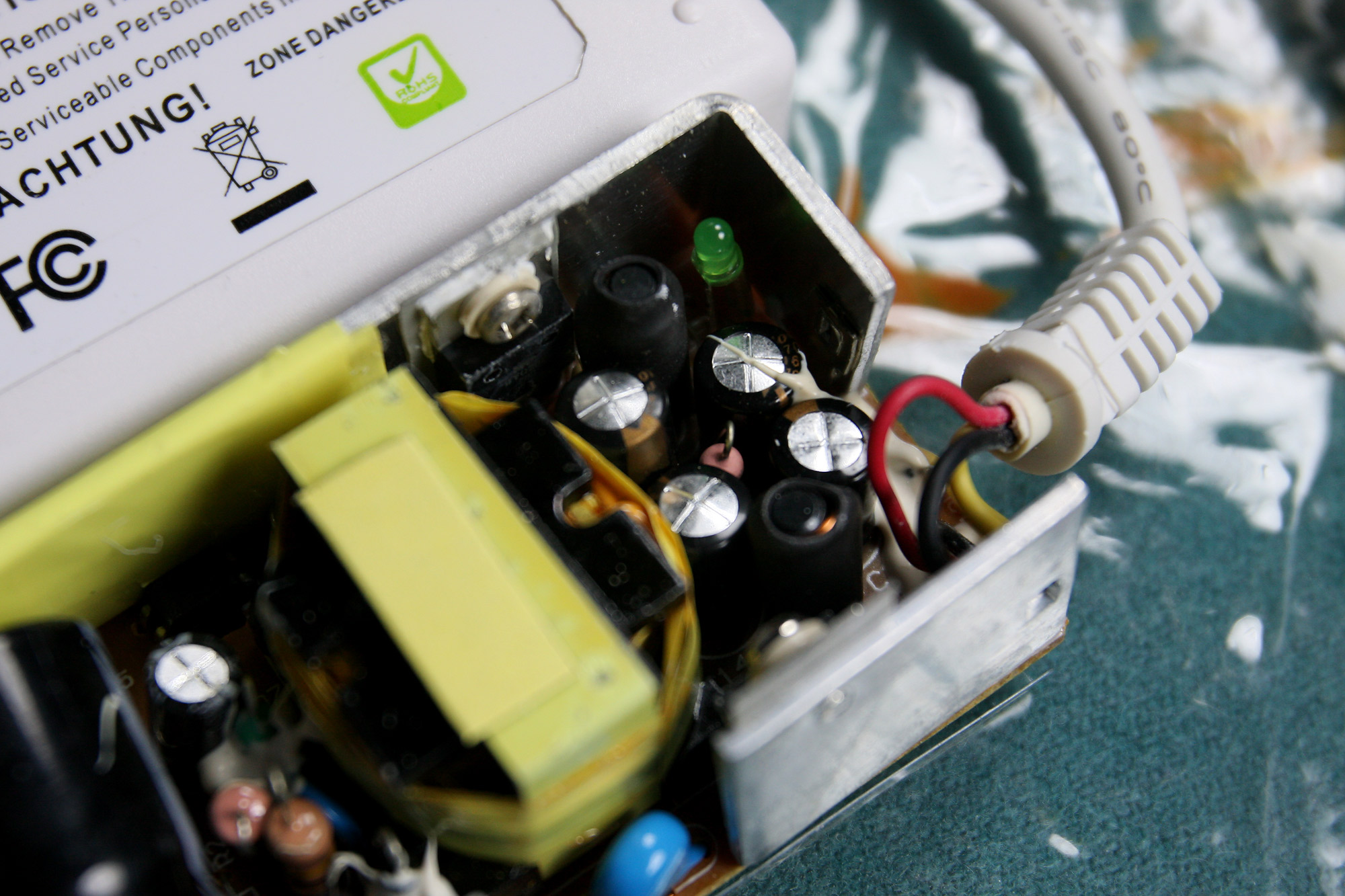

    I pull the dock and take it to the bench. Open it up, yep, the 5v is unstable under load.
    Crack open the brick power supply (literally crack open) and there we have 4 tocon bloaters.
    The worst is a 680uf 16v that measures about 30uf and 50 ohms ESR.

            My boss's boss brought me one of the same units yesterday. Asked me to determine if the drive was dead, or the dock. Checked, dock. I told him I'd fix it and give it back in the morning. I said it was likely a $0.50 part. He looked at me like I was an alien.
            Brought it back this morning, showed him the 4 bad caps. First he said "aren't those soldered in?" Yup.

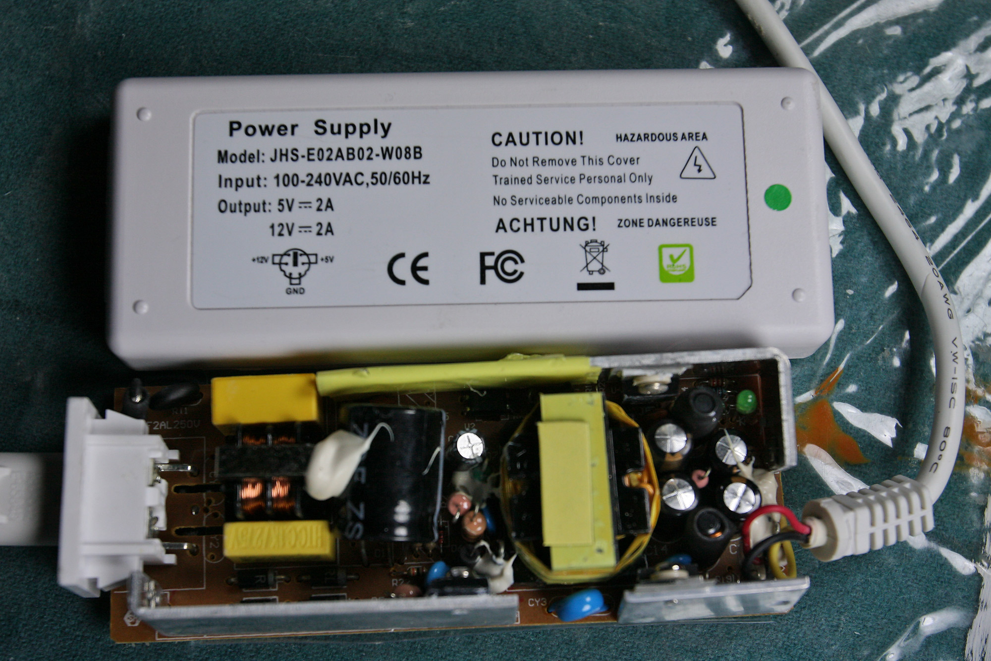

                  Re: SATA Drive Dock
                  Originally posted by ben7 View Post
                  And you should get pics too, just for the heck of it! xD
                  LOL, did your boss give you a raise? :P
                  No raise
                  Here are a couple crappy pics of the supply

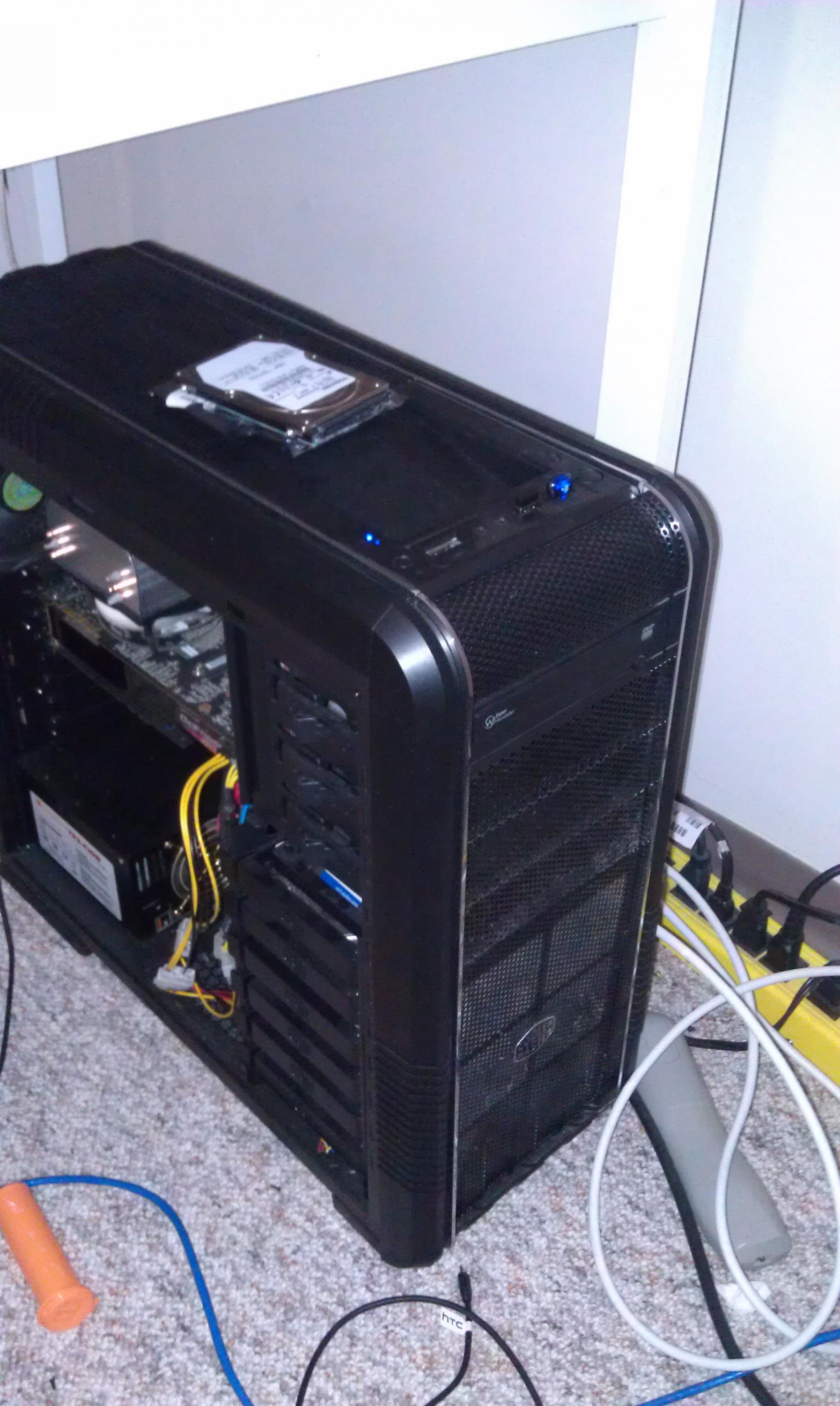

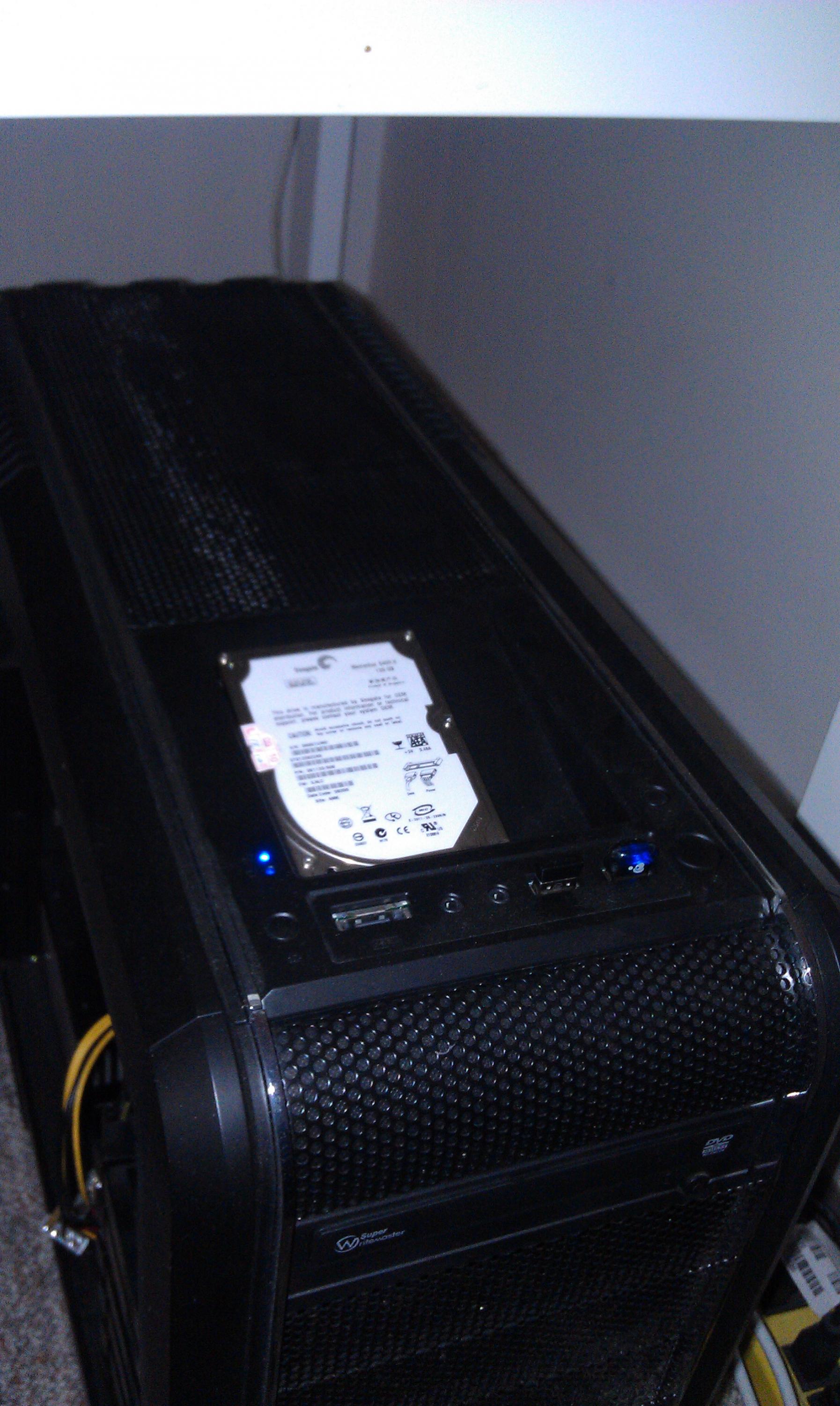

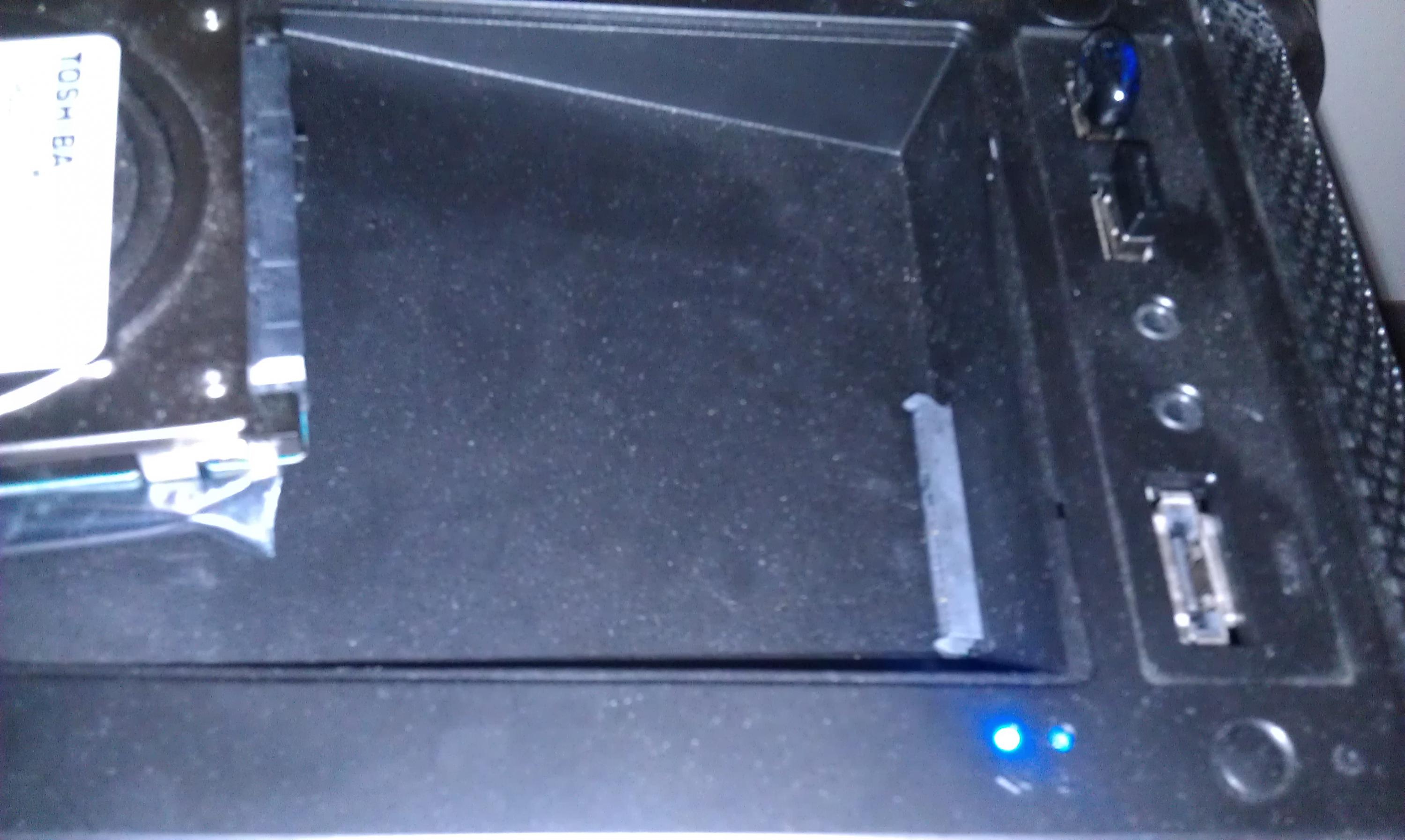

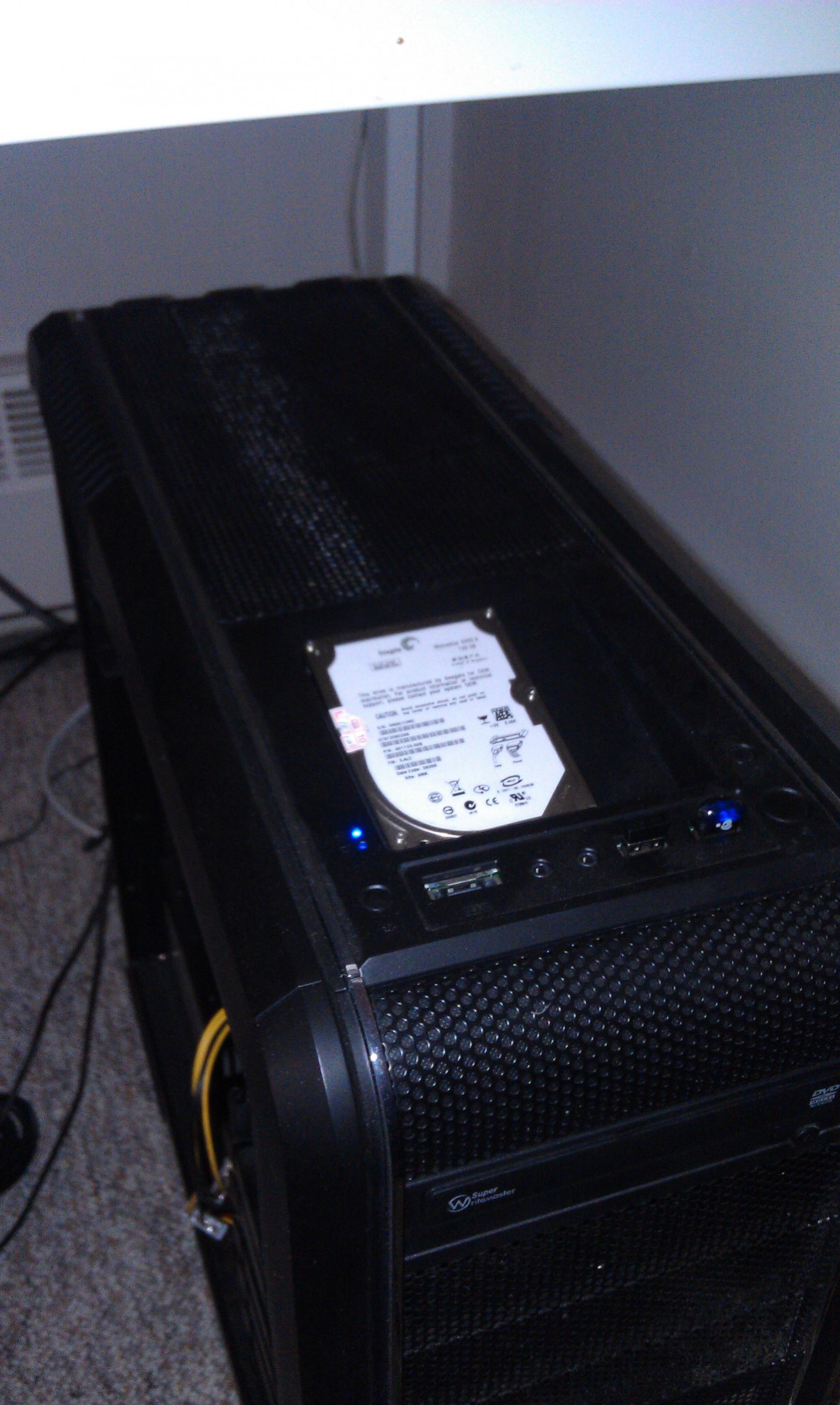

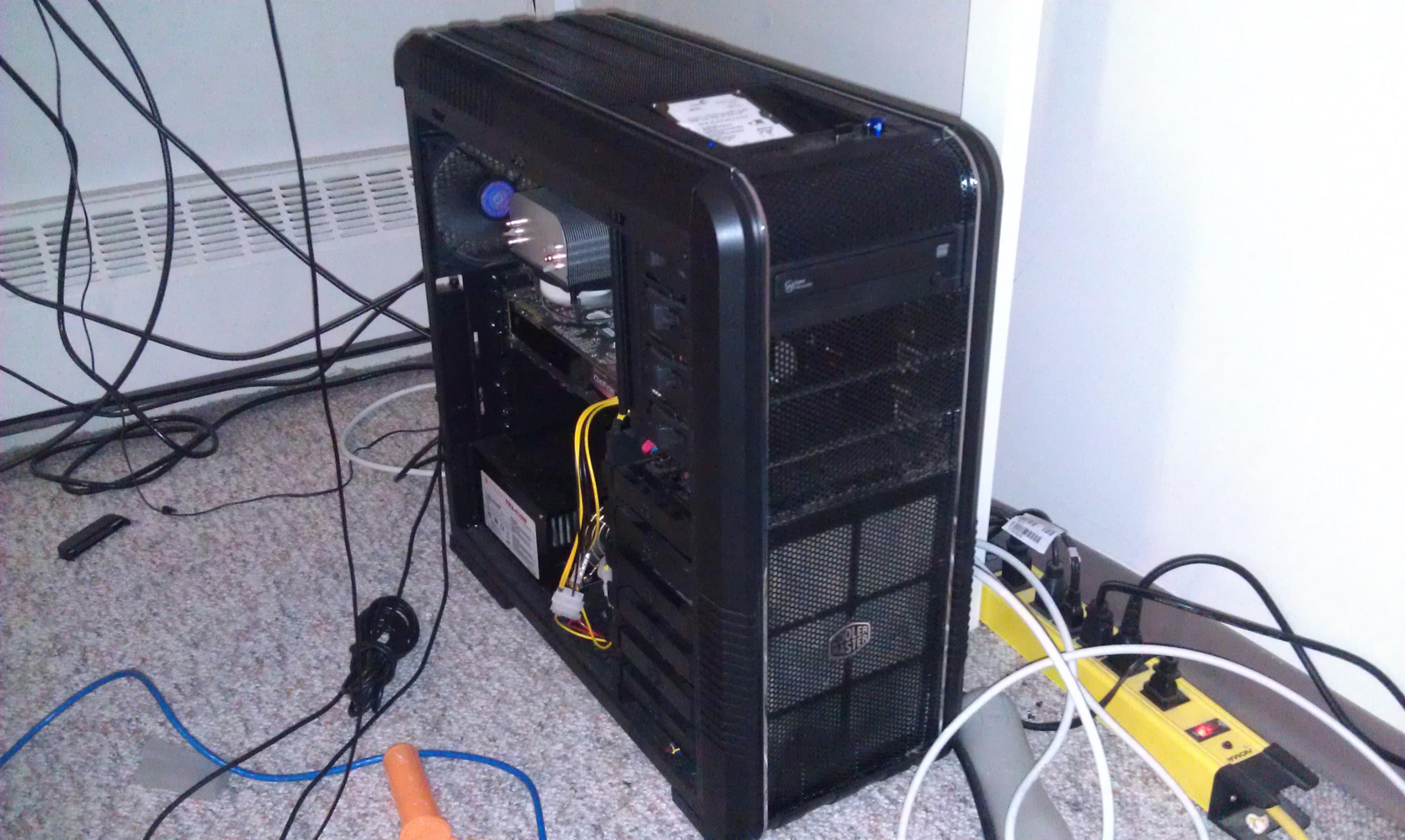

                    My Hard drive dock is built right into my desktop computers only issue is its not hot swappable so i have to shut the computer off or restart it after putting in a drive runs right off of my computers psu.

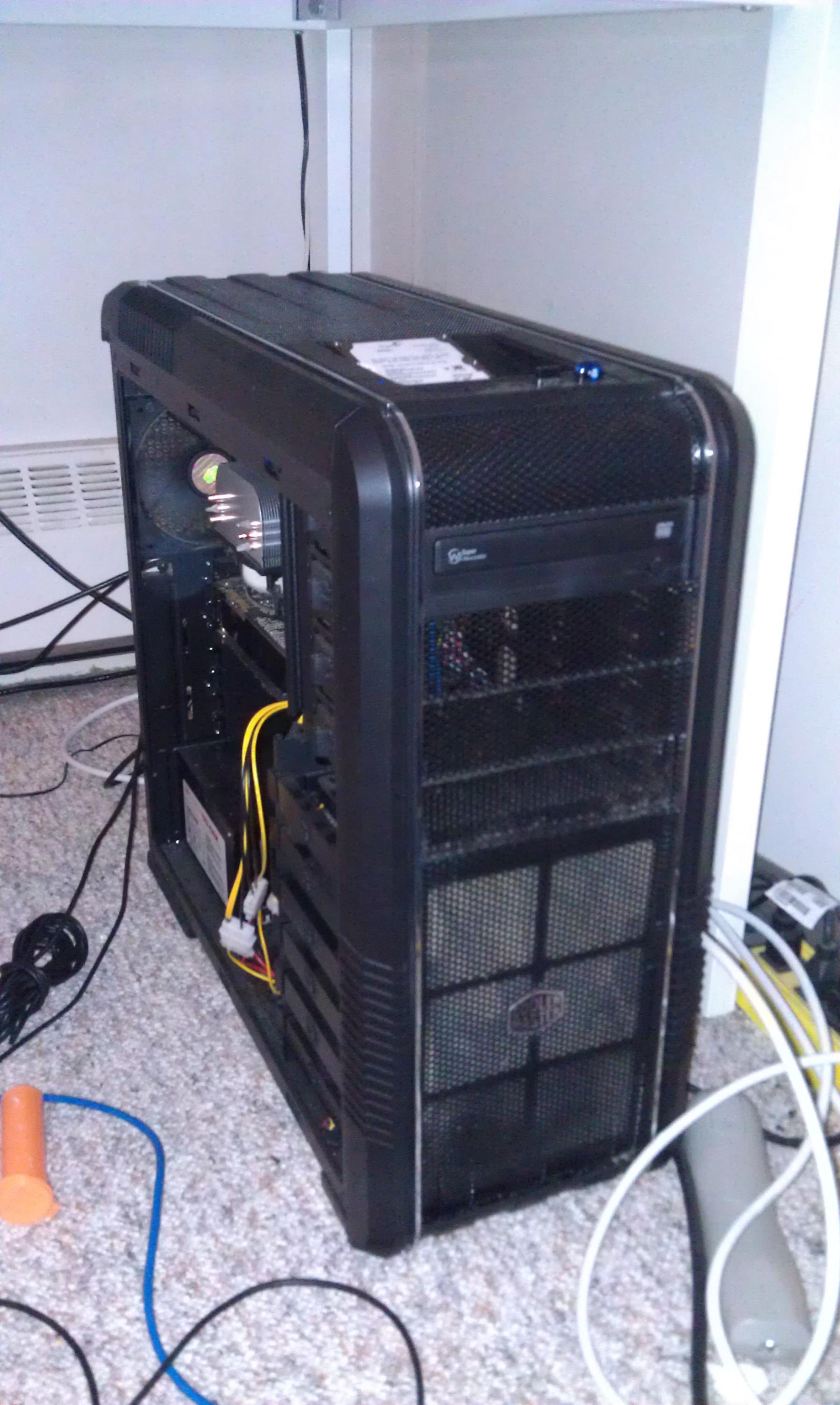

                      Re: SATA Drive Dock
                      my hard drive dock/computer.

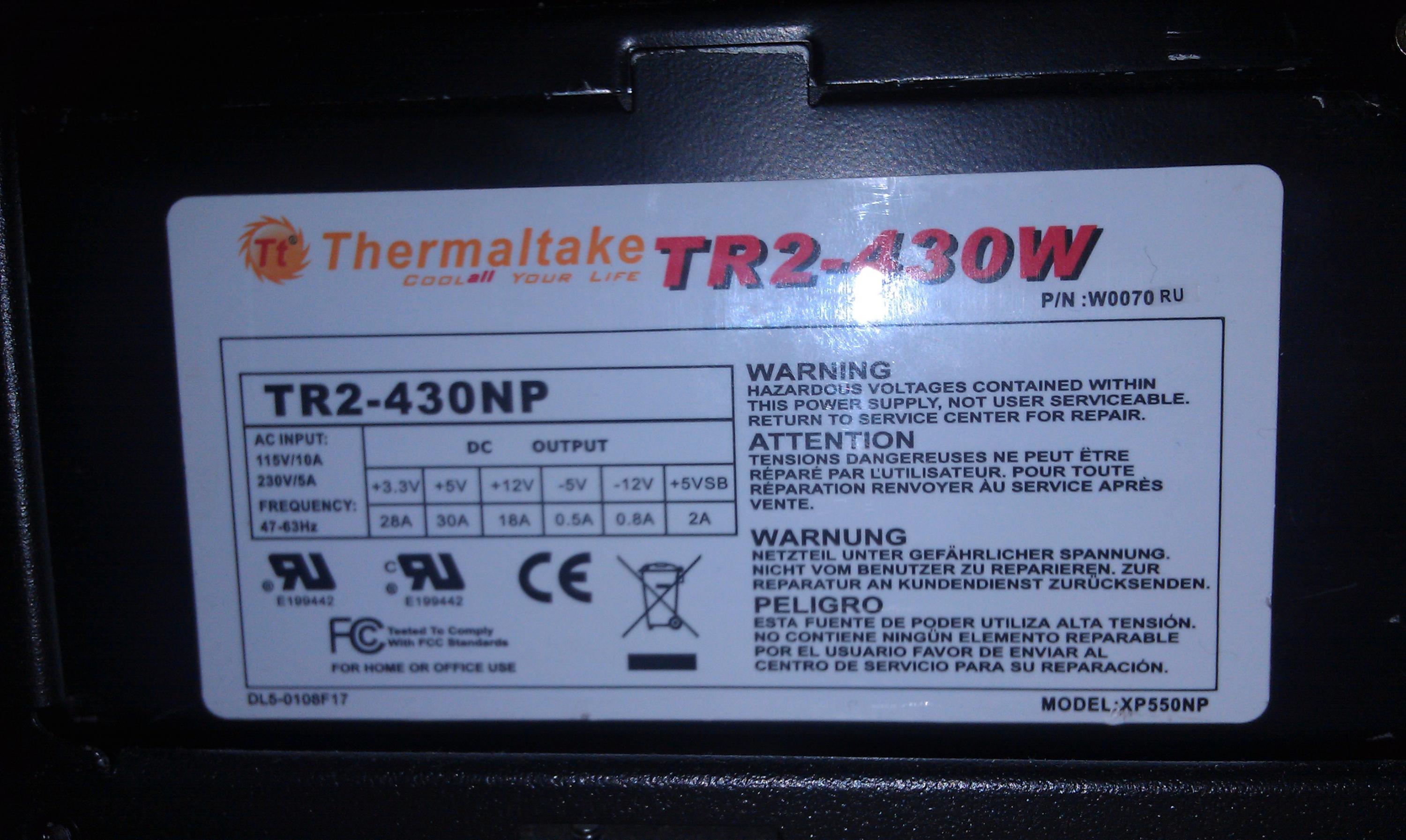

                        Re: SATA Drive Dock
                        I don't recognize that power supply label... what brand is that?
                        Seems like a super cheap, crap one, from the pictures.
                          Re: SATA Drive Dock
                          thermaltake tr2 430w

                              Re: SATA Drive Dock
                              Pretty cool that it's built-in. Really lame that it's not hot swap. I'd kill myself if I had to reboot every time I had to access a drive in the dock.
                              36 Monitors, 3 TVs, 4 Laptops, 1 motherboard, 1 Printer, 1 iMac, 2 hard drive docks and one IP Phone repaired so far....
                                Re: SATA Drive Dock
                                yeah its just an extension of the sata cable at least i dont have to hook up the sata cable and power cable with too much trouble.
