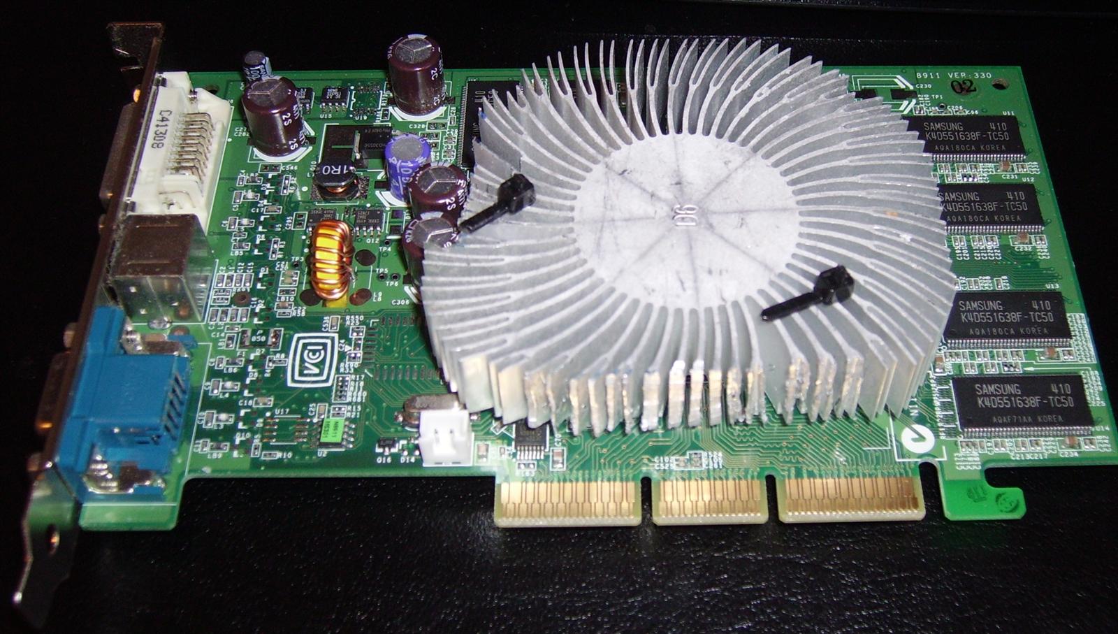

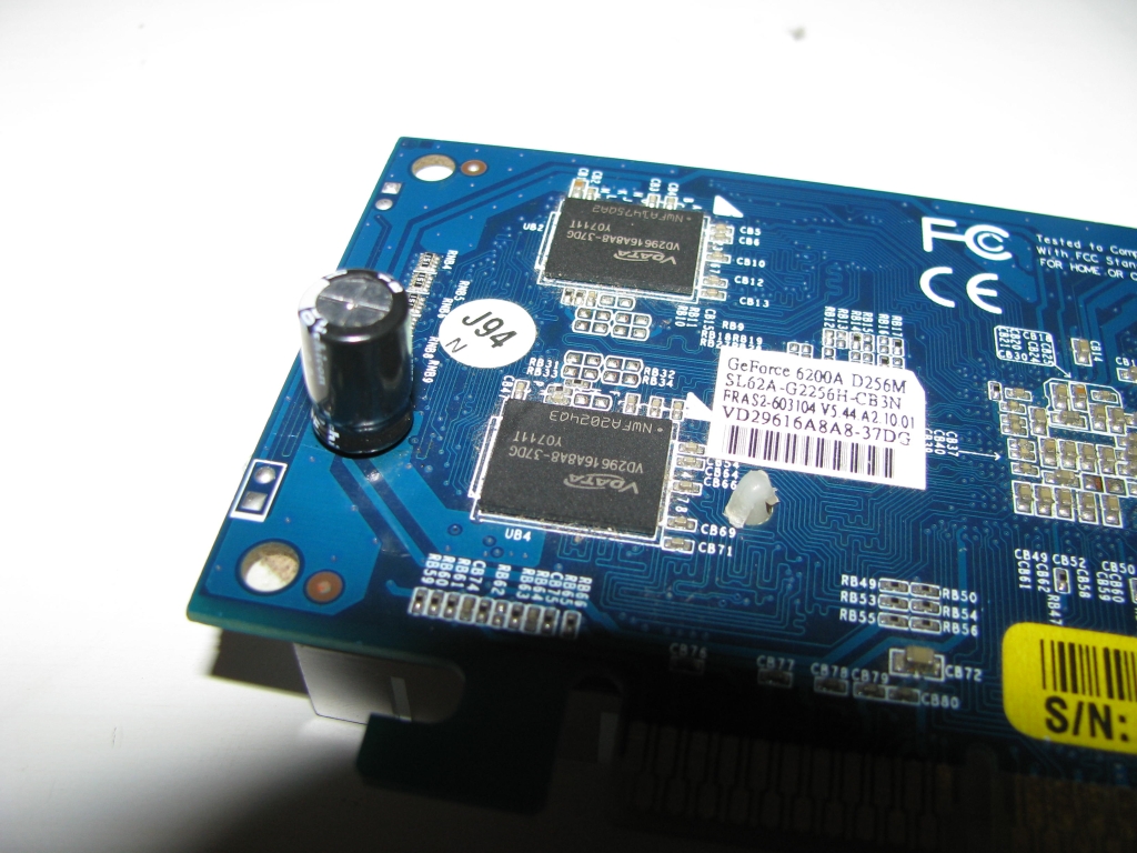

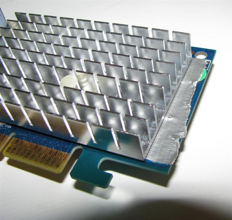

    GF 6200 AGP Ghetto heat sink/capacitor mod
    1 GF6200 card with a failed fan + a passive heat sink which almost fits + some tape = a ghetto mod
    I mounted the capacitor on the otherside of the PCB and used duct tape to make sure the legs didn't short on the heat sink.

    Re: GF 6200 AGP Ghetto heat sink/capacitor mod
    How did you solder the cap on the other side? Were the solder pads on both sides of the PCB?
      haha.. did something similar on a Radeon X1300XT.
      The original tiny fan died and I had no other fan with the same weird mounting pattern, so I tried mounting a big passive heatsink from a dead Geforce 8500GT..
      Trouble was: 4 caps, a coil and a quartz in the way.
      Solution: soldered the caps, coil and the quartz (all through-hole) onto the backside of the card
      Totally ghetto, but hey.. if it works
        Yup. It had solder pads on both sides

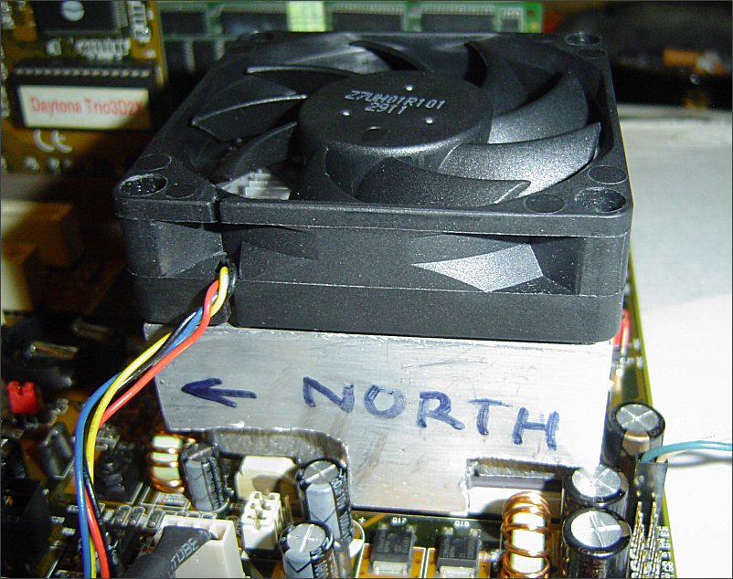

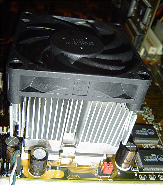

                    It's a socket A/462 heatsink ontop a K6-2 in a Super-7 board (another of my dinosaurs). The fan is 70x70 form factor, 65mm ⌀ propeller, standard Phenom II heatsink fan. As the SS7 socket is closely surrounded by caps the heatsink had to underwent heavy surgery.
                    All this is way overkill for a ~20W TDP K6-2, but better sure than sorry with cooling.
                    Seeing that I am amongst uninhibited people, I overcome my shame and proceed to torture your eyes with my GF6200 mods :
                    Euro 10, 20 & 50 cent coins make superb heatsink stuff, as they are made of nordic gold (89% Cu, 5% Al).
                    Credit where it is due, I got the idea from here.
                      Nice one TELVM! I've been thinking about trying a similar thing with some Xbox 360 CPU heat sinks and a few of my Pentium II and Pentium 3 computers. I have a friend that has a whole box of them that he says doesn't need.
                      Yeah, you could probably run the CPU without any fans and it will still remain within a reasonable temperature range. I would.
                      And then maybe add another one to that Daytona Trio3D video card
