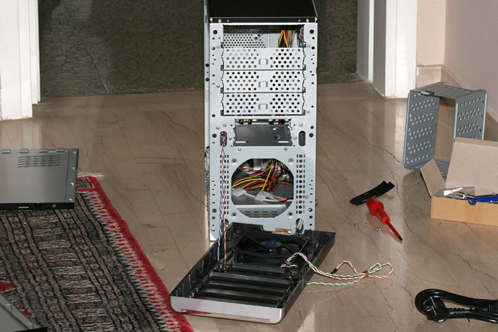

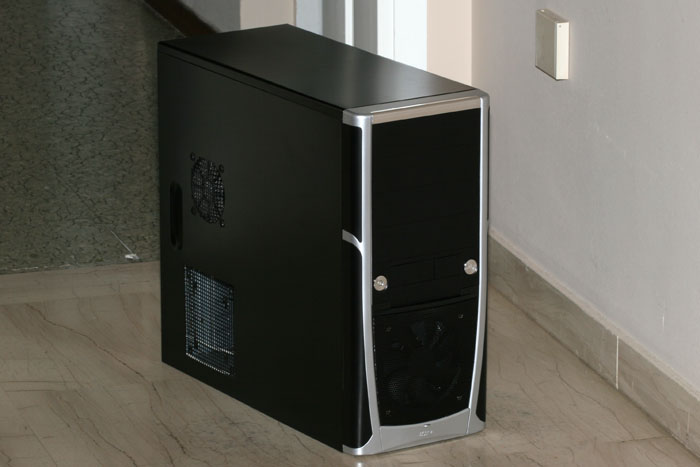

    I have already covered this case and the psu inside a bit in another thread but since this case has now dropped to 49 euro (or less with company discount) i will summarise and expand for our Greek friends because I think this case is good value.
    it has everything you need and is quite good looking if you use all black drives. Myself i do prefer all black because it is easy now to obtain black versions of optical and fdd drives at even the same price as the beige ones. Aluminium silver is very nice but then you are talking about aftermarket face plates etc to get it all matching. anyway i have done a few builds with this case and customers have been very happy, especially next to a silver samsung or LG tft and black/silver microsoft mouse and keyboard,
    it is something nice looking and these days it is possible to get a whole lot of good looking and functional computer for the money. Especially if people are upgrading from dial up to DSL which is still happening these days in Greece especially with those hanging on to PII or PIII systems with CRT monitor. Why not get a whole new setup but at a value price with value 19" tft and a new box which is fast and responsive and yes all colour co-ordinated. even with a celeron they can see the additional responsiveness and when the whole package is presented with tft and adsl they are very happy.
    anyway on to the case. here it is with samsung dvd (18 euro) and black floppy 8 euro. next is samsung 710v and logitech black keyboard. now the 19" monitors are the ones to get with samsung sm 930bf for gaming at 399 euro and sm913v for value at 269 euro.
    for the home user it is nice to specify black LG4167 or NEC ND3550 DVDr they are both 50 euro and very nice. also it is nice to have a black floppy with 7in1 card reader, everyone is using digicams these days. very useful and only 30 euro. I have zero problems with the teac units, they are much less problematic than the sandisk external usb ones. nice to have it internal even if the floppy is rarely used. for zero problems i am talking about the card reader functionality, for the floppy i have had a few fail, but who uses those these days.....
    anyway since the price is now 49 i got one to replace the case for my media pc. i wish they would sell it for less without psu because i have no use for that and it will be sold.
    so on to the first problem with the case. if you want to install floppy it requires removal of the entire front panel (6 screws) to get the floppy in with the rails installed. not a great start.
    you can see the case has external 4 x 5.25 bays and 2 x 3.5 and yes a 120mm fan, my first for home.

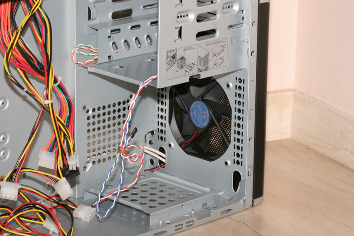

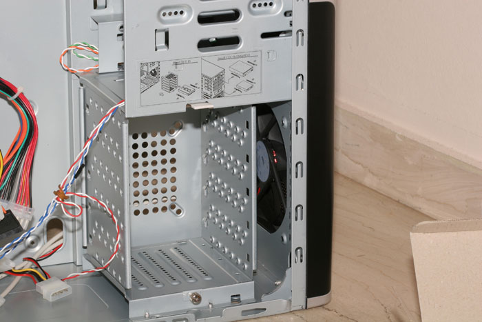

    the HDD cage is sideways configured for easy access. this is nice for convenience but as Galvanized said it is not so great for airflow from the front fan. at the moment i have it configured like that and i can feel blowback. the HDDS are connected with rails that snap in fine, i personally dont like rails too much but it is ok. you can fit 5 HDDs no probs but there is rails for 4.
    you can see also that while the floppy bays can only be used with rails, the cd rom bays can be used with screws or the provided metal rails. so i will get some brackets to get my hdds up there and remove the cage for better airflow. it is a benefit that the cd rom bays can be used with screws because if you wanted to use a front panel, it will attach nicely unlike other rail based bays. for instance on the chiefec cases which are nice, it is impossible to install a front panel which has short ears without some mods.
    so here we see the hdd bay removed and there is nice airflow from the 120mm fan. there is also option to install an 80mm fan blowing sideways to cooll the hdds if you liked. personally that is going to make some strange turbulence.

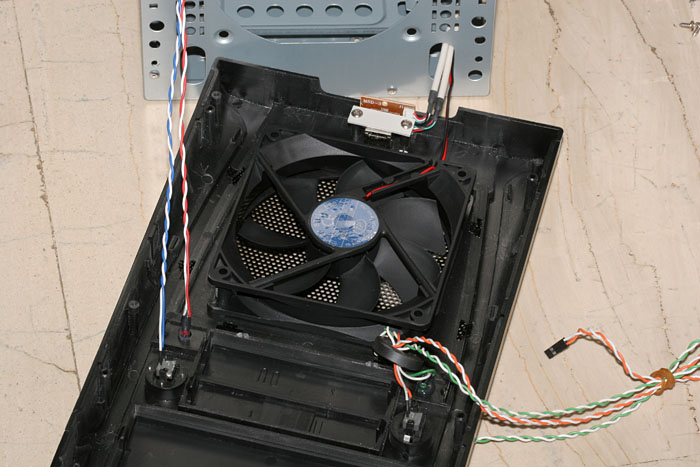

      so on to the front fan. it is a cheap Te Bao DC Brushless Fan, what did you expect? wowee anyway more money to spend on nice NMB fans. it is reasonably quiet at full power. in order to access the fan you have to remove the front panel which it is attached to on spikes, you could bolt one direct to the case if you wanted.

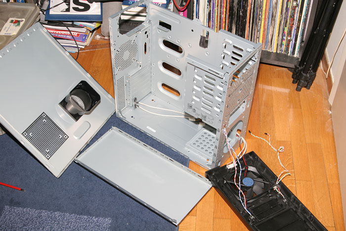

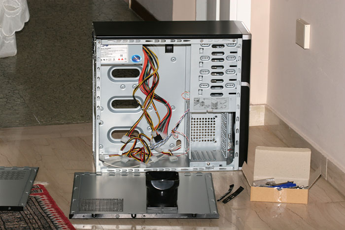

        here is the side of the case empty. the motherboard attaches with screwed in stand offs, i prefer those.
        here is the case with an albatron p865pec pro budget board in, like i have in my media pc. there is reasonably good space inside the case when compared to other budget models.

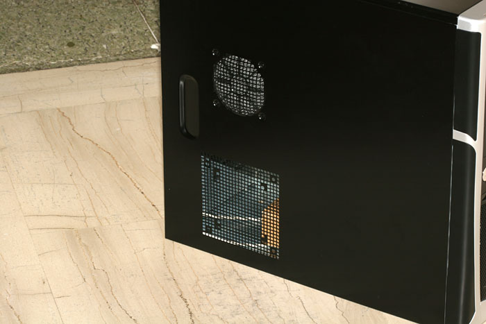

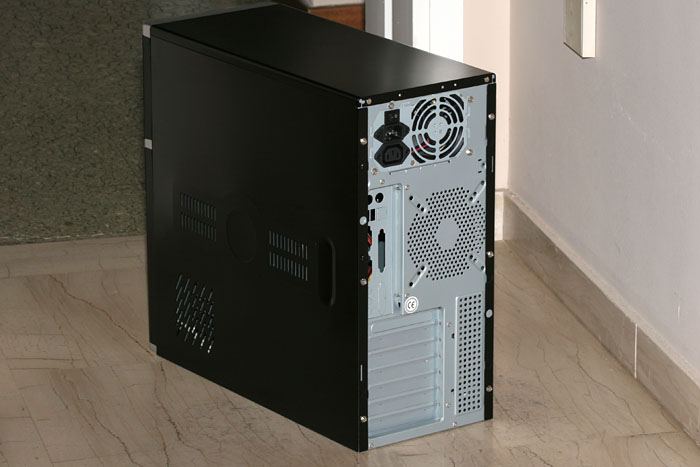

          on one side of the case you have the grille over the pci slots where it is possible to install two sizes of fans. also you can see the exit of the cylinder that guides airflow to the cpu. at the exit there is a plastic fibre filter which i have removed. looks fine if you wanted to keep it and regularly blow it out with compressed air.
          on the other side of the case you have the inlet for the 80mm fan at the hdd cage and also some general inlets for behind the motherboard. the motherboard tray is not removeable but both side panels and top panel are.

                      said drainhole will be dremeled....

                        The side saddle HDD cage does block intake fans. In this application the fans with straight blades seem to work well, as they throw the air off the blade tips and around most of the cage.
                        Sanyo Denki says fans should never be closer than thier thickness to any blockage on the suck or discharge side when used for case intake or exhaust.
                        Your going to move the HDDs anyway, so the above is a non-issue. I've mounted HDDs with grommets but next time that mod may not be done. I was reading where one fella mounted his HDDS solid in an aluminum cage and used a dot of TIM around each screw hole for better heat transfer. This helped the alloy cage be a better sink. Might do it next time.
