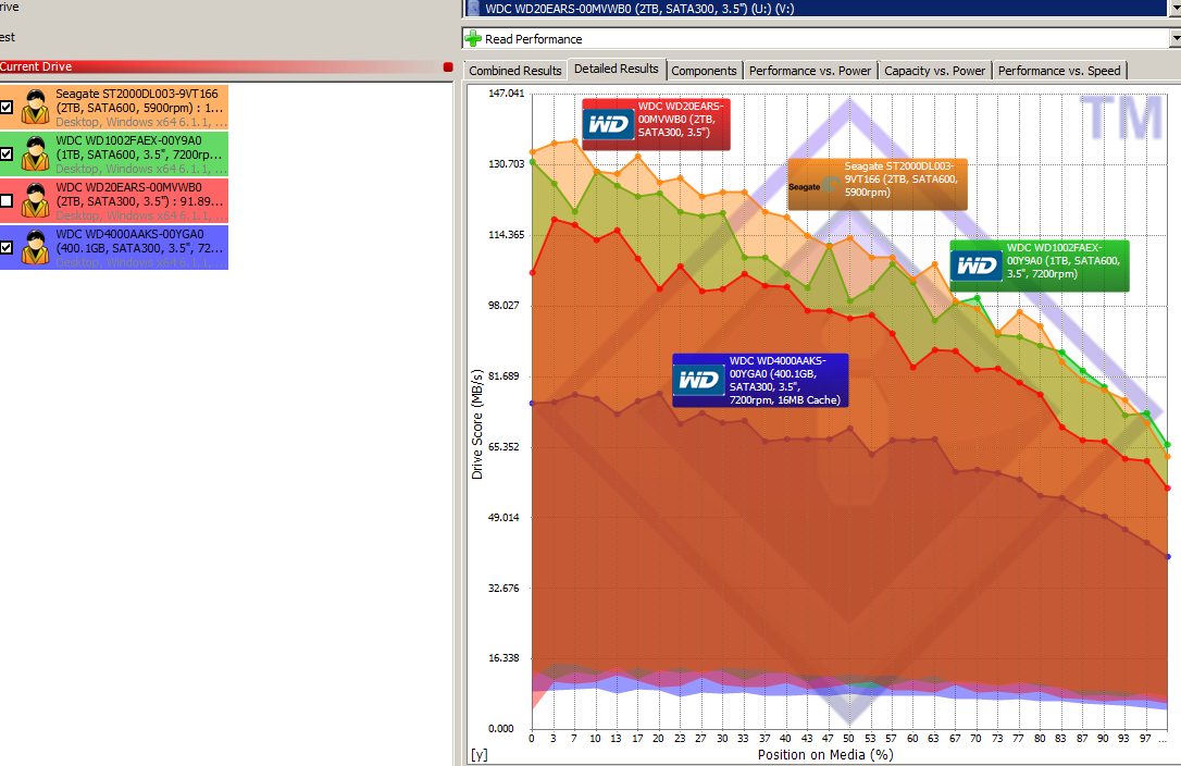

        While I agree that most hard drives with platters don't do 150 MB/s, a lot of them are very close to that limit.
        Here's a benchmark of my drives, showing all getting as high as 136 MB/s and keep in mind i'm doing other things with the system now, so it's not a very accurate test.
        I'm saying it's not worth it because the fabric, the processor moving data in that 3u unit, can only do 200 MB/s with both channel combined and can do only 20k IOPS. This was a decent value for the time when this machine came out but with more recent drives, even the integrated chipsets can do between 10k and 19k iops in software raid, as you can see here http://www.tomshardware.com/reviews/...a,2374-11.html
        A socket AM2/AM3 with 760g chipset is about 45-60$ and a cpu can be found on eBay for as low as 10-15$.. and you get the same performance this noisy power hungry thing will do - but as I said, I recommend gutting the internals and keeping the case + psu (if atx compatible) and mounting inside the drives.
        When you get 3 drives or more into a RAID-5/RAID-10, you're basically killing the performance of the drives with this hardware.
            Exactly.
            When you can't get over 150 MB/s in actual real world use anyway a faster interface isn't an advantage at all.
            The limitation is a physical MECHANICAL one.
            Basically, heads can only move across the disk so fast and still locate accurately...
            Interfaces can't fix that and they can't get around it either.
            The only thing that does get around it is a form of RAID with Stripping.
            Even then,, SATA 300/600 isn't an advantage over SATA 150 because the individual drives still have the same mechanical limits.
            Fact is the 136 MB/s you are getting is ~barely~ faster than ATA133.
            ATA133 drives with the same vintage [tech level] mechanicals as your drives [the mechanicals have advanced over time but slowly] wouldn't have any trouble keeping up with your SATA drives.
            The interface just ISN'T that important most of the time.

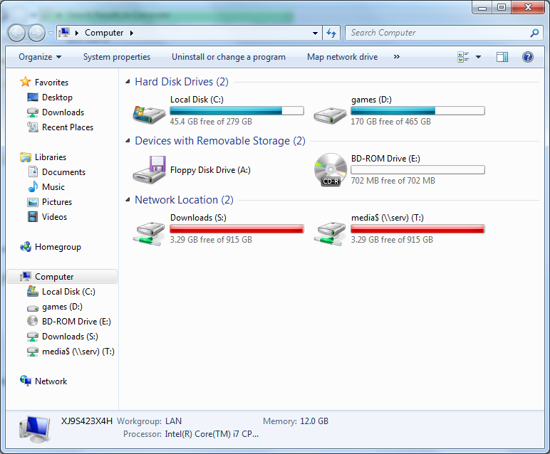

                                      actually, its about storage performance. My gaming box has 2x 300GB VelociRaptors intel raid 1 (ICH10R) for OS and basic documents, and 2x500GB WD RE3's in raid 1 on the same chipset for games
                                      No, this is for massive storage. Right now I have 2x1TB black in linux raid on a PE 1800 for all other storage. I actually have my win7 downloads folder assigned to a mapped drive. I have all my downloads from firefox, downloads from torrents, an image of my old HD, and some video editing things (source files and videos for projects made with pinnacle studio 12/14)
                                      I also have a public read-only shared folder for hosting files that I need to do when fixing peoples computer. All in all [attachment] is what I have left
                                      and thats WITH EXT3 COMPRESSION. I have probably about 1.2TB of data on that thing
                                      The picture has two mapped drives that show the same size cause they're different folders on the same volume. And I run out of space all the time!
                                      I LOVE how I can download any files off it at 70-90MB/s over my gigabit lan, and I hope to match or increase the speed at that
