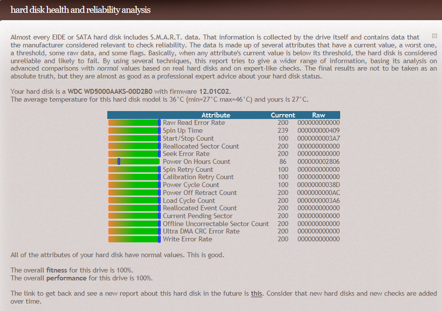

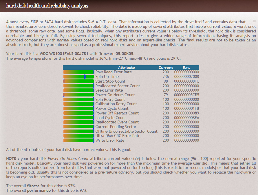

    smart data for my hdds

      Nothing wrong with them that I could see, but the "SMART Analysis" thing in Speedfan is pretty much junk.. (who wants to manually convert the hex values?)
      Something like HD Tune does a much better job.
