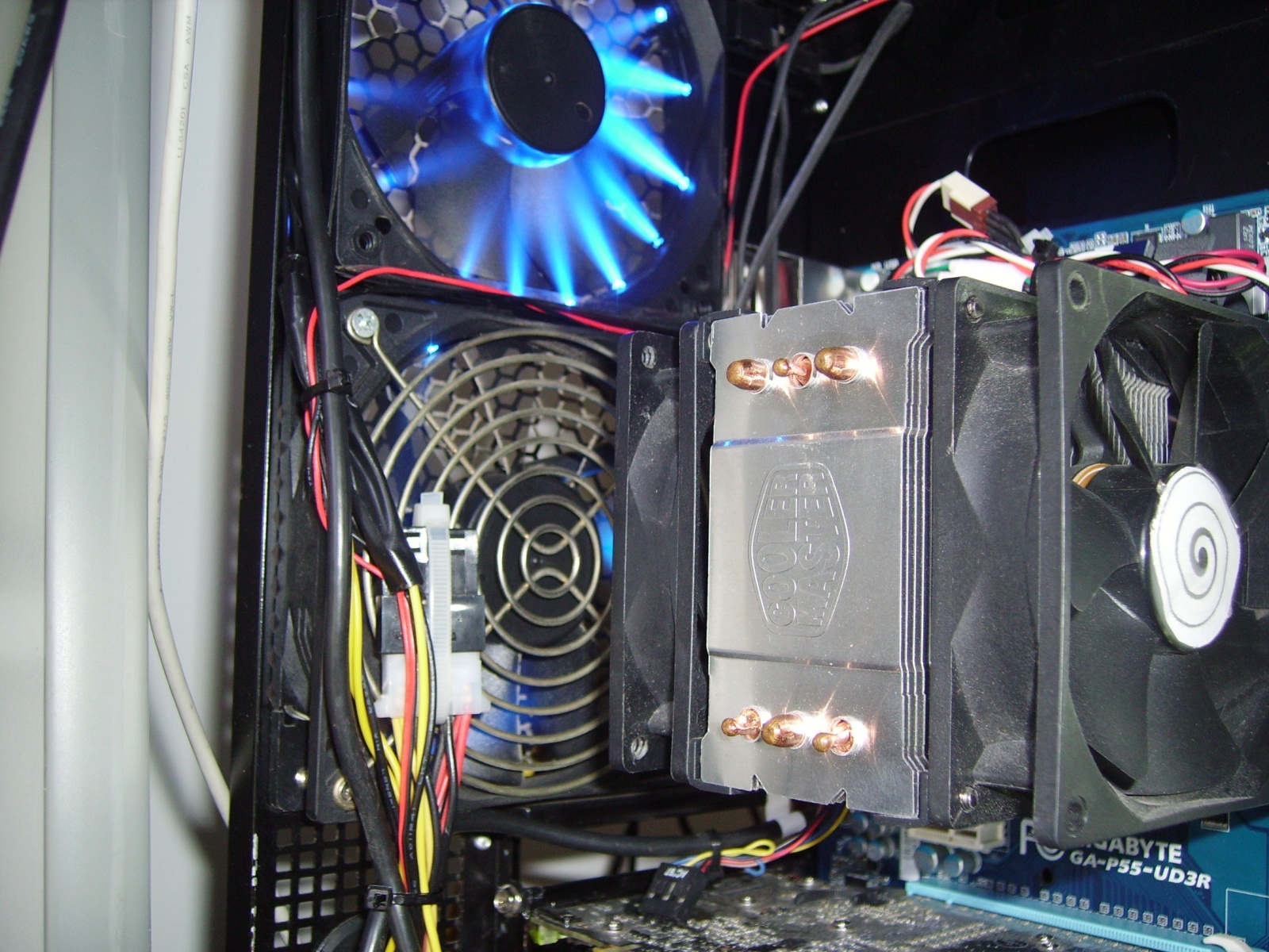

    As you can see in my signature, The case on my main PC is an Antec 1200. I got it for only $100 because the top doesn't stay on. It only had two very small screws to hold it on the lugs they scre into snapped when my boss picked it up by the top. It's good looking and has been serving me well for the two years I've had it, but i fired my PC up yesterday and I got that 'growl' from the top rear fan. So I replaced it with a cheap no-name fan which I scavenged from a dead PSU and added a few LEDs to and the growl is gone now, but after removing the sticker and rubber seal from the old fan it's a sleeve bearing with NO oil. Nice job antec. You sell a $300 case with 6 cheap and nasty fans, don't put any oil in the bearings AND use two tiny screws to hold the top on, even when the case by itself weighs 15KG!!!! antec
    It's excusable for a cheap $30 case, but when the case usually costs $300, I think it's only fair to expect half decent fans and a case that doesn't fall apart when you pick it up. Again, antec
    PS. I'm nearly ready to change my avatar to this
    EDIT: It it's any consolation, at least my new fan does look a bit better (it's the top one in the second attachment)

    I heard that sleeve bearing fans are not supposed to be run horizontally. All cases come with cheap sleeve bearing fans.

      They're not being run horizontally here. I know they usually do come with cheap fans, but when it's an expensive case, one would expect better.
        Wow. No oil at all... Good ol' "stoopid power" antec.
        Usually, they'll have that 'sludge' that passes for oil, as typically used in Chinese shit.
        I've been using Supco turbine oil for years in those little fans. Before that, the 'needle-oilers' that could be found at RipMeOff Shack. GC Electronics makes (made?) one too- MCM sold those.

          Putting a drop of ATF on the bearing is my signature move for fans. It has yet to fail me.
          I have a 120mm Cooler Master sleeve-bearing fan in my PC and about a year ago it started growling at me. I cleaned that China sludge off the bearing and lubed it up with ATF and I haven't heard anything from that fan again.
          Fans are moving parts, I can't call them crappy for needing a drop of lube every few years. Flimsy build quality, crappy noise-to-power ratio, or complete failure of the bearing are what qualify a fan as "crappy" for me.

              @WLG, I recently pulled an NMB Ball bearing fan from a Pentium 2 machine. It was very dusty from heavy use but it worked perfectly with no strange noises. I think it goes to show that fans can last for years withoput needing lubrication given a good ball bearing design.
              @Topcat, I know Antec probably didn't make the fan, but when you're paying $300 for a case, I think they could bundle some ball bearing fans with it, as well as use more screws so you can actually pick it up by the top without breaking it off.
              EDIT: As for who makes the fan, my guess is Dynatron Top Motor. They can make cheap sleeve bearings (which is what Antec used in my case), but I have also seen them as good ball bearing fans.

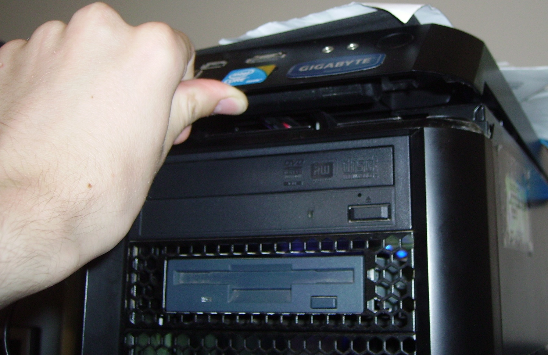

                Is there a handle on the top, IE, was it designed to support that much weight? Some cases designed around gamers did have such a feature, and of course those tops had thicker gauge steel and more screws and/or rivets holding them on. Normally, the top of a computer case isn't designed for that kind of load at all.

                  not sure who the oem was but the fans in a friends 1200 died off from lack of oil.
                  it had dried up.had to wash out the bearings and re oil.
                    It doesn't have one of those stick out handles, but it does have what appears to be a perfect place to stick your fingers when your picking it up (as well as a similarly sized indent at the back. Whether or not it was originally intended to be handle or not, I don't know, but antec should have seen that it sure looks like a good way to pick it up, besides, how expensive are screws nowadays? Using a few more would have only cost like 20c.

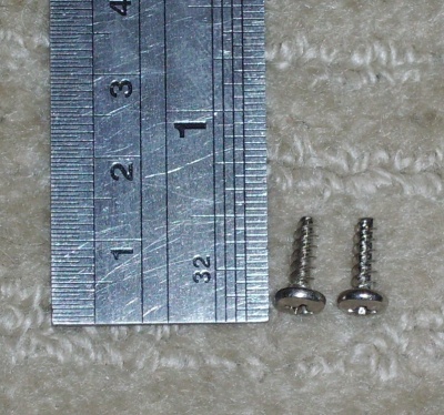

                      I should perhaps add that the two screws they used were like these two. As if they were ever going to hold 15kg.

                          That case is not ment to be lifted from that lip, that is why it only had 2 screws. The CD Rom also looks like a good cup holder but isn't so dont use it as one and blame someone else.

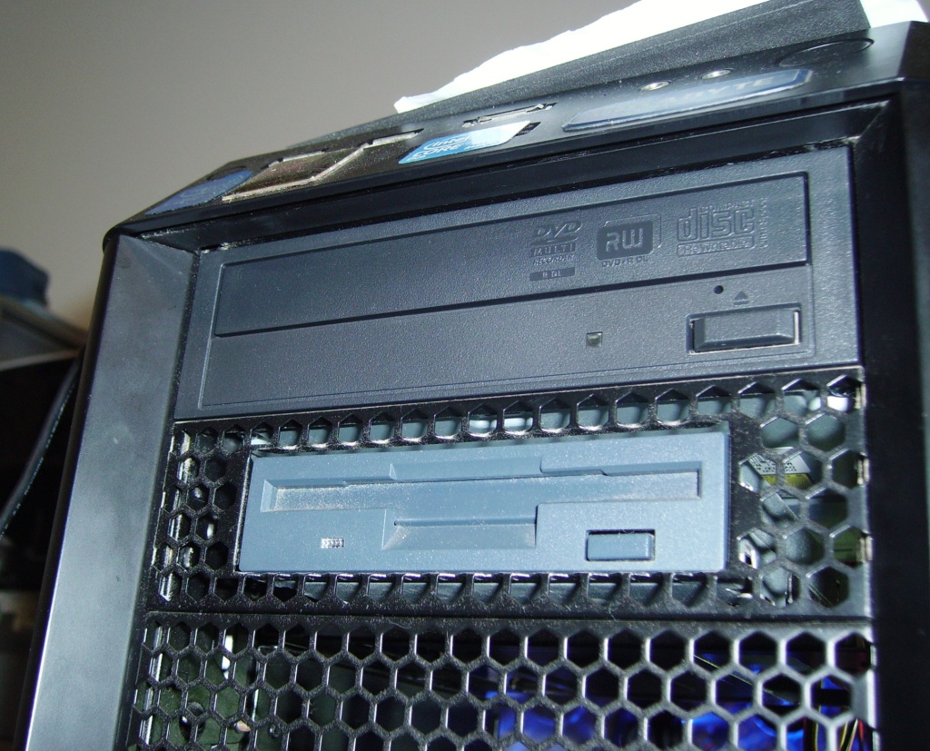

                            You've got a floopy?
                            • c_hegge
                              • Sep 2009
                              • 5219
                              Re: Nice job, Antec (rant warning!!!!)
                              Don't worry. It ain't plugged in to the motherboard. It's there because it looks better than a hole. Ive been considering replacing it with a card reader.
                              • lti
                                • May 2011
                                • 2548
                                What is wrong with having a floppy (or floopy) drive?
                                • c_hegge
                                  • Sep 2009
                                  • 5219
                                  It makes the PC look old.

                                        Sorry to dig up this thread, but I should perhaps add that the top rear fan is actually the second fan that failed. I've already oiled the front bottom one and it's dead again now. If nothing else, it's a good excuse to get some Enermax Apollish Vegas fans in there.
