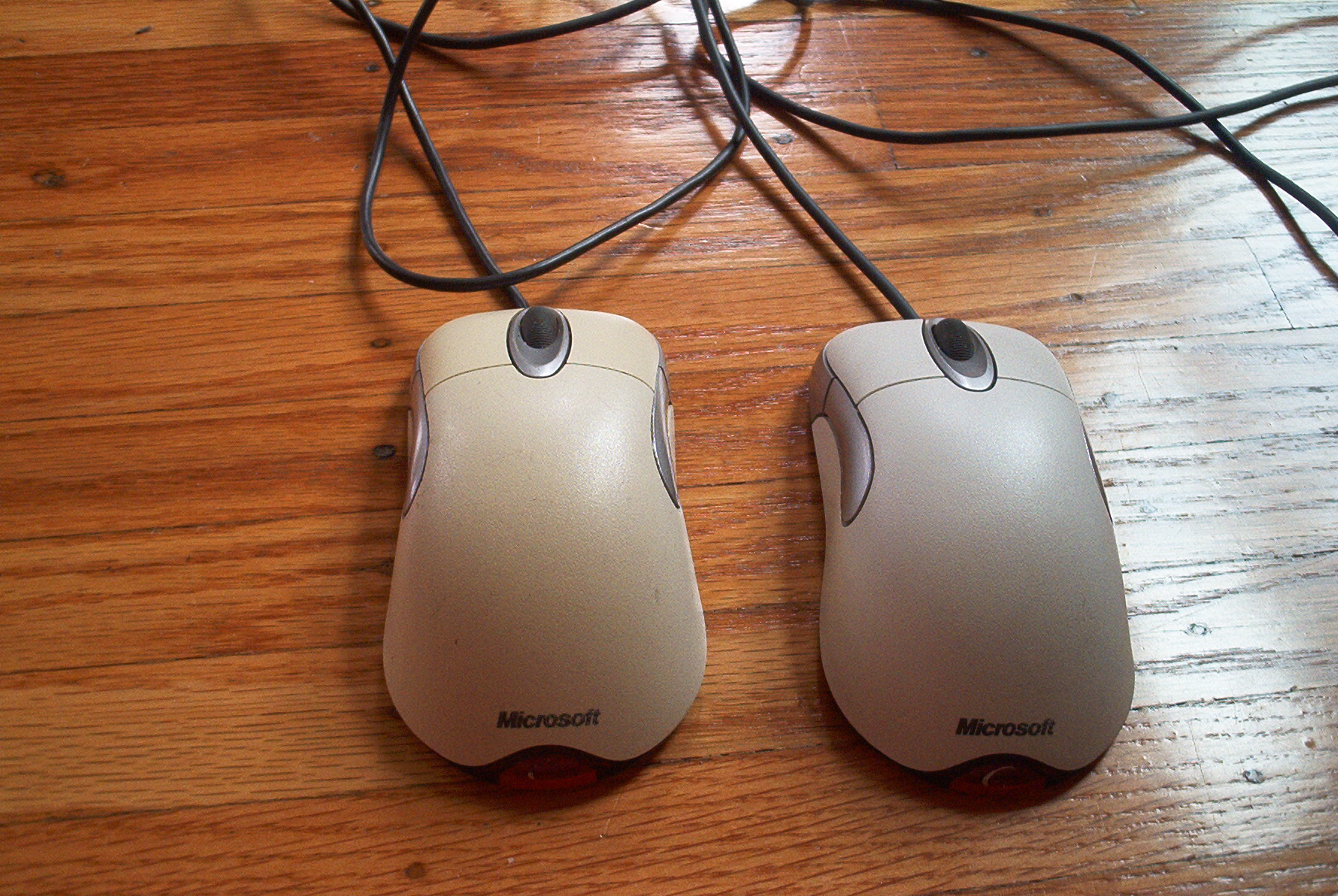

    for these pictures, the dead one is on the left and the good one is on the right.
    you can see the good one is yellowed... cosmetically it is kinda ugly, hence why I bought the one that died (It was used with my laptop). form this view, nothing else looks different.

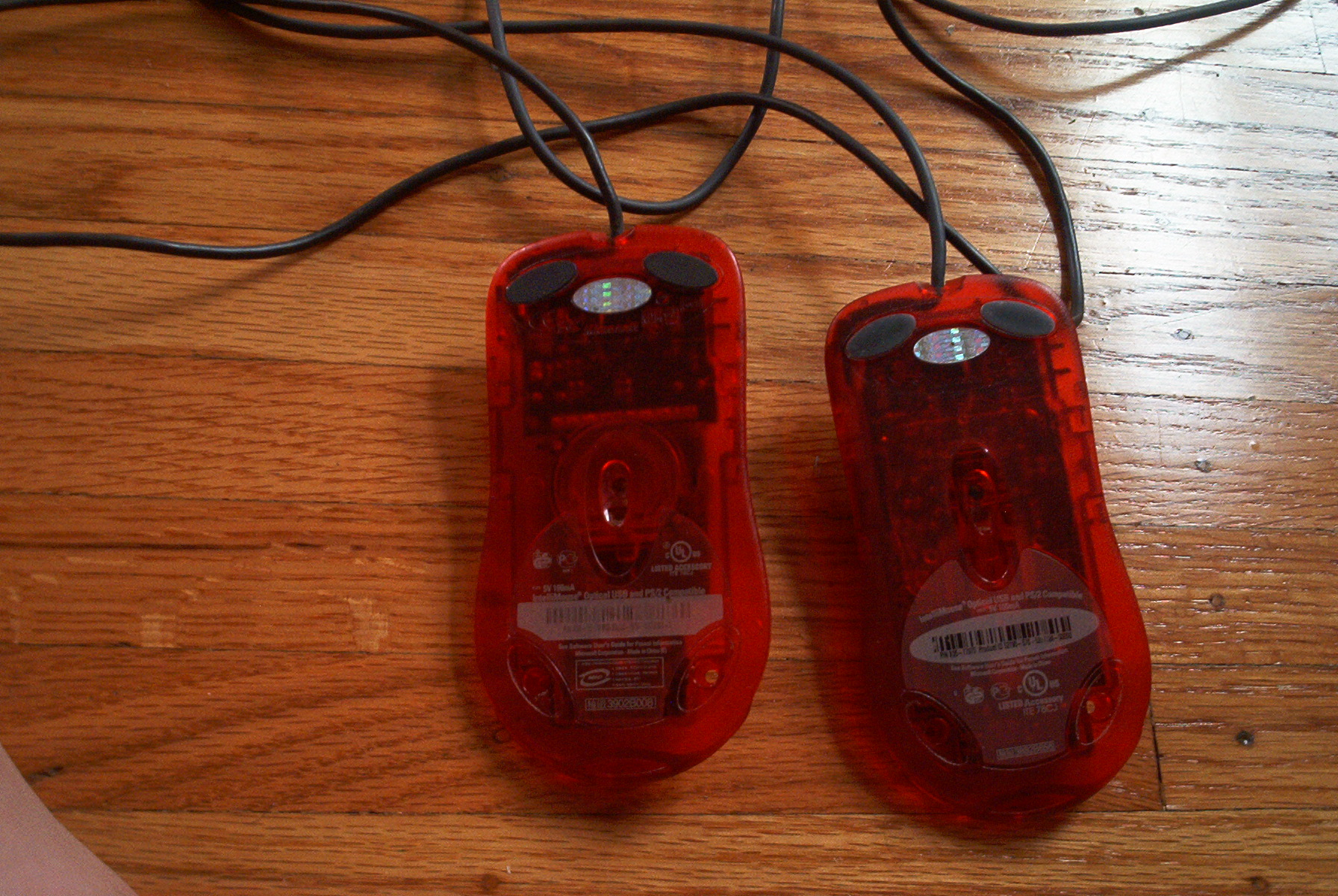

    from the bottom, the labeling is obviously different.
    even the shells are different... note that the dead one has the 2 screws missing... also, there are 2 gray supports that are in different locations, disallowing the swapping of shells.

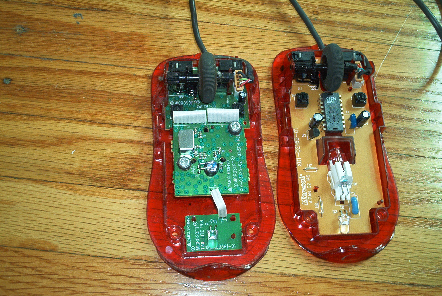

    but the biggest difference:
    The guts are obviously not the same... the dead one is all on one PCB, while the good one is split into 3. ironically, the switches and usb connector are all in the same spot. also, the good one uses 1 small 'lytic cap, while the dead one uses 2 larger caps.
    the only other ting the mice have in common is they both use the same brand cap... wincap (ironic that that brand was found in a microsoft product?)
    from the looks of the revisions marked, the dead one appears to be a newer build... and also a cheaper build. when resoldering the dead mouse, the single sided PCB seemed very cheap and i was surprised the traces didn't lift off on me. also, I noted that the dead one used clips not screws to hold in the pcb and shell components, unlike the good one.

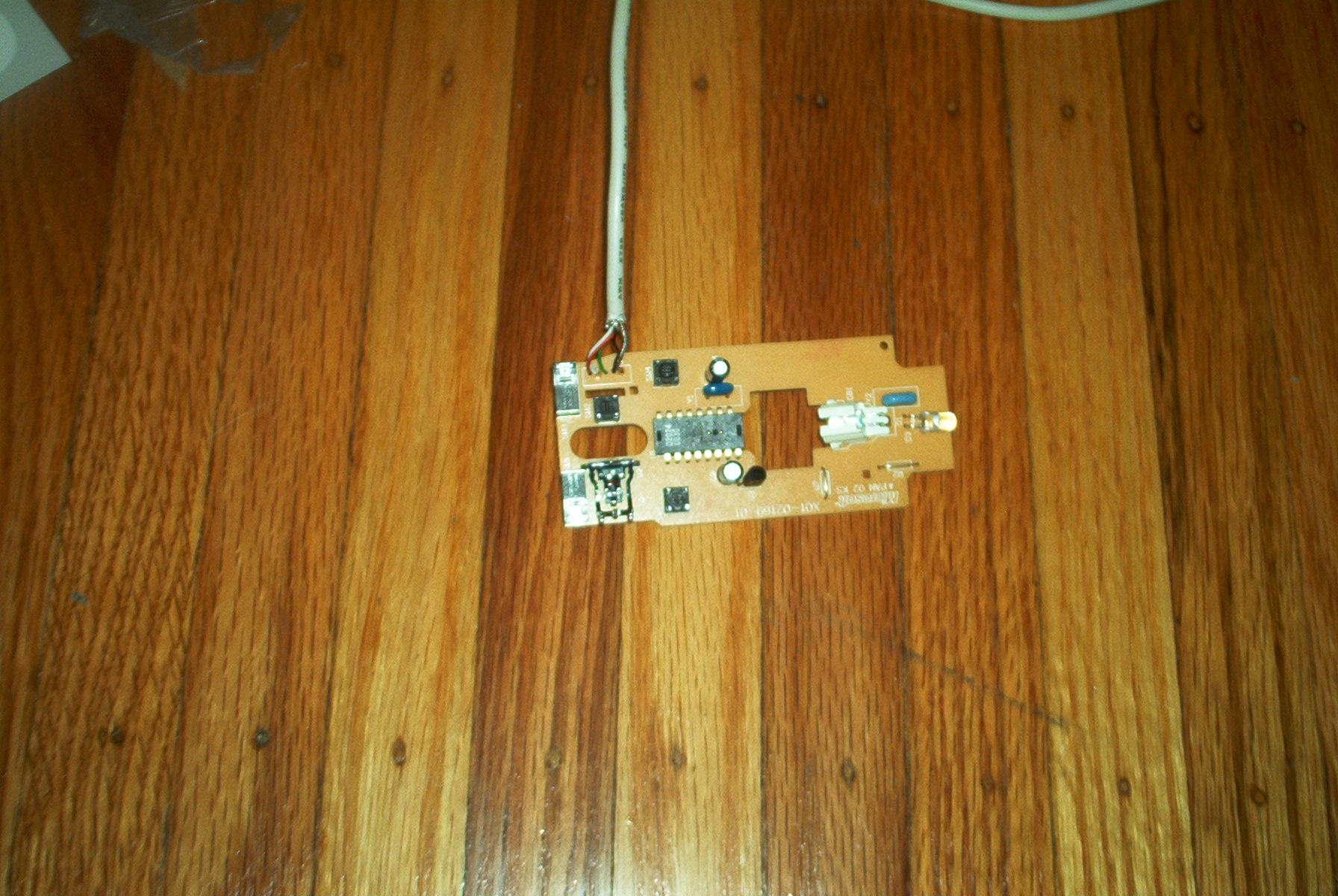

                    fixed it!
                    i happened to have a double ended usb cable sitting in my stash. I planned to chop it anyway (for use on two xbox controllers yet to be found/bought), so I took half of it (2.5ft) and soldered it to the pcb:
                    (sorry about the picture quality)
                    it works again... and with a cable less than 1/2 the length and thicker than original, it much better for use with my laptop (the extra cable would often get in caught in things and get in the way). the only fun part was getting the thicker cable to work in the cable channel... it took some force but its in... I might use some super glue to seal the deal since the front is under extra tension with the cable crammed in there.
                    how do you think i did?
                    Thanks Toasty for the hint... the cable looked ok so i never would have guessed.

                    • ratdude747
                      Black Sheep
                      • Nov 2008
                      • 17136
                      Re: Microsoft Intellimouse revisions
                      I carved some of the plastic out so there no longer any extra tension. it should be good to go (knock on wood)
