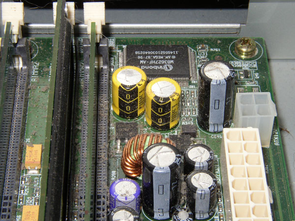

    My computer recently started displaying little pixelated gaps in the display. Upon opening it to inspect it seems some moisture has found it's way inside because there is rust around the fan grills and I/O connectors.
    It is an Intel D865PERL which has only recieved moderate use over the last year but it has a row of those yellow Fujitsu solid polymers near the cpu which have been identified as badcaps.
    Could these be causing the graphics corruption after only a year of little use? All other hardware has been eliminated as a possible cause. Any clues as to how I should go about diagnosing the fault.

    I put computers on boats so I see a lot of moisture problems.
    What wasthe source of the moisture?
    Rain, airconditioner, condensation, salt water?
    If it's salt, you may find green and brown residue around a graphics chip which usually can be cleaned up with a tooth brush.
    Look carefully at the graphic memory or main memory for signs of corrosion.

      To be honest I do not know. The only possible source of moisture I can see is some airborne mist from the garden reticualtion system at the rear of the house but that is a stretch.
      Have cleaned up the whole board including graphics chip as best I can.
      I have tried using an old s3 trio PCI card on a fresh XP install and the corruption does not occur but instead whenever I go anywhere near the display properties a different problem occurs. The computer locks up completely and I have yet to find a way around this. This does not happen with an AGP card.
      A bit of a shame really. The board is otherwise functional.

        Does the bios have a setting for AGP or PCI graphic priority?
        Memory timing?
        Not unusual for an s3 card to have incompatable driver but sounds like you've narrowed the problem down.
        May also check that board supports bus mastering and there are no conflicting devices.
        Your chipset drivers may not be loaded?
        Jim

          Yeah, I set it to PCI.
          XP spat out a driver no worries.
          Modern board - 865 chipset.
          Chipset drivers already installed.
          Think it's secrewed dude but thanks for asking.
          Unless it's those little yellow caps screwing things up - I dunno?
          Just to top it off, the replacement board I bought off Ebay turned out to be a dud too!
          When your hot - your hot. When your not - your not!
          Give me some of that wicked humour you are famous for - I could use a laugh at this stage!

            Try another card, some S3 Trios are known to cause problems with some chipsets - I've seen random hangs with S3 Trio64V+ (it was my test card until I fried it) and boards with i440BX and i815 chipsets.

                Anyone ever seen intel 865 boards with Rubicon caps standard? A couple of big honkers were on this board near the CPU which made me wonder if it might have been worked on before.
                • Neo2_000
                  • Apr 2005
                  • 180
                  Re: Graphics corruption Problem
                  The original 865 is actin real squirly now. Almost loads XP then resets.
                  Might try replacin that row of little yellow sargeants adjacent the CPU:
                  https://www.badcaps.net/forum/showthread.php?t=597
                  They aren't bulging but it's gotta be worth a try.
                  They are solid polymers 560uF 4V.
                  Be OK to use 1200uF 6.3V Rubys or would 100uF 10V be a better choice?
                  Remember reading somewhere you shoulkd double the value of Oscons for replacement by Lytics? Would that apply here or am I reaching?
