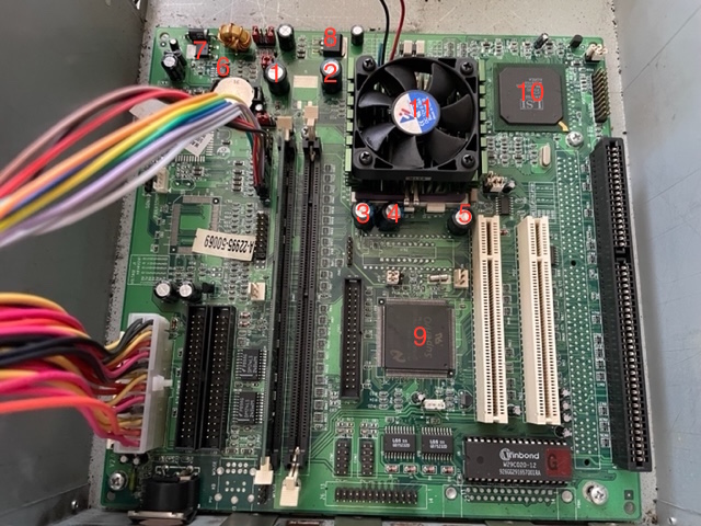

    Hello, I have a problem with this motherboard mgx 7520.
    This motherboard is from a pinball (revenge from mars); the problem is with the onboard graphics.
    After an inactivity period i can see the post screen but only for more or less one minute, than the screen goes grey, it stay powered on but nothing on the screen. If I use a pci vga card the pc works flawless.
    If I let the mobo without power for a while (i think something has to discarge) then the onboard graphics work again but again only for one minute and then grey monitor.
    I tried changing the power supply, the ram and also the processor, but nothings change.
    This motherboard has a known problem with some capacitors (number 1 to 5), 1000uF 10V, but mine looks good, after an inspection i notice that they was already been changed.
    I tested with the dmm the 5 capacitors and number 1 to 4 give me a value from 3 to 5 kohm, while number 5 only 25-30 ohm. Thinking it was shorted i decided to change all with panasonic FR caps.
    I tested the removed caps with the esr meter and all was good 1000uF and an ESR of 0,14 ohm, testing the pads of the numbered 5 cap on the mobo with the dmm again 25-30 ohm.
    What else can i do? that value is normal or there is a short on the board?
    I'm not an engenier nor a technician, but i have experience in electronics DIY, but without the schematics of the board i can't go further by myself.
    1) 1 to 5 Removed caps
    6) AIC1579CS
    7) 09N05
    8) L1084S
    9) PC97317 - IBW
    10) CX5520
    11) CPU Cyrix GXm-233GP

    Re: MGX7520 onboard graphics problem
    Hello, i found another identical mobo, but this one is working.
    I check the number 5 caps with the DMM in ohm mode, and in this board the value is 350 ohm, so completely different from the non working one.
    I think the problem is in this line, but where?
      Now that you have two identical board a nice way could be to use a thermal camera to look for any hotspots that are not the same between the units.
        I was thinking the same, but i don't have a thermal camera, and i didn't found a cheap one.
        I tried to touch with the hand, but in this way i didn't found differences.
          I don't think 25 ohms would show up in temperature measurements.
          Can you see what that cap connects to? The CPU takes 2.9V and 3.3V, and I would guess that the Cx5520 runs off the same 3.3V supply. The 3.3V most likely comes from the L1084S.
          Also, check the voltages in both the working and non-working states.
