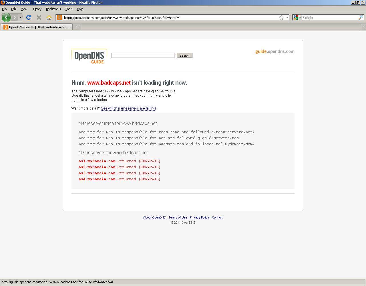

    OpenDNS
    Couldn't get my BadCaps fix yesterday - kept getting the attached
    Problem went away after I changed to Google DNS

      Re: OpenDNS
      My withdrawal anxiety is abating now
      And I've opened a case with OpenDNS - will be interesting to see their response

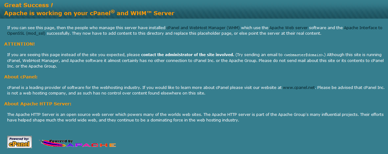

              ISP DNS Problems with Badcaps.net
              Not sure the place to post this, but here seems good enough so I guess it will do.
              I've had problems with the website failing to load for a couple of days and once last week, at first I thought it was a problem with the server but then I got some email reply notifications while the site was 'offline' which made me suspicious
              Called my ISP and they confirmed they're looking at what seems to be a fault with their DNS and with any sites that use the name servers "NS1.MYDOMAIN.COM through NS4.MYDOMAIN.COM" - which includes Badcaps.net
              I guess there is not much that can be done on this end, but thought I might as well post here. Currently using Google's DNS servers instead of my ISP ones.
              As a side note, I tried accessing Badcaps.net by IP address directly but I just got a blank page.
              Does anyone know why that is?

                Re: ISP DNS Problems with Badcaps.net
                On most web servers they use a name based addressing system.
                for instance a website with a domain name like domain1.com may be on a server with a ip 111.111.111.111
                If you were to go to 111.111.111.111 the server will display it's default page that could be blank have ads or display the servers info like in the attached image.
                most servers are set up to server more than one domain name like domain2.com domain3.com domain4.com domain5.com but they all are on the ip 111.111.111.111
                hope this helps.

                  Agent24 - I merged your thread with this one. Not sure why some people are having problems with DNS and others not. DNS propogation is a funny thing... Drove me up the wall when I worked for Network Solutions. Most people are not happy with an answer of "wait 24 hours"...
                  Perhaps your ISP is actually using OpenDNS for their servers? If that's the case, it's possible that OpenDNS has decided to blacklist mydomain.com or something.
