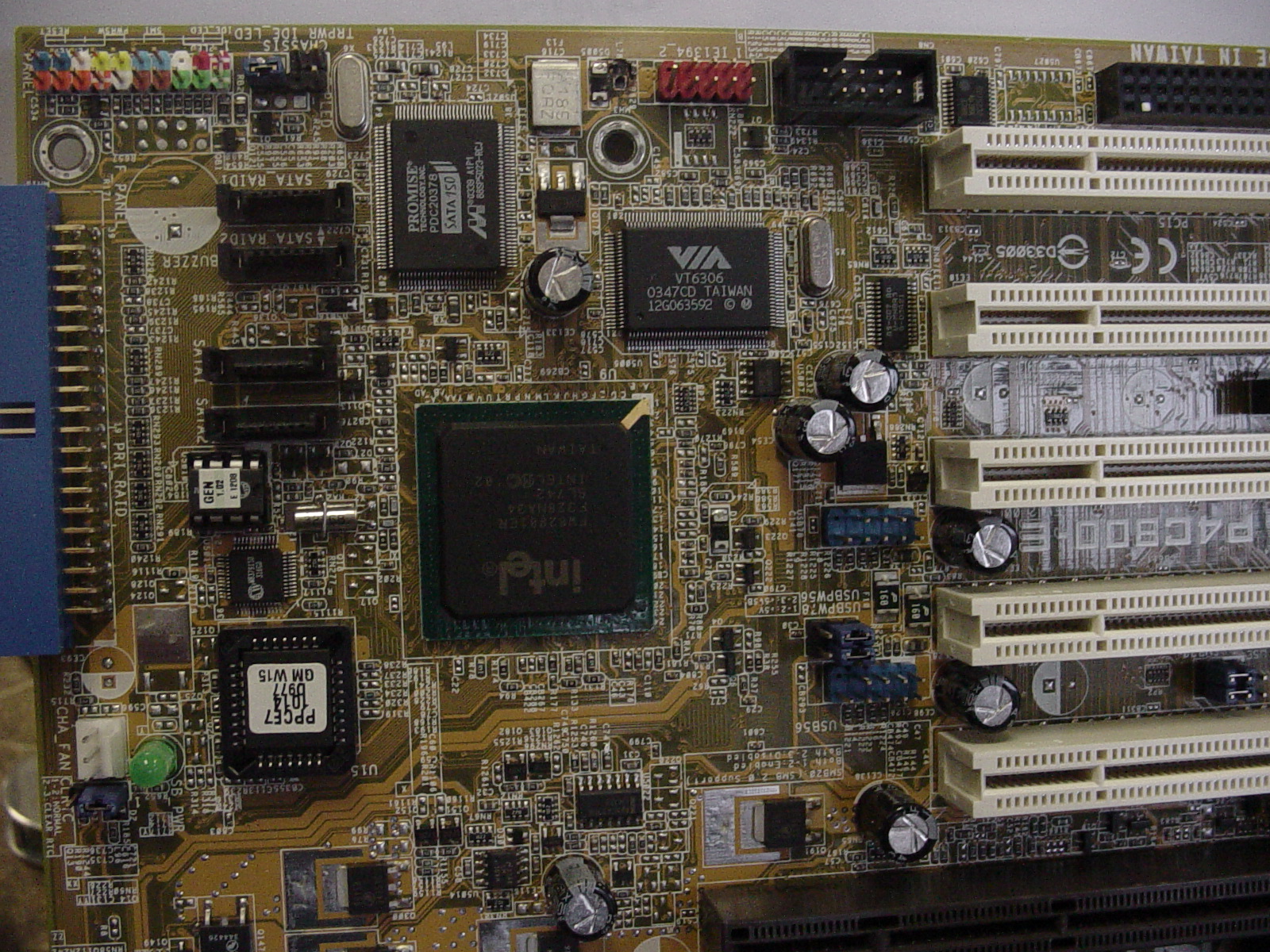

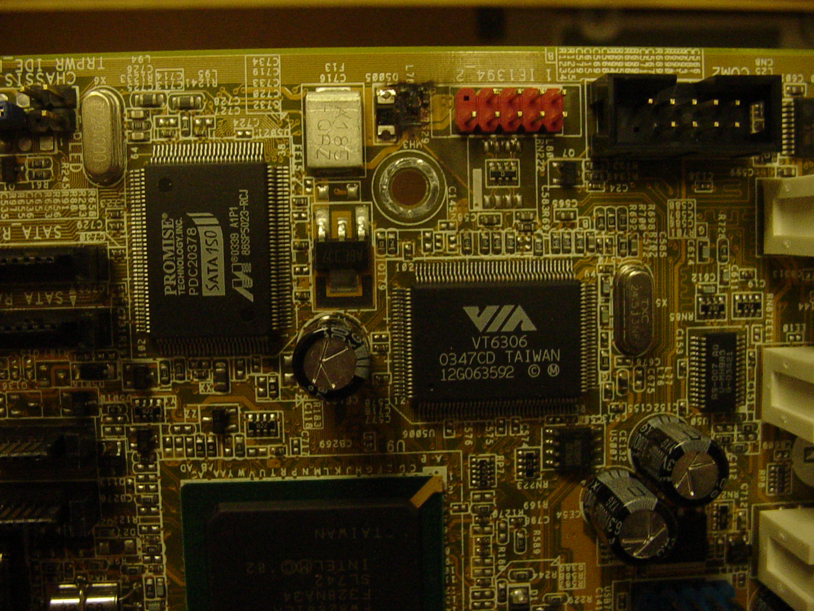

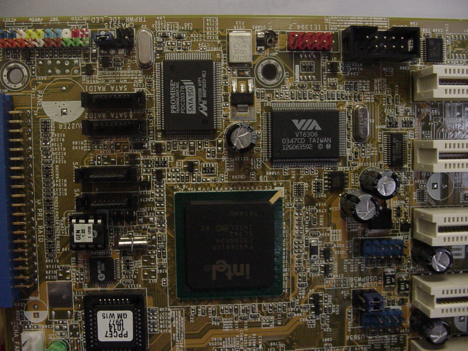

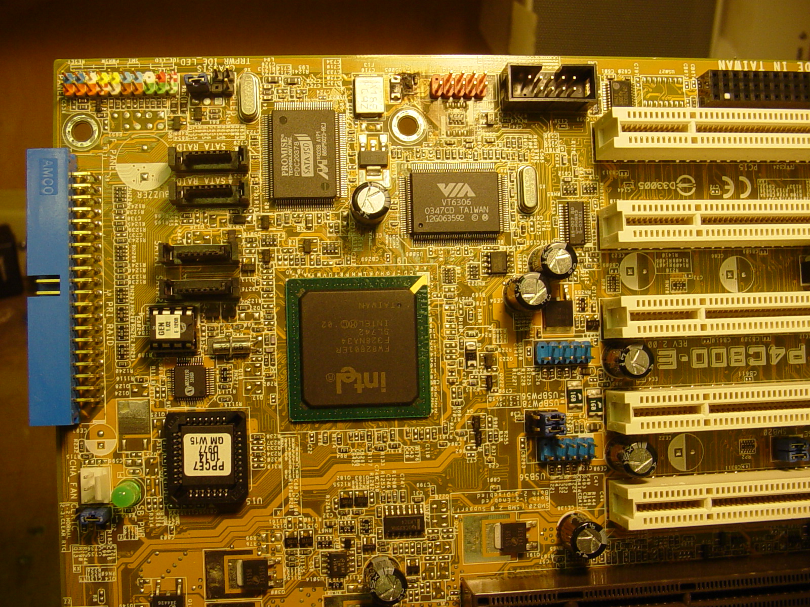

    Hello All
    If anyone can help with the P4C800-E motherboard
    It Throws GPFs when trying to install windows, sometimes it reports the bios is corrupt

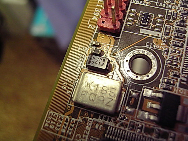

    After pulling it out and looking at it carefully I have spotted where the problem is. There is a burned spot next to the Firewire port.
    Does anyone know what was there and suggestions on how to fix it? It has P4 3.4Ghz CPU so it is decent for many things and it would be nice to get it working again. I do not mind killing that Firewire port so if I can fix it by unsoldering something there that would be OK too.
    It comes in a nice aluminum case with 400Gb and DVDRW so getting it working would be nice. If I can get it working, adding a $100 approx cost BluRay burner and I could use it to backup data files off of other computer drives over the network. Gigabit of course, I can't believe I am using eight ports out of nine in a simple home network, Oh well.
    Thanks for any suggestions
    RT
    FWIW those were the best pictures my old Sony 2Megapixel camera produced.

    that does look bad but i'm not sure thats the reason why. do you know if your ram is good. usually bad bios checksums can be due to a bad stick
    that looks like a diode directly in line with your firewire. don't use it

      Looks like a fuse which has obliterated itself.
      Can't tell whether L3 next door is dead or just covered in soot.

        I tried different memory, different power supply, different Video card, The bad Bios checksum is sometimes. I dipped a toothbrush in alcohol and scrubbed it. maybe the attached will help?
        Since I do not care about the Firewire and if that is where the problem lies I wonder what I can unsolder as a fix.
        I see four KZE 1299uf @16v and the rest seem to be Rubycon and they all look visually OK. So I'm thinking it has to be at the burned spot
        L3, I'm not seeing it?

          Do you have any KZG?
          Technically, the firewire socket is now out of circuit, so it *shouldn't* be causing an issue. It just depends on what the item next to the fuse was. Have you turned off Firewire in the BIOS? That should cure your problem if it is the issue.
          I may have one of these in an old server, will check tomorrow.

            Fuse is the large metal-plate thing.
            L78 is whats blown and the item next door is a diode - possibly also blown if somehow power was applied to the connection in reverse.

              I may be dating myself when I say this?
              I seem to remember from my school days in electronics course that parts labeled L78 would be a inductor, D5005 a diode, and parts labels C78 for example would be capacitors. Of course those days we Used VTVMs and Tube type Oscilloscopes. I had to dig back in memory to recall that since it has been many years ago.
              The Diode tests shorted one way and open the other so I'm calling it OK. The Fuse has continuity so it is OK too.

                KZG & KZJ are famous for failing with with no visual indication.
                So are OST [any series].
                Asus naturally likes both KZG and OST caps.
                That way most people will need to buy a new mobo in fewer years from new.
                L D and C still mean the same things. [Except maybe for Asus..?]

                  So KZE is good and KZG & KZJ bad, Got it. Most on this particular board are Rubycon
                  Well I figured I needed better since I want to destination to a BluRay burner. They've come down in price. I believe the last Verbatim blanks, the better ones not the LTH, I bought were around $3 each in the ten pack, currently $3.60 off sale.
                  Right now since I used a toothbrush to clean the burned area that I discovered yesterday I have been able to install XP onto a small (20GB) drive that I keep around for testing.
                  Since that did work I'm installing to a 200Gb SATA from scratch as a test. It was either the cleaning or turning off the firewire that seems to have worked.
