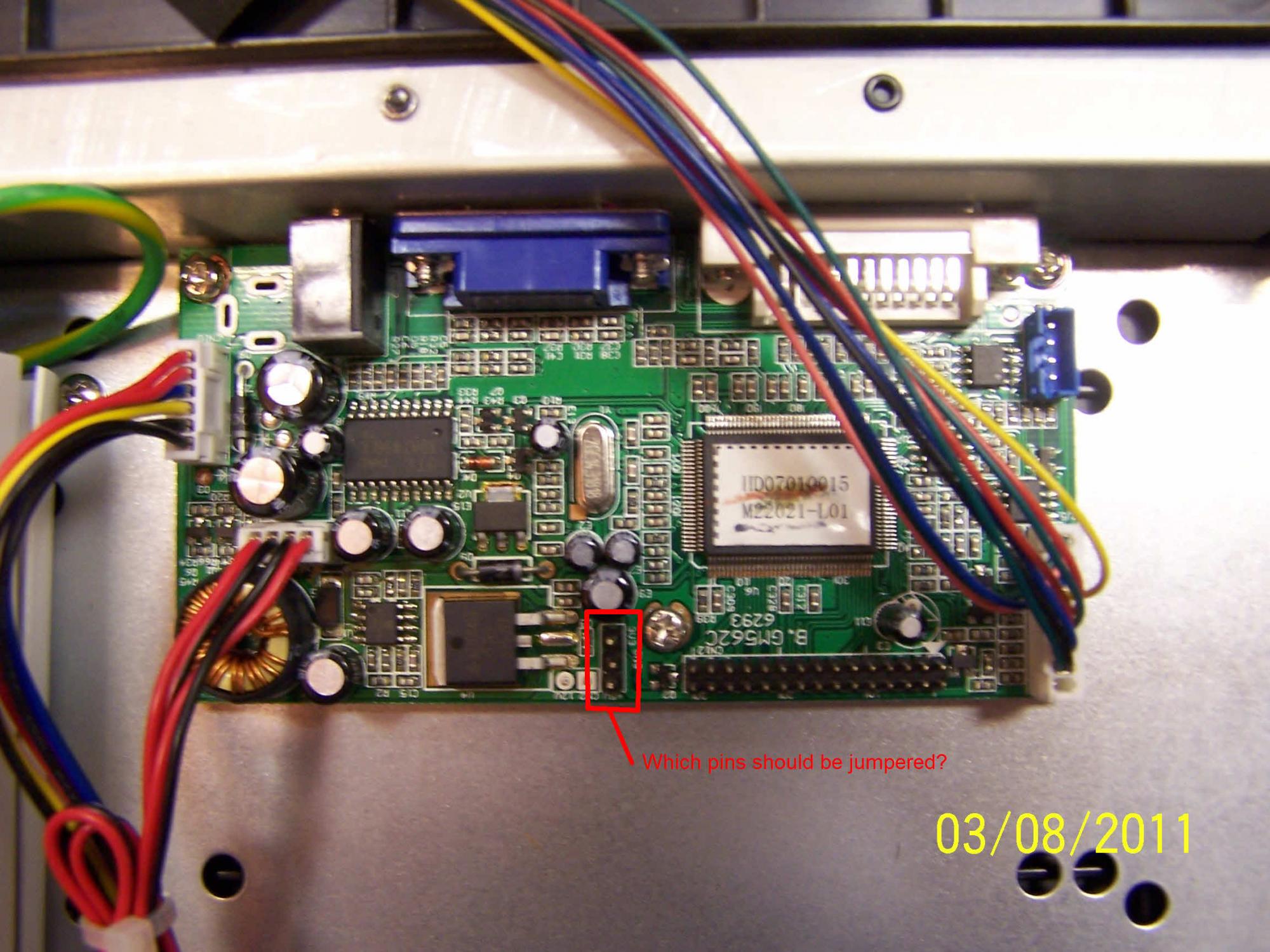

I inadvertantly removed a jumper on the display driver board of my X2GEN Model MW22U monitor while disconnecting the multi-conductor cable. See photo. Anyone know which two pins need to be jumpered? TIA!
X2GEN Monitor Jumper

If someone finds this through google or whatever, try the 3.3V setting first and see if it works properly. If not, change it to 5V.
Selecting 5V for a LCD panel that needs 3.3V is almost guaranteed to let the magic smoke out.. and the LCD panel is the most expensive part of any LCD monitor/TV.Last edited by Scenic; 03-29-2012, 09:19 AM.Comment
