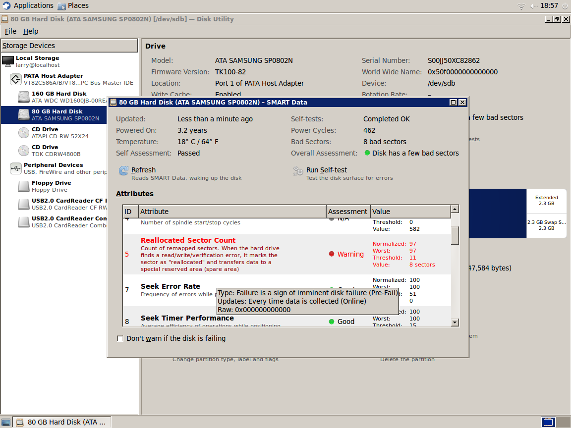

    i think i found the problem
    switching to a 160gb wd green seemed to fix it... i guess the spinpoint is a spinout failure
    btw, it is compaq presario 7000, with a VIA chipset and firewire. full ATX s well.

          uhh... it might be the cable. cd tested good, but 2 bootloader install errors. the disc was good an smart last i checked (cannot check now- xubuntu doesn't have disc utility by default).
          i will have to try a different cable. if it is the cable, then maybe the sammy is not RIP.
          sigpic
          (Insert witty quote here)
            Re: samsung 80gb hard drives
            fixed. different cable... or was it the fact i did not have install updates as part of the install... i might have to give the sammy another go sometime...
              If possible, take a screenshot of the SMART data and post it here.

                  momaka - Keep in mind that SMART data is not the final word on drive health. It does usually give a good overview; but every once and a while, you'll get a drive failed with no SMART codes set.

                    well, i fi had smart data, i would give it to you.
                    my disc i was using was XUBUNTU. xubuntu does not have disc utility. ubuntu does but is too heavy for the system.
                    i can give smart data on the 160gb wd, since i instalkled disk utility. it says everything is in order...
                    i will plug in the 80gb sammy as slave and see what i get.
                      ok, done.
                      the sammy has 8 bad sectors.
                      screenshot attached.
                        Some people would still use that drive, as all drives have built in "spare sectors". But, I never re-use a drive with bad sectors, unless it's for something stupid like my truck MP3 drive or something, where loss of data would cause me no harm or time lost. But with the performance issues you're already having, I'd just chuck it in the bin.

                          My recommendation... I'd do a full surface scan of the drive. There may be other sectors that have yet to be mapped out. If you do a full scan, and it finds more, replace the drive. If the full scan doesn't show any more bad sectors, keep a close eye on it. These sectors will show up in the SMART data for the drive. They won't show up as bad sectors in the file system unless the drive runs out of spare sectors (256 spares, usually), or it fails to remap a sector completely because the data is that far gone. If it's a mission critical drive, I'd replace it anyway.

                            RD: What are the other attributs reading, such as Raw Read Error Rate, Reallocated Event Count (if present), Current Pending Sector, Offline Scan Incorrect (if present), UltraATA CRC Error Count, and Write Error Count?
                            8 bad sectors isn't at all that bad, as long as that number doesn't continue increasing. Do a surface scan as yyonline suggested. Also do some heavy writing (single large file and a large folder with multiple small files). If the Bad Sector count doesn't increase, drive should be okay to use. Probably better to use for non-critical stuff only or perhaps as a secondary drive, though.

                                      i think i will keep it as an emergency spare... i forgot i had the spare 160gb
