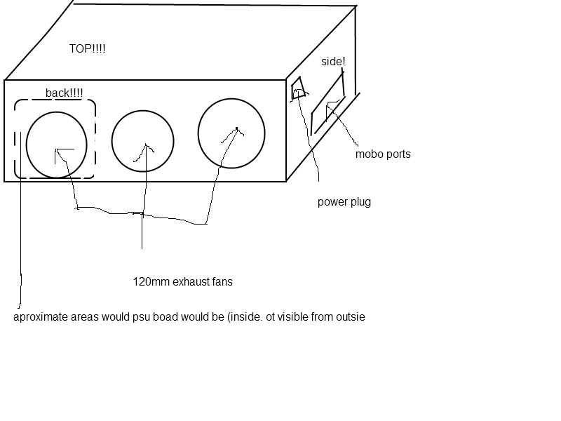

                    hmmmm-well i wass going to use unfinished wood, then maybe put a veneer on the inside? or is that a no-no?
                    also: i am planning to remoe te metal casing of the psu and just mount the circuit board piece. so let me draw up a quick doodle but this may be far from what it will be like, since i havent meaaured the mobo r anything yet...

                      note that in the icture its suppose to say "approximate area where psu board would be, internal,not visible"

                        Sounds fine to me.
                        I think the board's hole pattern is regular EATX which is basically just ATX with an extra row of holes added on one side.
                        Full ATX is 12 x 9.6 in - EATX is 12 x 13 in.
                        A full tower full ATX case [or mobo pan from one] should work by adding the other row of holes.
                        I've done EATX into full ATX case before.
                        The drive mounts at mobo height have to go away leaving only the drive bays above mobo height available.
                        The odd placement of ports on that one would be the tough thing to work around.

                            One idea if you want a groundplane for the board would be to simply salvage the part from under the board in a scraped case and put the whole thing in the wooden box. Ive done it on a few occasions, much simpler then measuring out all the holes and stuff.

                              I may do that. But i dont know how to cut metal. I hink i will simply screw the motherboard to the wood. With a few washers so the board isnt up against the wood. Does that sound ok? But i dont know how to mount the drives?
